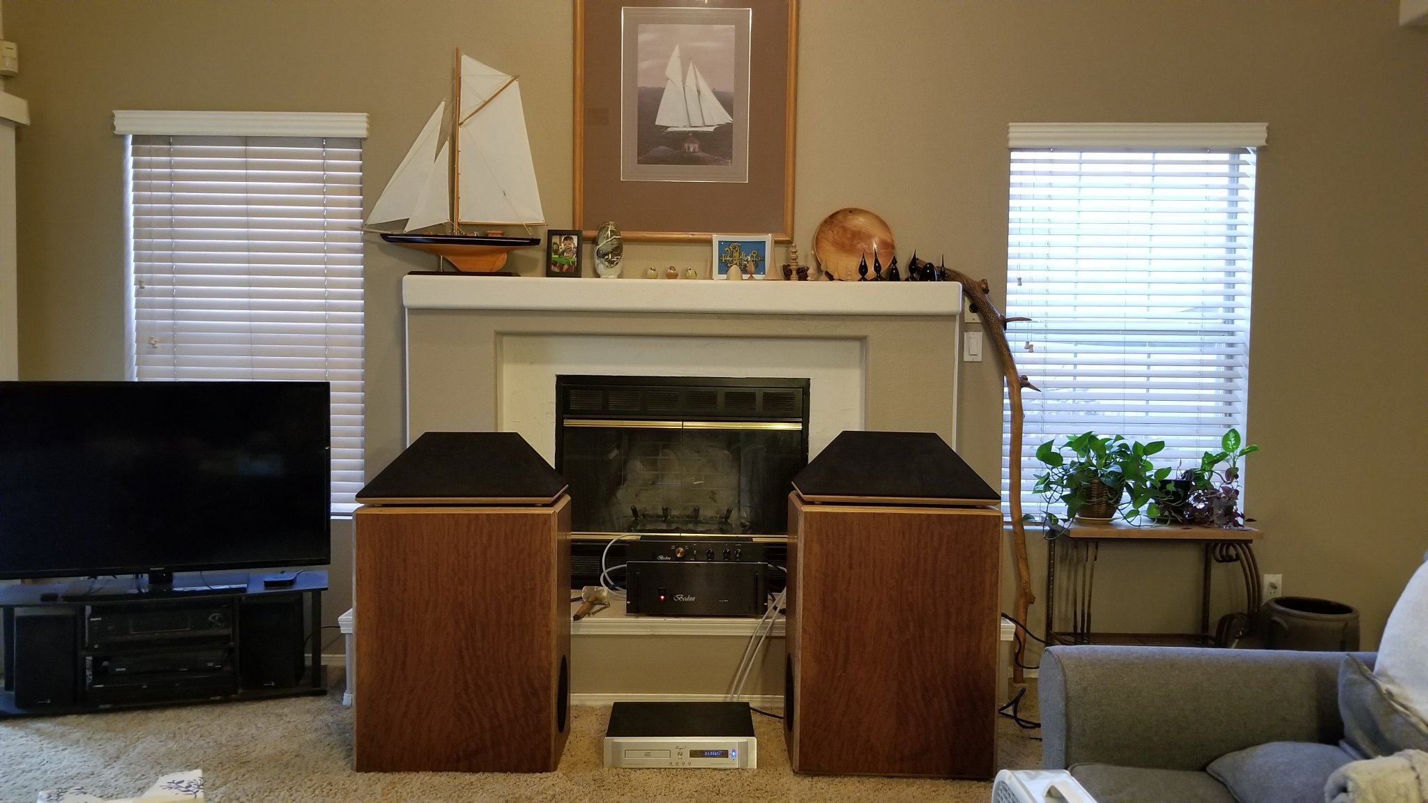

Here is the link to mine from the page Scott posted. Just click on Diapason Ensemble
