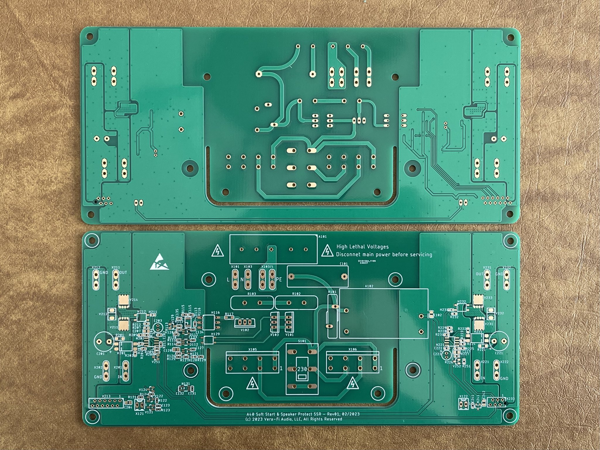

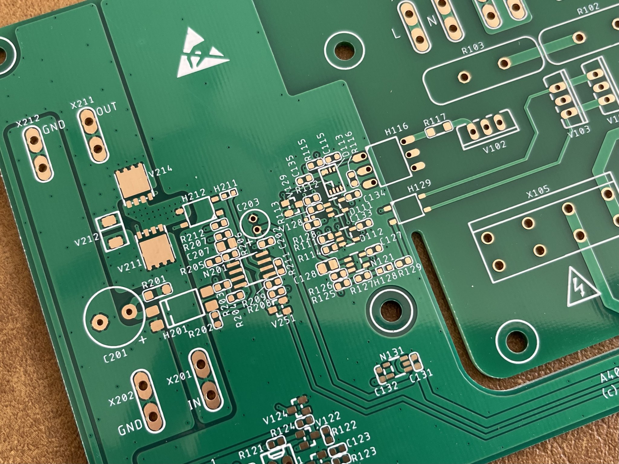

Thanks for your interest. I am stuck at finding time to build the verification board of the combined soft start/solid state relay/PSU main board for the A40. It’s basically a combination of 3 boards into one to simplify production and assembly. This will nudge me to work on it a little more. Thanks for asking.

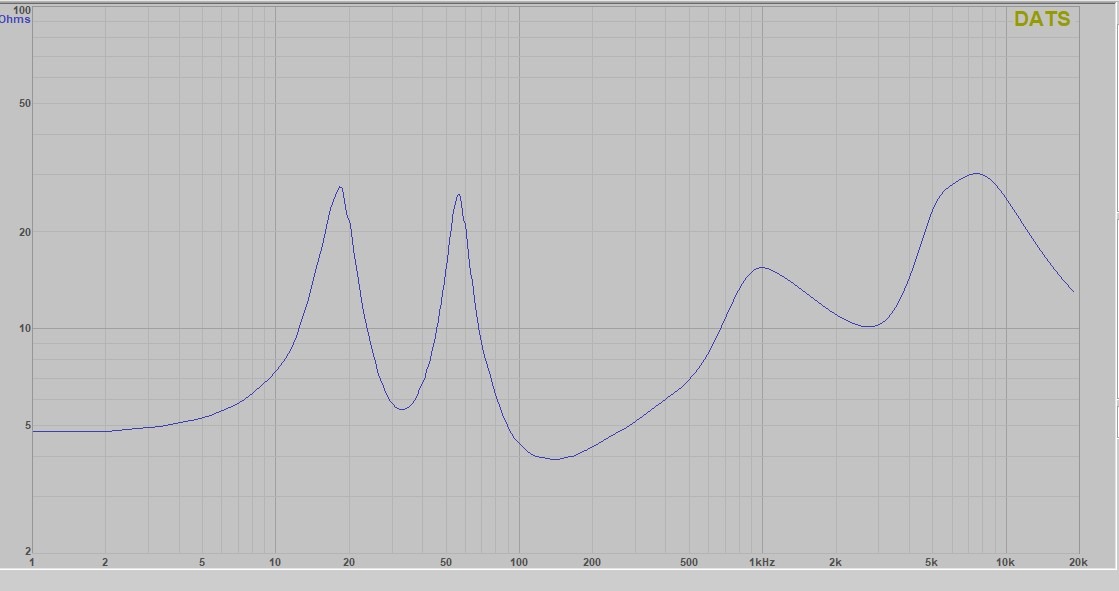

90 to 96dB sensitive 8R to 11R speakers should work great. 4ohms but 96dB should work well too. I have driven XSD which are 4ohms and 93dB and it works well. Depends on what your max SPL needs are.

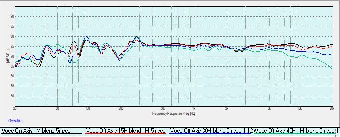

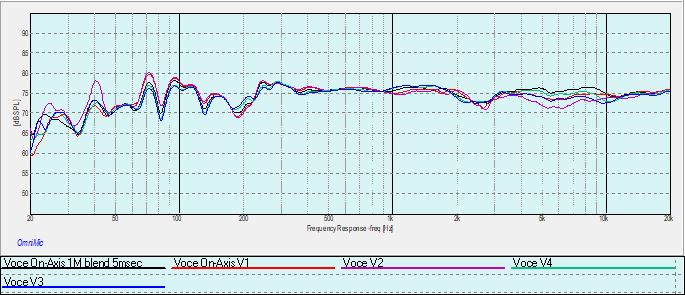

I found impedance and frequency response charts for my custom Selah Voce 3 way speakers.. my new plan is to use the A40 to power them in my nearfield setup with an eversolo dmp-a6 with upgraded linear power supply as the streamer/dac/preamp
it should be fine at non-extreme volume levels right?

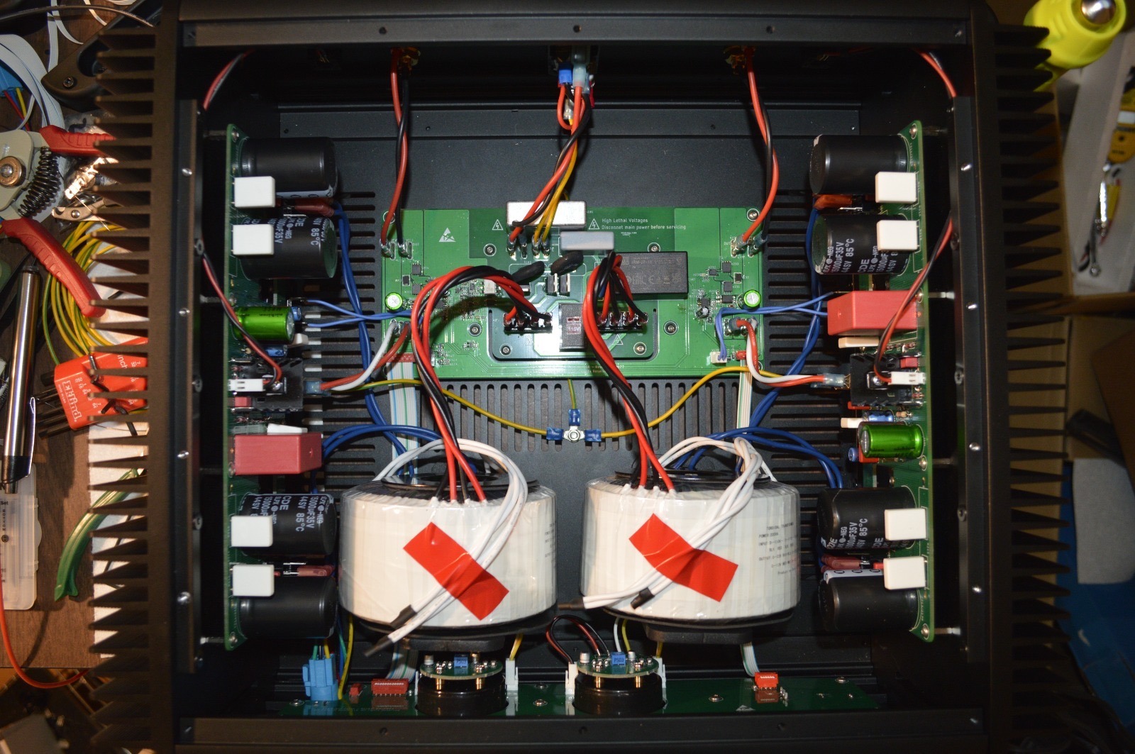

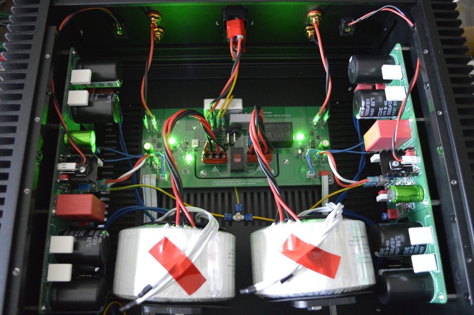

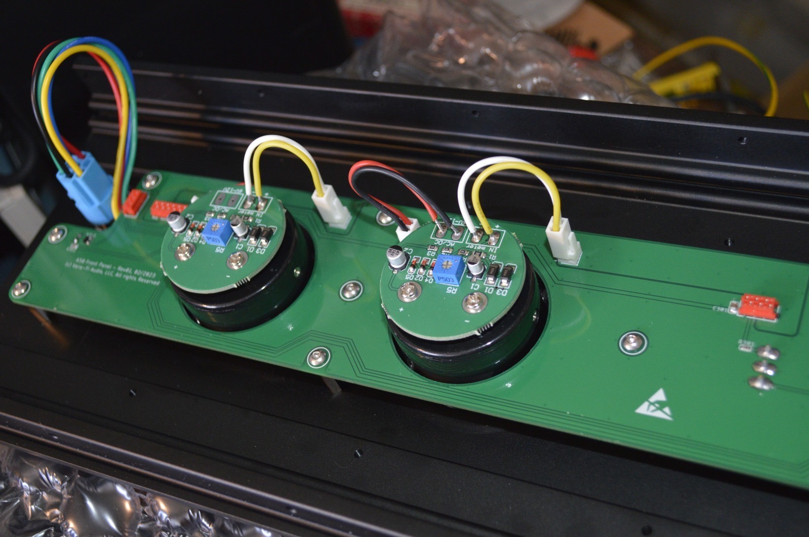

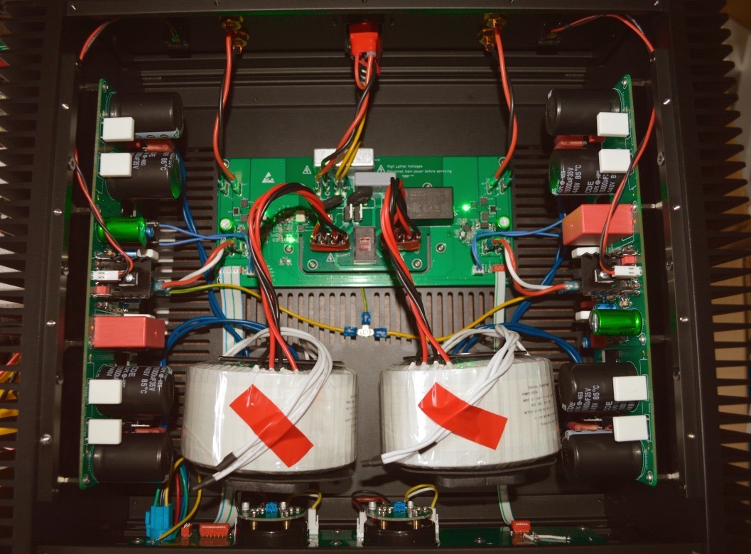

We are making great progress with the latest pre production prototype build.
The front panel PCB for the VU meters and switches with Micromatch ribbon cable connectors look totally clean and pro:
Operation of power on / standby solid state relays (SSR) and soft start SSR, and speaker protection solid SSR are working nominally. Front panel mute switch controls the SSR and that is working nominally. A lot of SSR’s - no mechanical relays on board.

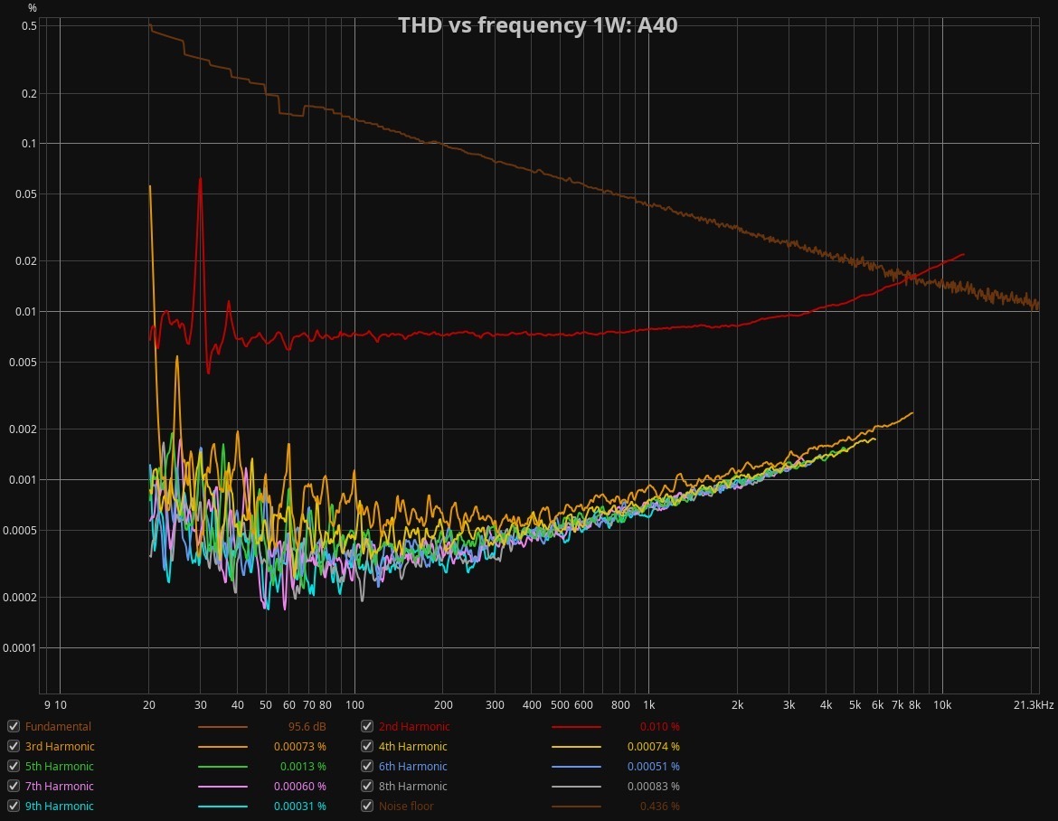

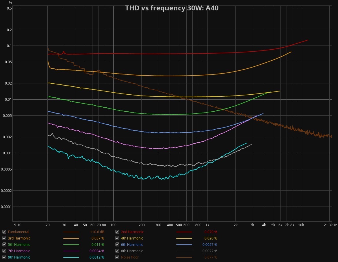

Some measurements of distortion too. Here is distortion vs frequency for 1W - note consistent level of dominant second harmonic and very little higher orders:

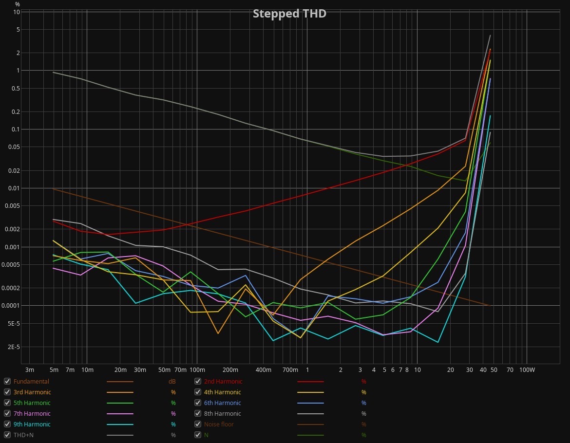

At higher power of 30W, second harmonic is still dominant and higher orders are monotonically descending in relative level:
And distortion components as a function of power:
The amp is working well as designed. DC offset is currently about 13mV. We are working on reducing this by adjusting the LTP tail current more precisely.
A great job by Keantoken on this verification build.
Funny thing is, I don’t think Keantoken has played music through it yet! 😂

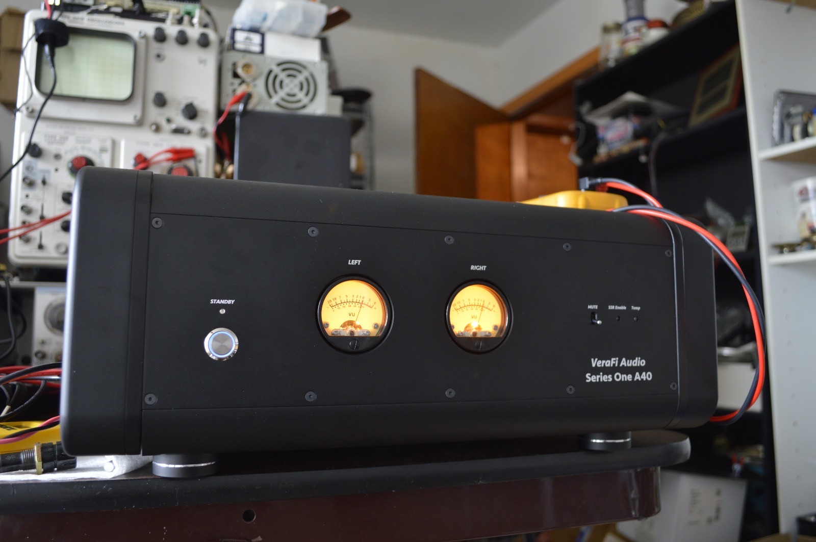

On the bench is a working A40 amp undergoing calibration of the VU meters. We decided to set the meters to 0dB at 8Wrms into 8ohms (8Vrms) vs 40Wrms. Because… customers like to see the meters dance with music playing at casual domestic volumes. If we set it at max power, it hardly moves and people complain or wonder if it’s working. 8W is a round number that most casual playing hits occasionally. Thats about 94dB at 1m for a typical 85dB sensitive 8ohm speaker.

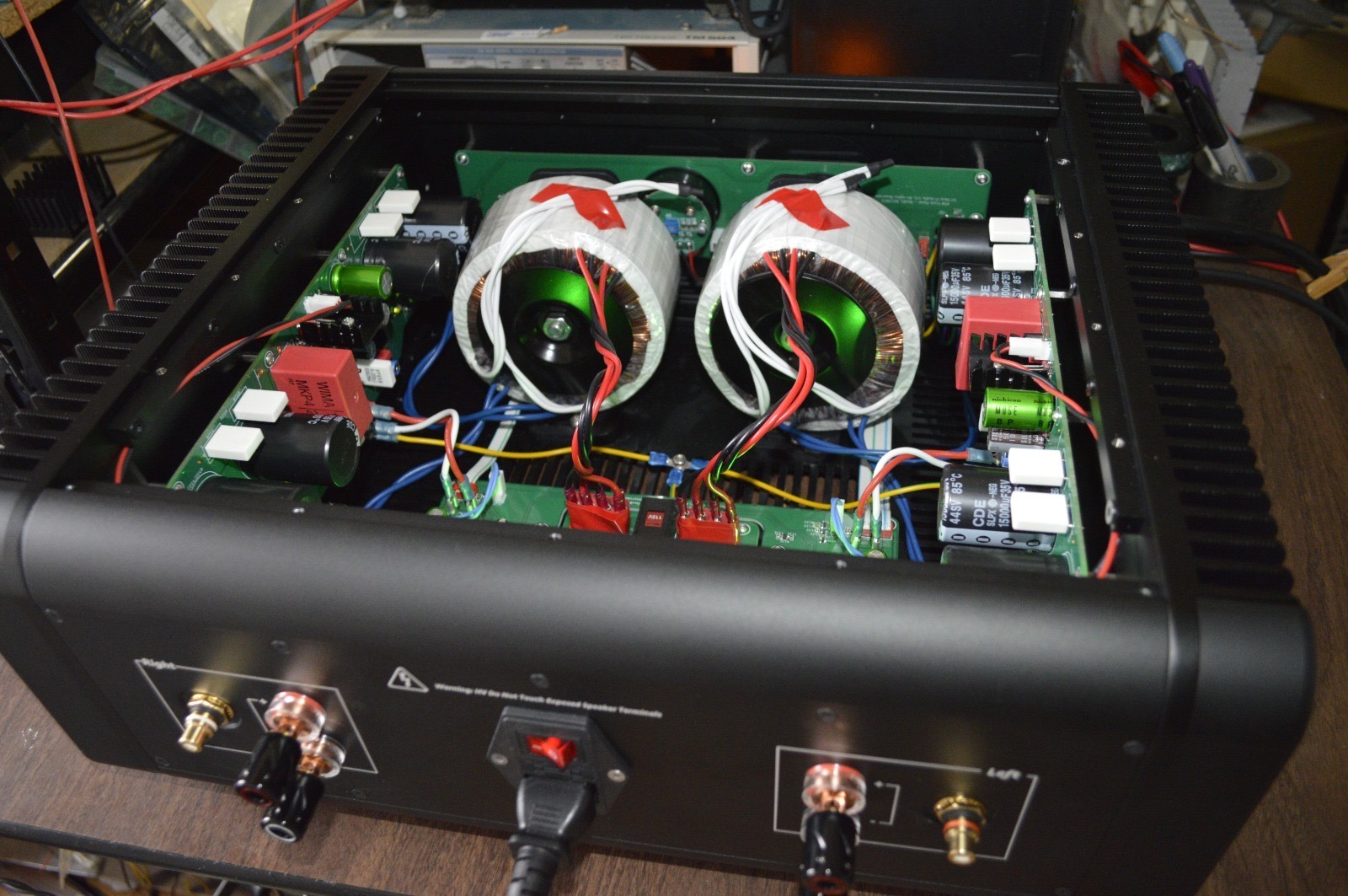

DC operating points on this unit are:
  • 1.67A/1.63A DC bias current through the output stage MOSFETs
  • DC offset is 6mV and 19mV
  • Rails at 29.5Vdc. This is a bit "hot" and probably can be reduced by 1.5V or so for production.
  • Heatsink temps are 55C for a 25C ambient room temp. (29.5vdc x 2 x 1.67A = 97W) this should drop a bit if we lower the rail voltage.
  • LTP tail current is 2.6mA
We are carefully fine tuning the front panel LED's, characterizing a wide variety and choosing the appropriate resistor to set the current so that the light output is circa 15 to 30 mcd. This is a value that is bright enough to see but will not blind you or annoy you when room lights are dim. It depends on the color too as green is very bright and blue can be annoying if more than 130uA of current. In the past, I have used a rule of thumb of 2mA for LEDs and this appears to be about 10x way too high for visual indicators on stereo equipment!
Typically, vu meters are set 0dB at max power, then there is 0.1X switch for one tenth of that.
