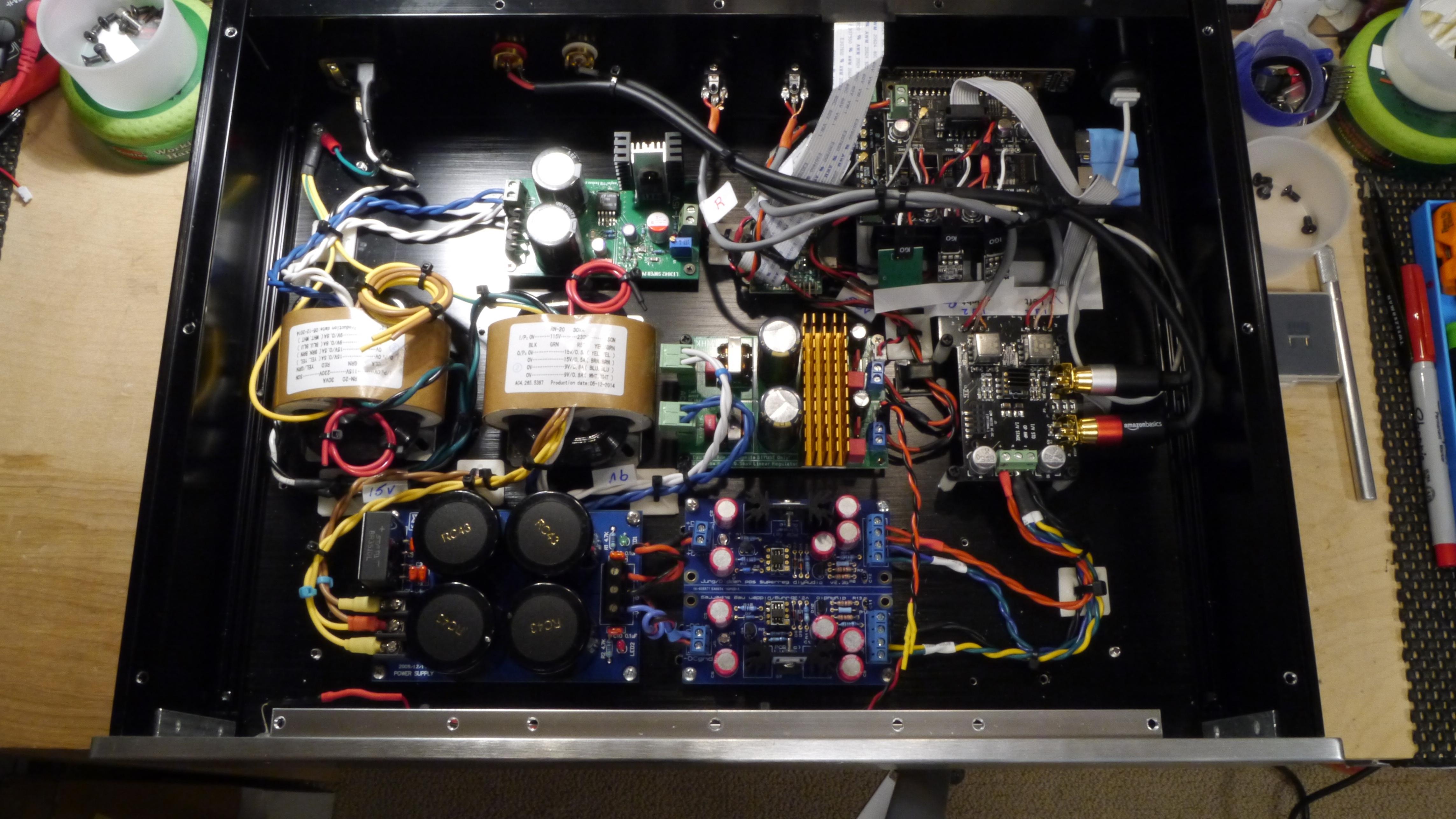

It would be nice to have the same modular advantages that the original Yarra has, for DAC and Bluetooth, etc. - but I'm not sure how modular it could be. I have numerous RaspPis and DAC HATs that I put together and use as streaming device end-points for roon. My main system DAC (pic below), and supporting hardware would not conveniently fit into a Yarra case sadly. :( Now, if you could provide space and back panel cutouts for a 'drop-in' RPi footprint, with associated clean power for a DAC HAT, that would excite me. The user could then supply the RPi and their favorite HAT with all the hookups ready to go. But I realize that may be outside the boundaries of the Yarra 2 conceptual design scope. I may be dreaming too.:D
After spending over a year building, modding and tweaking the one pictured below, it has pretty much provided digital nirvana for me. Once I start listening I have a hard time turning it off. :) I never thought a DAC could sound that good! Quality source dependent.

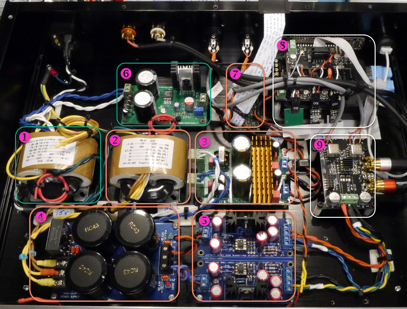

Sure thing.
Shown illustrated below is a block diagram of my entire DAC sub-system. This system uses the IanJin RPi DAC stack of complementary products featured in DIY Audio. More can be found here. Each block is numbered, corresponding to the list below.
1 - Dual secondary 9V & 15V xformer
2 - Dual secondary 9V & 15V xformer
3 - Dual 5V LDO DIYINHK Low-Noise Regulator. One side feeds the FifoPi Utimate reclocker. The other side feeds the dual mono ES9038Q2M DAC and AVCC Twisted Pear Regulator. It also provides a clean 5V to Jan Didden's SilentSwitcher (#7).
4 - Linear PSU rectifier and filter caps feeds +- voltages to #5. (Super Reg)
5 - Dual Jung/Didden Super Regulator providing +-15V to #9 (I/V Stage of DAC stack)
6 - Regulated 5V PSU provides separate power to the RPi.
7 - Jan Didden SilentSwitcher. (under the ribbon cable) This provides 6.5V as input to; 2 NewClassD Low Noise Regulators, used for both DVCC and VCCA.
8 - The DAC stack consisting of, from bottom to top; (1) RPi, (2) FifoPi Ultimate with upgraded Crystek clocks and (3) Dual Mono ES9038Q2M DAC board with 3 off-board regulators previously mentioned.
9 - I/V Stage with upgraded Burson Audio V5i-D opamps.
Is this what you were looking for? I don't have a schematic.

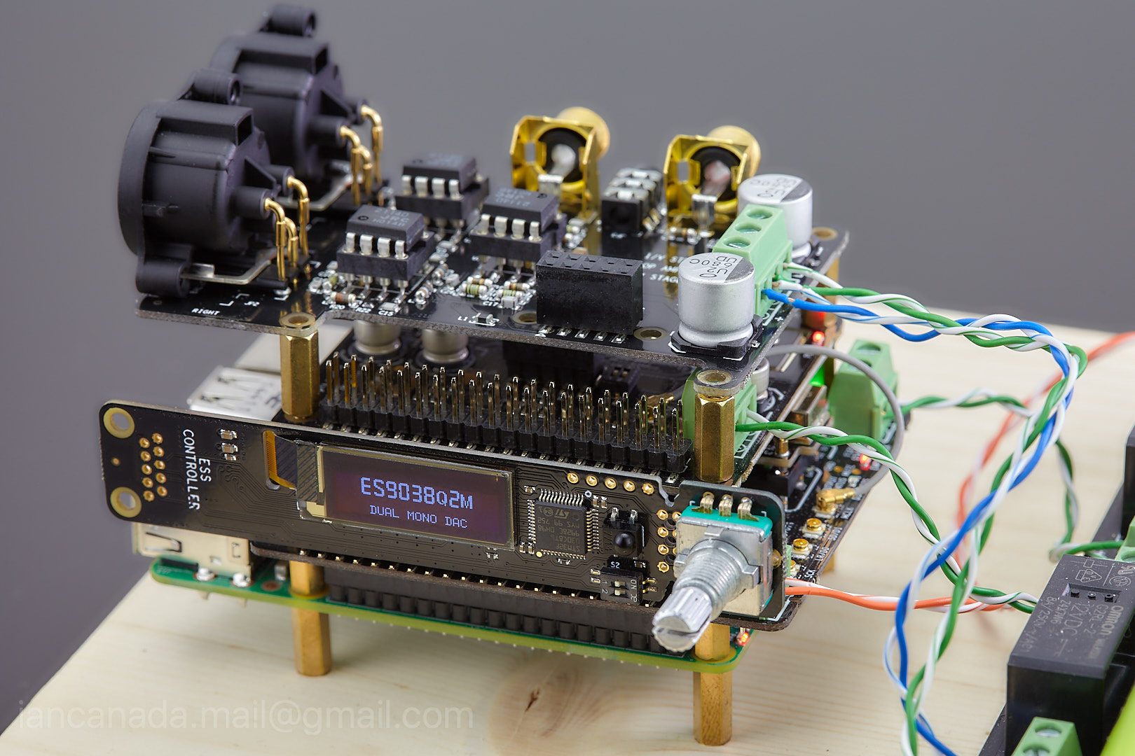

Thanks JT. There is a little controller/display board for the FifoPi Reclocker that you can't see in my picture. It faces the back panel! It is designed to be mounted remotely and controlled via an Apple remote. Never taken the time to design and fix it to the front panel yet.

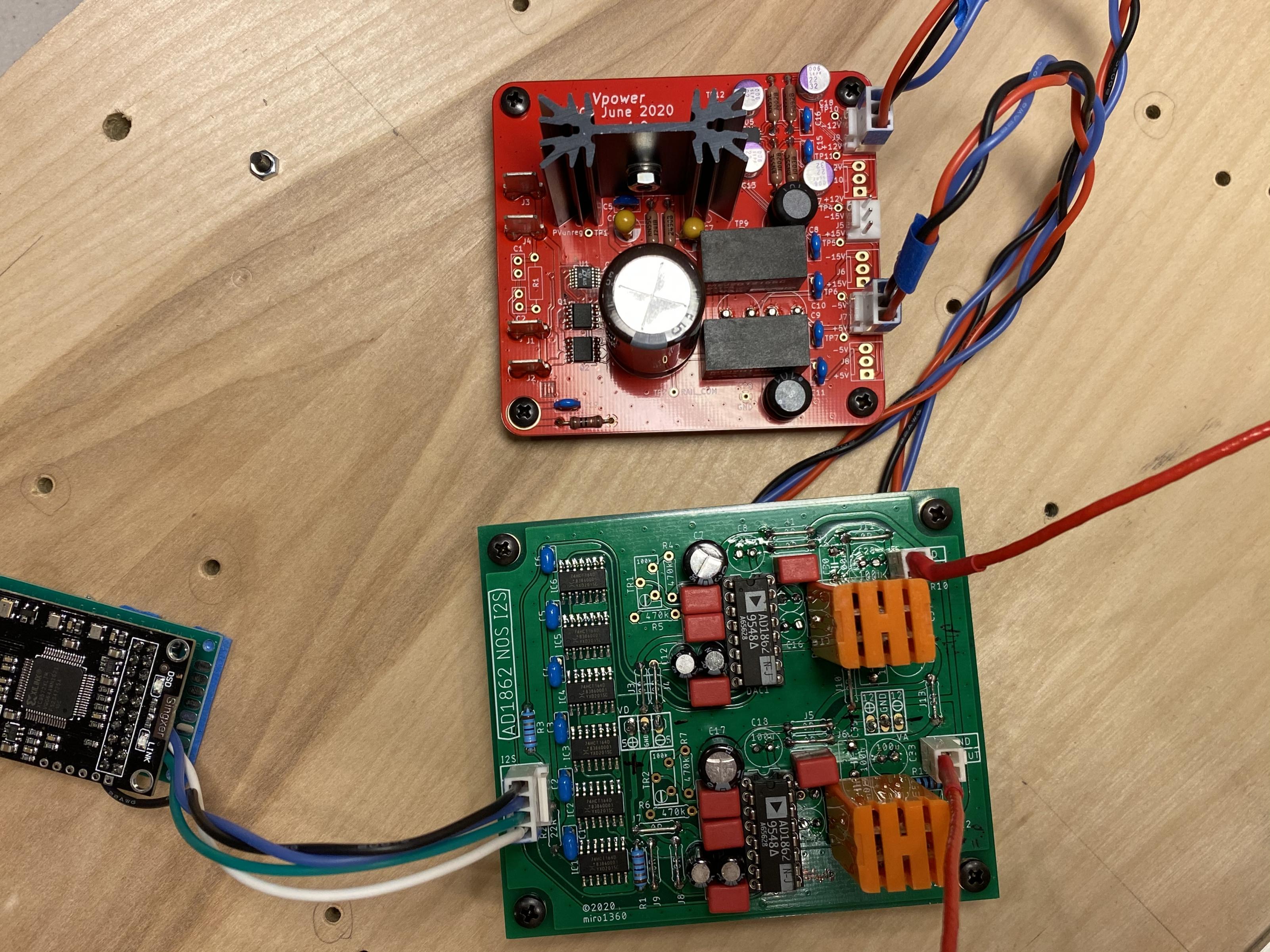

I’m keeping it simple and going with an old school R-2R AD1862 DAC chip in NOS mode. My application doesn’t require big time current draw, the Vpower psu would not be adequate for >200mA.
But, the pcb’s are small and a pair of them can be powered from a single 12v dual secondary trafo. I’m using one of the Talema’s (12v) we use in the Yarra psu.
