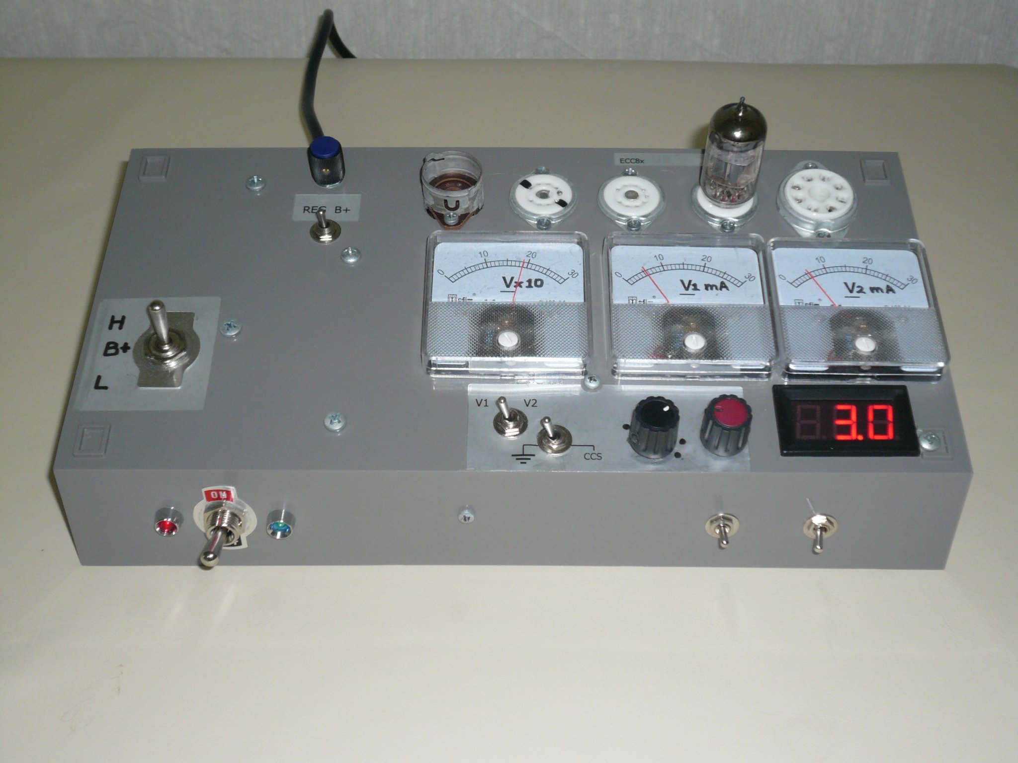

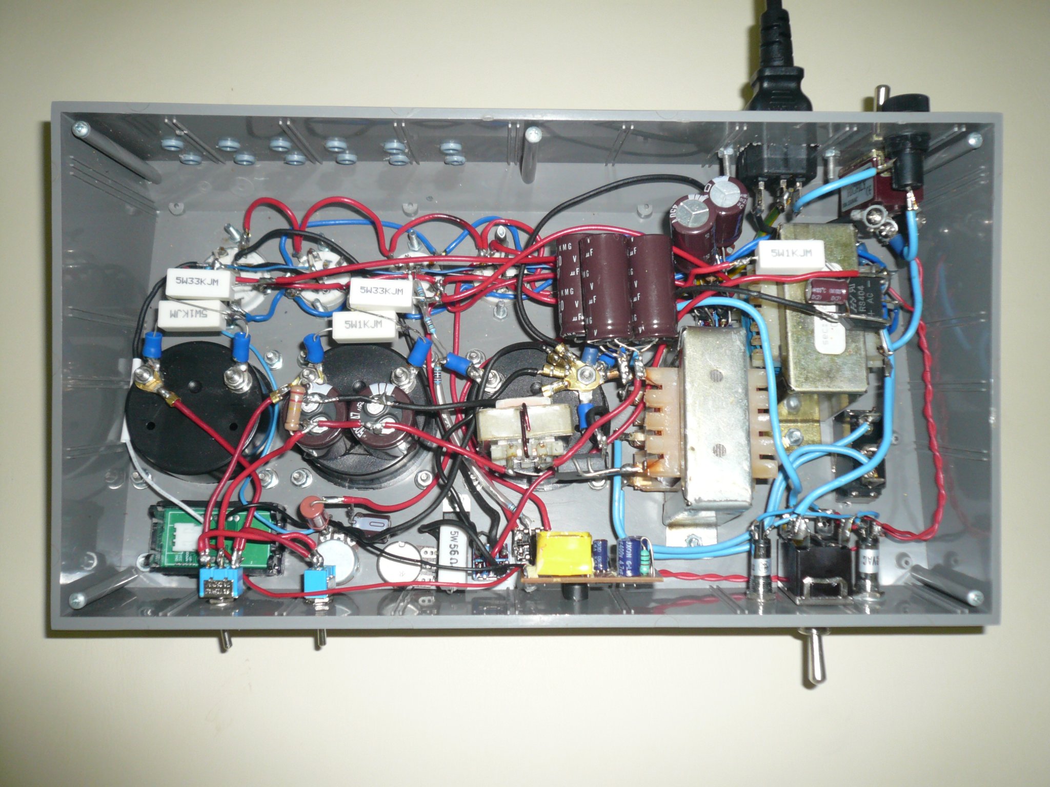

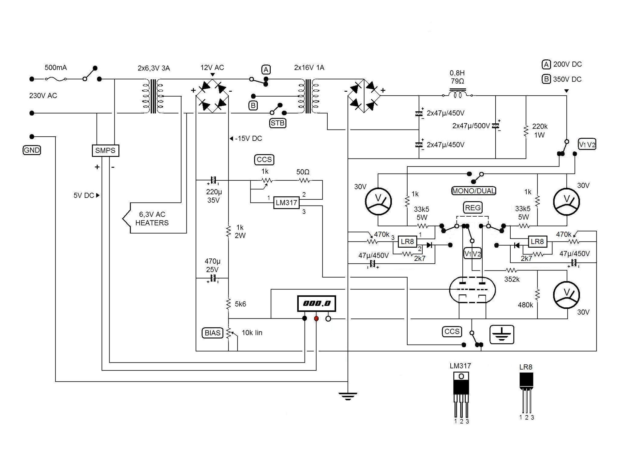

A few years ago I built a similar but simplified tube tester. It is made out of nothing and it can test only the most common types of small signal double triodes. I need to have the datasheet on hand and then verify if the tube is anywhere around the specs and if the two halves are matched. It can test at a few different operating points so I call it kind of "dynamic matching" within its limitations. With a lot of patience it can serve as a manual curve tracer as well. I always wanted to add signal output like the one discussed here. I might return to this some day.

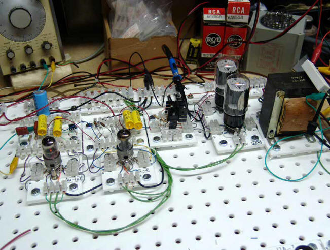

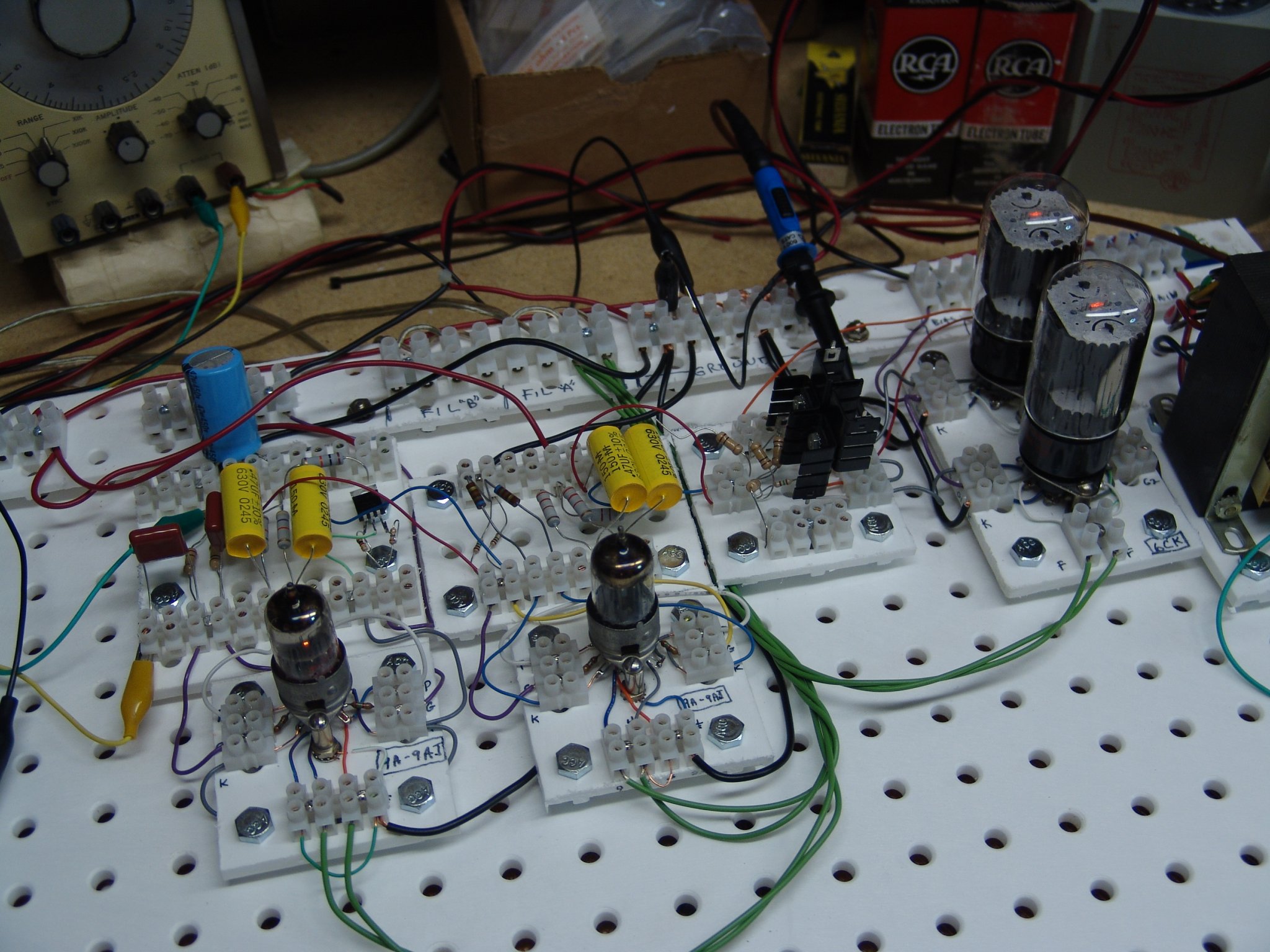

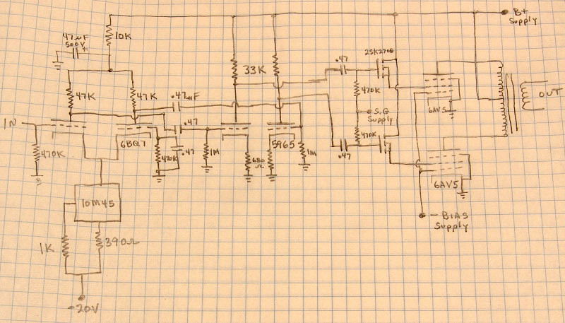

There have been several "tube labs" over the past 20 some years. All have been superseded by tubelab II or tubelab III or whatever since I always think up something better or different in some way. The "tube lab" has varied in purpose from something to test tubes and generate curves, to something that I can design amps on. I spent far too much time trying to build a better "tube lab" that it became my focus and in 2005, the name of my company. The picture in post #33 is of Tubelab III. It was not the third iteration, just the third one that I liked enough to use for an extended period of time. I used it to torture lots of different tubes in screen drive back in about 2005 - 2007. The amp on Tubelab III at the time of that picture is "screen drive 800." I have no idea of where that name came from except maybe the fact that it made 80 watts of power.
I found a picture that is zoomed in a bit more so that the writing is legible. There was a box full of modules. Each module fit one or more of the popular JEDEC tube base / pinouts. This amp used two that can handle 9A (12AX7 and similar) and 9AJ (6DJ8 6BQ7 etc) tubes and one that handled a pair of 6CK tubes (6AV5). Other modules held the individual components. This worked but having to screw down each wire, or bunch of wires took considerable time.
After 10 years of doing amp design on Tubelab III I got pretty good at just building an amp on perfboard and having it work well enough to start tweaking on so that the Tubelab prototyping system saw less and less use. When my 41 year engineering career at Motorola ended we packed up what we wanted to keep and sold, traded, or gave away what we didn't want, or didn't want to pay to move and store. Tubelab III was useful enough to me that I still have it, but the box full of modules got lost somewhere. We had to get out of Florida on three weeks notice, so lots of stuff got lost, or otherwise diverted from making the trip.
I have been waffling back and forth as to just how to "design" a new guitar amp since I sold or gave away two nice vintage rarities before leaving Florida due to their size and weight. Tube HiFi amps are a known technology, and the goal is generally clean good quality sound. Yes, there are many different opinions about that sound, but guitar amps are a different thing all together. Here we want some "dirt" in our not so clean sound, but not just any dirt, and the flavors are widely varied. I need some way to bend the circuit into multiple different contortions and vary nearly every component in it. guess what I dragged out of storage and cleaned up.

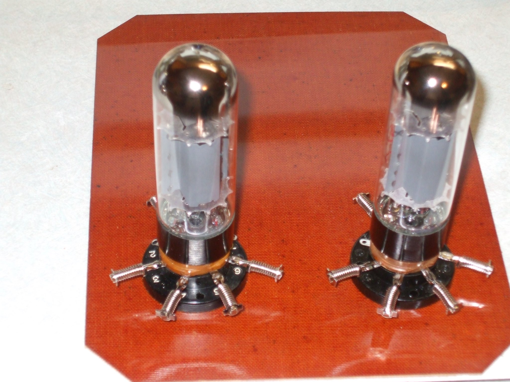

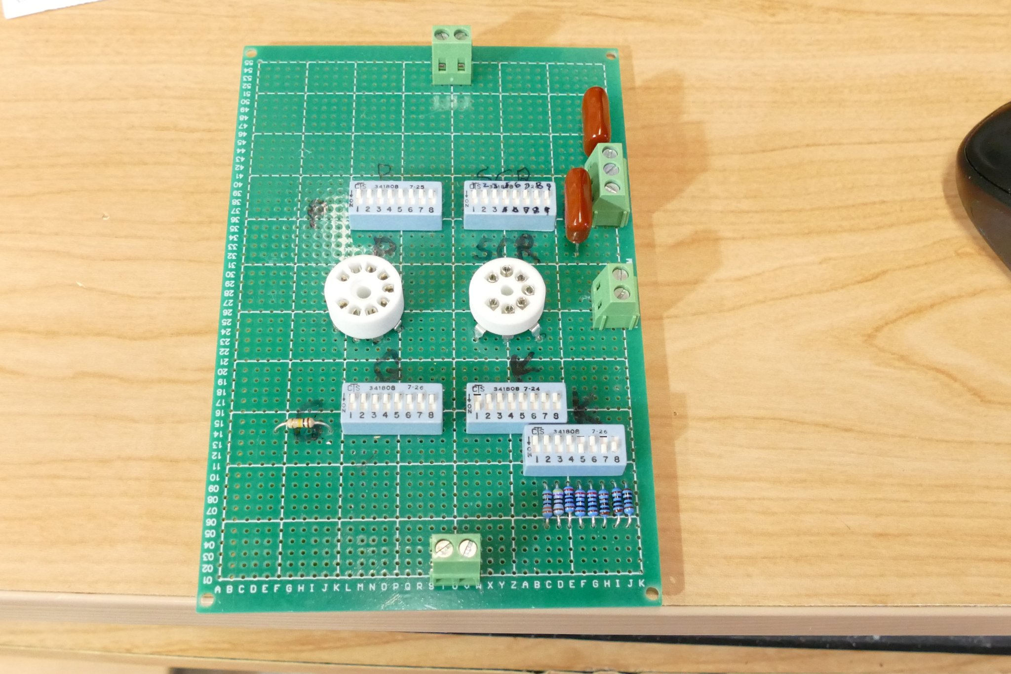

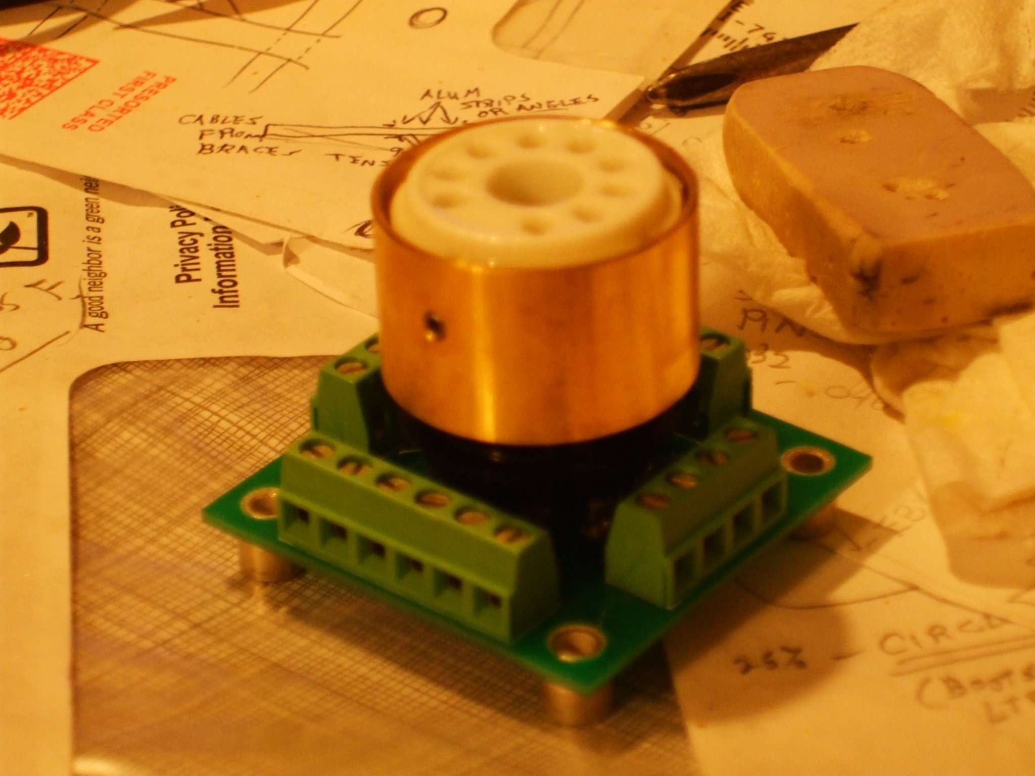

I made a protoboard "module" to see if it would work. This one can take a 7 or 9 pin miniature tube. The heaters are prewired to both sockets, but the cathode, G1, G2, and plate terminals on the board go to DIP switches to select the pin number. I also have a switch for selecting the cathode resistor value, or bypassing it for power supply curve tracing. Obviously use of a system like this requires some thought since random switch flipping can blow stuff up. It is possible to route the plate voltage back into your function generator just by setting the plate and control grids to the same pin number, so plugging the grid cable into a meter before plugging it into the function generator is a good idea.
I am currently laying out PC boards for this generic DIP switch board, and for all of the individual stages of a guitar amp. Pentode gain stage, triode gain stage, tone stack, etc.

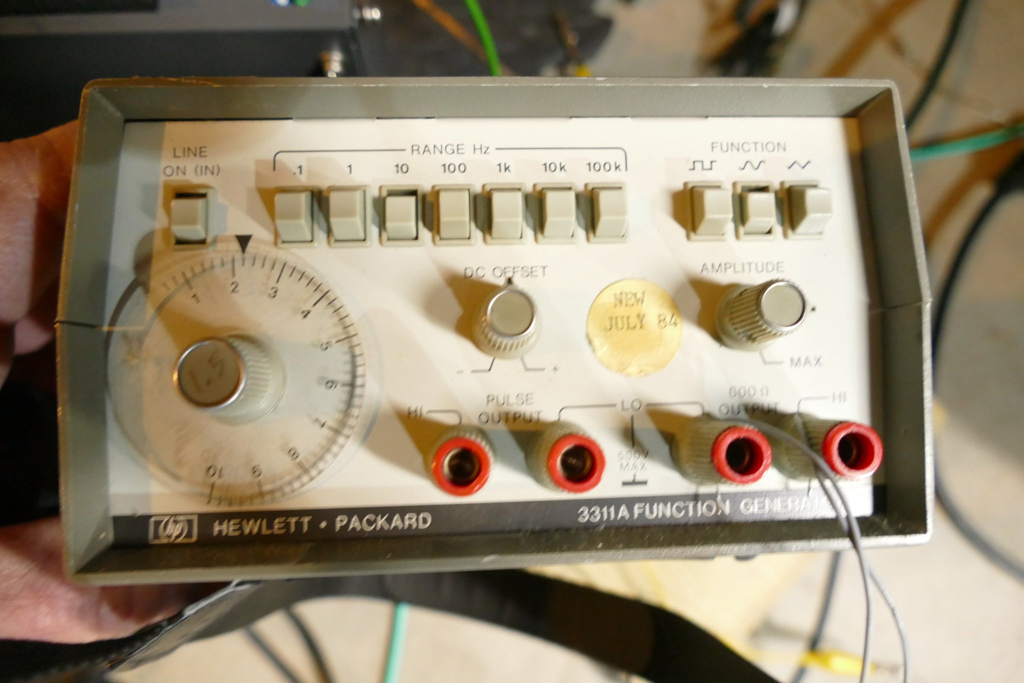

I use a HP3311A function generator that I got cheap at a hamfest and fixed. it can output a triangle, square, or sine wave with an adjustable DC offset. Feed this into the grid terminal of a test board, put a power supply on G2, and a power supply and load resistor or OPT combo on the plate terminal, and find your tube's sweet spot by turning knobs. I have been doing it this way in some variation for as long as I can remember. Load lines have their place, but they really only work on the tubes you see in the tube manual, not the ones in your stash, or circuit.
Remember that OPT's don't have a fixed value like 6600 ohms to 8 ohms. They have a ratio that works over a pretty wide range at 1 KHz. So that 6600 ohm to 8 ohm OPT is also a 3300 ohm to 4 ohm OPT and a 13200 ohm to 16 ohm OPT. You don't need a box full of OPT's, you need a couple and a load bank that goes from about 2 ohms to about 18 ohms in 0.1 ohm steps.

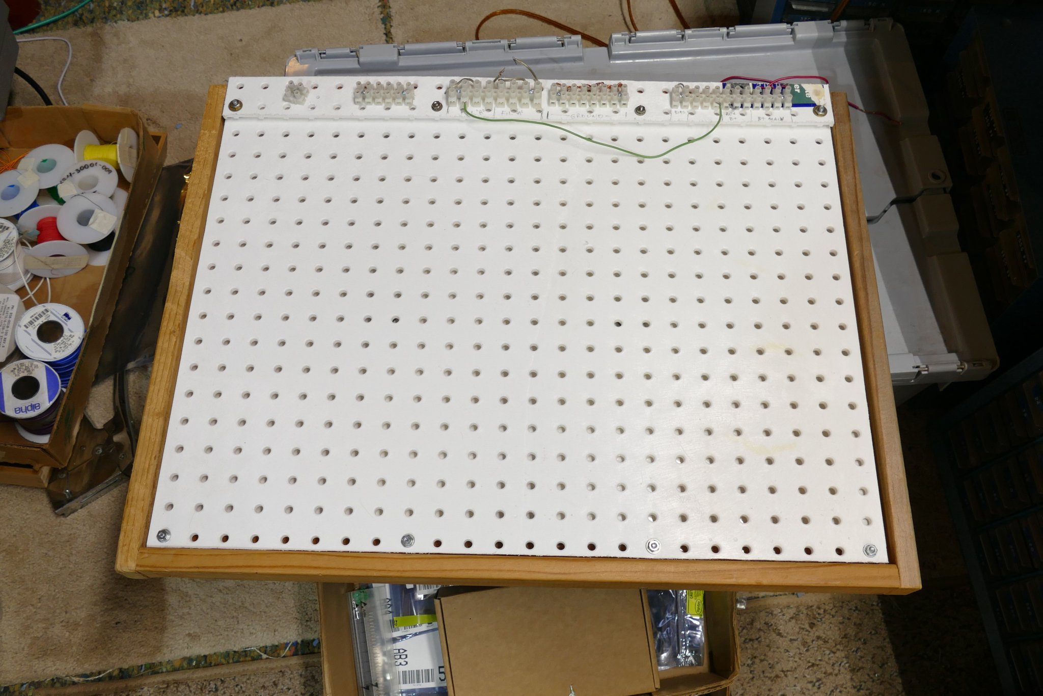

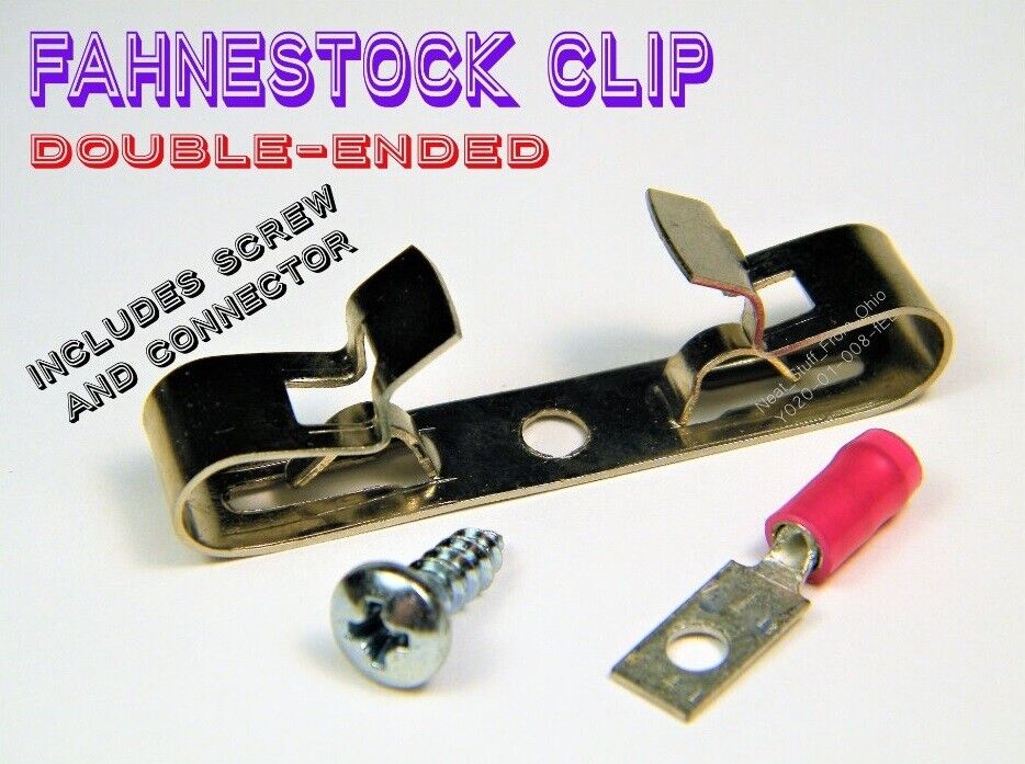

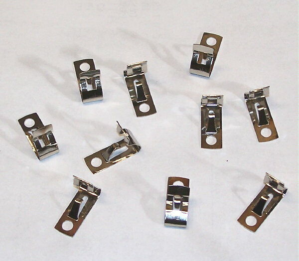

Fahnestock clips, Vector T30 pins, surface mount tube sockets, tube prototyping sockets
I mount Fahnestock clips under the 4 corner screws of the tube prototyping boards, T30 terminals can also be pushed into the corner holes with an insulating sleeve. (for the bigger sockets I drilled a center hole, so a single woodscrew can hold the whole socket assembly down to the wood base)

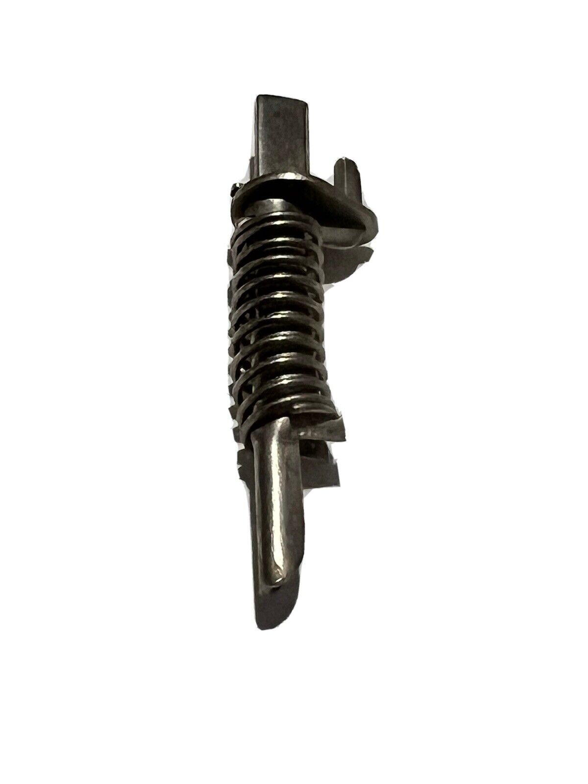

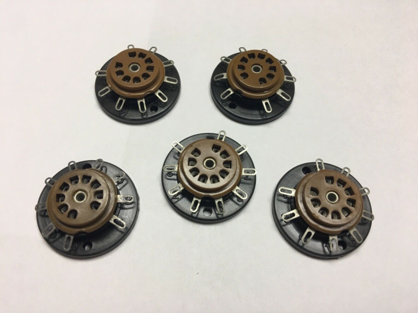

I assume that those top secret T30 spring thingies are the "push down, stick the component wire through the hole" type? If so, can you fit more than one wire in at a time? I can't find any info about them on the internet.
I got some of those spring only thingies like found in the older Radio Shack 50 in one electronics experimenter's kits from Maker Trading Post in Ohio. I may use them, but they can be a challenge with multiple wires and numb fingers.
Yep, multiple wires fit into a long strip-like hole. Just push down the spring to insert wires, then release. A fairly stiff spring. "Vector T30" will bring up bags of them on Ebay. Unfortunately they're NOT insulated. Kind of a mouse trap for wandering fingers, arrayed out on those sockets. The "surface mount" tube sockets aren't easy to find any more, used to find bags of 10 of them. There don't appear to have ever been any Compactron or Novar versions. The Octal, Nine and Seven pin ones may still show up occasionally, but individual ones are way too overpriced. Probably could make some facsimiles from regular sockets. The tube prototyping sockets on small PC boards with screw terminal strips are a bit pricey too. But much safer! Could be useful to make small PC boards with the T30 terminals around the socket. Not sure the PC foils would stand up to repeated spring depressions or clumsy side-ways pressure. Maybe working with a double-sided PC board with soldering on both sides.
