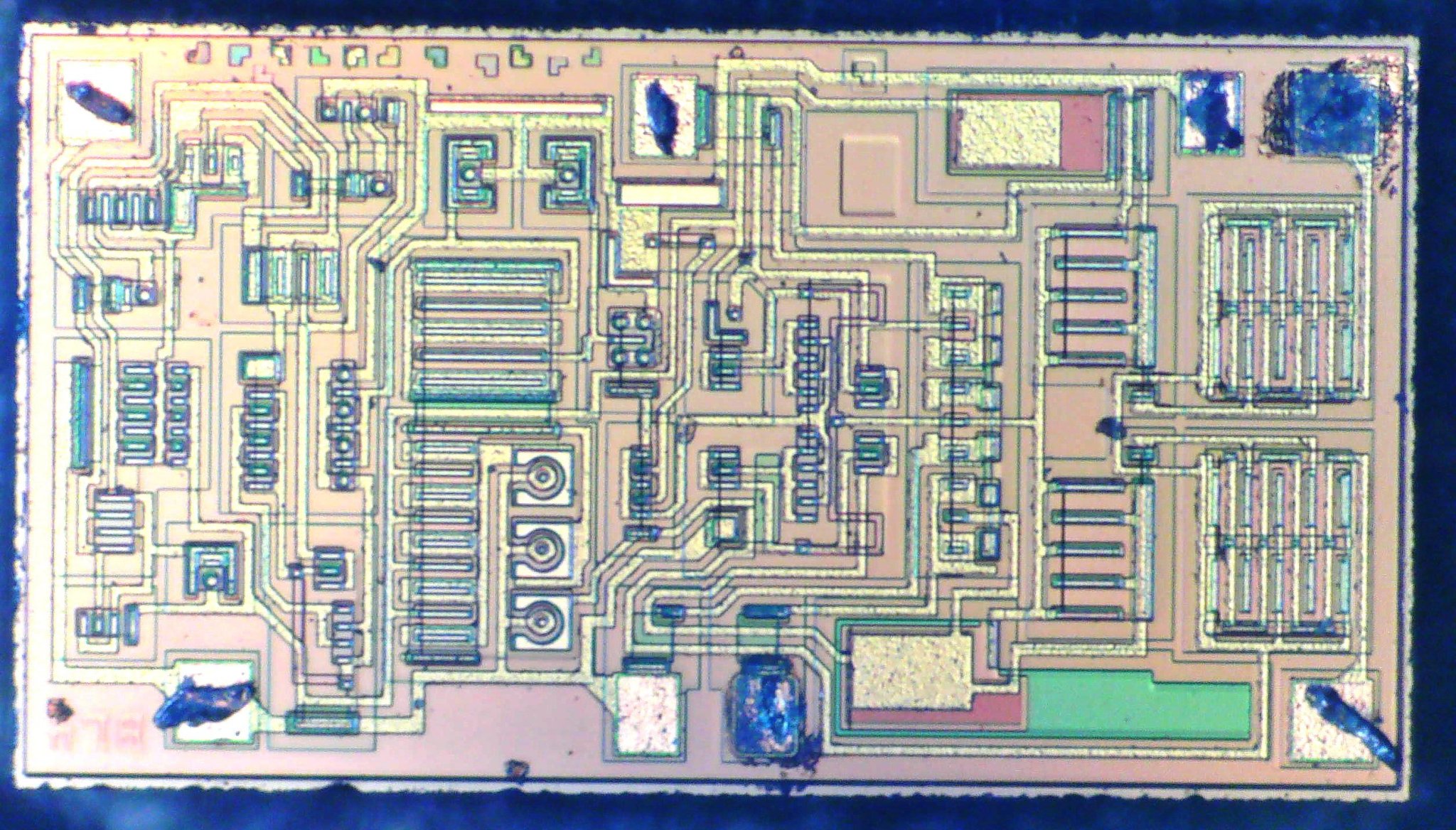

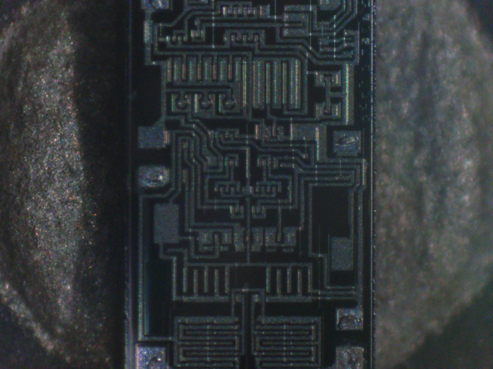

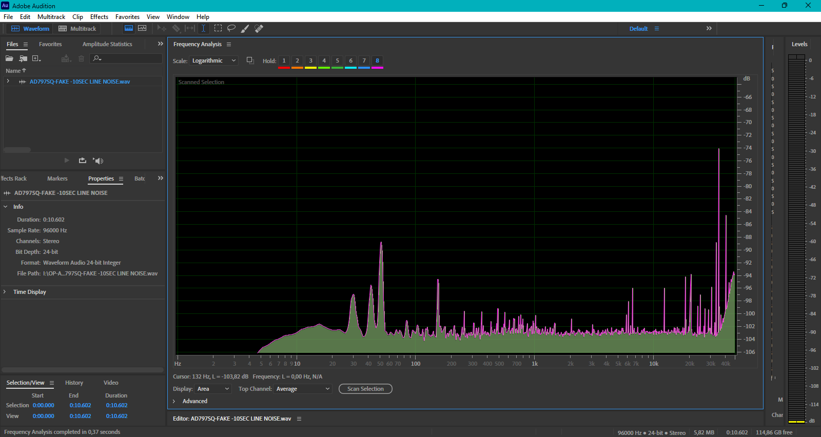

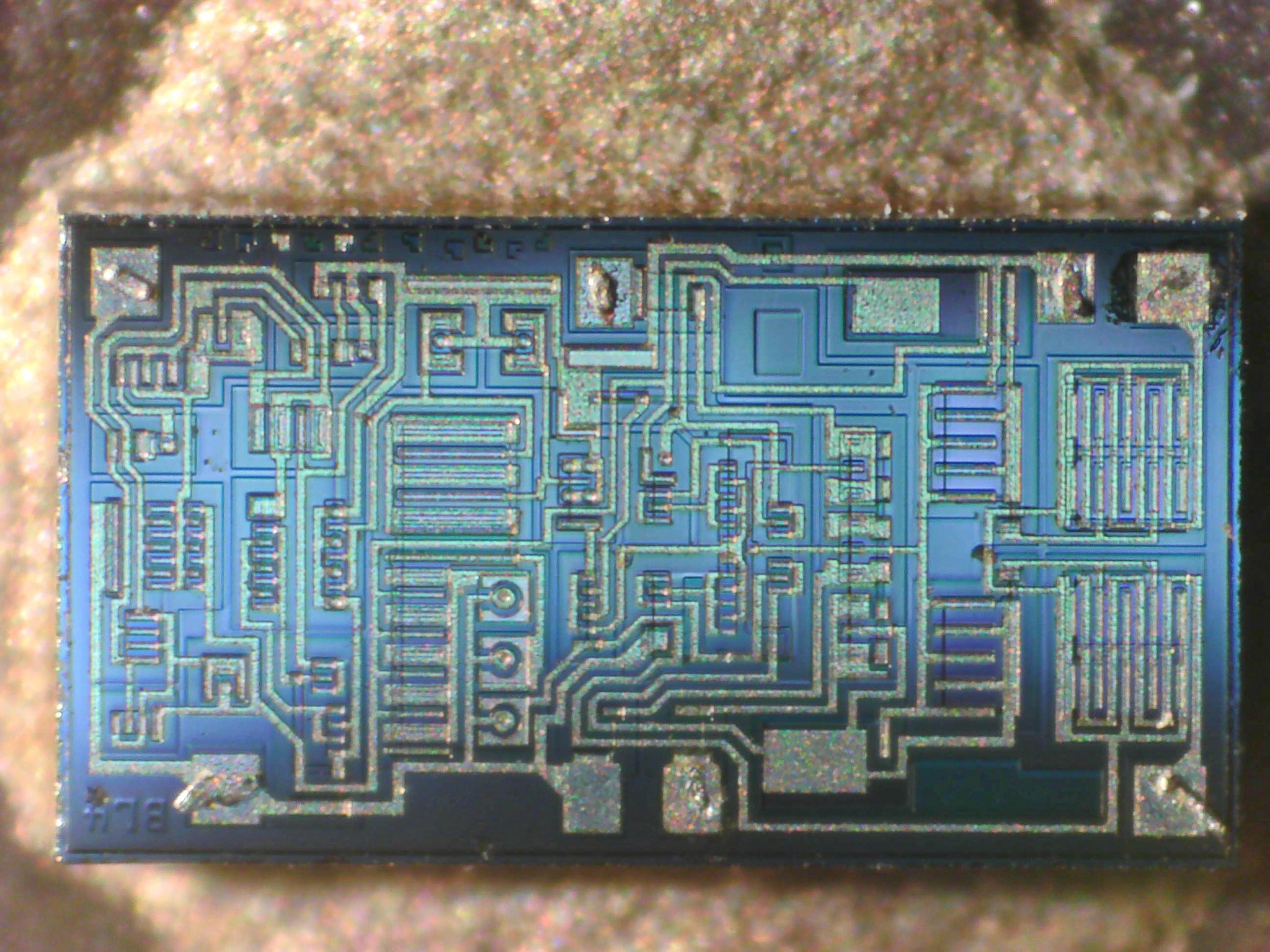

Greetings everyone,

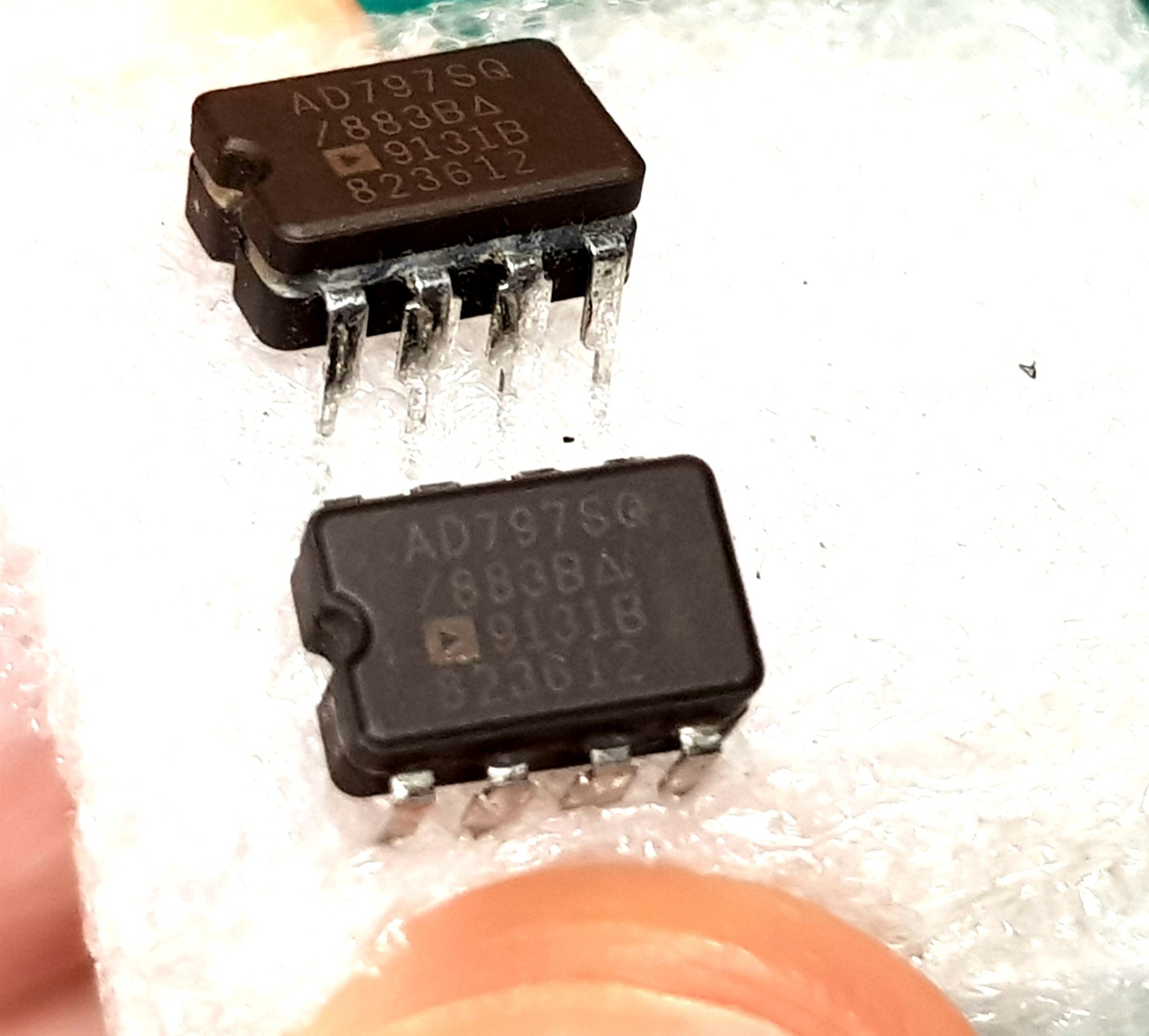

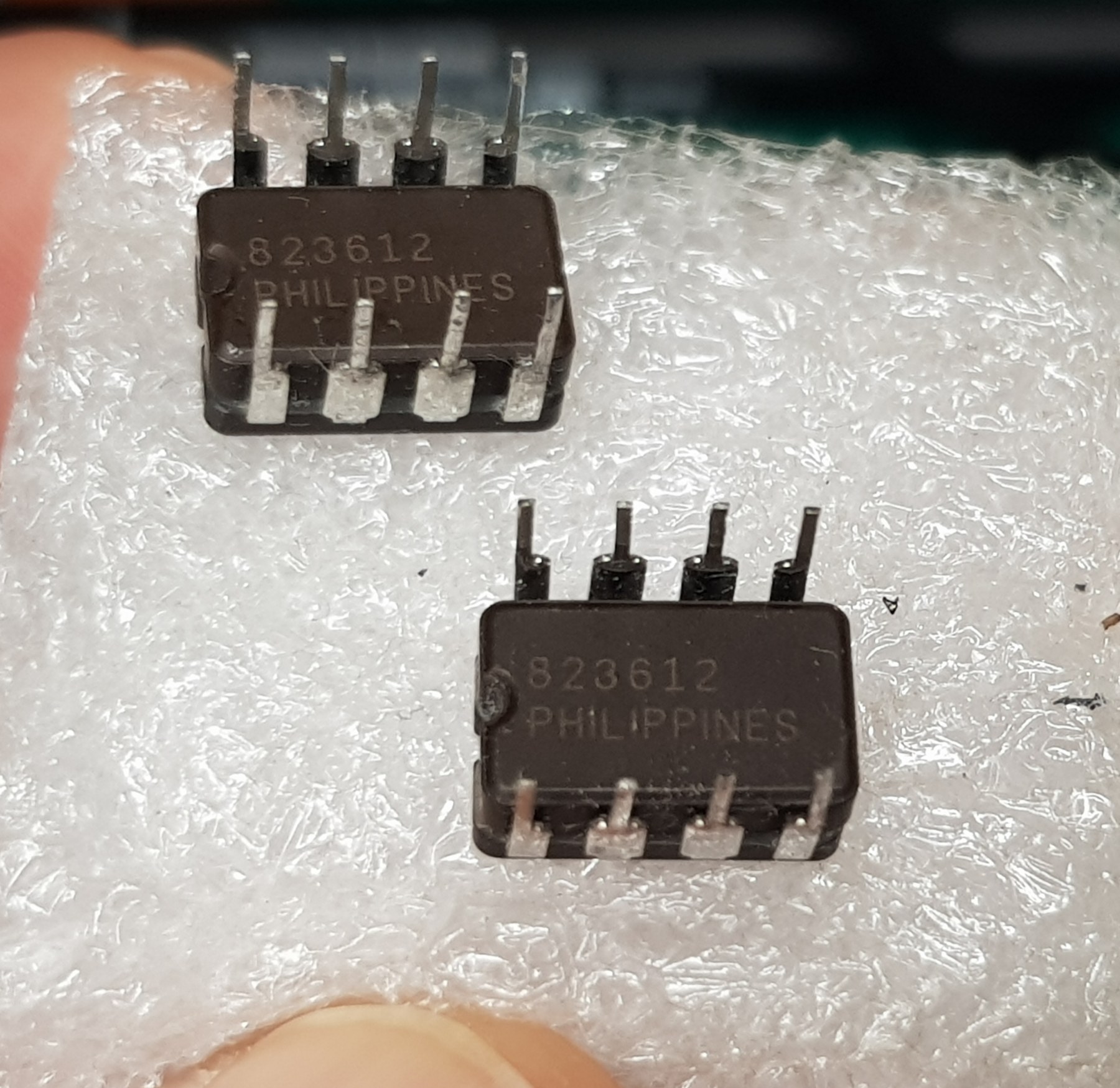

I must confess, I couldn't resist the temptation to acquire the ceramic DIP8 SQ version of the AD797 Op. Amp for merely ~$4-5, especially when faced with a seller on Ali-express boasting 1001 positive reviews, claiming it's "exactly what is being sold" and so forth. Indeed, two op-amps arrived, impeccably polished in their ceramic SQ packaging, with engravings that appeared as original, complete with the Philippines or Malaysia listed as the country of manufacture on the back, along with all the minor details that match some of my old and guaranteed original AQ and SQ versions of the AD846/843, etc.
Upon initial listening, the OP. Amp "sounded OK" until I began testing its noise level and response speed, i.e., the rise and fall times of a square signal (Tr/Tf). Perhaps the Rise/Fall time might have misled me (the original is 20V/us) with about ~12-15V/us, but the noise level indicated it was a decidedly mediocre op-amp.
My suspicions of it being counterfeit were aroused since it was supposed to be identical or superior to the LT1028, OPA1611, and OPA1612, yet it fell between the NE5532 and TL072. Through measuring characteristics such as resistance, etc., I deduced it resembled something along the lines of the LF356/411. This assumption remained until, during the soldering of the pins, I accidentally sprayed cooling spray (intended for cleaning) on the hot ceramic casing, causing it to crack open and reveal the IC's die.

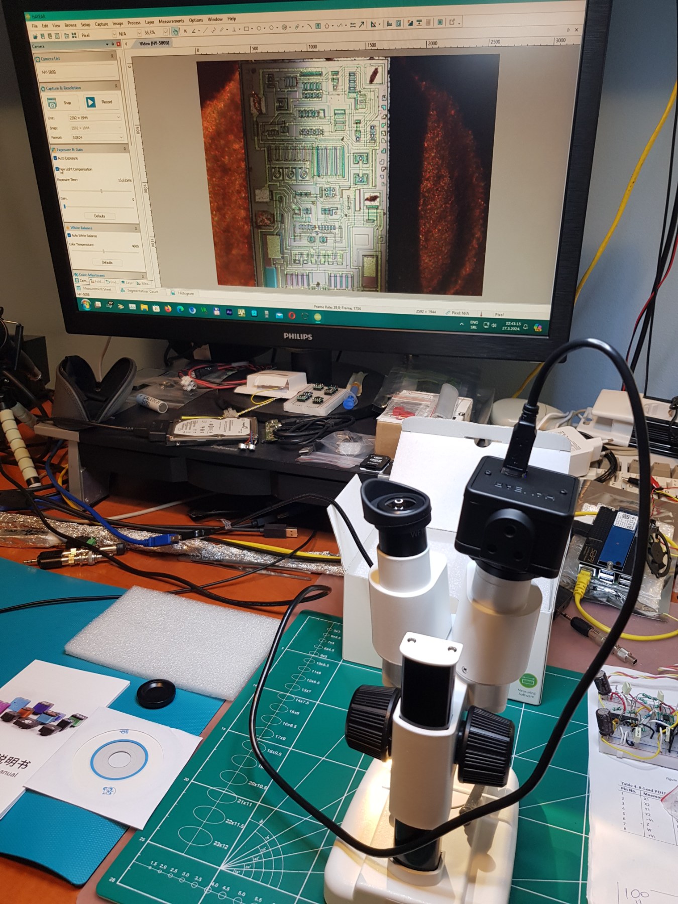

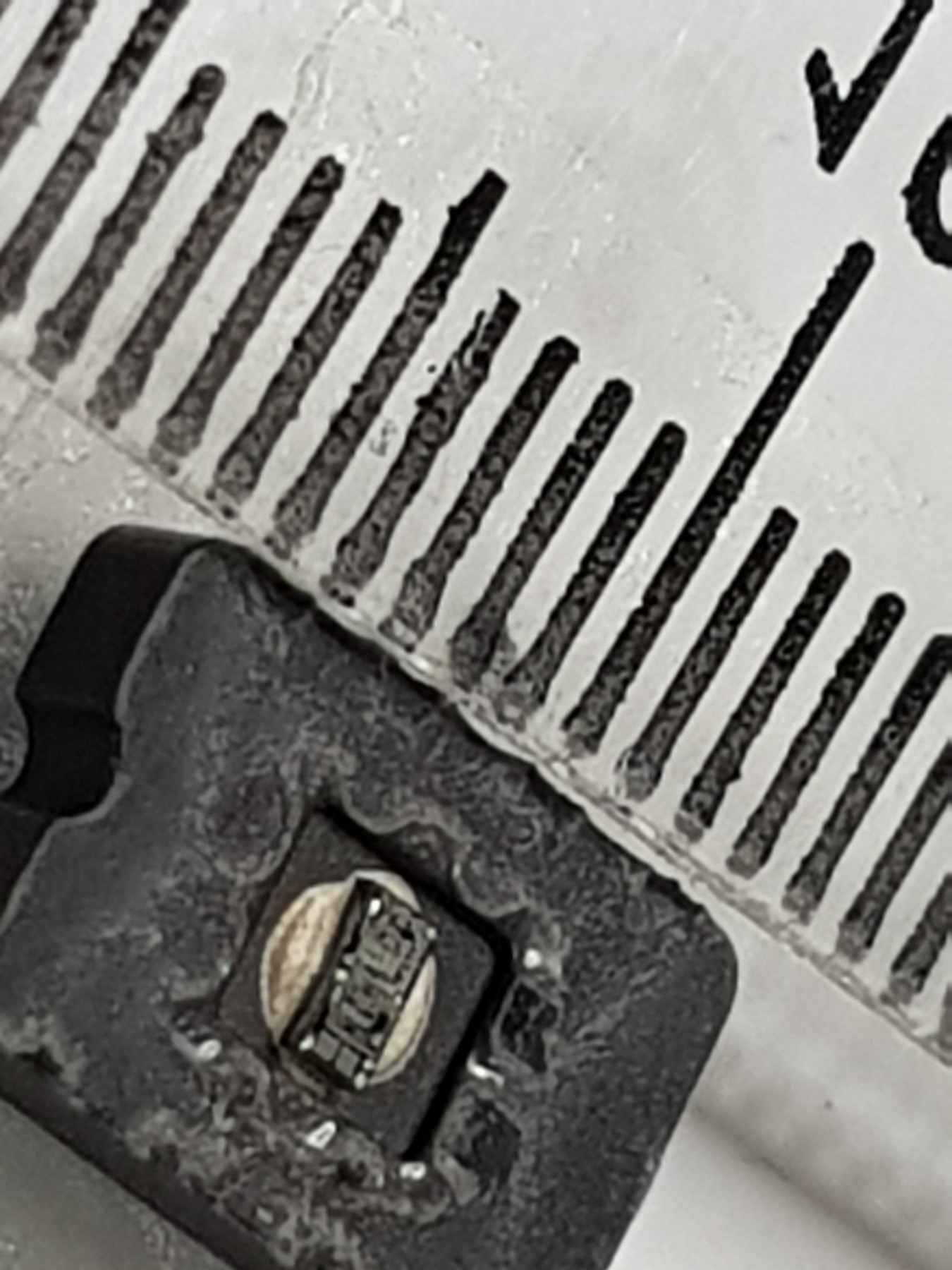

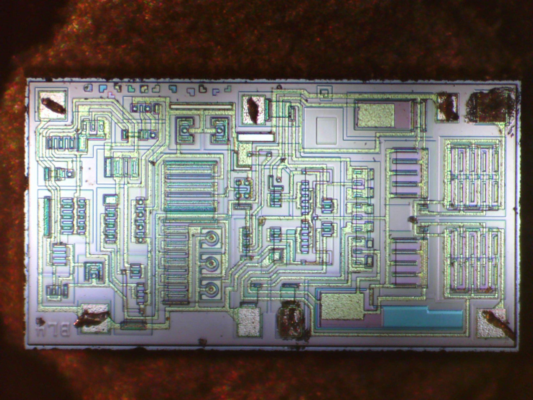

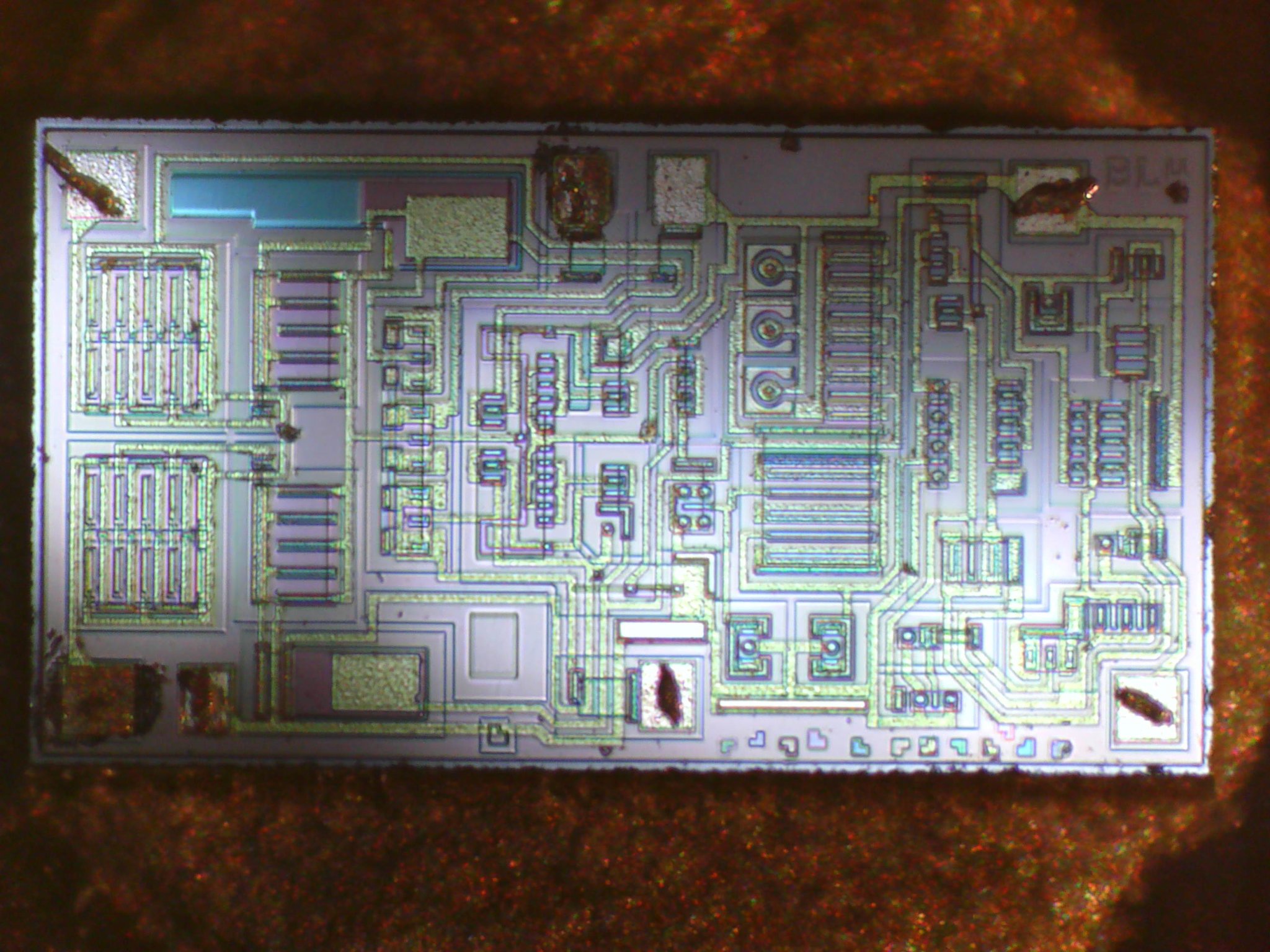

Now, after a couple of years, having finally acquired a 5MP CCD microscopic camera and a better (though still juvenile) AOMEKIE 20x stereo microscope, I can share with you the appearance of the IC Die, which by design, closely resembles (99%) the LF356/357, with the only question being the exact model.
Hence, we can conclude that the mystery is solved depending on the response speed of the Op.amp you've purchased; you've gotten either an LF355, LF356, or LF357, the question remains whether you bought the metal canister TO-CAN and ceramic, or if you opted for the plastic DIP, then you've indeed incurred a loss
In any case, there's no trace of the 1nV/sqrHz, instead expect 12..20nV/sqrHz, which is up to 20 times higher, equating to +26dB for a higher noise threshold. Also, forget about the GBW of 110MHz since the LF356/357 equivalent has a GBW around 5 to 20MHz.
It was an apparent scam that I, too, fell for, so if you see any comment of mine on the seller's website, please disregard it as it cannot be withdrawn retrospectively.
Attached are the spectral image with a 50 Ohm terminated input at Av1 and the appearance of the IC Die.
Best regards,
Dr. Jovan Ivković
