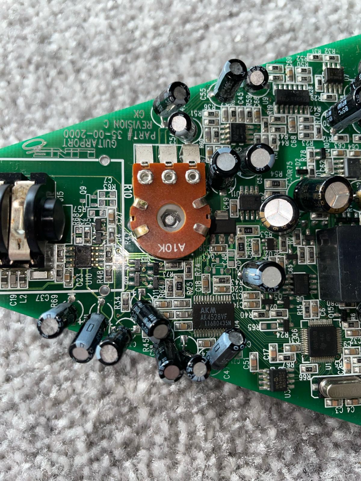

So while I'm waiting for the op-amp to arrive and in the interest of sharing my ongoing experimenting and investigation with these interfaces, I've dismantled the Line6 Toneport UX2, which is an interface from the same series released a few years after the GuitarPort. The Toneport was pitched as a more upmarket recording interface and their target audience was a home studio, whereas the GuitarPort was always pitched as simply a practice tool.
The Toneport has
Dual XLR + Phantom Power
Twin Jack Input, one is padded.
VU Meters.
and some other bits and bobs that aren't included with the GuitarPort.
However, both are compatible with the same archaic Gearbox software supplied by Line6 and the patches can be shared seamlessly between the GuitarPort, TonePort and other Pod models that were released during that period.... which means I would hazard a guess that they contain the same DSP but may different amp chips? Most people don't use Gearbox anymore other than for practice. For recording, there's better guitar VST's (Guitar Rig etc).
So this is the Toneport guts'n'all.
Admittedly, I don't know where I'm looking on this board and there's a lot more components, but:
Next to the two XLR's there are
2x C082C
slightly below that is a
TL074C
140528G
In the middle, there's a AK4528VF.
And sure enough, next to the two guitar inputs is another TL072C which I find quite interesting. I'm not saying that chip alone will make or break the sound quality, but they definitely pitched these two products towards difference audiences while many of the components appear to be shared... at least from my entirely n00b'esque understanding.
There's a cluster of IC's in the middle, but I think they may be more towards the USB side of things? No idea though.
For reference, here's the full GuitarPort PB. Lots of similarity!

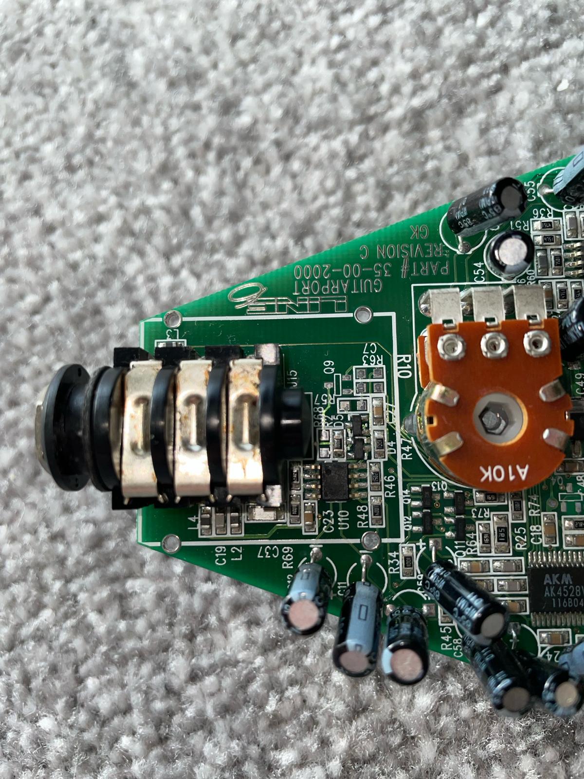

Got bored, so I cracked on. Job done! I'd say if anyone is reading this and interested in having a crack themselves, it's probably somewhere in the region of intermediate difficulty wise. although I was mildly rusty with my SMD rework skills as it's been a good 2 years since I did an ECU, so it was a good thing I worked on the new amp chip first just to get my hand steady again. As always, it comes down to the prep. Plenty of kapton tape to protect the surrounding components as recommended by @NIXIE62, just the right amount of flux and just keeping a steady hand Take time!
As there was nothing to sweep, I took a relatively high air flow and moderate temp (350 i think?) to scavenge me an OPA1642 from it's adapter board
Easy work.
There are a good four or five components in the vicinity of the IC that you want to be wary of. There are about 4 resistors and a little ceramic cap, all of which need plenty of protection, so I used a good amount of tape, dropped the airflow to avoid sweeping them off and bumped up the temperature to about 380, which is a little higher than I would usually go but seemed to do the job.
Adding the OPA1642 is the reverse. Pin 1 is the one nearest to the 1/4 jack so be mindful to put the bar at that end. I refreshed some of the kapton tape and just moved quickly. Quite often in my experience, when these reworks go wrong, time is the killer. Either you're flapping for too long and sweep a component or you burn one. I probably only had the air on it for no more than 20 seconds.
Job done.
First signs, I think it sounds loads brighter and way more dynamic. I would say you can hear more of the overtones coming through... but it may be a placebo in my head. Until I do a proper A/B test, I can't be sure, so I need to work something out. What do other people do for this kind of stuff? Is there a reference WAV file I can put through it or something?
If anyone else fancies a pop at this... these interfaces go for next to nothing as they're over 20 years old, yet have an incredible 2ms latency at 128bit with no pops or distortion.
Not bad eh?
