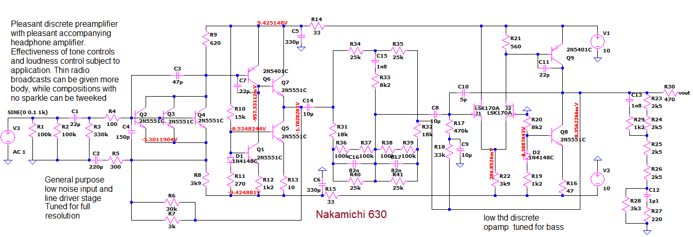

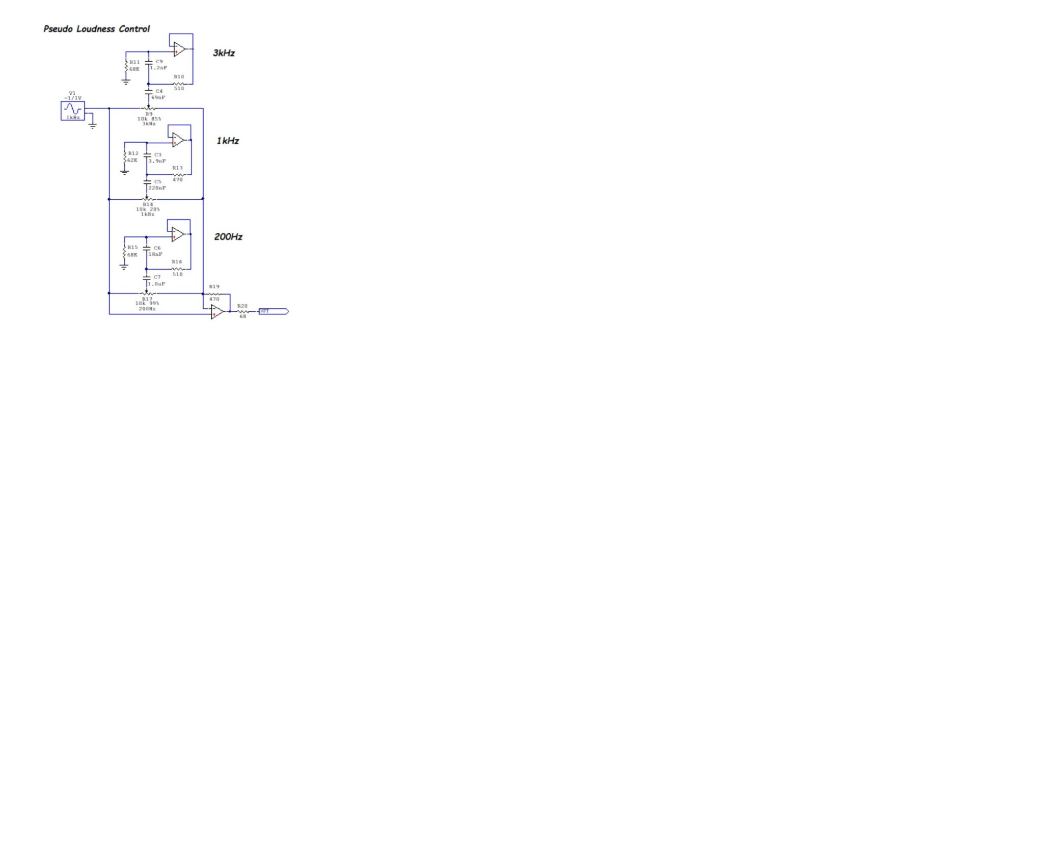

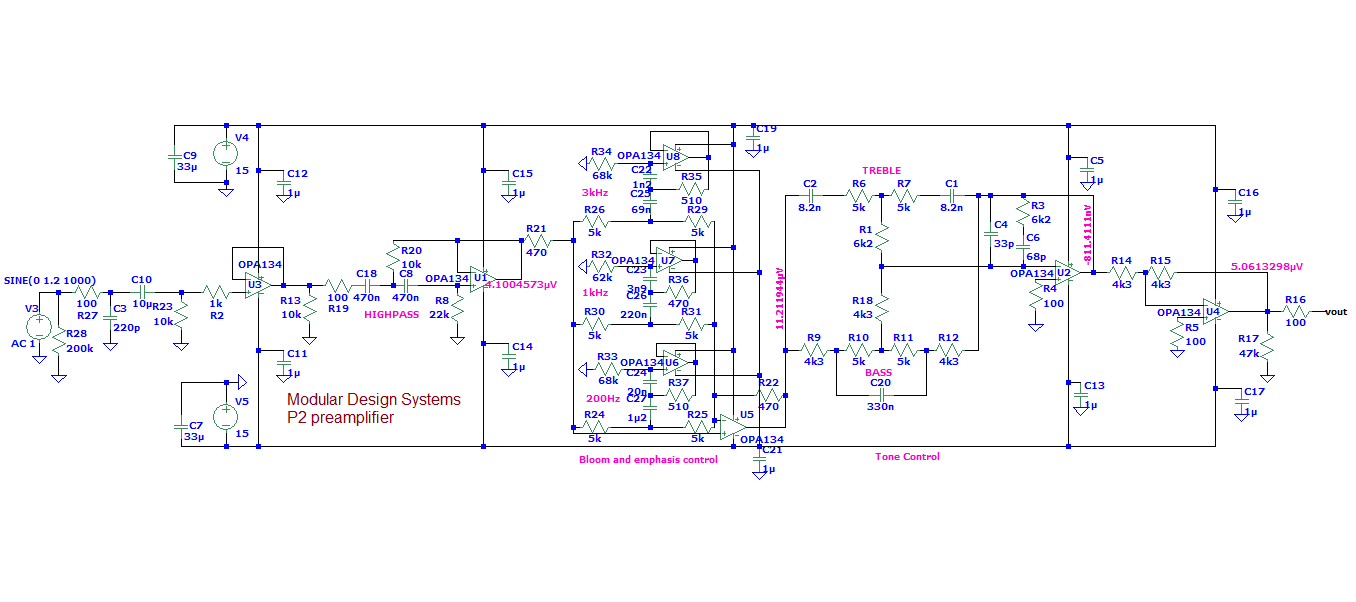

Thank you for posting those schematics. Could you please explain how your 'Bloom and emphasis control' works? It's obvious to me to realize that R6 an R7 make up a 10K linear pot but which are the adjustment pots in the bloom and emphasis section? You have posted an interesting circuit and I would like to better understand it.
OnAudio,

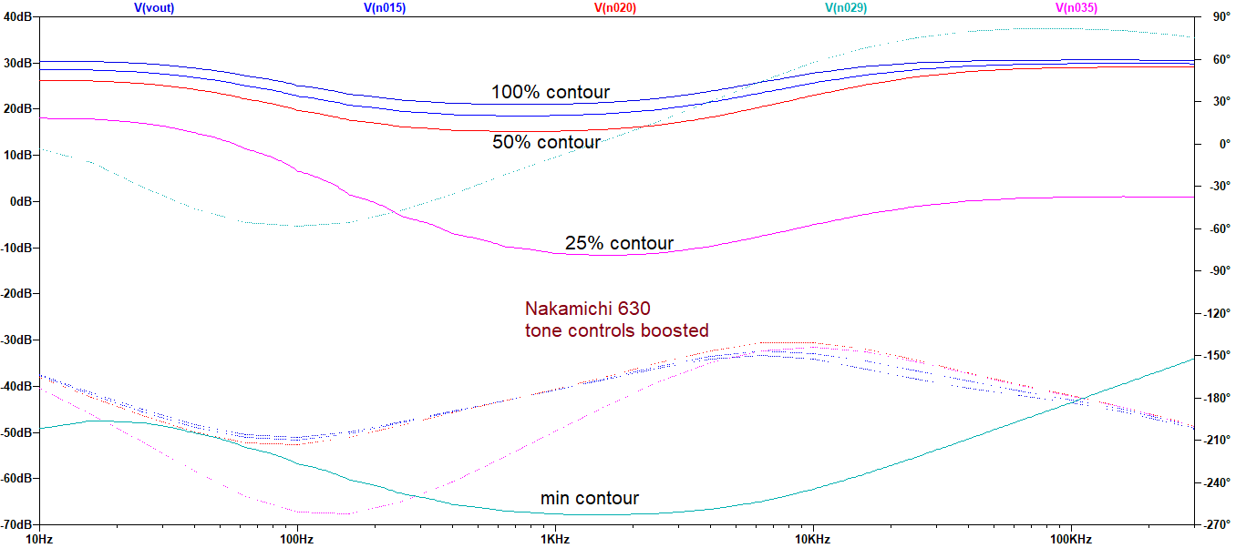

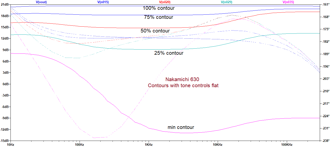

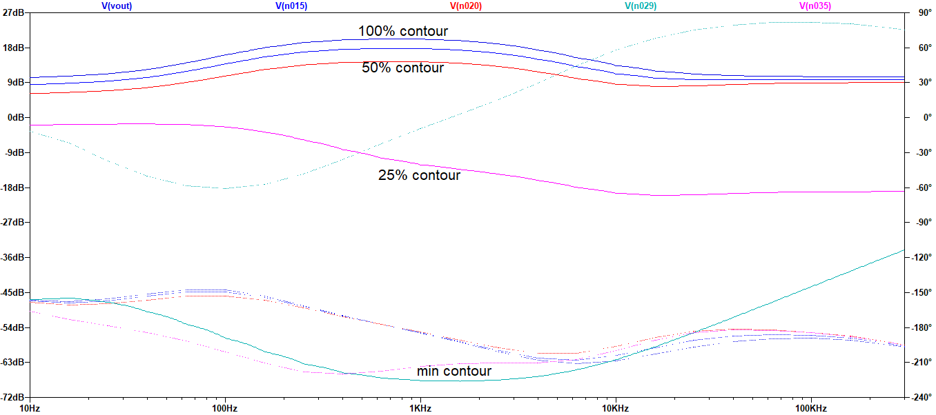

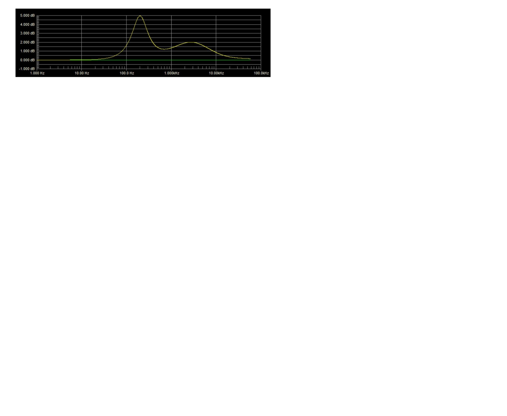

I copied your circuit into my aging copy of Circuit Maker so that i might better study it and 'twiddle' the knobs. It's a very interesting circuit that amounts to a pseudo loudness control. My results are shown below ...
Thanks your right. Your results are correct.OnAudio,
After studying your circuit are R26 & R29, R30 & R31 and R24 & R25 in fact adjustable pots?
If yes, I have a better clue as to how your circuit works.
