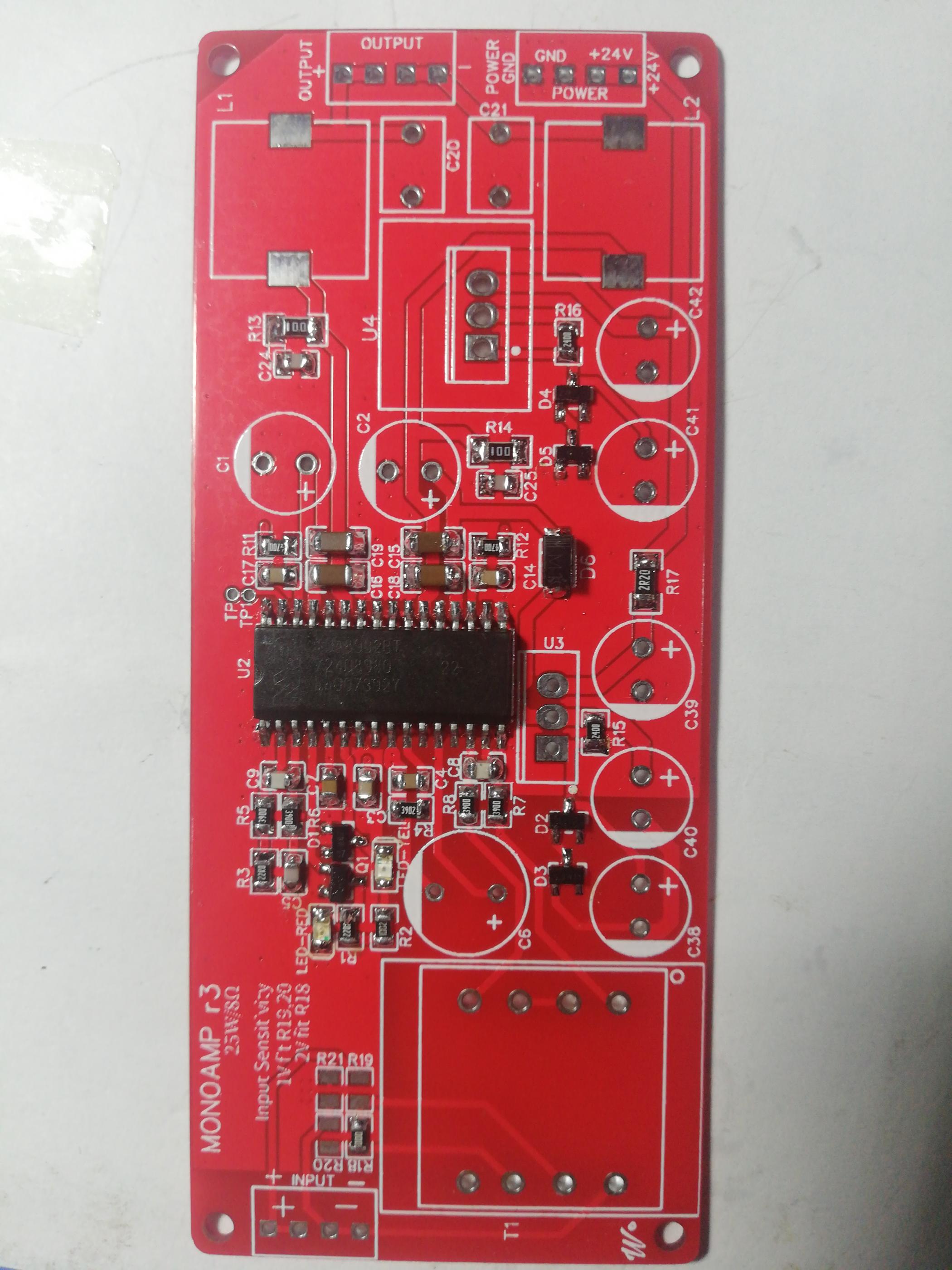

We are at present only selling amp kits in multiples of two. Kits contain all the parts you need to build 2 off mono amps, excluding power supply. Most of the parts are SMD, the smallest are 0805. If you've only done conventional (through-hole) soldering before this kit could be a handy introduction into surface mount tech. The trickiest part to solder is the TDA8932 itself, it has 32pins on a 1.27mm pitch.

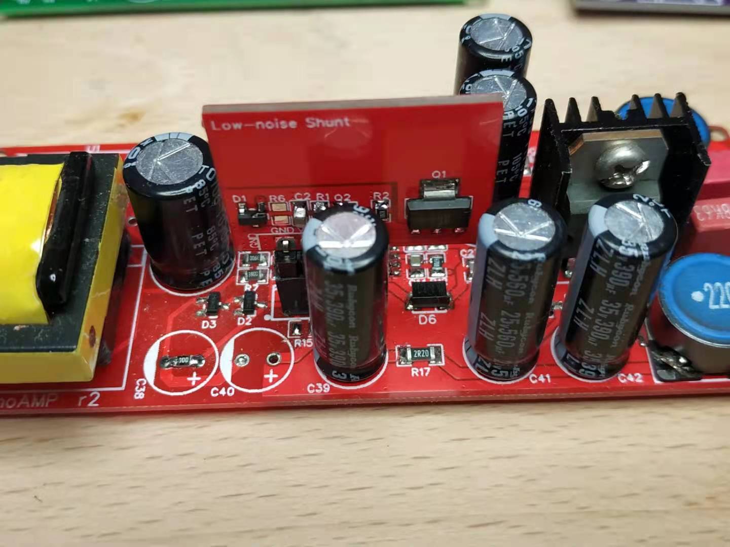

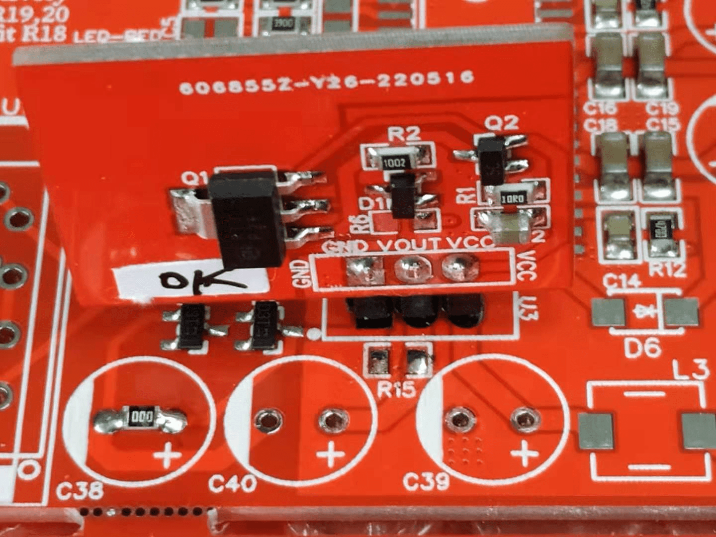

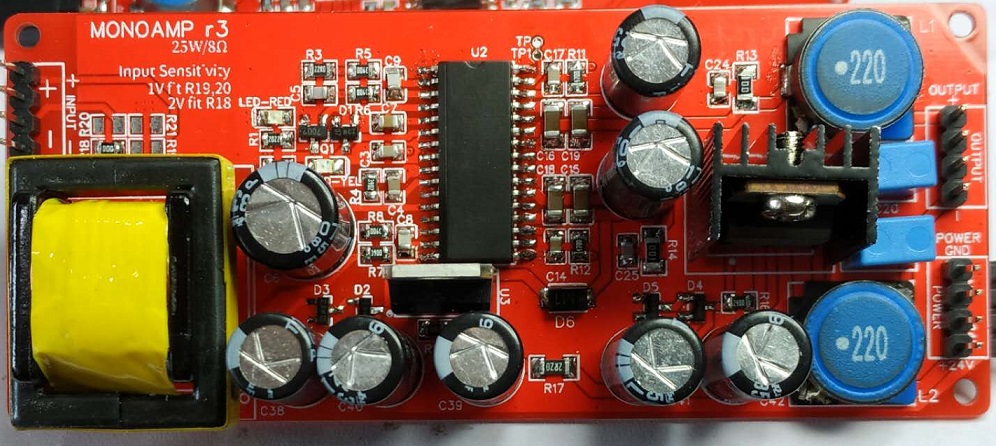

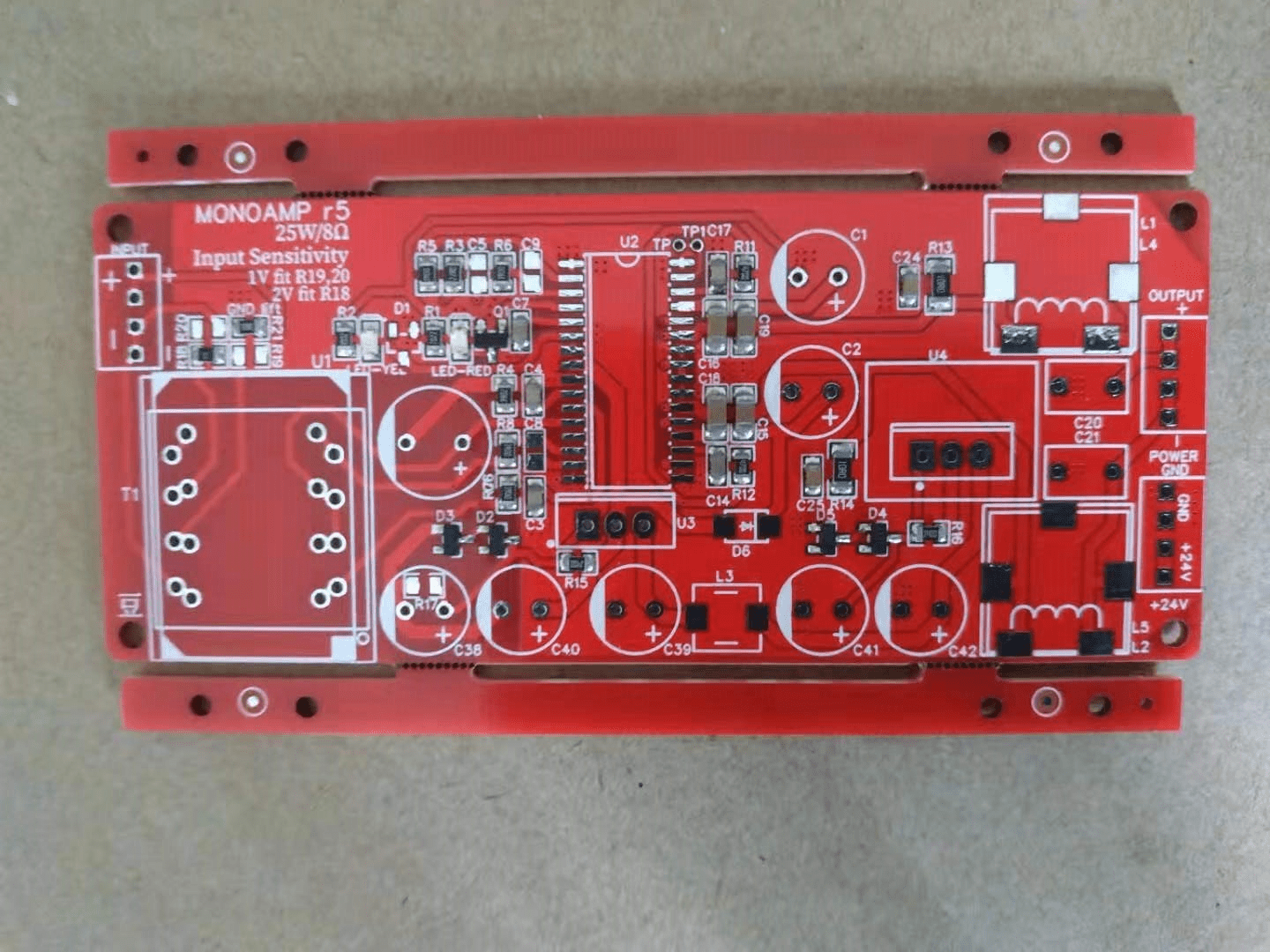

<Update Aug 2022>
The PCB is up to rev5 now and accommodates a few options:
a) You can fit a low-noise shunt regulator board in place of U3 (a three-terminal regulator, either LM317 or LM350). To use the shunt you'll need to solder a 0R resistor for R17 and remove R15. C38 isn't fitted when the shunt is used.
b) The transformer footprint accepts a 20k:600R centre-tapped EE25 transformer from Taobao/Aliexpress in place of our custom trafo. https://www.aliexpress.com/item/2251832717562057.html. The reason for choosing this trafo over the stock one is so you can couple to it with a 10X lower value cap due to its much higher primary inductance. It also increases the gain of the amp by about 4dB.
c) Coilcraft flat-wire output inductors can be fitted, part number SER1390-223
Old (prior to Aug '22) shunt orientation (earlier PCB revision but orientation the same) :
Current shunt orientation - note the latest shunts say 'Low-noise Shunt' on the silkscreen.

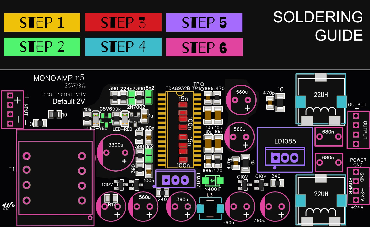

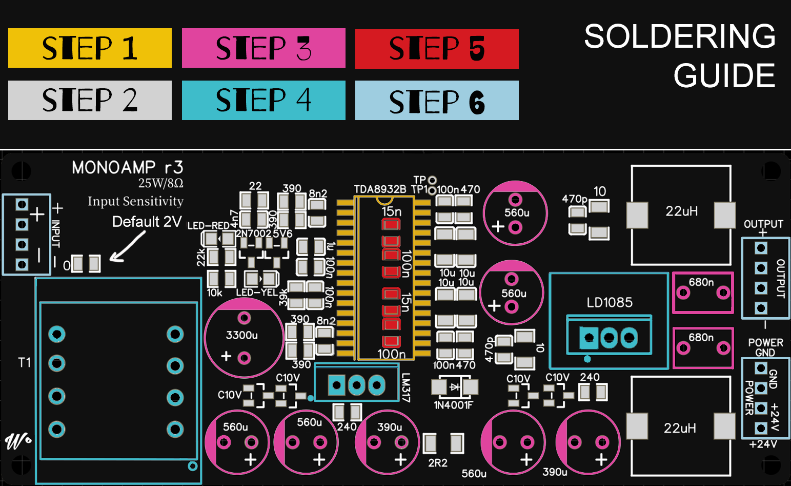

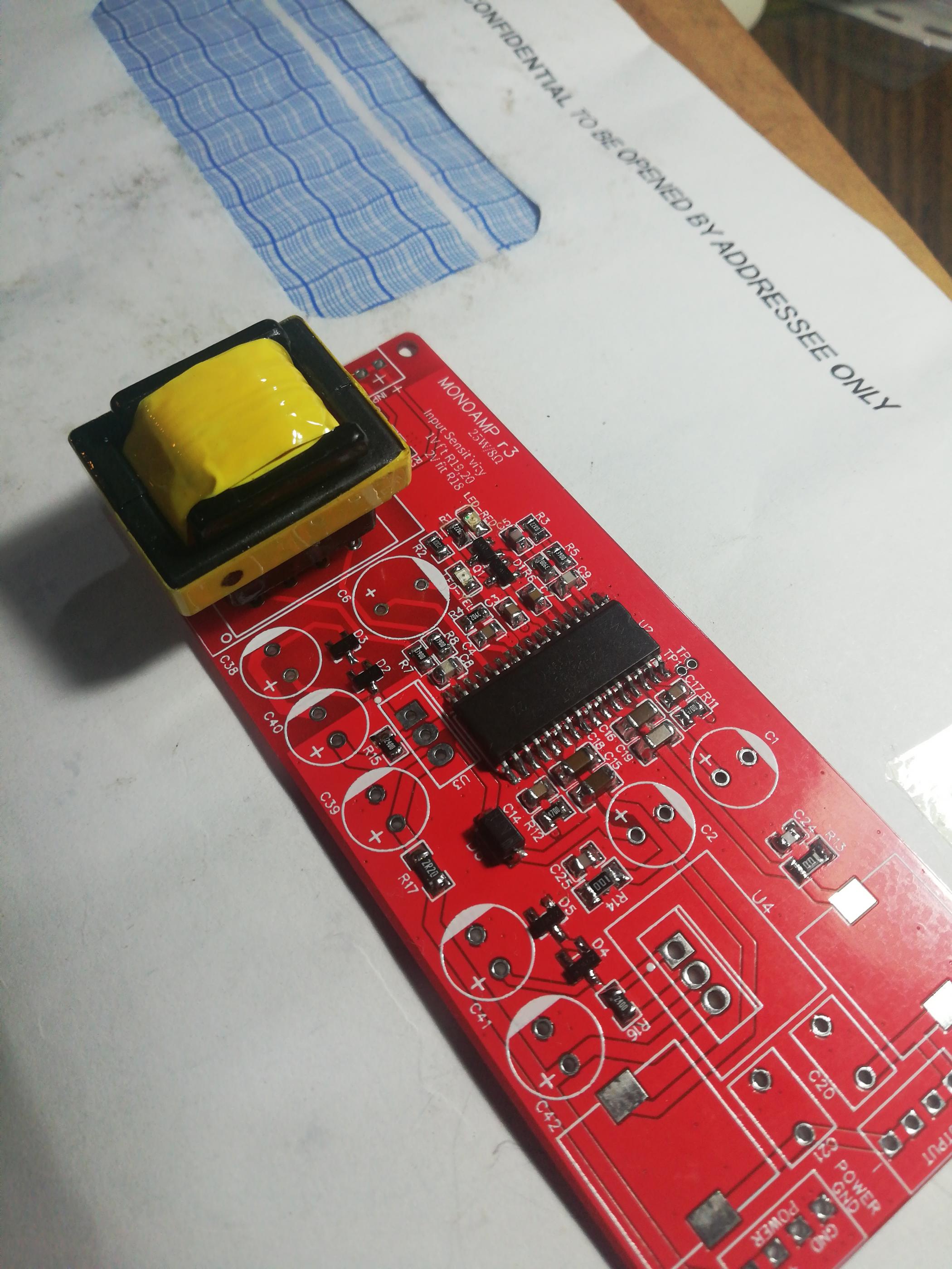

Board stuffing guide
Here's a graphical guide to hand soldering the components on your monoAMP kit.
The general principle is to solder the lowest profile components first so as to least obstruct useful soldering angles on later fitted parts. The exception to this is that the chipamp is best fitted first although its taller than surrounding components. There's a bit of a 'gotcha' for the unaware with this IC - the corner pins don't serve any electrical purpose rather they're for improving the chip's thermal resistance. Meaning that they're connected to the groundfill without any thermal reliefs. This makes them more difficult to solder than a typical pin so when tacking the IC into place it might make life easier to solder the next inner pin from the corner first. With that pin holding the IC in place, tweak the rotation and/or shift the IC along till the pins have good alignment with the pads. Then solder up the opposite corner pin to secure the device before moving on to the rest of its legs.
Don't forget that there are 4 components on the reverse side - the 1Mohm resistors aren't normally needed, they are there to accommodate an earlier revision of the chipamp, (without 'B' suffix) should it show up at some point. The reverse side components are shown on the guide as seen through the board - when you turn over C12,C13 are 15nF, C11,C10 are 100nF.
Fitting the transformer firstly needs correct orientation - double check this as its a pig to remove without damaging the PCB if you get it wrong. There's a black dot marked on the yellow transformer tape indicating the secondary - this dot goes adjacent to C38. The legs might need slight adjustment - I use a pair of pliers - to fit comfortably through all the holes.
BTW there is an error on the current schematic to be corrected soon - C40 should be 560uF/25V, not 390uF/35V.

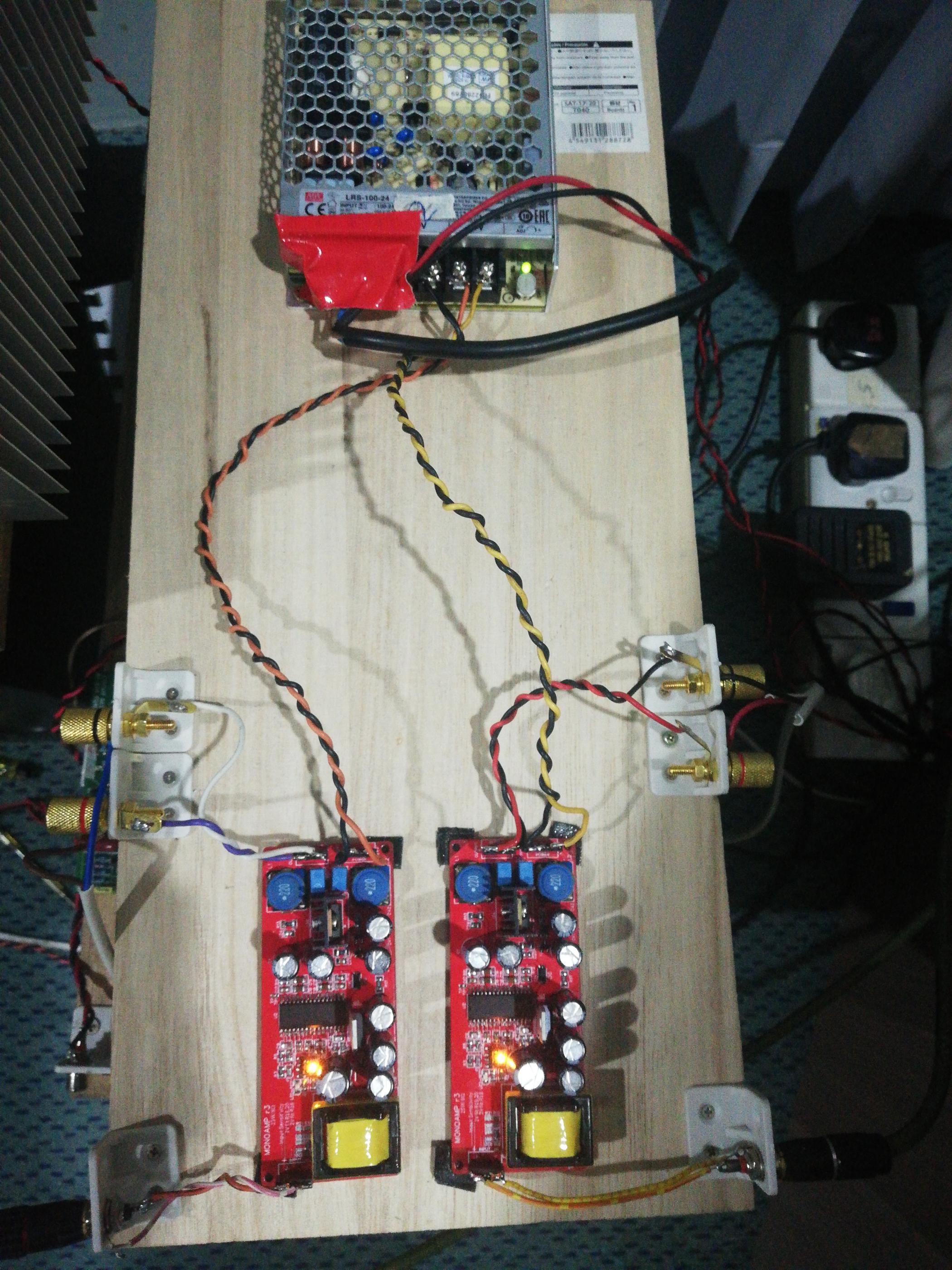

One channel
Testing. There is music. Constant hum. This is probably coming from up stream. Feed by passive volume 10k potentiometer. Quiet when input shorted.
Red LED light up for a while on power up
The TDA draws a significant quiescent current (40mA) so warm is quite normal. I'd not recommend a pot between source and amp as transformers don't perform too well when fed from significant source impedance.
Do you have source and amp 0V power terminals connected together? If not then hum can be a consequence.
I intend to insert the B1 buffer after the potentiometer. Is this a better solution?
TDA8932 powered by smps and the negative/ground of the TDA8932 is not connected to ground or 0 v line of the cd player /source at the moment.
Can l connect the smps negative to the ground of the B1 buffer?
Building the 2nd channel now
Is it ok to connect the B1 buffer power ground to the power ground of this board to solve hum issue?
