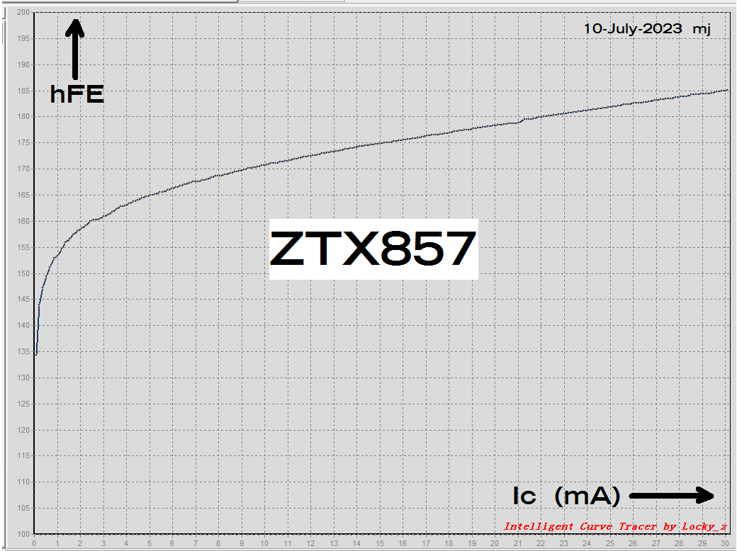

It's 0745 here in the Pacific timezone. I just took my mug of morning coffee into the workshop and measured hFE versus Ic for a ZTX857 NPN transistor that was lying on the bench. Equipment is a LockyZ curve tracer plus the comes-with-Windows "Snipping Tool" to get a screen capture. I told the tracer to sweep Ic from zero to 30mA while holding Vce constant at 10 volts. So at the far right end of the plot, the instantaneous power dissipation during measurement is 300 milliwatts.

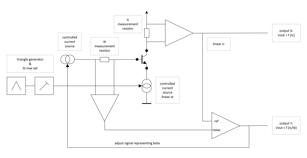

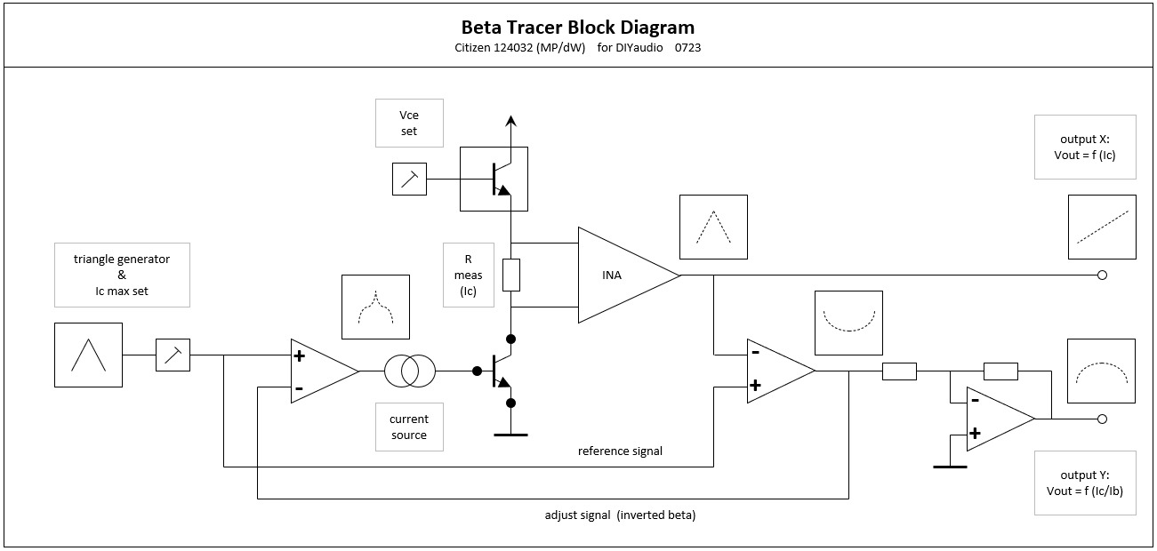

Thanks, for the Y we need divide Ic/Ib ?From scratch, that would be something like this.
The adjust signal represents the beta and linearises the the Ic output.
Not tested or simulated!
Great, but this is not available anymore ?Equipment is a LockyZ curve tracer
Insert a fixed cascode with voltage steps for variable Vce on the collector ?Not sure Ic is represented linear, an improved suggestion.

hFE = Beta = Ic/Ib.Thanks, for the Y we need divide Ic/Ib ?
Better avoid those compex four quadrant miltipliers/deviders..
Not sure if that will fix Vce at a certain value. That would be a second user setting.Insert a fixed cascode with voltage steps for variable Vce on the collector ?

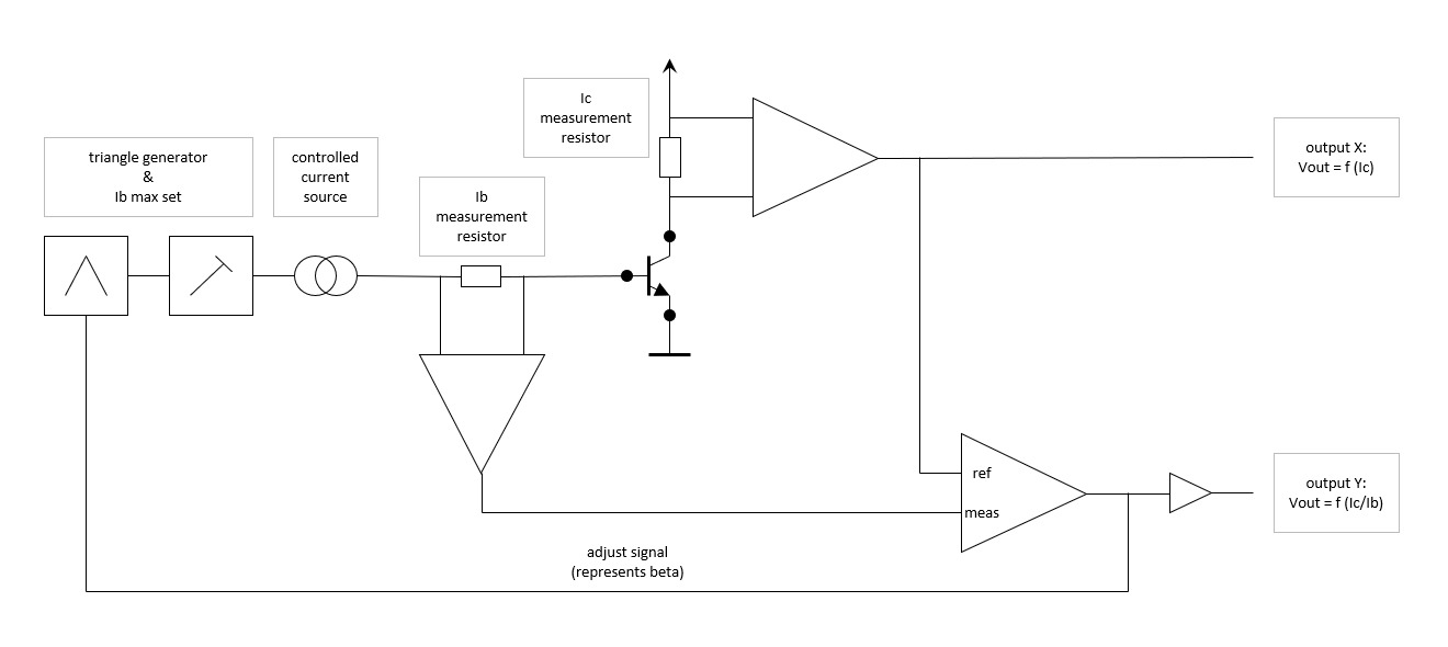

While browsing through number 1, I realised that output Y is inverted in #3 (a 'valley' instead of a 'hilly' curve), so an inverting opamp should be added there.
number 1 is about transfer and output characteristics, but not seen a beta-tracer.
Also several digital circuits (the elaborous path, but promising - I leave that for the digital folks), and cops intervening...
I never have wrapped my mind around a beta-tracer, but the idea of Bernhard is very challenging!
This correction signal is that specific beta curve (inverted), but these extra conditions (constant Vce, NPN/PNP) makes it difficult.

Is a four quadrant divider needed ?Better avoid those compex four quadrant miltipliers/deviders..
In your block diagram should`t the Vceset be below rmeas ? Because of the current dependent voltage drop across Rmeas. Or R is very small ?
INA is a BB instrumentation amp ?

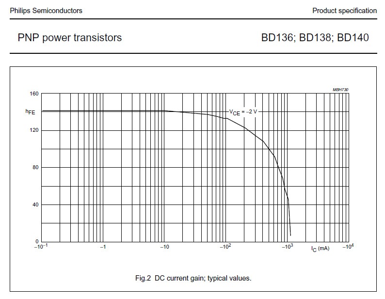

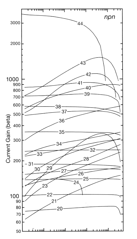

There are some nice curves presented in Horowitz and Hill's textbook , example below. The logarithmic horizontal axis (Icollector) spans 4 1/2 decades of current, from 10uA to 50 mA

If you want accute devide two electronic (volts, amps) values, in most cases yes. Unless the 'error signal tric' kicks in. And that happened!Is a four quadrant divider needed ?
Rmeas is of a low value - should be scaled with current obviously (TO92 / TO126 / TO3 just as examples).
Any instrumentation amplifier: accurate and amplification adjustable.
