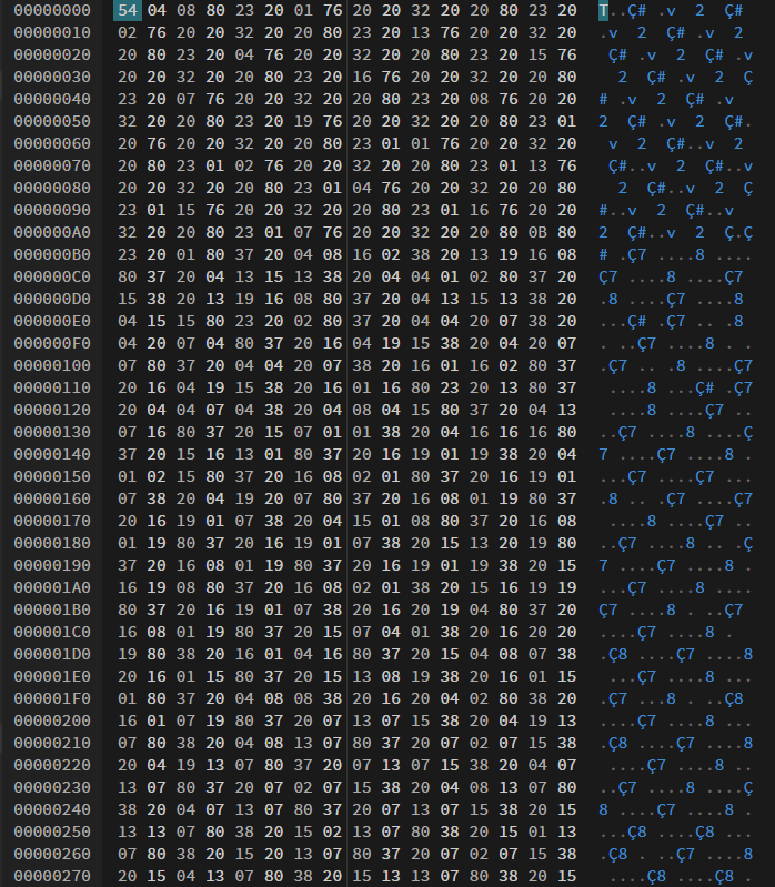

I have been using TraxMaker (part of Circuit Maker 2000) for over 20 yrs. I recently moved across to KiCAD and am getting to grips with that for all new boards moving forward

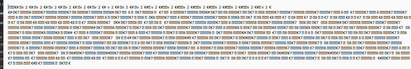

However, I still have a lot of boards on TraxMaker but have a problem that has recently emerged. Everything works ok except the DRL files are corrupted and are complete garbage. Has anyone else found this problem? I am unable to import the Gerber files into KiCAD PCB because although the tracks and board outlines are all ok, it can’t read the DRL file because it’s corrupted.

I am not sure where your problem lies, is it traxmaker creating erroneous drill files or is it that kicad can’t figure them out?
Maybe it’s the Gerber file viewer issue with kicad. Try a different Gerber viewer. It could be the settings for reading in the excellon drill files like imperial vs metric, sometimes I have issues with the precision or format settings, like 2.4 or 3.4 etc

I don't think your DRL files are corrupted.

Thanks for the replies guys.
The problem is definitely not in KiCAD because if I open the DRL files in eg Notes or Wordpad, the file is corrupted - it’s all garbage. All the other Traxmsker files are ok.
I took my old PC to the computer shop and they were able to recover the hard drive and transfer everything to an SSD.
All the programs work ok and Traxmsker is ok except generating the DRL files.
I guess I’m stuck at this point unless I can fix this. Very frustrating.

KiCAD Gerber reader will import Gerber files incl the DRL file. It imports my Traxmaker files ok except for the DRL files, which as I’ve noted, are getting corrupted by my PC (old and new PC). If I take an old Traxmaker zipped up file from a year back and send it to a Chinese PCB house, they can make it. The problem is projects done over the last 3 months have corrupted DRL files.
