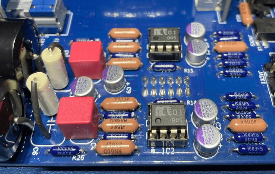

I purchased this a few years ago but just assembled it about a month ago. Using GE12AT7 tubes and Muses01 in phono stage and I have to say that I'm not impressed. I upgraded every part in the phono stage, resistors are low PPM military grade and signal caps are WIMA and Mundorf. I have about 40-50 hours on this and the phono to my ears is just ok. My 2nd gen Hagerman Bugle is actually quite better and my Salas Ultra Folded makes a joke of it, unfortunately... Not sure what I'm missing but having built and rolled many simple phono stages over the years this design seems to be on the lower spectrum of performance. Any thoughts or comments good/bad are welcome. The picture is the completed PCB with the soldered components.
These are what is supplied in the kit and according to the schematic are not part of the "signal path" per se and are used for supply filtration. Every iteration of phono stage that I can remember in detail uses electrolytic's in the same fashion.
And I was thinking about supply filtration or decoupling, although I wouldn't be surprised if we soon see OS-CON on the signal path as well

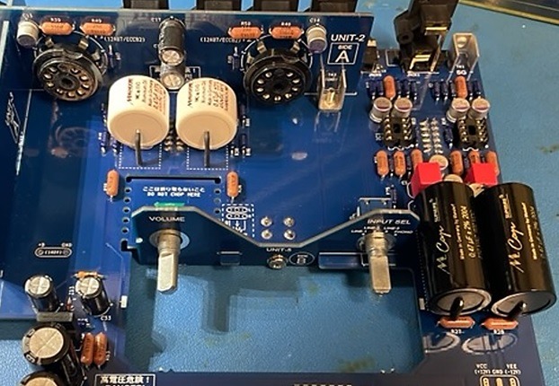

I bought a TU-8500 off of someone on this forum and it has Mundorf Mcap Supremes and Muses 01 opamps. I am using it as the preamp for a Buckeye Amp (Hypex NC-502MP) - replacing a Topping Pre90. I am very happy with the sound.
The only thing I wish it had was a remote for the volume. Has anyone replaced the pot with a motorized one?
