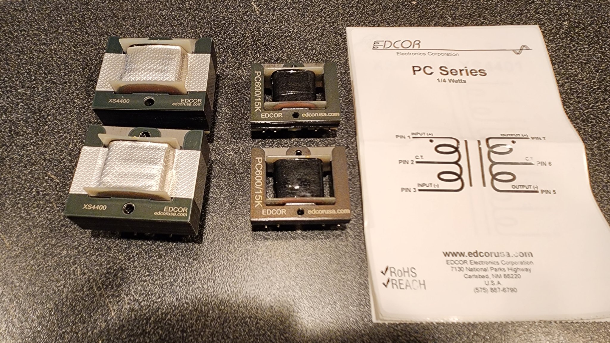

Anyway, I did some experiments with edcor 600:15k stepup trafo, and it works great and sounds amazing.
Basically i have normal volume pot on the input, followed by the buffer, whatever you fancy, feeding the transformer. You can have 0 gain, that is 1x, or two levels of step up, 3x or 6x. I decided not to use switch, just the wires to cinch connector. One will simply plug it based on the gain needed.
I ordered some more trafos...since this is likely going to be the best pre.

Transformers are here. New one is massive for line level, looking good.

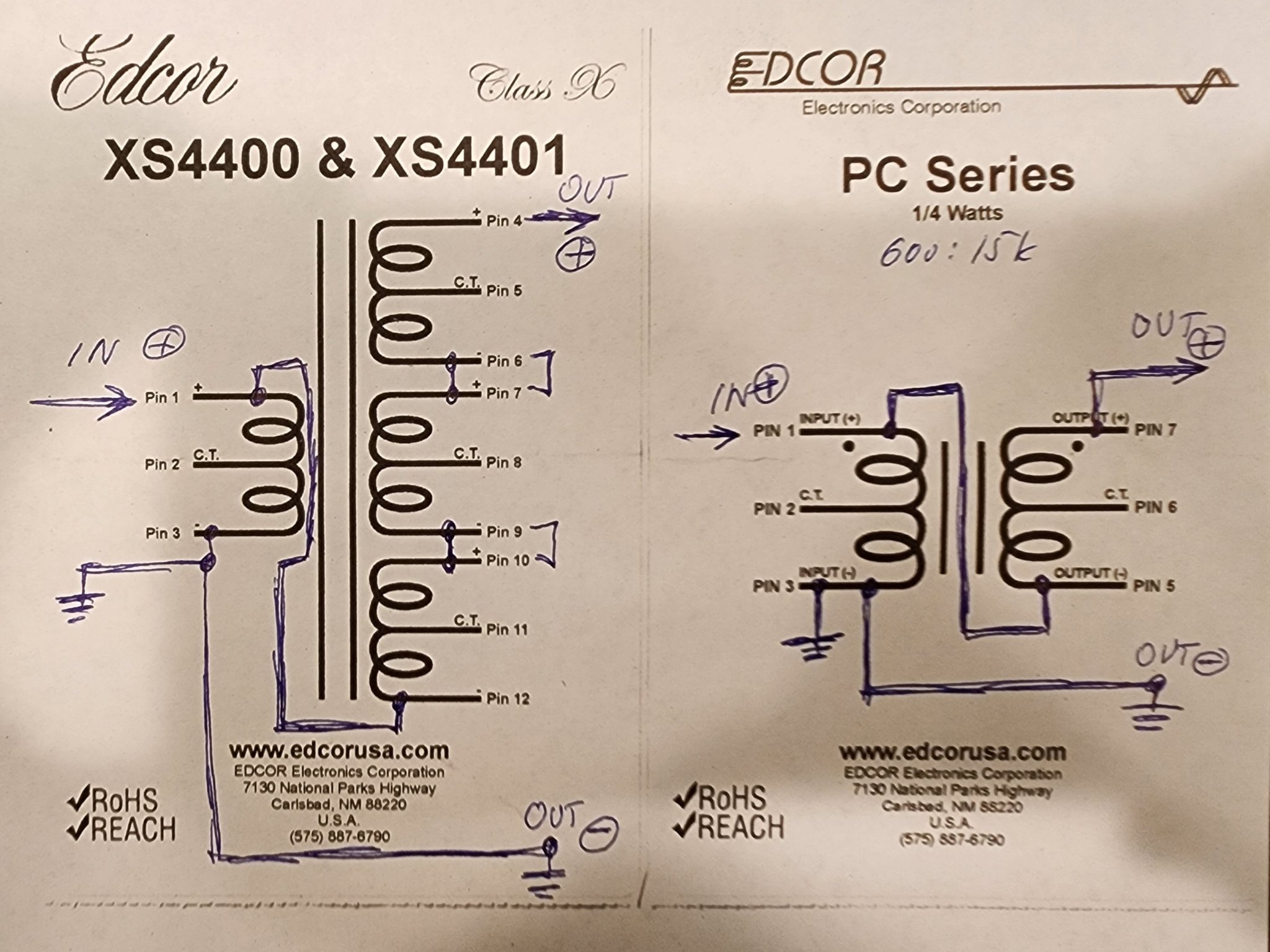

Here is how i connect those edcor transformers.
For those who like some pleasing distortion, use 600:15k edcor as in M2.
For those who like clean step up line transformer, i highly recommend xs4400. It can handle much higher peaks without limiting.
I made three preamp and they surpassed all other preamps i tried (including nutube korg b1, acp+, whammy, scg, ba3fe, goldmund, Wayne's pre, schiit, and bunch of tube pre).
The better the buffer, the better result.

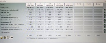

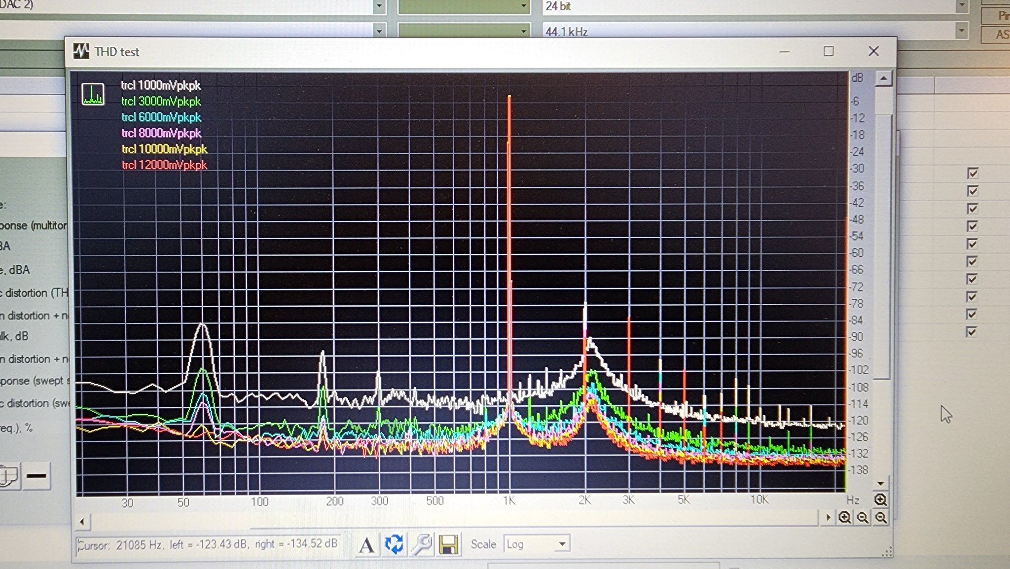

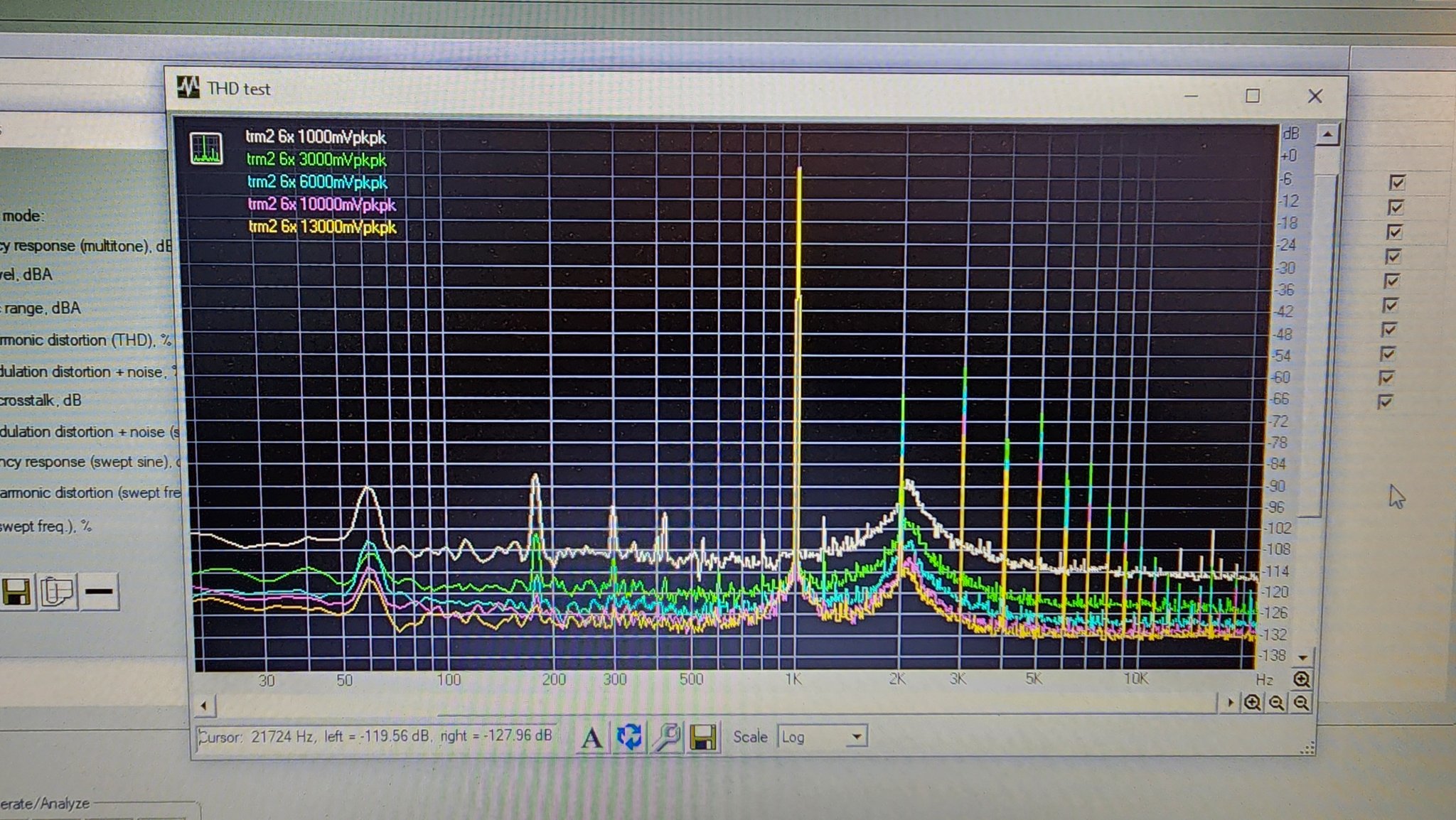

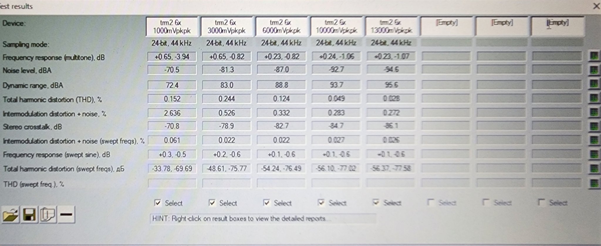

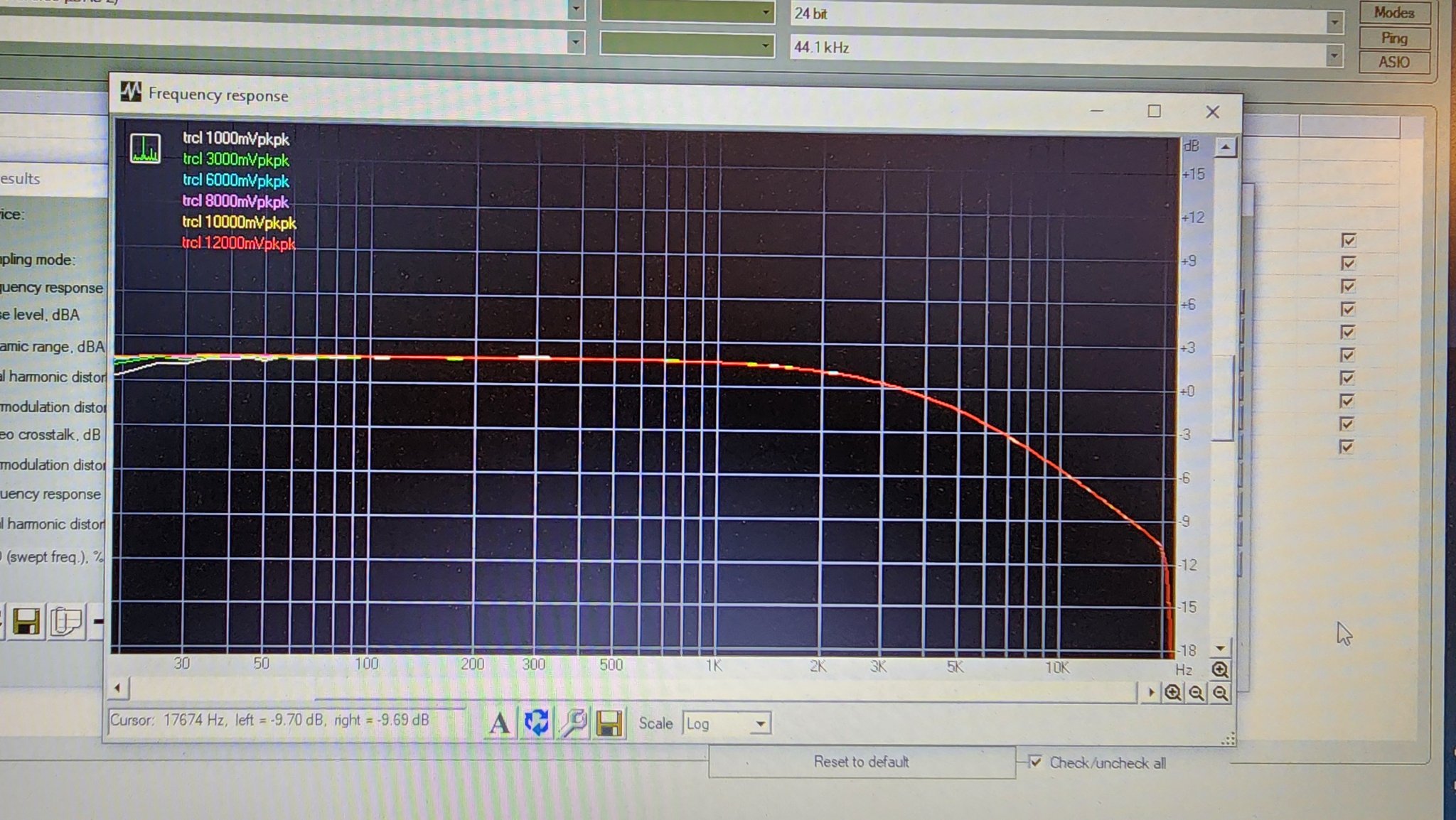

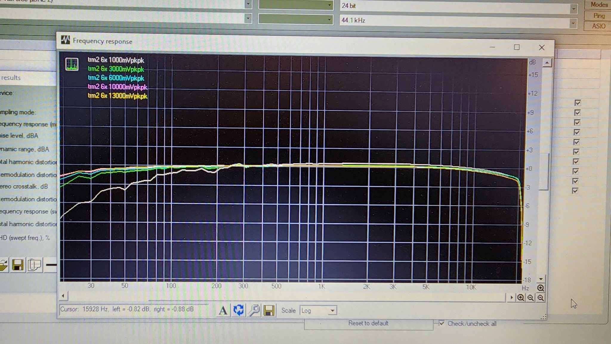

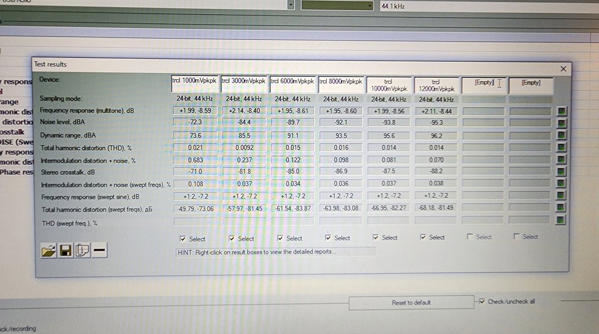

Not that any of you care, but i will post some data about those two edcor line level transformers above mentioned. Kind off comparison.
Then i post two other line level transformers, these time balancing mic transformers. Some interesting findings.
Then perhaps some data about ground break line level transormers. So lets do it.

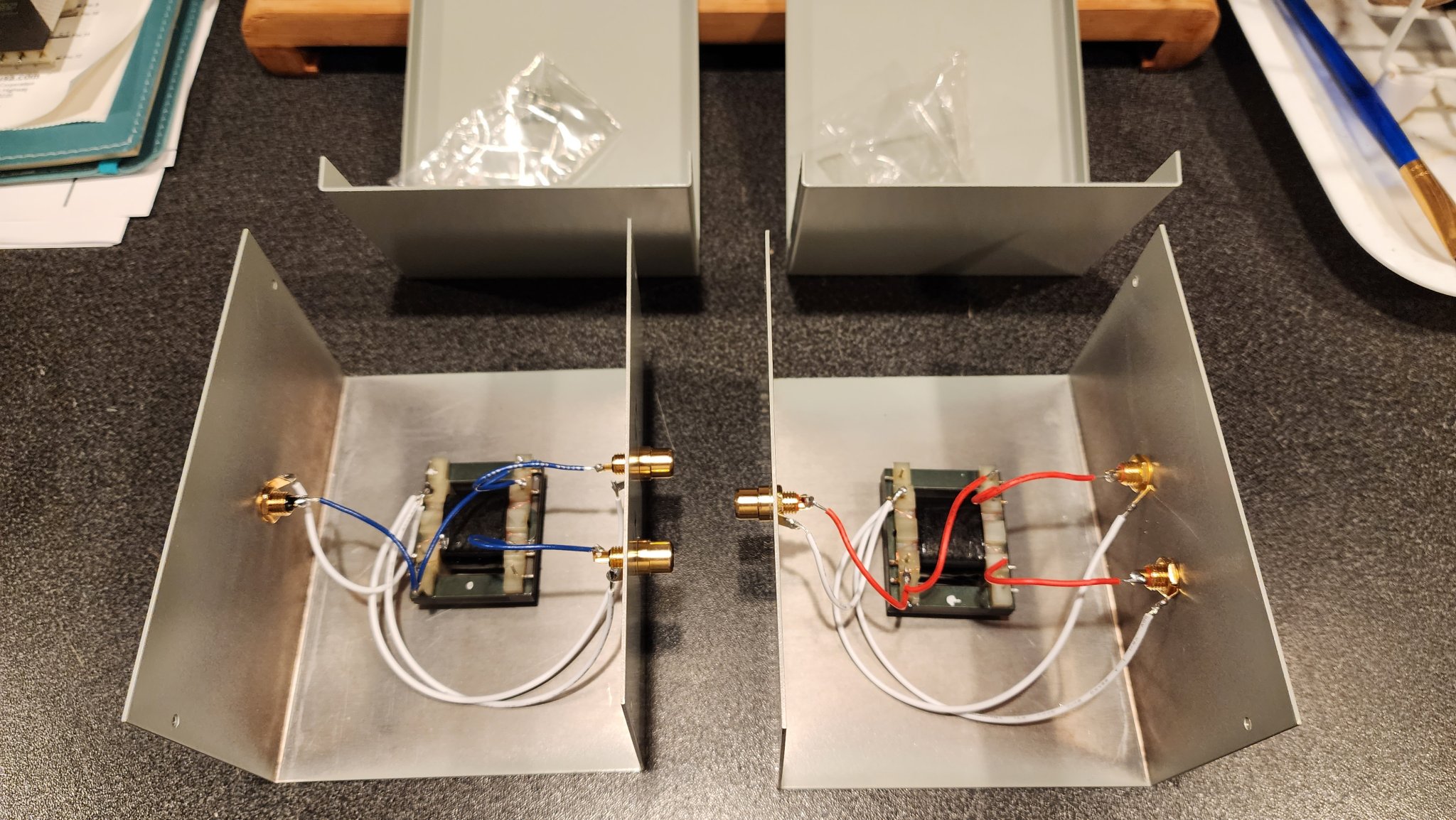

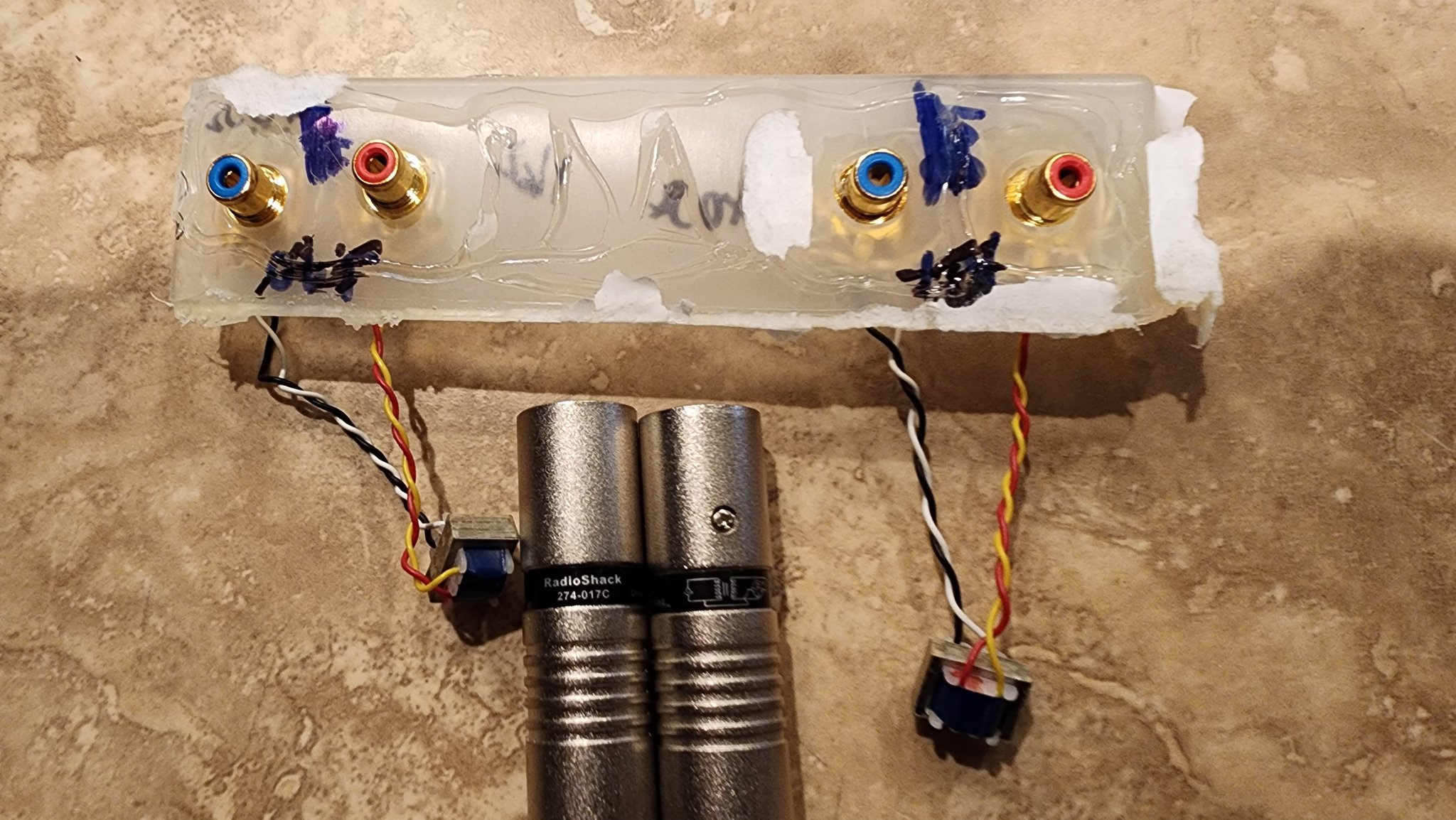

Ok, now for the surprise. We have here small mic balancing transformer from radio shack. I used these long time ago when i was soundman for our company music group. Great time.
Anyway, these are absolutely tiny in comparison to big edcor line level transformer. I used these as mc cartridge step up.
They are i believe 600:10k ohm, but i am not certain.
Here picture how they look in original steel casing and taken out for measurements.
