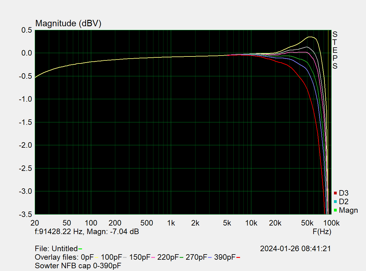

There are lots of posts asking about the gNFB feedback compensation cap.
I am building my third SPP, this time with Sowter OPTs (that seem to be of very high quality, BTW), and thought I'd share a FR graph of different cap values.
With this OPT, FR is pretty flat in the audio band, so I'm not even sure if a cap is necessary, but I experimented with 0pF-390pF.
With 0pF (no cap), the HF continues to rise and is likely truncated only due to my sound card sample rate?
With 390pF, the amp becomes unstable at max output power, so that is too high.
150-220pF seem to be the optimal capacitance, for this specific OPT.
