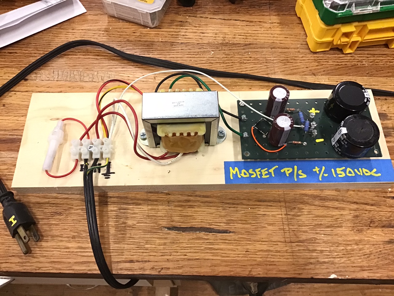

Making progress on my 1st Universal Driver board, which I’m building:
(A) right-side, ala TubeLab, for prototyping
(B) initially in conventional G1 grid-drive configuration
(C) initially MONO, so I only need one board, but also because:
(E) to be powered by Heathkit P/S, max 100mA at 400VDC
(F) initially Ultralinear mode with 6L6GCs, or some JJ 7591s repro tubes, or possibly Gold Lion KT66s (but only have a pair). Leaning towards 7591s, as very cheap with good sonic reputation...
Getting close, and need some advice:
1. Built the +/- 150 VDC MOSFET supply on a piece of guitar amp board with used 450v caps, so Big & Ugly. See awkward class photo attached. Measured +/- 144 volts, within a few tenths between sides (matched the resistors). I assume that’s within acceptable limits; if not easy to raise it a little.
The nominal value of R9 & R11 (120K) gives 120K / 144volts = 833 ohms per volt, which is in the prescribed 500-1K ohms/volt.

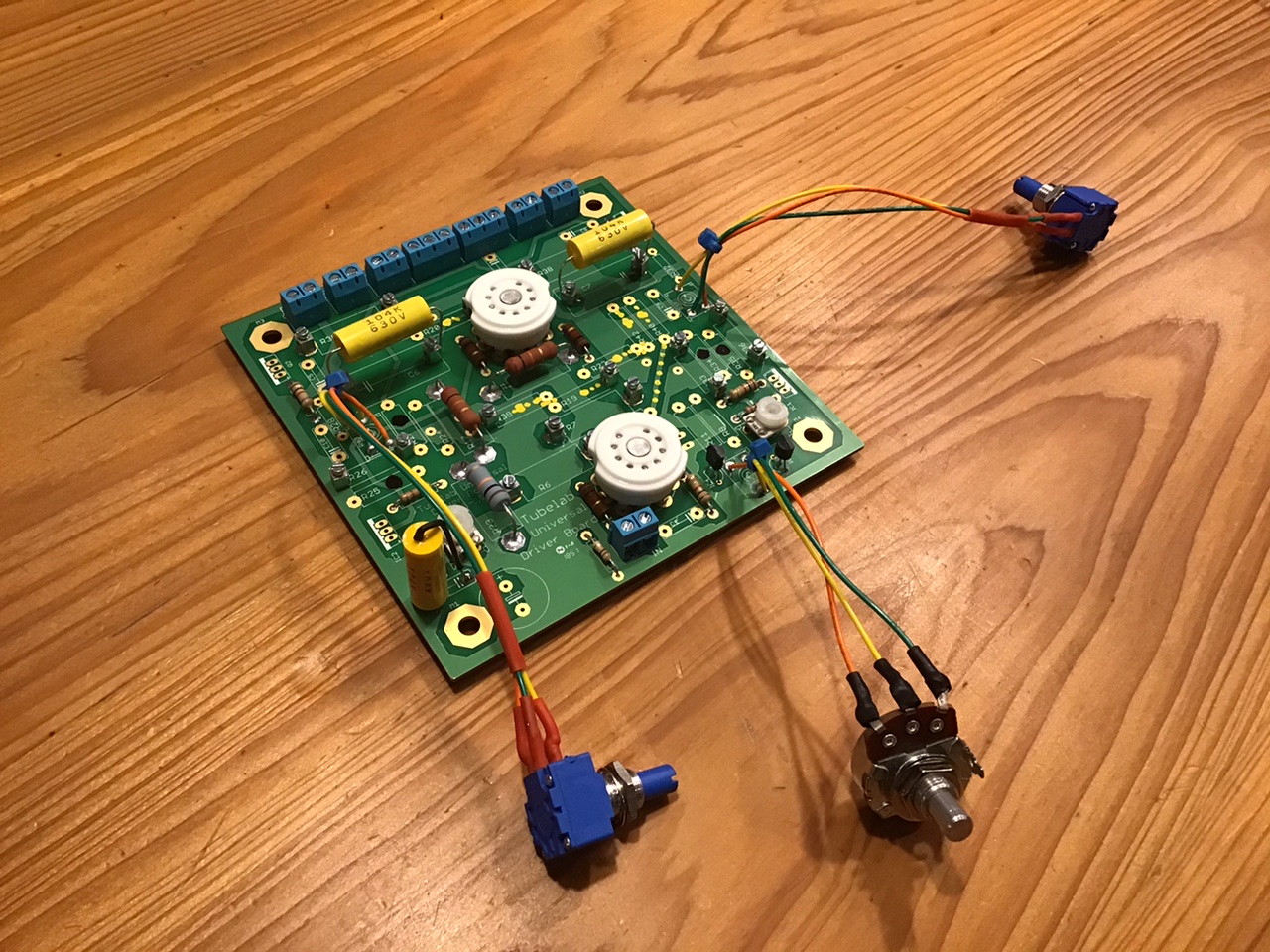

2. Not planning on using FB initially (clean ultralinear first, which may be enough “feedback”), but want to be sure I understand the concept.
There are FOUR built-in FB “channels” as it were:
One to each anode of the four triode sections in the two (nominally 6CG7) drivers. Each FB “channel” has places for TWO resistors in SERIES.
I have ZERO experience with ANODE feedback, although I could certainly consult my files, Morgan Jones, and the Google Machine when the time comes.
In the meantime, I am installing single terminals at the distal ends of the resistor pairs (eg R19 & R40).
2A. Why PAIRS of resistors? Cap by-pass on only ONE of the pair?
2B. Any suggestions for starting points on Global FB to driver anodes? Alternately examples and/or reference docs?
3. For Conventional G1 grid drive, I am NOT populating R25, R27, R34 or R35.
Is 4.7K correct for the Negative Bias resistors R26 & R36? I doubt they will come into play with the Heathkit P/S and my prelim tube selection, but makin’sure.
4. I assume that 43K and 20K are correct plate resistors for V1 and V2 respectively at B++ of under 400 volts, is that right?
5. Haven’t seen a setting procedure for the trimmer on the SINKS of 10M45s (although I love this topology, and will use it elsewhere). I could measure the net resistance from Sink to ground, then look at the 10M45 chart ; this would be easy AND not under power. Alternately, could measure voltage across the plate resistors, I guess...what’s correct???
6. Haven’t seen the NOTES mentioned on the latest BOM, although I might have walked right past it.
7. Same for a start-up sequence; is there one around? If somebody has an OUTLINE, I could flesh it out (preferably NOT literally)....
Here’s the board so far; note the off-board BIAS and balance pots; at my age/condition, trying to keep from sticking a fork, I mean screwdriver, in amongst 400 volt things. Hence the question about the CCS Sink pots...

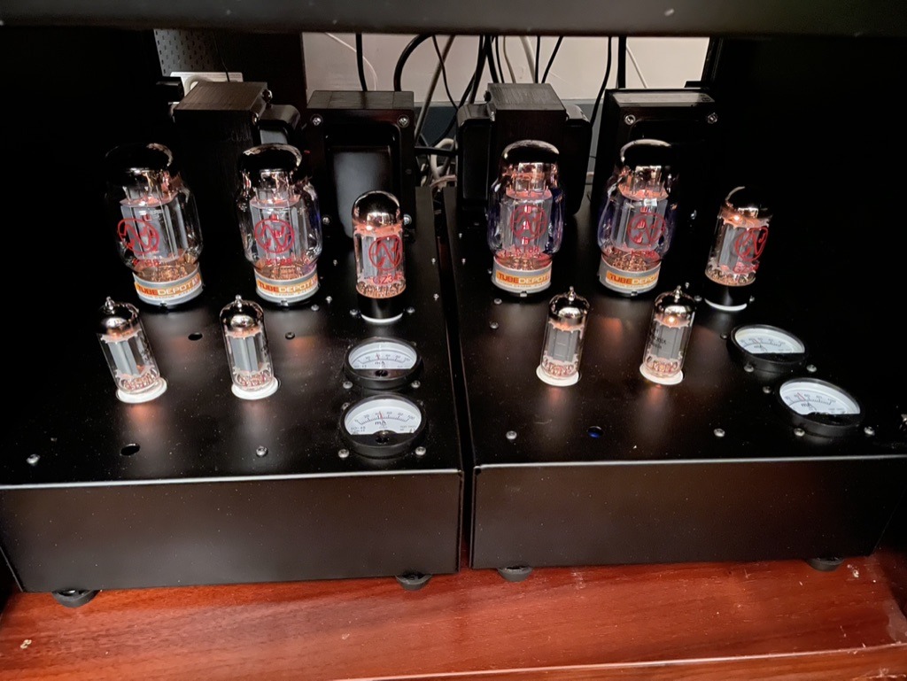

I am listening to a set of mono-blocks I built using UDB's driving KT88's. I love the sound. I've had them for a few years now, very stable, no problems. It required building two power supplies which are documented in this thread. I have plenty of power, enough to drive some vintage AR 3a's. Highly recommended. Just another wonderfully design circuit by George Anderson. 🙂
Jacques
