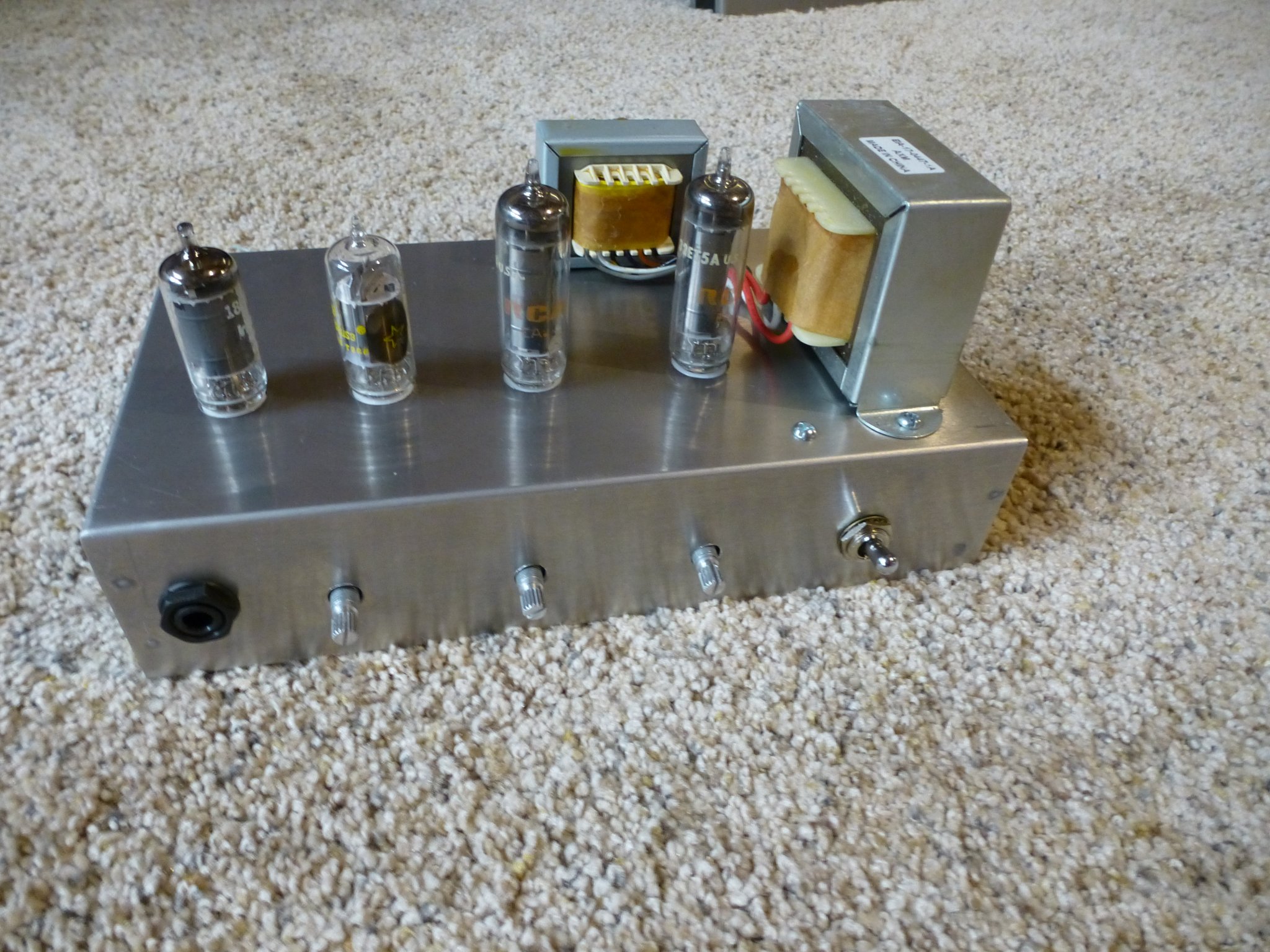

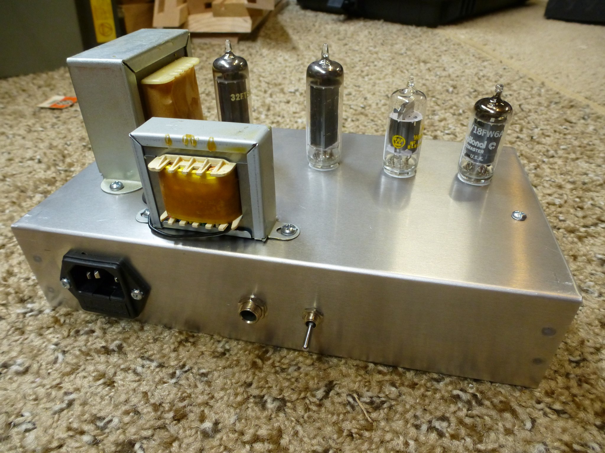

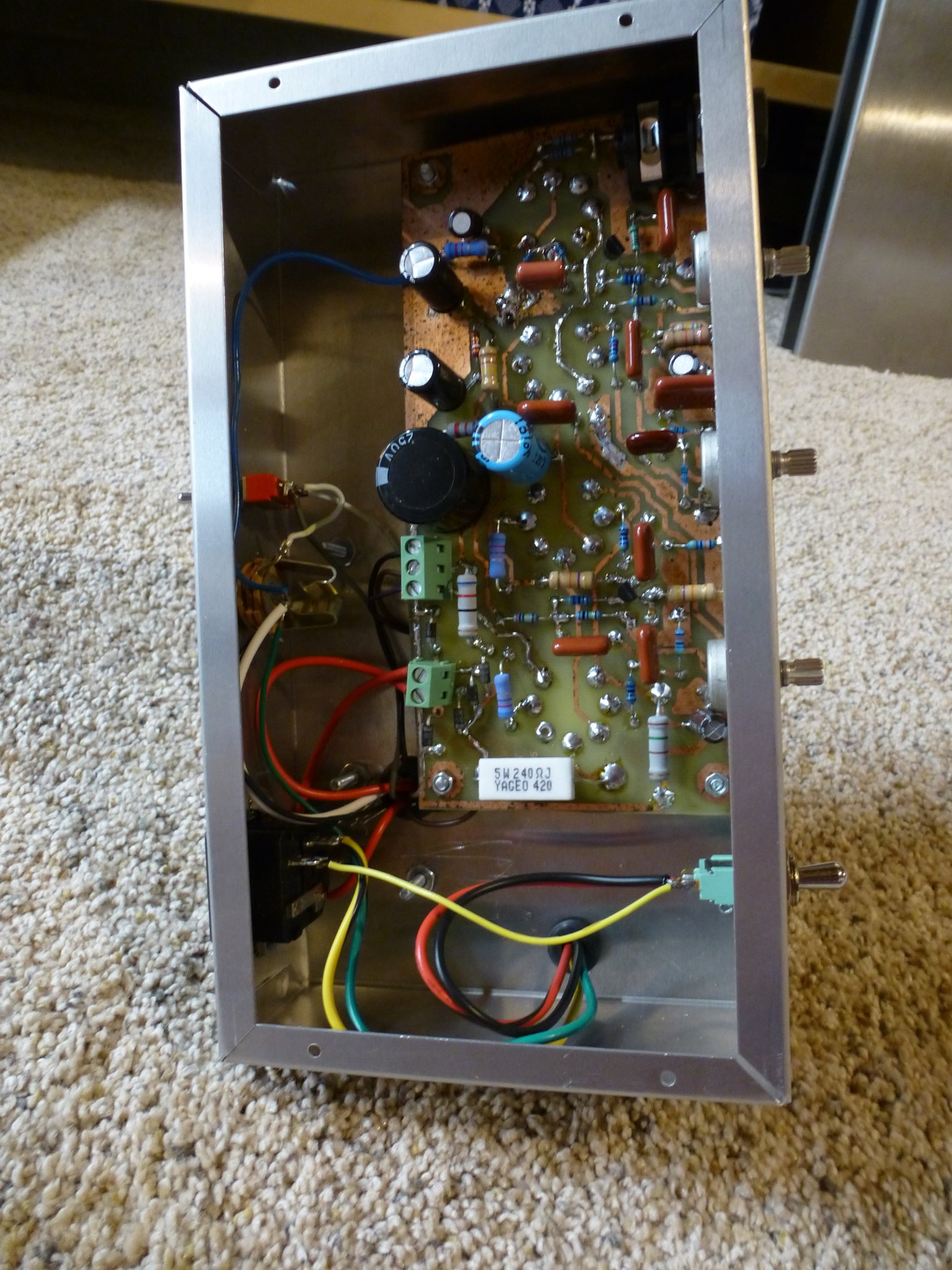

The original 4 tube design for the HBAC did not use any semiconductors as per the definition of "tube guitar amp" that was dealt out by the guy who started the whole challenge with his attempt to sell his amp kit here. His design did however use diodes in the power supply. My initial 4 tube amp used a "self split" output stage. The little 70 volt line matching transformer that I used for an OPT really did not like being used as an SE OPT, so the original plan was to leave the second output tube undriven. I experimented with removing the shared bypass cap on the paralleled cathodes and did get a little more power and slightly better sound quality. The input stage was just a typical resistor loaded pentode follower by a simple tone control and a triode gain stage. The amp worked well but lacked that cranked to 11 sound that I wanted, so it wound up in a box after the challenge was over.
4 or 5 years and 1200 miles later the little amp crawls out of the box. The HBAC is over and now there are NO rules. Plating was cut, parts were sky wired in and experiments done. Tuning was done with a box full of pots, some clip leads and several guitars. It looked ugly! There is no "putting this back together again" so a new board was made and amp 1.4 became amp 1.5 The major additions were two LND150 mosfets and the associated caps and resistors. The amp even made its way into a shiny chassis.

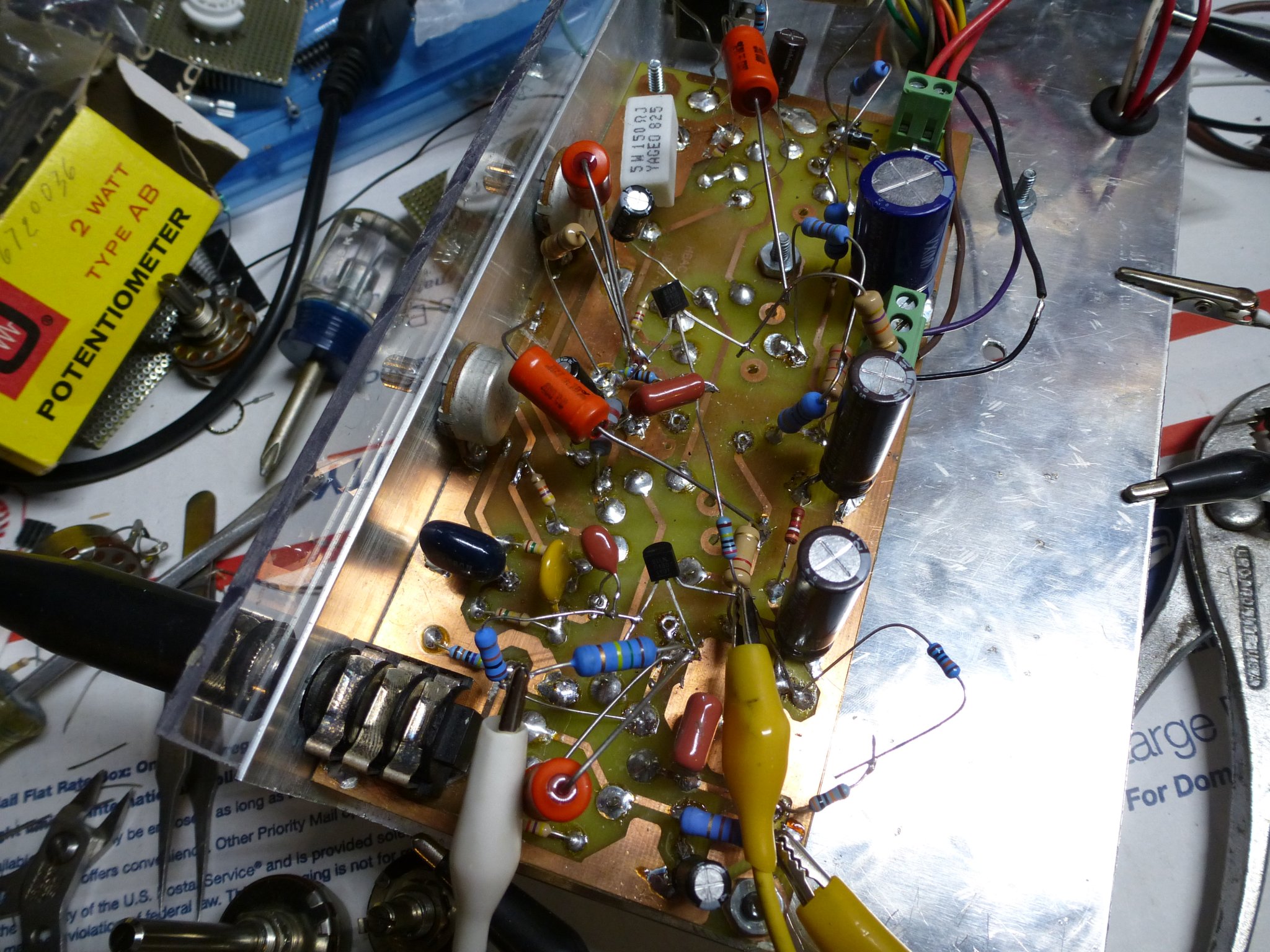

One mod created a variable input impedance "gyrator" load on the input pentode which I called the Saturator circuit. So named because a pentode running into a 1 megohm or higher load impedance will swing from the plate supply voltage to its saturation voltage with just a few millivolts at its input. The pot can be used to dial back the gain into wimpy triode territory (about 10X) or anywhere between these extremes.
The other LND150 became a split load phase inverter transforming a self split output stage into a real push pull stage. The transformation resulted in more power output, about 4 watts as compared to about 2.5 watts. It also resulted in a far better overdriven sound where hard clipping was possible. Even at 170 volts of B+ it was now possible to make the screen grids glow in the wimpy 32ET5 tubes. I raised the shared screen resistor to 2.7K and hung the whole preamp's supply line on the tube side of that resistor. Now the little amp has a "sag" effect somewhat like the tube rectifier effect.
I expect my neat looking preamp board to experience some similar changes before I'm done here.
