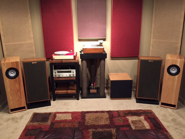

I've got them built, and up and running (see thread here http://www.diyaudio.com/forums/full-range/266717-my-super-pensil-12-2p-build-pics.html#post4159740). They sound terrific so far, but I'm wondering what improvements I can expect with stuffing and/or positioning tweaks. Right now, they are stuffed with 1# of poly fill (well teased) per cabinet. I also have the upper walls lined with 1/8" F11 acoustical felt. They are currently positioned about 36" from the back wall and about 13" off the side walls (to the center of the baffle), with a little toe in (see picture). They are 110" apart (center to center) and my listening position is about 100" back (I can adjust that easily enough).
Not knowing what these can ultimately achieve, I'm wondering what I can expect with more/less stuffing or a different positioning set-up. Sick with they are front ported, I'm thinking that the distance from the rear wall isn't critical (I may be wring) but I'm not so sure about the side wall distance.
Any suggestions? It's easy enough to change the position (although I'd like to leave my Forte II's in relatively the same place). But I need to pull the drivers to adjust the stuffing, and I dont want to do that any more often than absolutely necessary.

Here's the front wall as it is currently...

The felt at the top is to reduce early reflections thru the cone. The smaller the cabinet the greater the benefit.
As a TL the Pensil uses quarter-wave resonance to make extra bass. The damping is to kill the unwanted higher frequency resonances that we don't want. Less damping means more bass but more ripple from the unwanted harmonics. More damping gives a smoother response with less bass.
Room, room placement, and taste play a role too so there is no fixed correct amount. The back is removable so that you can play.
In our build Chris ended up pulling out about a 1/3 of the recommended damping.
