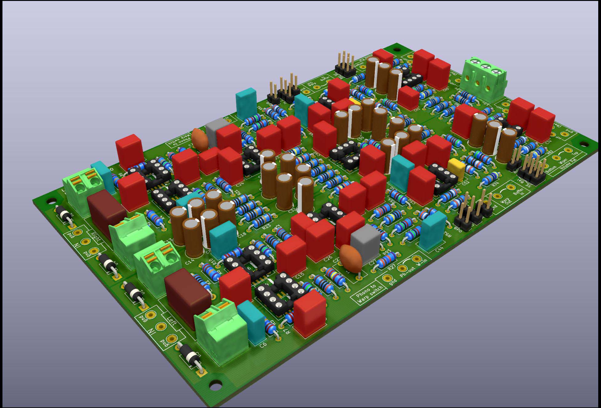

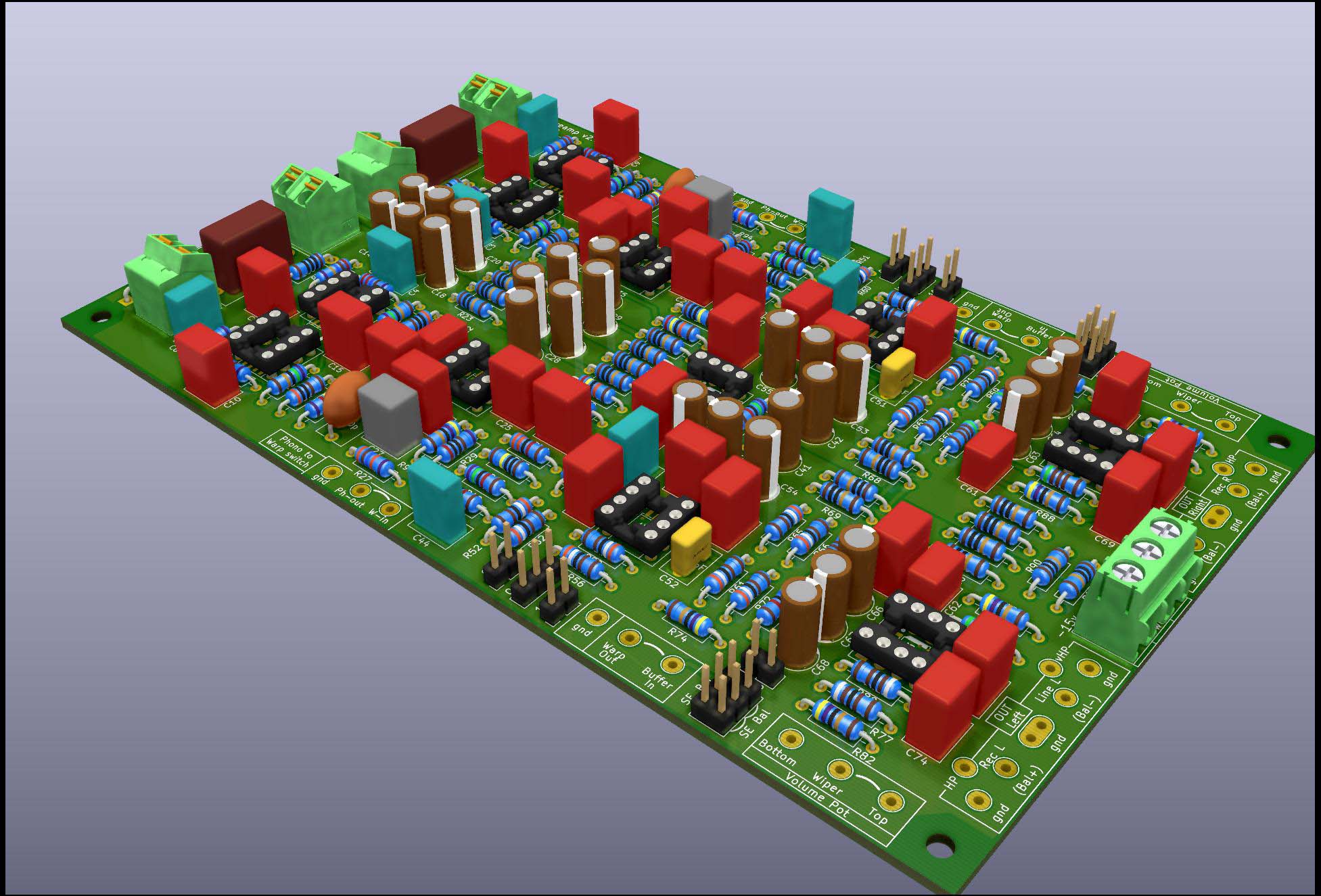

With v2.0 board finalized & fab underway, here's a few teasers of what the finished board will look like:

Still, the boards are in the US, and I'm not expecting any consequential issues, so they should be available for shipping within a week.
The v2.0 boards are here, and one has been assembled and tested successfully. The first batch was oversubscribed, as was the headphone amp, and I will order a second batch based on demand. The phono board set will be $30 excluding shipping/handling, while the headphone board will be $10 excluding shipping and handling. Both prices could fall if there is sufficient interest.
There have now been multiple users of the "warp filter" included on the board with a surprising level of enthusiasm for the result.

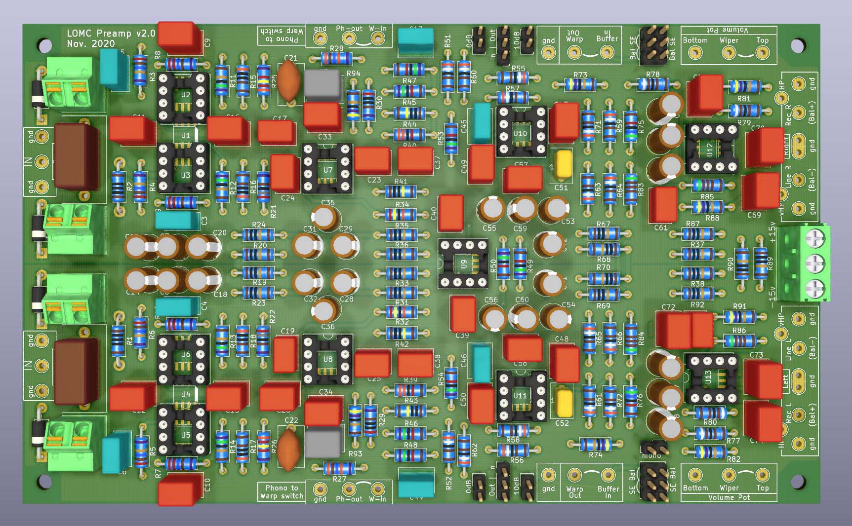

The set of goals in the project were-
Create an easy to build phono/preamp based on state of the art commercial audio opamps with a measured performance that matched or exceeded essentially all of the commercial/DIY designs out there that also satisfied the known requirements of the psychoacoustic limits of global negative feedback stages, and was modular and extensible.
It was also intended to demonstrate that a commercially available, off the shelf, cheap, SMPS, could be employed with a degree of additional passive filtering to create a sufficiently noise free environment for that near state of the art measuring phono amplifier.
The design would meet exacting design criteria for distortion- hence the inclusion of the many tone tests and the focus on high order distortion products- and frequency response- in fact meeting RIAA compliance results where the ripple introduced by the ADC/DAC source/measurement system is a noticeable part of the measured result. It would also achieve essentially a maximum possible, constant over the audio frequency range, overload characteristic limited by the +/-15v supplies.
These criteria forced a particular architecture to be used.
In essence, it was intended to, in part, dissipate the illusions that often are associated with high end audio components.

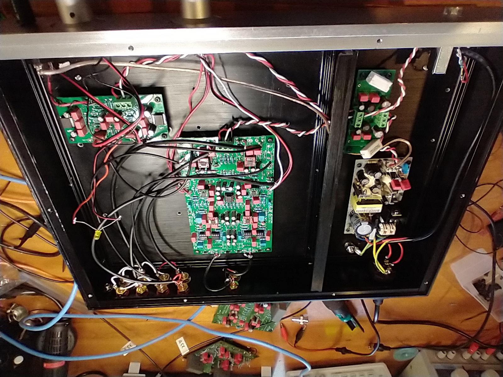

In any case, the board is stuffed, tested and incorporated into the preamp with the headphone etc. and it sounds quite good.
Initial testing shows no change in prior performance- except, as expected, the noise is a couple of dBs lower.
The VERY detailed build notes are on AK and are being updated even as I write this.
Once that is complete a link will be posted here.
