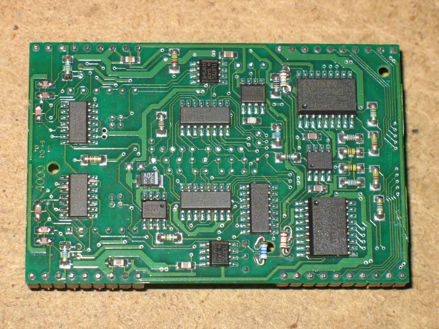

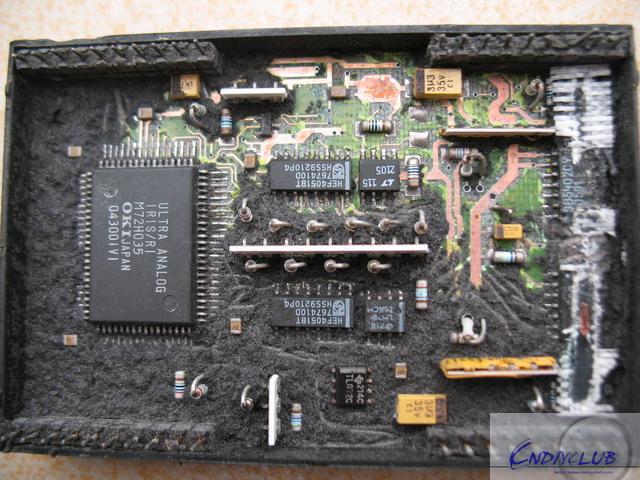

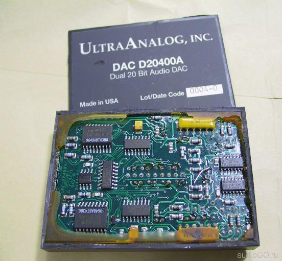

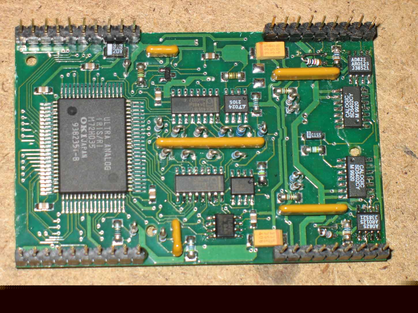

Some guys must have create a schematic diagram according the opened PCB's (have a look to the images).
Maybe one of the members can upload the schema.

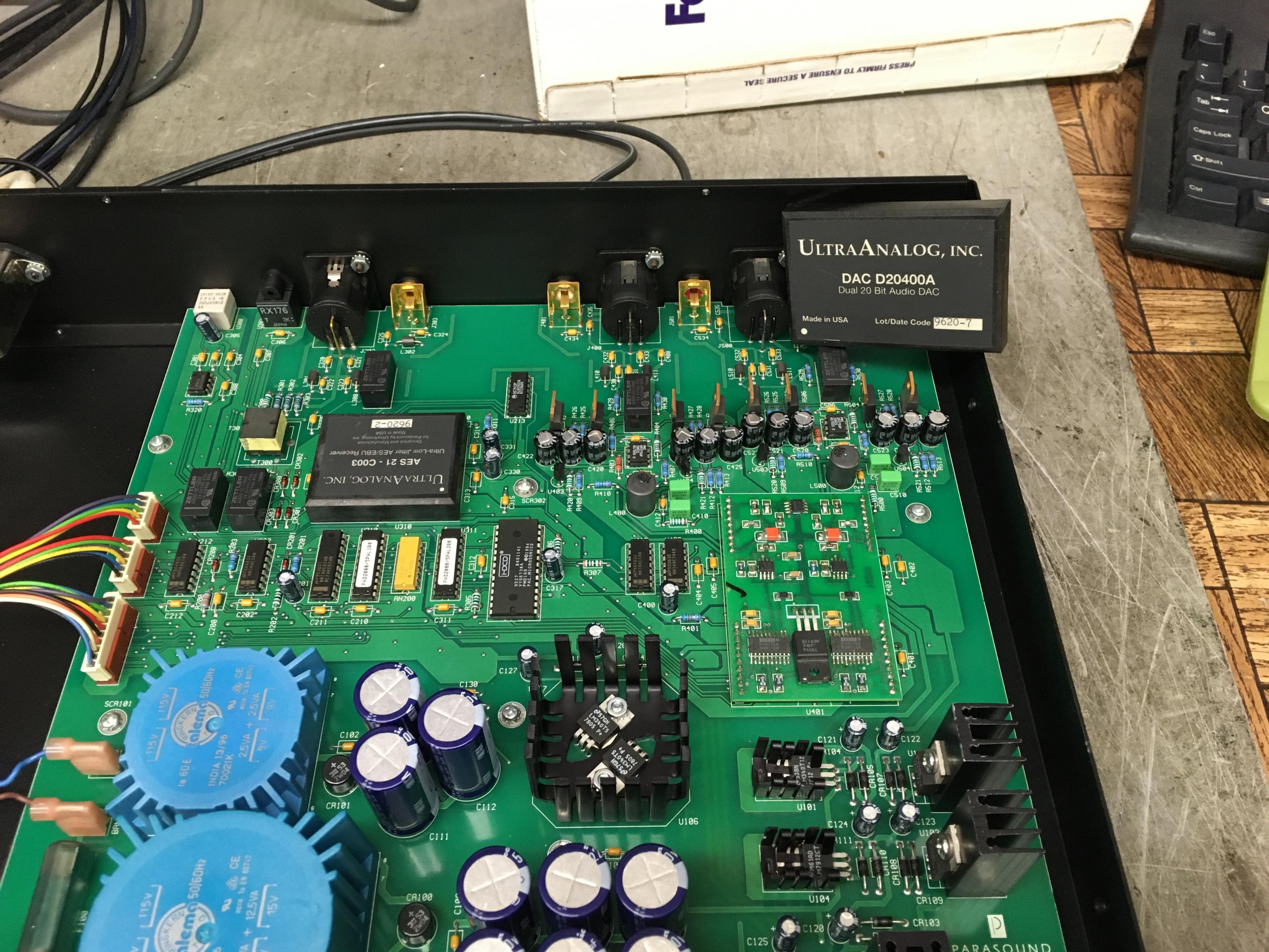

yes, the design is straight from the TI data sheet but the layout is mine.
The last batch I made was years ago and I only have the populated boards for use in repairs. the Paraound was a drop in but the Levinson No35 resquires a clock buffer replacement and the No30.5 requires a different PCB.
If you still have the Gerbers, I would order some (perhaps 10pcs.) new bare PCBs in China and offer it here to other users.
I also could edit the layout to add a clock buffer.
This would cost most certainly not more than 10USD per piece.
I still have a few PCM1704U-J in my drawer. This would be probably the best way to get them used.

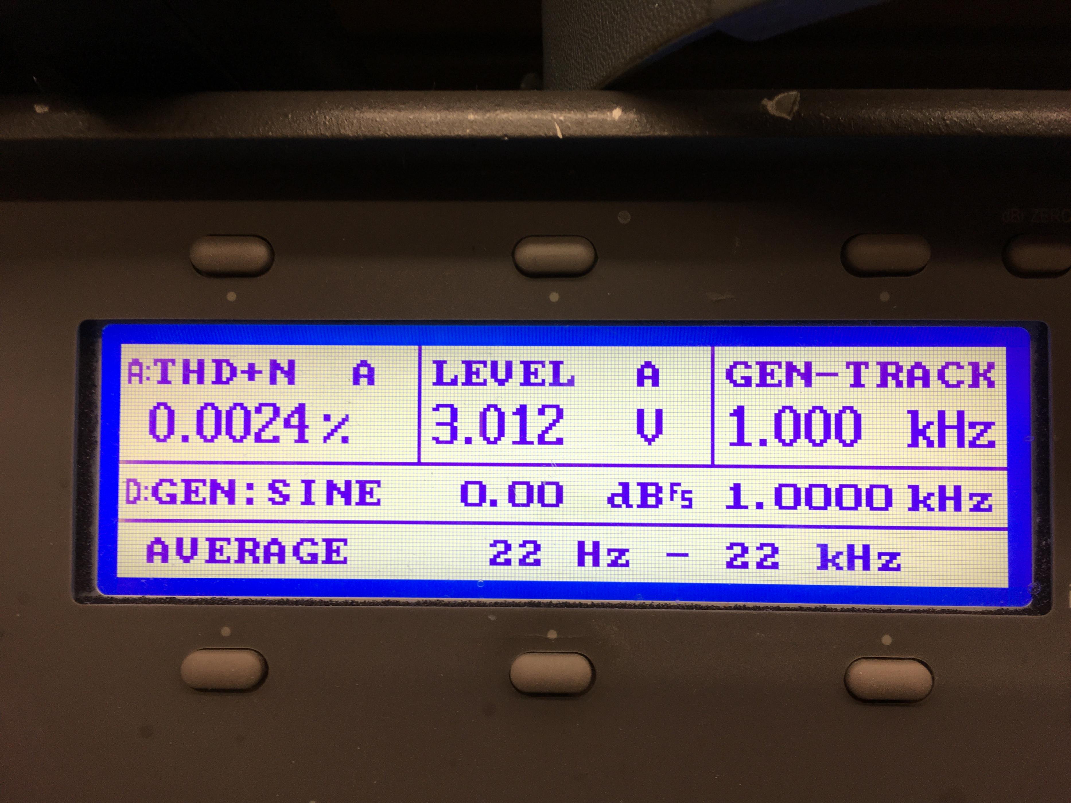

I have made a replacement for years for use in the Levinson No35. Today I dropped one in a Parasound D/AC-2000 and it works there too.
0.0025%
