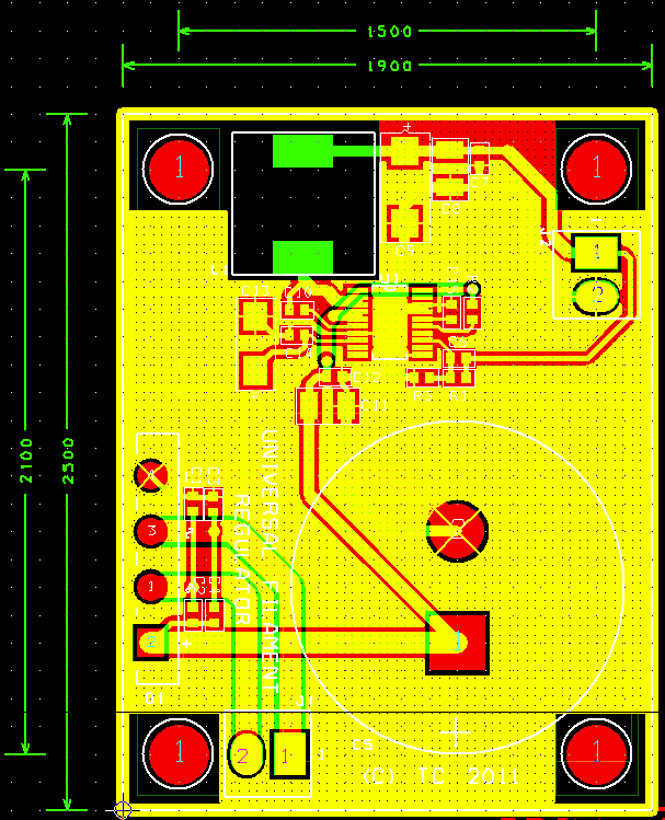

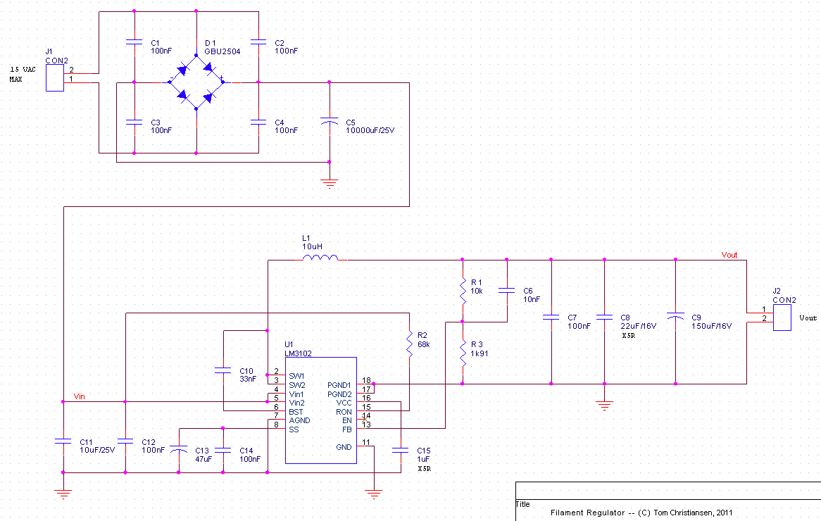

It turns out I can support the range of common tube voltages (1.5, 2.5, 4.2, 5.0, 6.3, 7.5, and 12.6 V) with a single inductor value. For some of the output voltages, I may have to increase the switching frequency from the nominal 500 kHz to keep the inductor ripple current within reasonable limits (250-ish mA). But that's easily done by swapping out a resistor.
Latest schematic and board layout are attached. The component values on the schematic are for 5.0 V out. The board is etching as I type... Just a quick prototype before I commit more serious money to a fab run.
~Tom

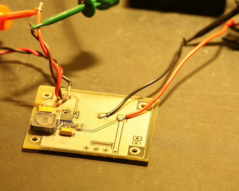

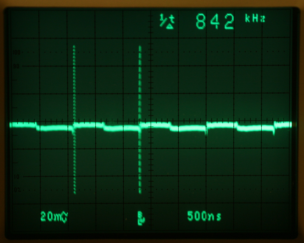

Folks,
The first results are in. I assembled the circuit as shown on the schematic, except I omitted D1, C1~C5 and just fed the circuit from a lab supply. I also didn't have any 68 kOhm resistors in 0603 package for R2, so I used 47 kOhm. As a result, I had to accept a higher switching frequency of approx 800 kHz versus the 500 kHz I designed for. Oh, well...
At Vout = 5 V; Iout = 2 A, the regulator shows a few mVpp of ripple voltage. The start-up time is about 5~6 seconds. Not bad for a day's work, eh?!
~Tom
