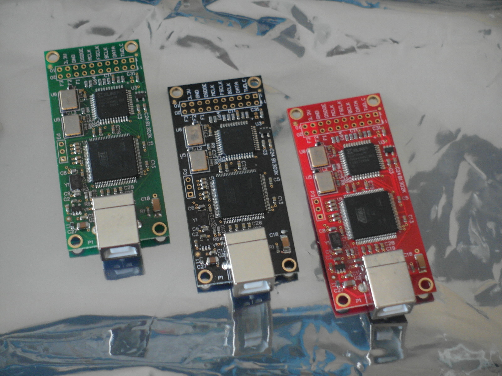

Help or insight wanted/needed.... Small but very annoying problem with Amanero board I bought in the group buy years ago:
When playing 384kHz content it will sometimes 'glitch' resulting in distorted (metallic) sound. Pause/play does not fix it, where a hard Stop and Play usually fixes the problem. Sometimes it just keeps glitching and I need to pull the USB plug out and restart. A google search didn't give me significant results.
Uninstalling the driver and reinstalling didn't help.
Power supply stabilized with 2200uF cap directly on USB connector, so that is not the problem.
The SDATA and BCLK signals appear to be early with respect to LRCLK; testing with 20ns delay helps but doesn't resolve the problem completely.
Problem occurs with Jriver and Winamp for example, but not with Chrome browser playing Szynalski tone generator.
If this is a known issue I'm sorry I missed it, but confirmation that other people have the same problem is also valuable.
Any help or insight in how to fix this issue is greatly appreciated. Thank you!
Testing with DSO revealed that the I2S output coming from Amanero contained incorrect data when I experience the glitch/choppy sound. Further testing revealed that using the WASAPI output setting in JRiver leads to occasional glitch problems, where KS and ASIO settings in Jriver are no problem.
Also when the Play silence for hardware synchronization option is set to 1 second, the glitch is present with WASAPI output option selected.
