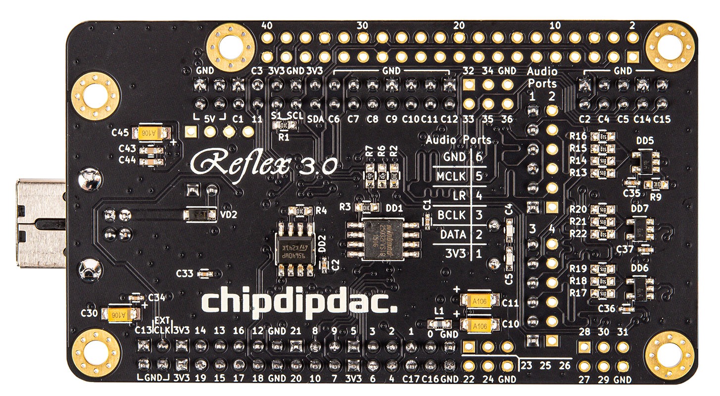

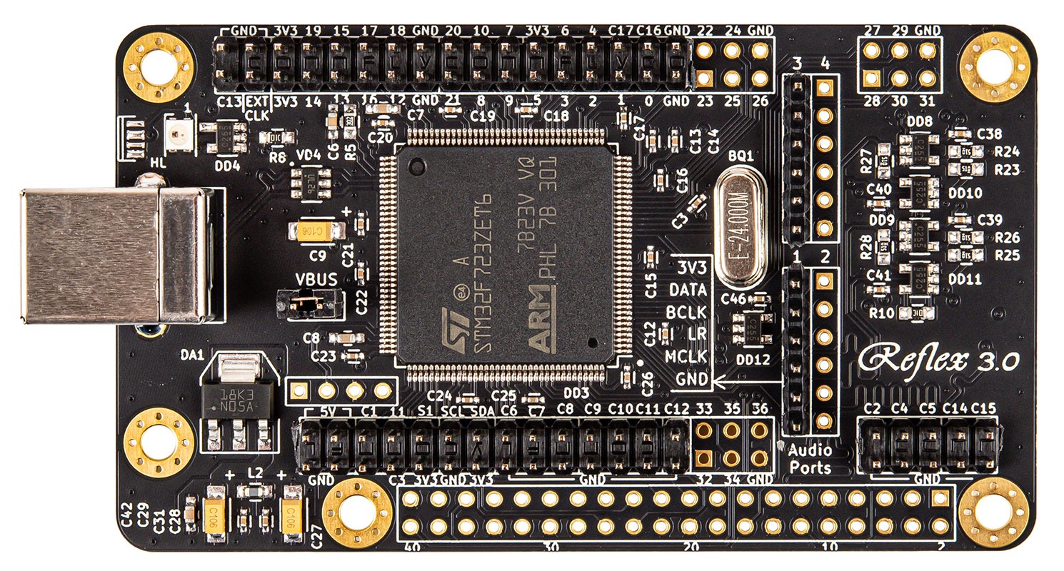

USB transport I2S 32bit/384kHz, DSD512, multichannel Out 4xI2S, stereo In I2s, surround up to 16-channels (TDM mode)
There are two of them. They're called Reflex 2.0 & Reflex 3.0
  • Playback of PCM format with a maximum sampling frequency of 762 kHz 32 bit, DSD512 native or DSD256 DoP playback.
  • Playback of S/PDIF - 384kHz
  • Plays multi-channel Surround audio in PCM format.
  • Recording stereo sound with studio quality with a maximum sampling frequency of 762 kHz 32 bit
  • Two I2C ports for controlling external DACs and ADCs
  • Two SPI ports for controlling external DACs and ADCs
  • Addressable LED (Neopixel) control port
  • Thirty two GPIO pins for connecting external controls and indications (potentiometers, buttons, switches, LEDs, encoders)

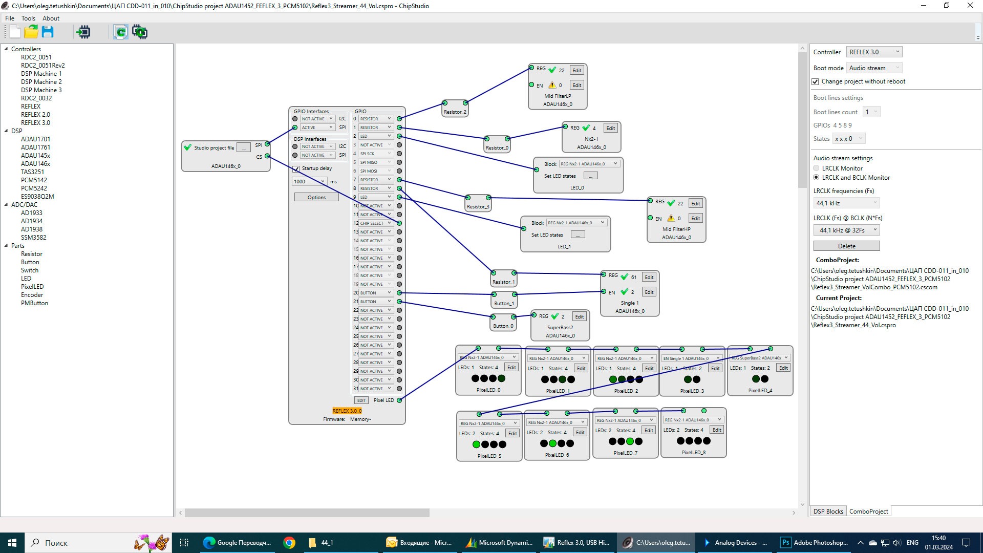

  • Programmable using ChipStudio, SigmaStudio, PurePathStudio software
  • Hardware adjustments
  • Free change of USB Vid/Pid
  • ASIO drivers from any third-party manufacturers

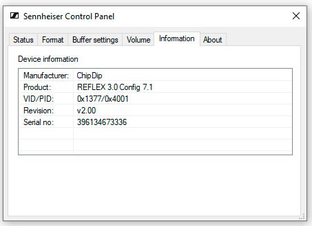

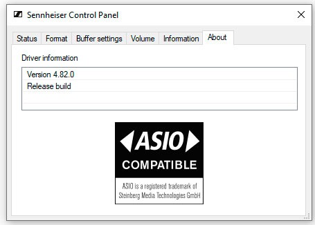

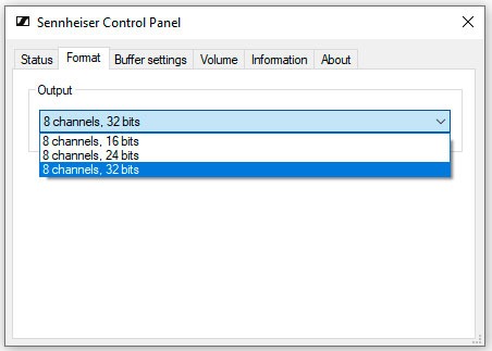

@ Works with any ASIO driver
Any pointer or download link is welcome? As is needed to run on Win 7, 8!

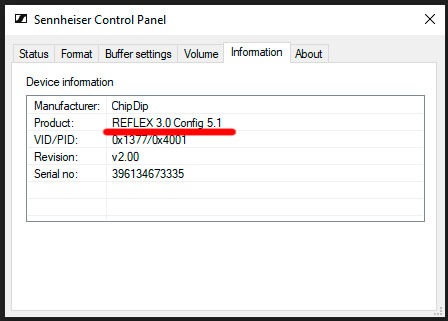

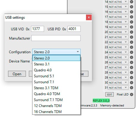

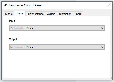

We will not provide an ASIO driver for our Reflex* USB transport. But if you need a driver for your USB device with our transport, please contact a vendor who can provide you with such a driver, such as Thesycon.
Another way. If you already have an ASIO driver for your device. You can change the Vid/Pid in Reflex. And it will work with your driver.
Third way. If you know the Vid/Pid of any device for which you can download a driver, and then replace the Vid/Pid in Reflex and it will work with this driver.
Replacing Vid/Pid in the ChipStudio. It’s not hard.
For example.
We know Vid/Pid for SENNHEISER HDV 820. They are like that: 0x1377 0x4001
We change them in the ChipStudio. For all configurations.
I did not change the manufacturer or name of the device, only values of Vid/Pid.
Download and install the ASIO driver. And it works with Reflex!
