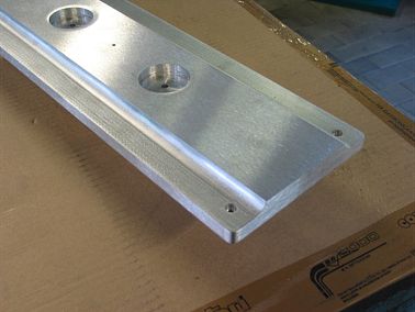

Now how do you make a BIG recessed hole like this with aluminium? :confused:

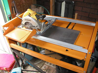

Circular saw table attachment
attachment.php
For anything that doesn't fit my mitre saw I'm using that setup. I bought that table long time ago at Canadian Tire and although desined for wood cutting it works great with metals. I'm using 7.5" circular saw which can slide above the table. I clamp aluminum pieces to the table. I was cutting 1" thick aluminum pieces as well as 2" thick heat sinks without a problem. When a piece is thicker I do two or three runs to complete the cut. Don't forget about the safety glasses.:cool:
Can ytou tell me the make and model of the saw table and where I can get one? It looks like something I can use with my wormdrive saw.
Thanks,
David
