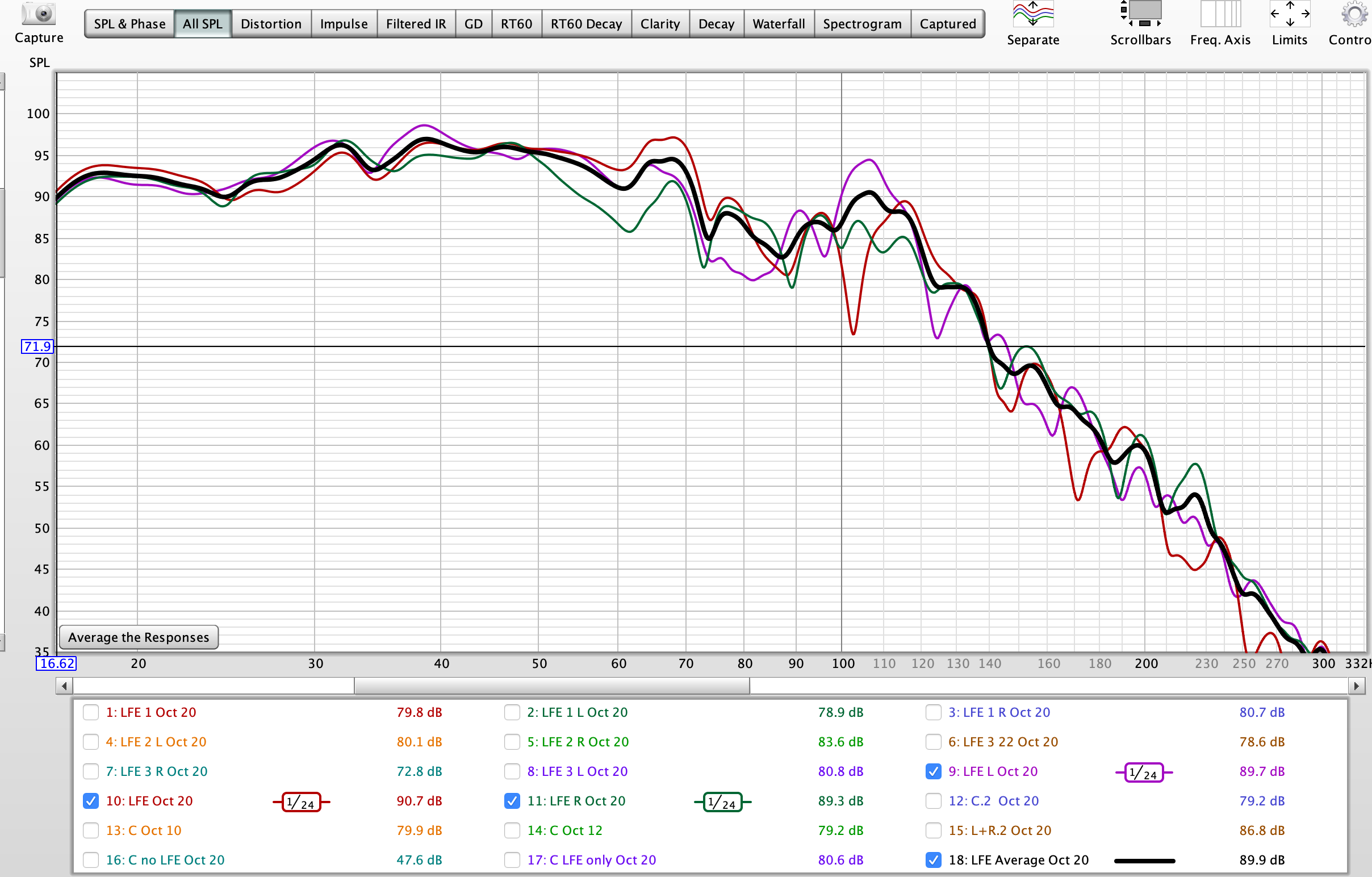

Sub 'pack' measured across the seating area, L is left seat, R is right seat, red is centre seat, black average
this is the subs before filtering in the Mini DSP, at the moment as I am only FLE and rears I have not put a filter on so probably losing a bit around 70-120 Hz if the cover is that high, hopefully its 80 Hz. At the For the fronts if I am just adding these in parallel I will add an input filter

should work fine
you can use an advanced biquad PEQ on the input to LP filter the fronts signal
matrix mixer to send both inputs to the subs
btw: have you tried the simulation software multi sub optimiser? you should be able to really get great results with 3 subs and 2 fullrange fronts
