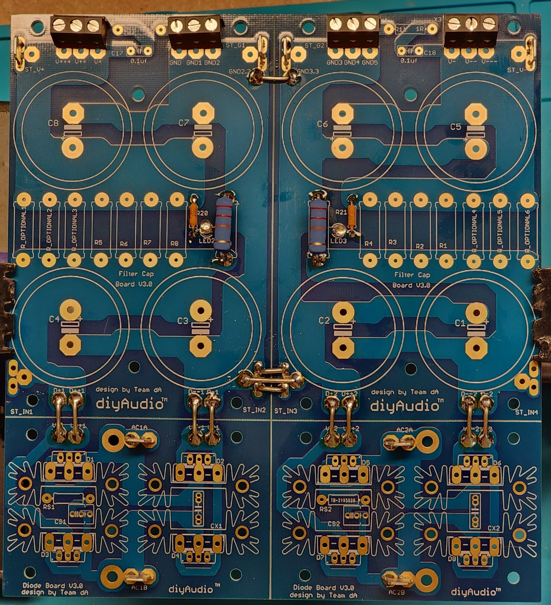

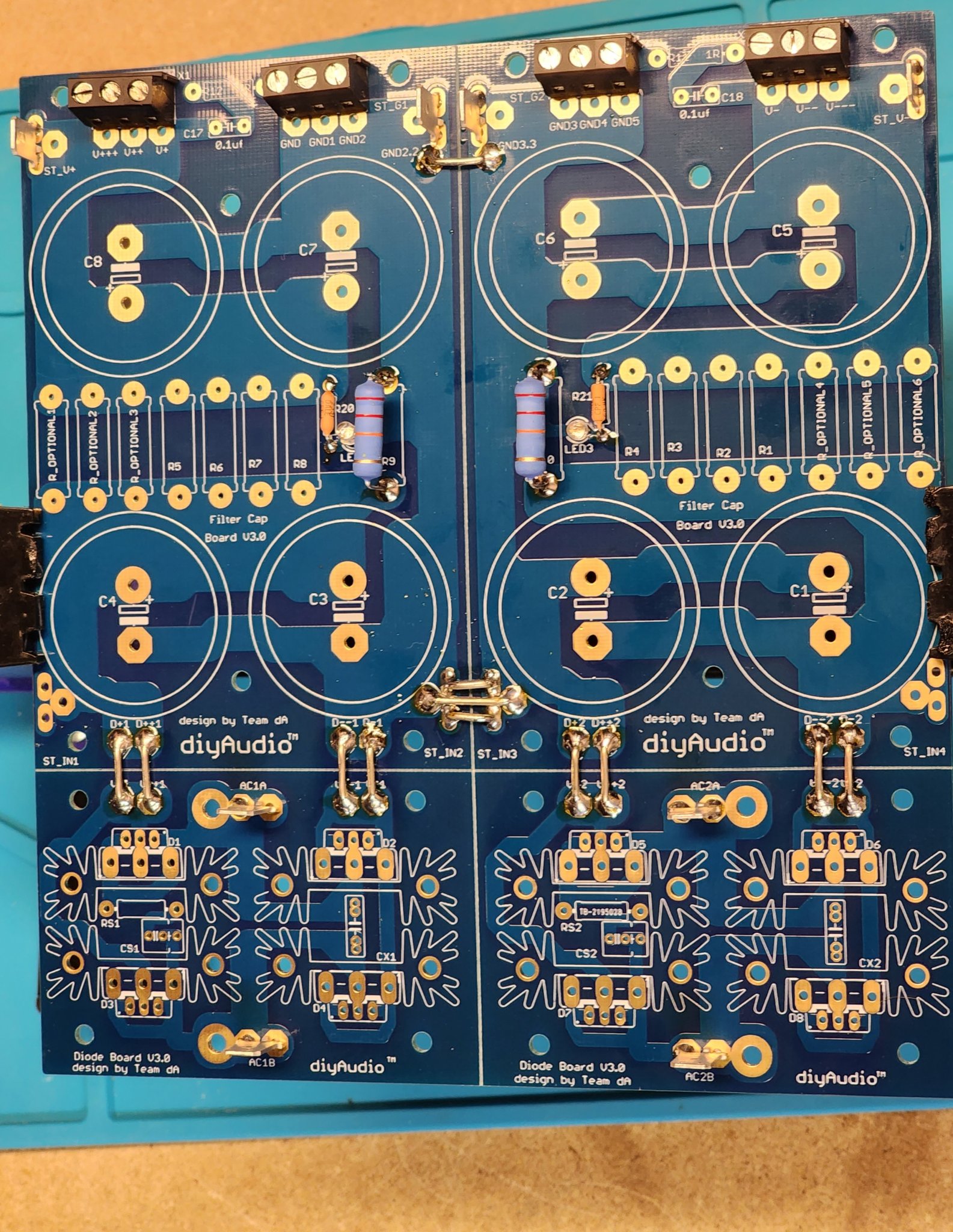

I am currently building a Honey Badger. I have one board finished and will start the other one tomorrow. I would like to begin putting together a parts list for the PSU.
I will be using a toroidal transformer with dual secondaries that produces 45 volts and is rated at 625VA according to the manufacturer. I recently received my V3 universal power supply pcb and suddenly have more questions than answers. The potential options are overwhelming. I am relatively new at this and could use some guidance.
I've done some research on this thread and found a lot of information, most of which doesn't help me decide how to choose components and populate my board. There are some basic PSU recommendations in the Honey Badger build guide but it doesn't get specific.
I would like to keep the V3 board intact and use on-board rectifiers because this would reduce the wiring involved in using bridge rectifiers.
My questions:
Do I need to utilize the optional Pi resistors?
Can I forego snubbers since this is a Class AB amp?
Do I connect the ground tabs of the board even though I'm using dual secondaries?
How do I calculate the resistor value of the LED resistors with 63 volt rails?
I apologize for the basic nature of these questions, but power supplies confuse me and I'm pretty new at this. If anyone has built the Honey Badger and sorted through these decisions I could use some guidance. Even a BOM or photo of a finished HB PSU would be helpful. Thank you in advance for your time and patience.

No.
Always forgo the output snubber. Input snubber a good idea if you have Quasimodo. If not, just leave empty.
Yes, you need a bipolar (+/-) supply. Make sure you understand how to connect this.
Roughly 1K per volt, so use something around 60k resistor.

If the dual secondaries on the 625 VA transformer are 45 Vac , that will give about +/- 62 Vdc rails .
From what I understand , anything above 50 Vdc can be lethal . Which , as I'm told , why fork lifts run on 48Vdc .
PLus with large electrolytic caps charged up to 62 Vdc , you'll be able arc weld with this .
I don't know the Honey Badger Amp , but does it really need +/- 62 Vdc rails ?
People often avoid suggesting actual component makes and models on the site ,
because even the slightest hit of " boutique " audio components , breaks out into argument about
spending silly money on " boutique " components .
However, highly recommend buying components of off well known electronics vendors ... and not Eb y .

Suggest using the Pi resistors - those 3 W Panasonic metal oxide power resistors are very popular on this site .

Note : its critical that the first bank of electrolytic caps on the power supply board be able to handle the ripple current .

6L6 has a complete discussion on wiring the board .
Suggest soldering the jumper wires first .
A schematic comes with the board - the power diodes are just wired in a bridge configuration .
Its very similar to the F5 power supply shown here in post #1
https://www.diyaudio.com/community/threads/f5-psu.211649/
The issue maybe that the V3 schematic shows 2 diodes in a single TO-247 case .
Looking at the board , you'll see pins 1 and 3 of the power diodes are connected
So the 2 diodes in TO-247 case are wired in parallel .
Make sure you buy diodes that match the pin out of this board .
As for the LED resistor , as I recall the voltage drop across a forward biased LED is 2.2 Vdc
and the max current is 10 mA - but go with something like 6 mA .
10 K = ( Vrail - Vfb ) / bias current = ( 62 Vdc - 2.2 Vdc ) / 6 mA
Its going to be dissipating 0.36 Watts . Typical me , I way over rate components , so go with 1 Watt

Actually , do you have a small 50 VA or 100 VA transformer with something like 9 or 12 Vac secondaries ?
If so , you could temporarily lightly solder on one secondary to the Power Supply board and test the board this way .
Again try to build up the board 1 stage at a time , then when the board is totally populated , then solder on the 625 VA beast .
Also , remember the supply is always going to need a load to take measurements .
A temp load resistor of something like 10 K at 1 W will be fine .

Hello Forum Members,
I am currently assembling a V3 Universal PSU board for my Honey Badger build. The transformer used will be a 625 VA version with dual secondaries. The output voltage is 45-0-45.
I would like feedback on the attached photos since I am new at this and a little unsure of myself. When working with high voltage, I would rather be "safe than sorry," as the saying goes. It is my understanding that for the purposes of my Honey Badger, snubbers and Pi resistors are not required.
My specific questions are: Does the board look like it is assembled properly as it relates to the jumpers? Are there any obvious errors in assembly at this point? I want the bleeder resistors (R9, R10) for safety reasons and they are 22k, 3 watt, flame resistant versions. The LED's are green with 60k resistors (R20, R21), as the rails will be about 62 volts.
I have not yet installed the heatsinks, capacitors or diodes as they would have obstructed the view of the current components.
Thank you in advance for your help!

A dual secondary transformer has 2 distinct pairs of secondaries , such as 45 - 0 Vac and 45 - 0 Vac .
A transformer with 45 - 0 - 45 Vac secondaries is generally referred to as a center tap transformer .
The diode bridge is wired totally different for a center tap transformer .

Thanks for the reply @Uunderhill!
It appears that I know even less than I feared. Looking at the mechanical drawing I am pretty sure that my transformer has two secondaries and my description as 45-0-45 was an example of my limited knowledge.
I will post the data sheet with the mechanical drawing showing the windings as soon as I can separate that page from the other 5 pages listing all the possible ratings of this transformer. Thank you for your assistance and your patience with newcomers such as myself.
