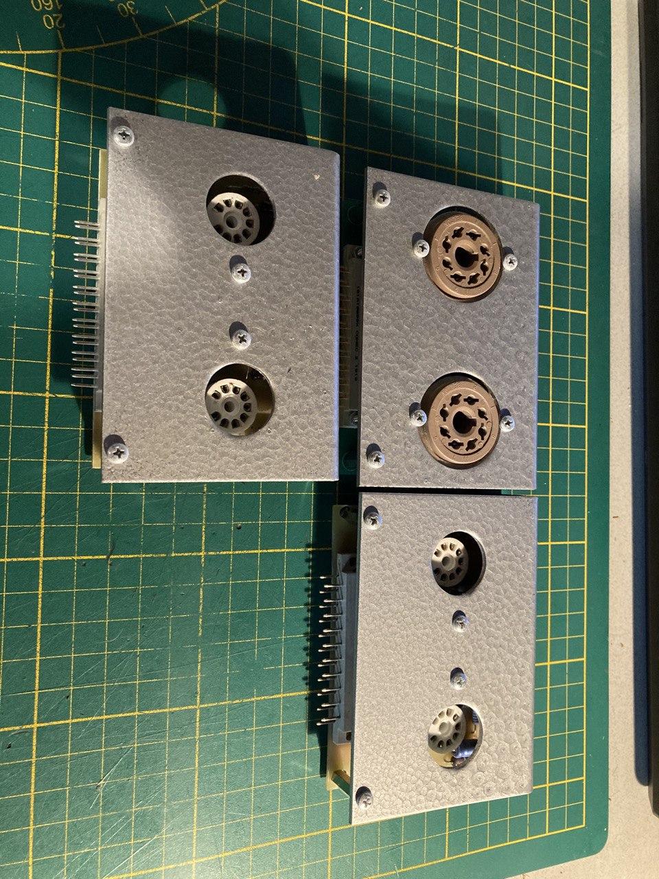

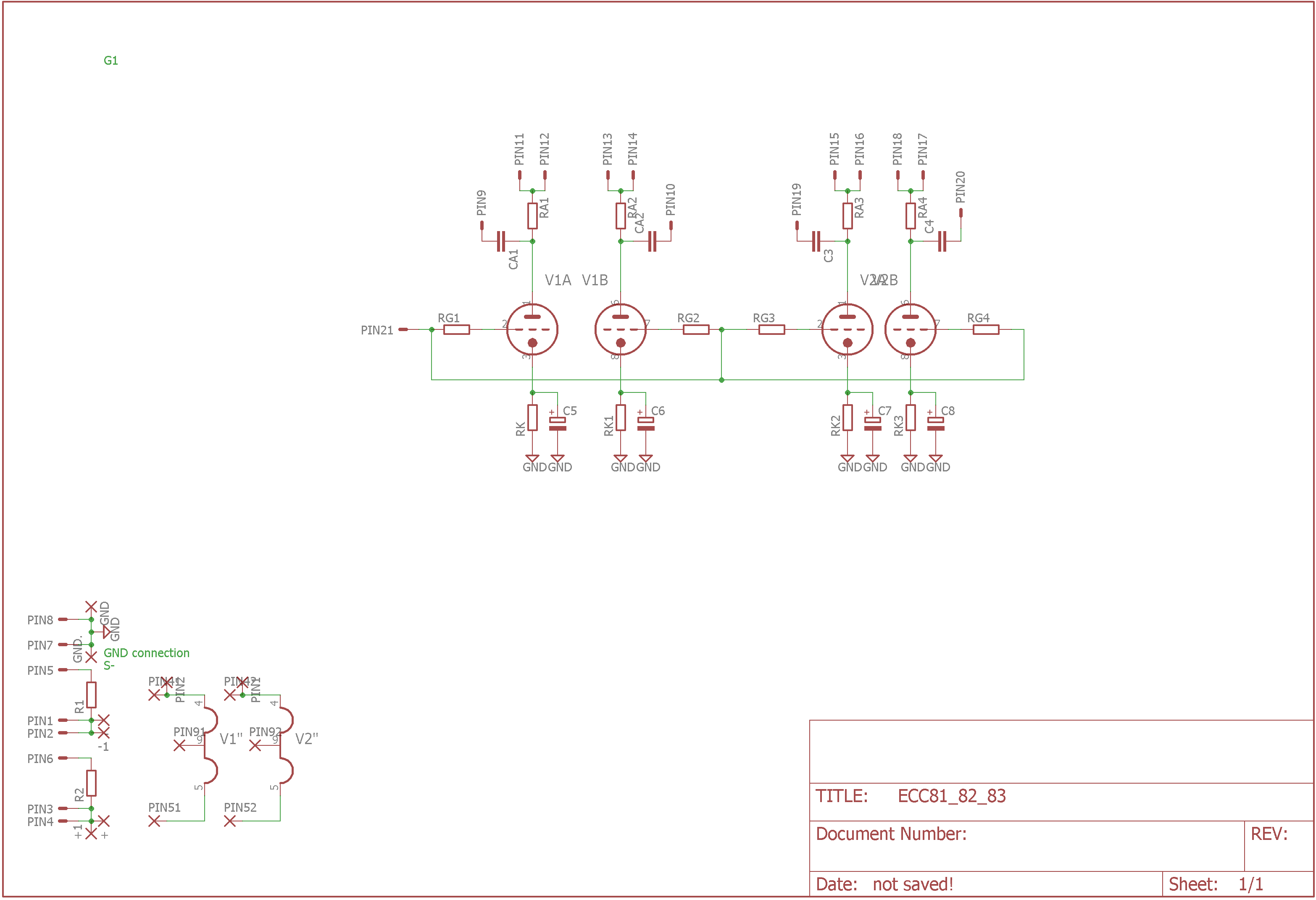

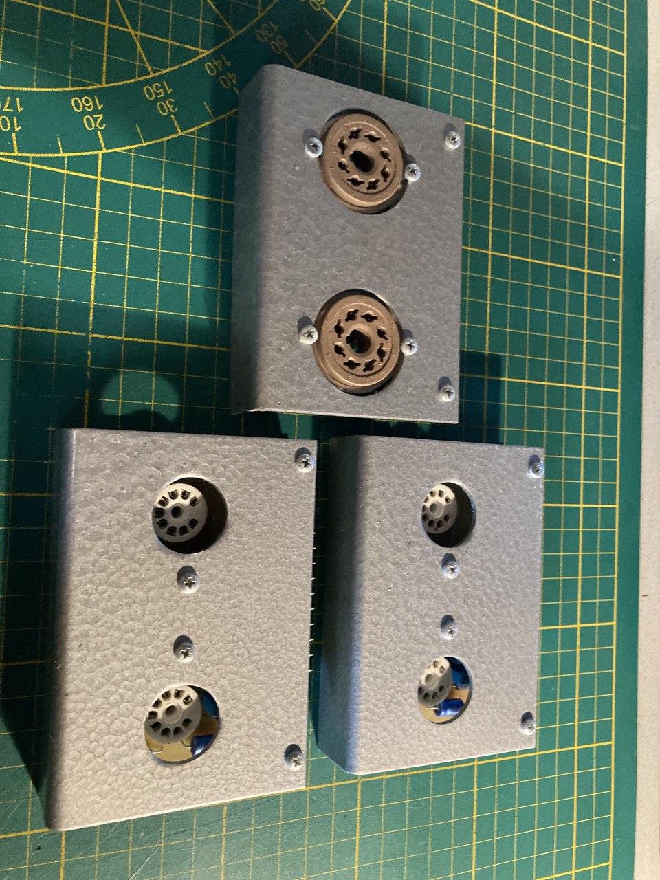

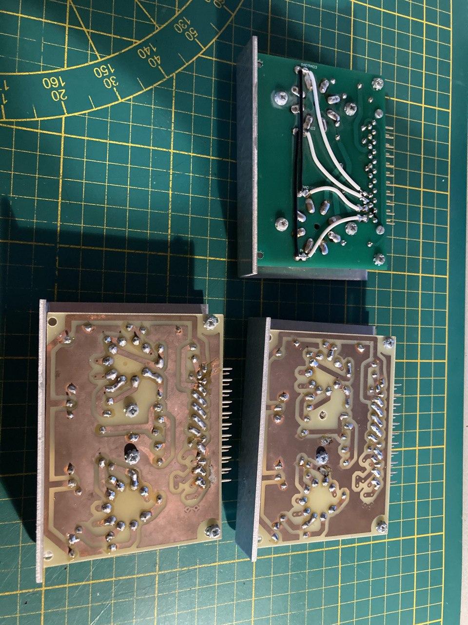

DIN41617 based boards for matching tubes.
I got something along those lines in my Dropbox somewhere, let me dig it out. Its a series of fixtures that can also be used for noise measurements. I designed those and still have a big box of prototypes somewhere.
They where based around some obscure 21P DIN41617 connector, and are all the same size. Ideal for anyone that is building a tube matcher.
Edit, i found the map, but its a bit of a mess right now.
Here's an example of the test board for EL84 matching jig, back from the time i was still etching my own boards. Like you might have guessed from the cathode resistor and bypass these are the cathode bias variety.
I would have to look up the connections, but these where made with remote sensing for the heaters in mind, to get the most accurate results. The noise measurement variety has coupling caps on the board that are connected to two pins, so you can measure the noise on four sections of dual triodes simultaneously.
thanks, 9 pin miniatures and octals....some sort of a screening bed for tubes that will find its way to a finally built amp...

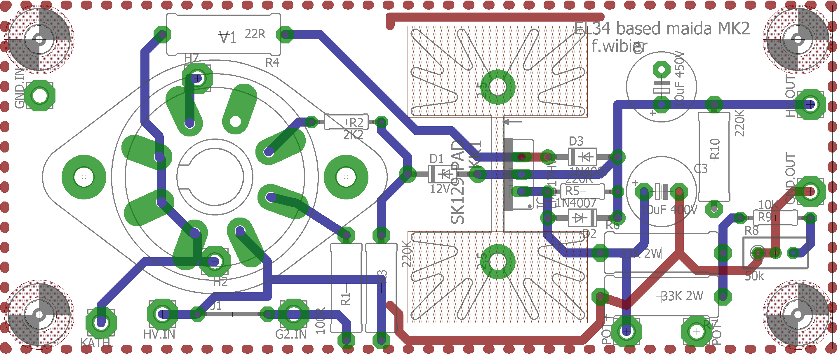

LM317(HV) EL34/KT88/6L6 tube maida MK2 single version.
I have boards available for this project, and can also supply parts.
These are ideal for feeding phono stages.
This is a simple tube based Maida-style regulator. Suggested IC is either LM317AHVT or TL783.
Heatsink is a SK129-38.
Cadjust 10uF is required for stability.
Please keep in mind that if you want to use this as a wide adjustment lab supply, that is possible if you run the pass tube with a floating G2 supply, and use a higher voltage regulator like the LM317AHVT or TL783*
*The TL783 needs minimum 10-15mA load current to regulate, so you need to add a 10M45S current sink to the output to keep the IC in regulation in case of low load operation. In that case you can get away with a triode EL34 up to about 500V input. Set the 10M45S to about 10mA and set the divider current to approx 3mA

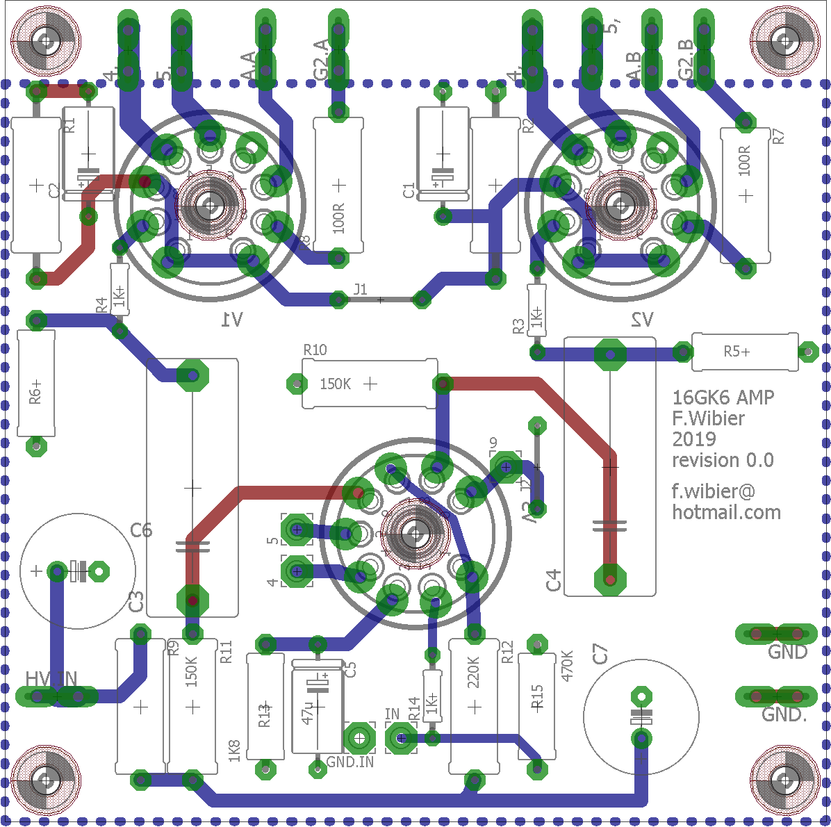

ECC82 16GK6 amp
This is a board for 16GK6 outputs, a lesser known EL84 equivalent.
Boards are OK, they are playing for well over a year with a friend of mine.
Driver is a ECC82/12AU7 from the top of my head, but i might be wrong here.
Some values are missing, feel free to add these yourself, its a minor inconvenience.
Sockets are mirrored, made for under chassis mounting

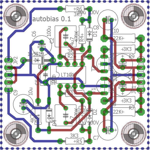

Bias servo modules
These are modules for a bias servo for class A/AB amps.
Dimensions are exactly 2x2'' and the connectors and mounting holes are on a imperial grid, so these fit on veroboard.
These work great, but they have one requirement, that is that the power to the opamp needs to be interrupted until the tubes are warm. Otherwise the servo will try to upregulate cold tubes and given the slow time constant of the module this will inevitably lead to massive current draw.
I think you can get away with LM358 instead of that LT chip, provided you up the value of the decoupling caps on the resistor divider.
Edit, Ive also added the .LBR file for the footprint of the board.

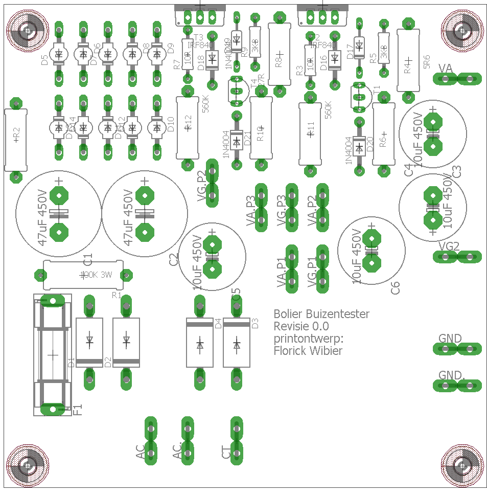

Tube tester anode and grid supply (mosfets)
The schematic for this board is from the project of a Dutch DIY enthusiast, its a board for the two high voltage supplies in a parametric tube tester. The schematic is not rocket science at all, and will function as it should.
Its just two mosfet source followers fed from a potentiometer that is in turn fed from a zener stack. P1, P2 and P3 mean pin1 pin2 and pin3 of the potentiometer.
Vout 0-250V, current can be set by the resistors.
R6 and R10 are the only hard to understand components in the supply, if you choose to populate these resistors you can have a crude but effective foldback limiting.
The other solution is just to use Mosfets that are tough to kill, and in TO220 there is little competition to the IXTP15N50L2, if you use these on a decently sized heat sink, there is little chance you can blow them up. IXTP15N50L2 IXYS - Transistor: N-MOSFET | unipolar; 500V; 15A; 300W; TO220-3; 570ns | TME - Electronic components
For best results its recommended to use a 100K 3W 10 turn pot for the voltage control.
Allthrough you CAN isolate the mosfets its better to screw them directly to the heatsink with some thermal grease, and isolate the heatsink on a piece of Phenolic board.

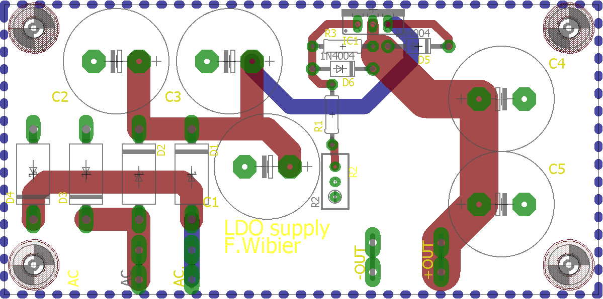

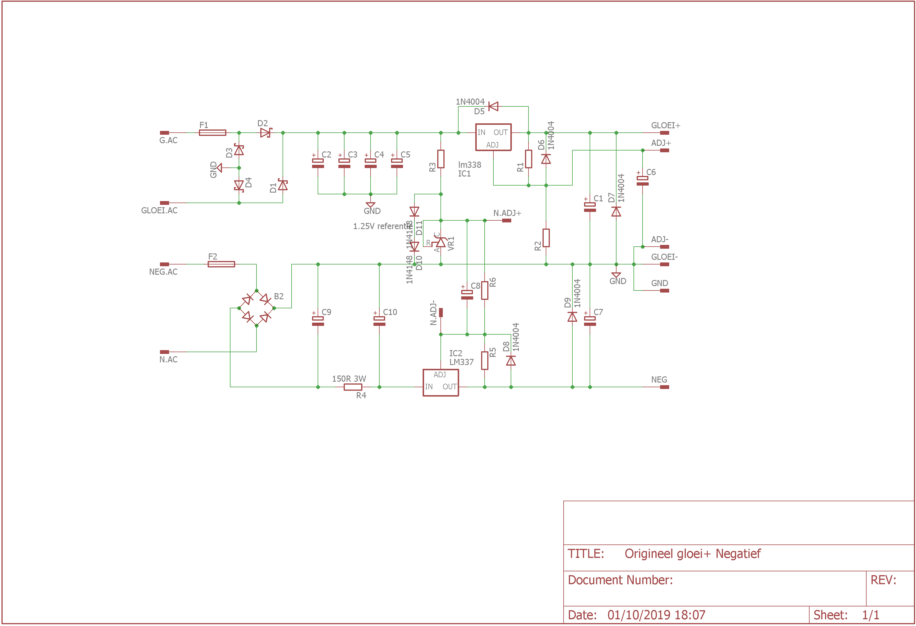

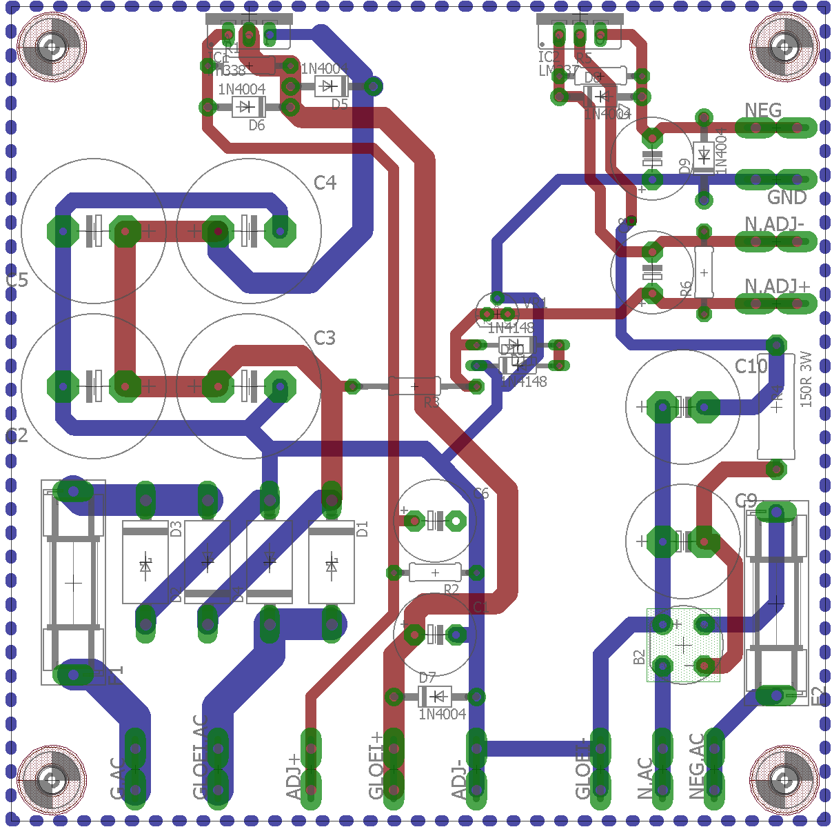

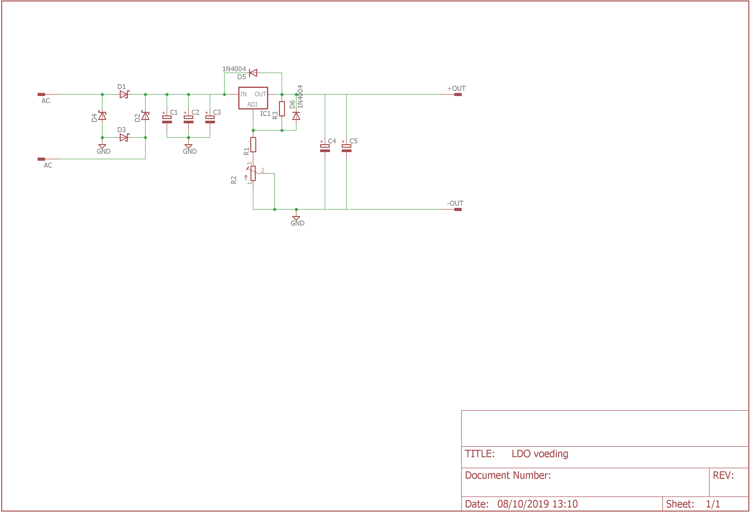

Tube tester negative and fillament DC supplies.
These are the Negative control grid supply and the filament supply.
The control grid supply takes a +1.25V reference from a LM385-1.2. So it will regulate from 0 to about -30 volts. This supply is designed to operate from a 24VAC PCB transformer.
The Filament regulator can either be a LM338 or a LD1085 3A LDO regulator, but the latter needs 100uF output capacitance for stability.
The AC input of this supply depends on what you want to do with the tester. If you only want to do 6.3V or lower, 8VAC ~4A will suffice.
Diodes are SB560 and a generic small bridge rectifier of at least 100V 1A, reverse polarity diodes 1N4005-1N4007.
