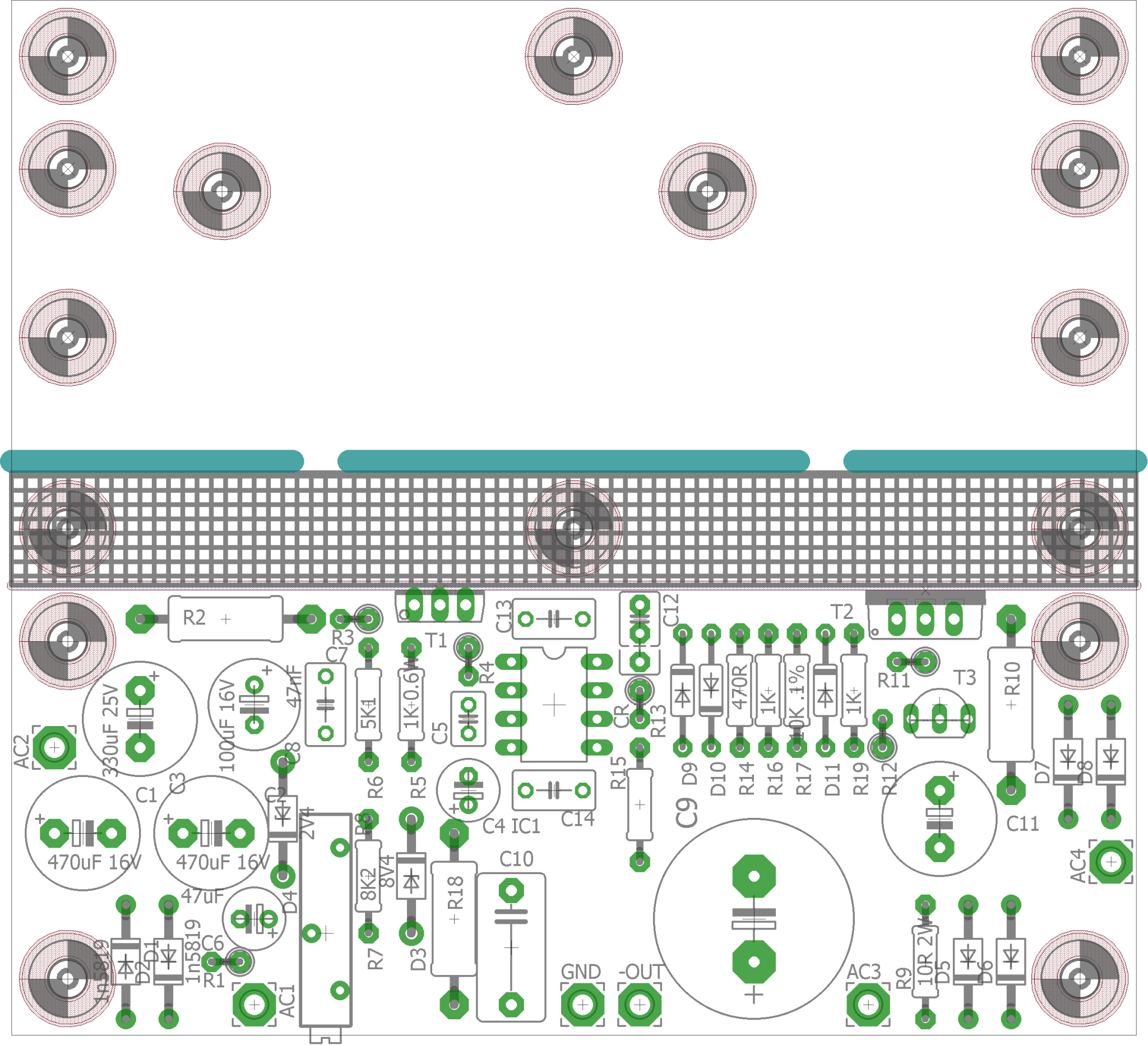

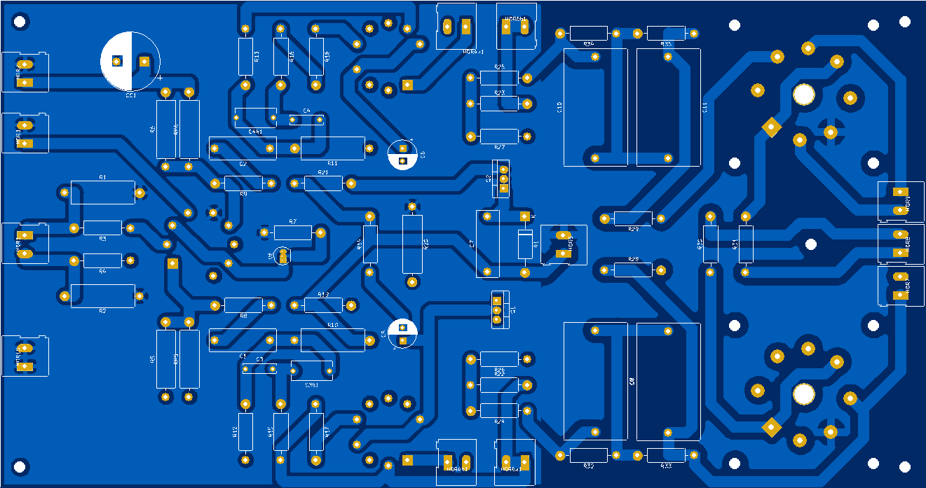

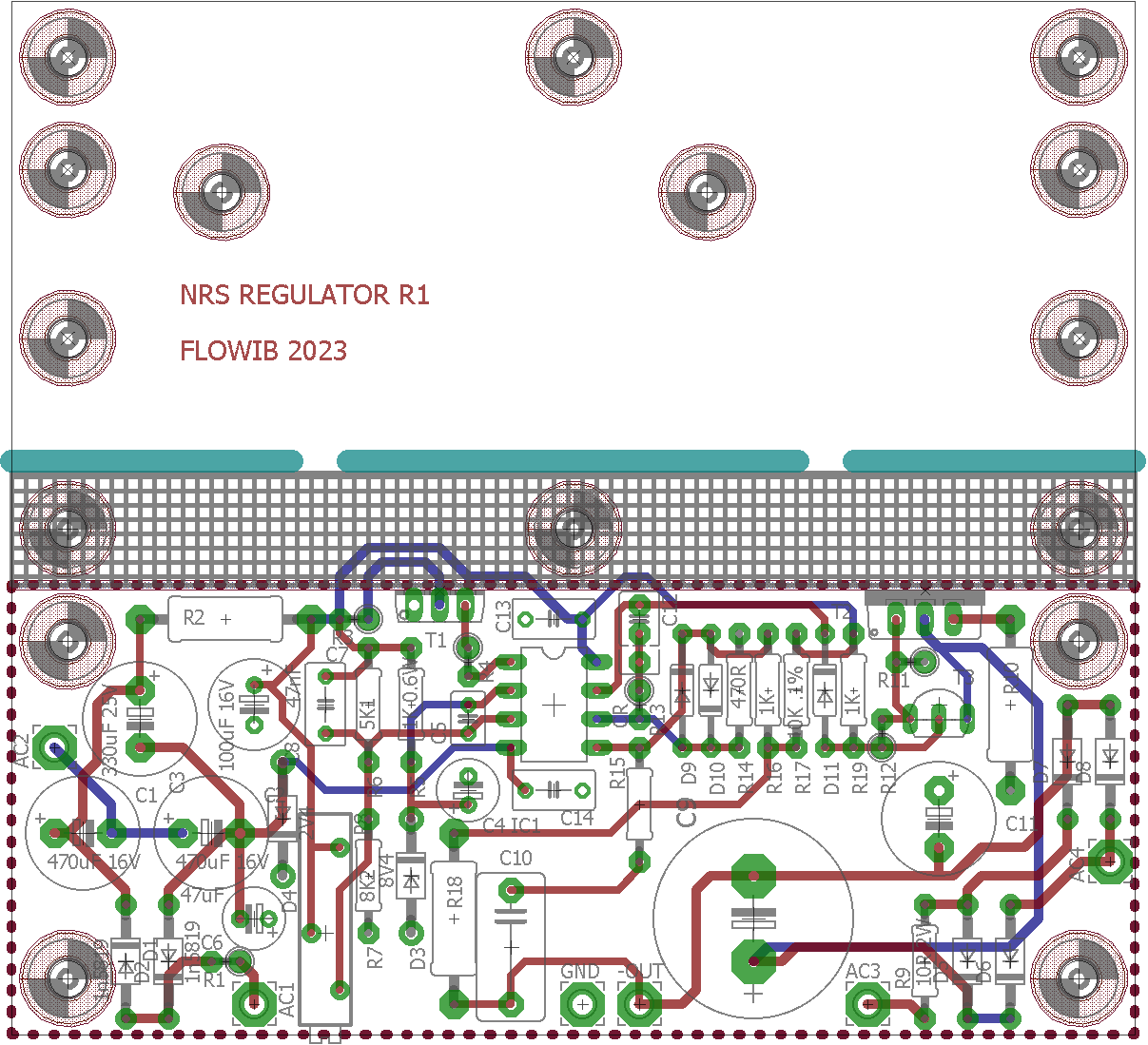

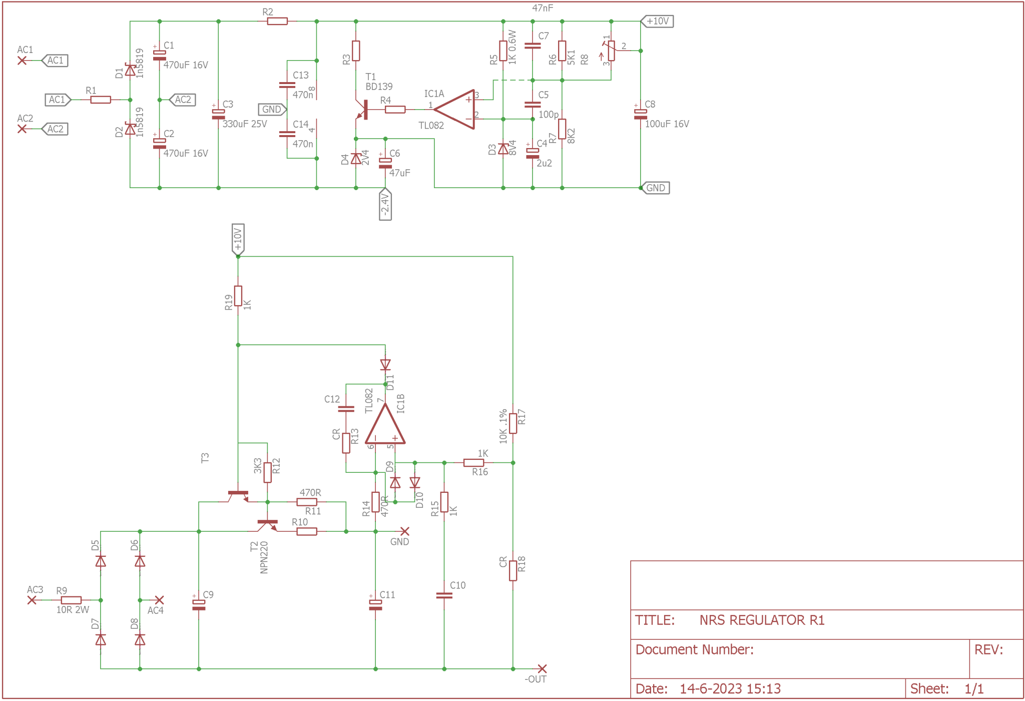

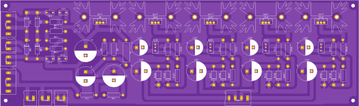

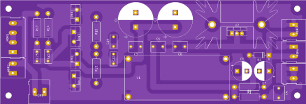

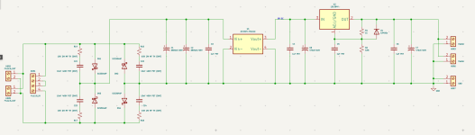

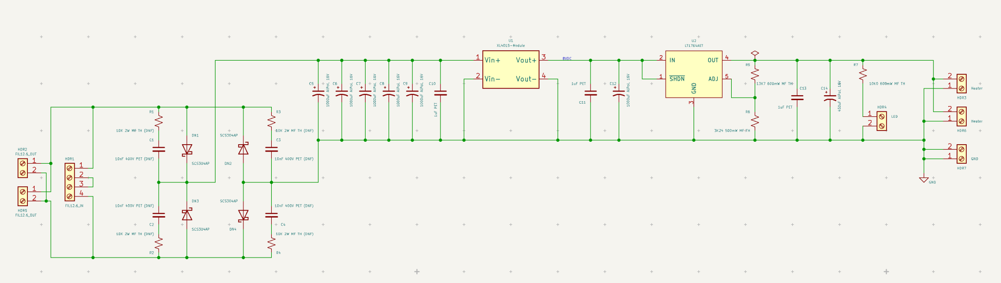

I designed a series regulator for negative voltages (NRS is a Dutch Abreviation for Negative grid voltage)
PCB can be used up to minus -250V at max 50-100mA, consult TIP50 SOA graphs to see how much current is allowable in your use case.
This is a series reg design, It uses the 6.3V normally used for heaters for a voltage doubler that gives 17V no load, this is used for a shunt regulated PSU that gives +10V reference, and -2.4V so TL082 opamps can be used.
R13 and C12 are critical. I need to simulate in spice for the value when i have time.
R18 sets the output voltage at 1K per volt. normally I would use a 2W 50PPM metal film type.
The pass stage is TIP50 with a MPSA42 driver.
Im trying a new build form factor, I'm using 10x40mm Aluminium bar stock to serve as an interface between PCB and Heatsink.
I have ordered ten boards to play with, can supply assembled and tested modules.
V4LVE.

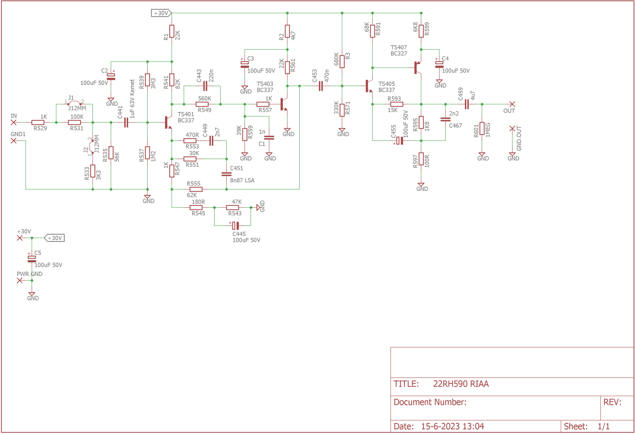

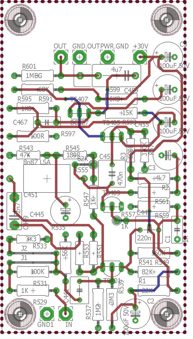

This was a little fun project, its a transistor RIAA, so sorry for posting it in the tube forum. Its the RIAA input section plus VAS from the Philips 22RH590 amplifier.

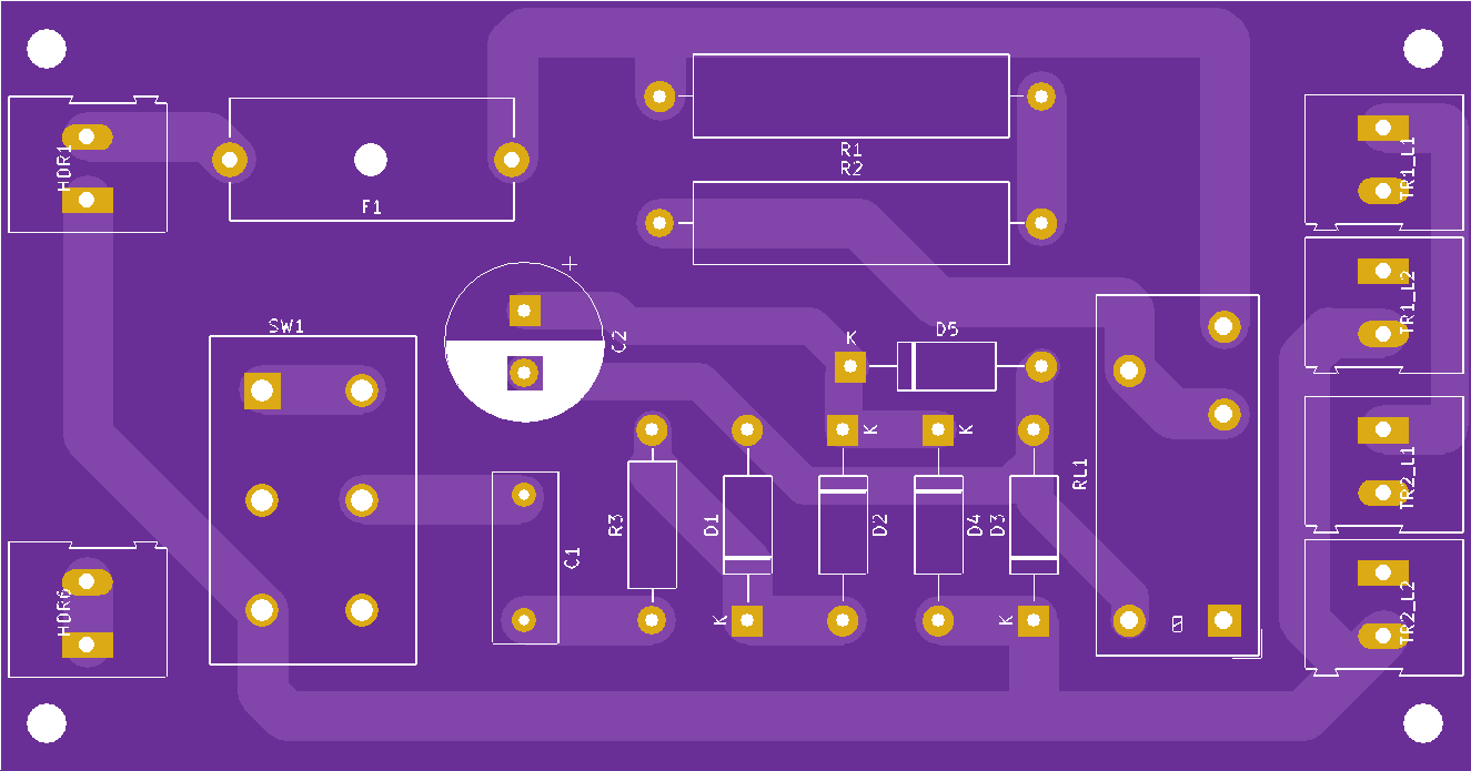

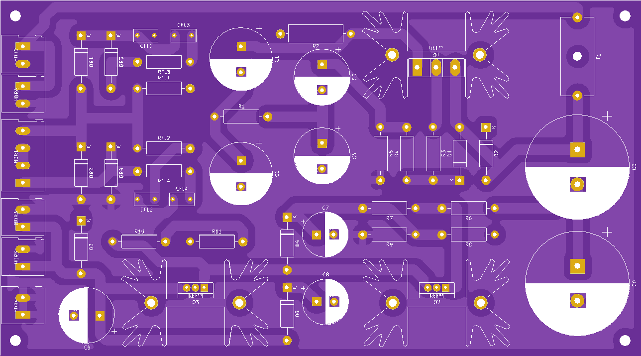

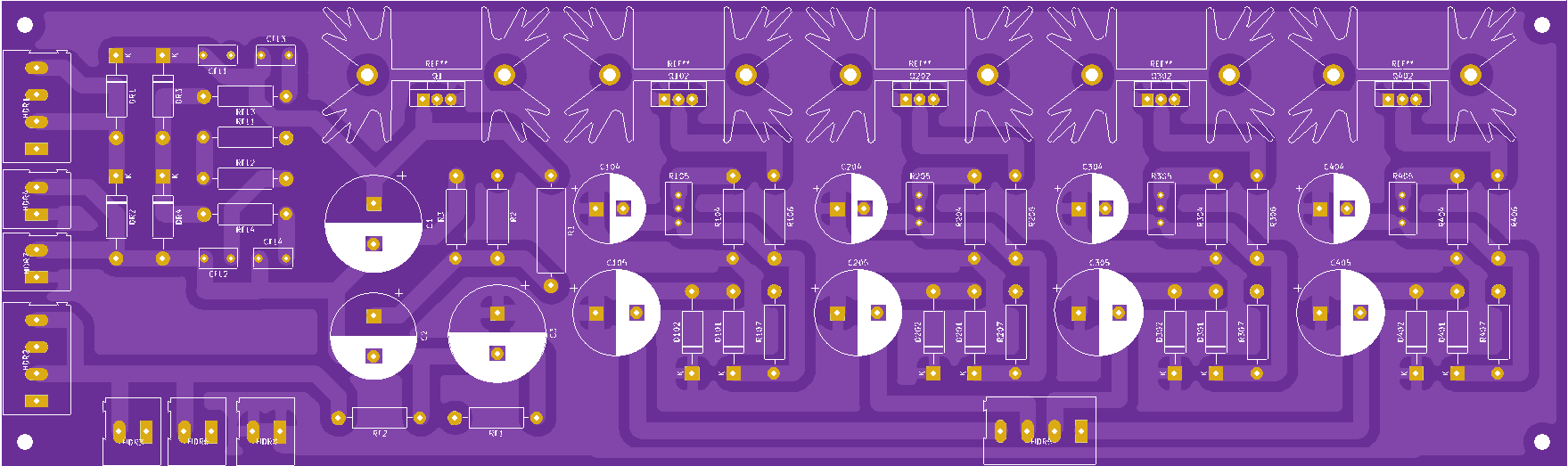

BUG Power PP Amp, my design attached. Included:
  • PSU
  • GSU
  • Simple softstart
  • DC filament
  • amp, in normal and flipped mirror design
A project description with more infos in this board under my name. This was my best of all ever build project. So much fun and satisfaction not to speak about the sound…
Ps.:
Direct wire the 6E5P filament supply with twisted solid wire to the socket. Using the terminal blocks on the board will introduce hum. The GU50 sockets can be mounted on the board if you extend them over the board by about 30mm using posts (holes are on the PCB) and run wires direct down to the board. Don’t put the socket on the PCB directly the GU’s will become quite hot (~260-280 °C). With this, 400mA bias current and XLR balanced input you’ll have a low THD fantastic sounding amp!

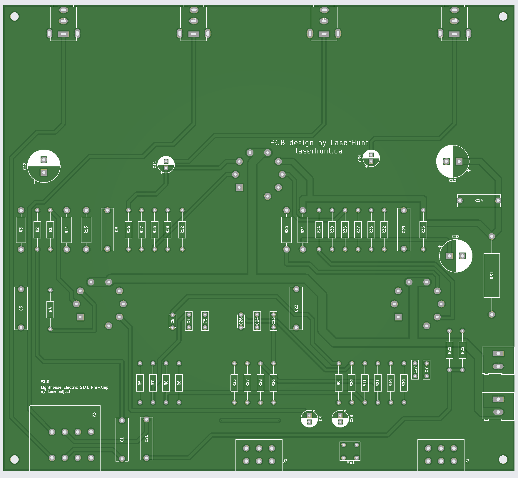

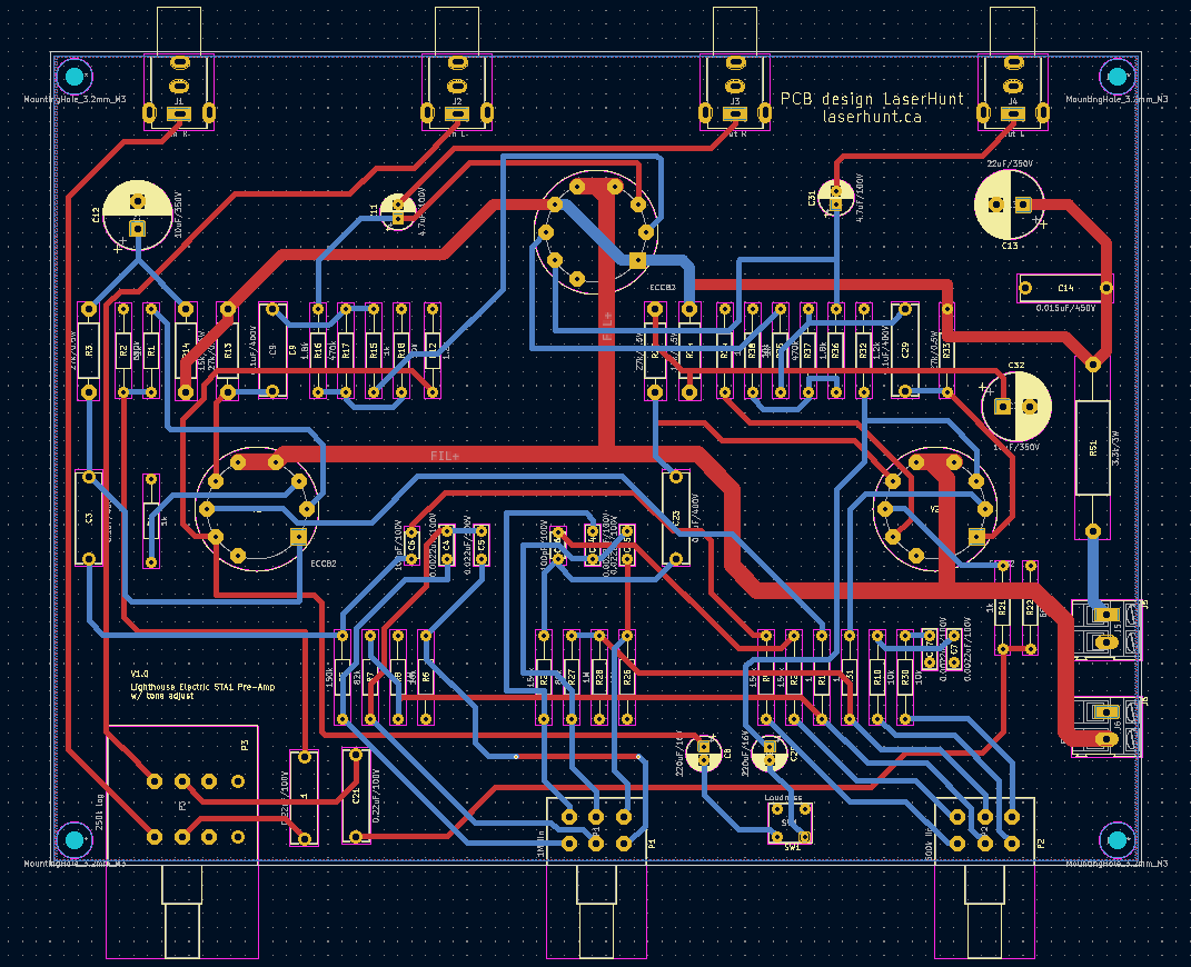

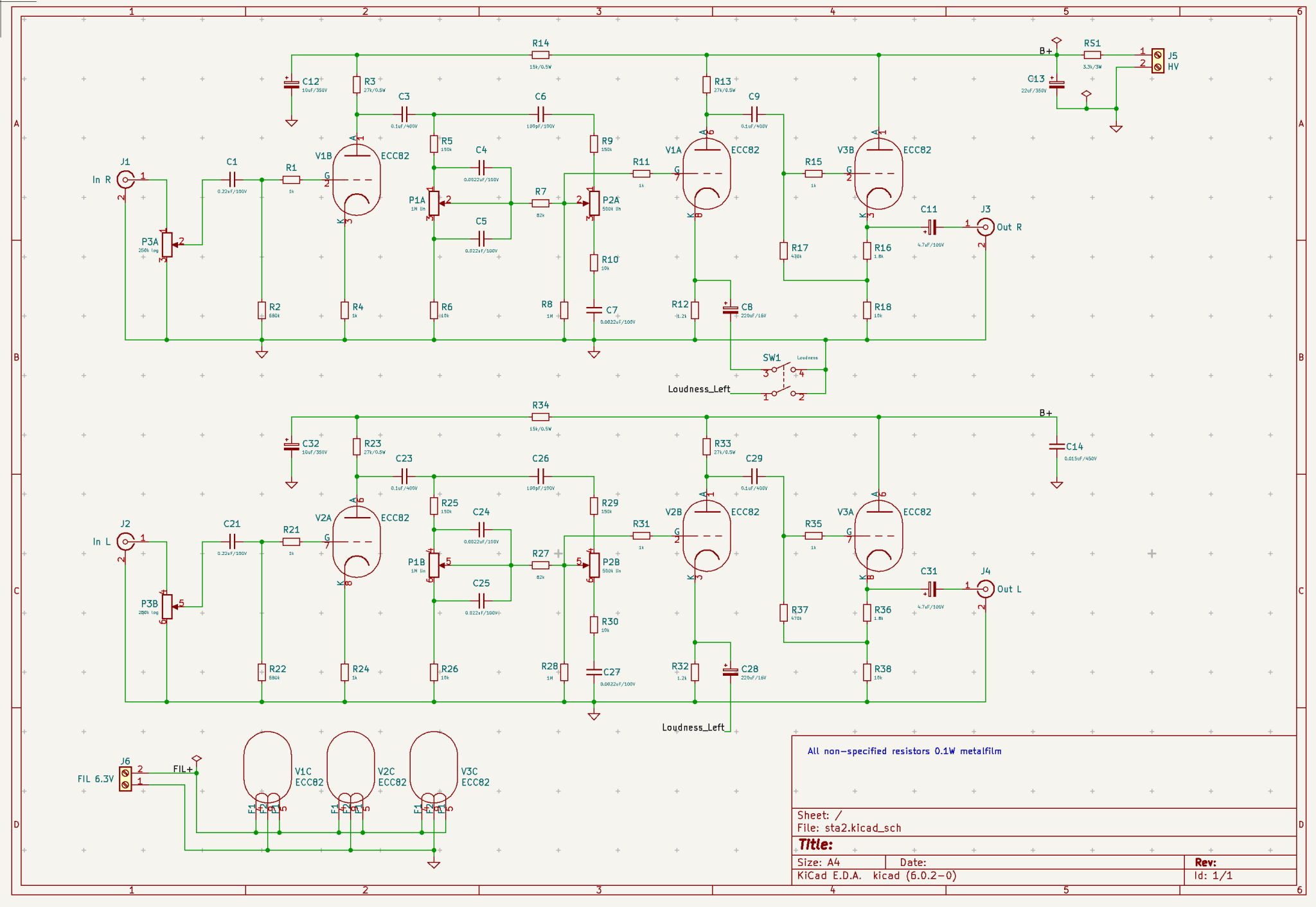

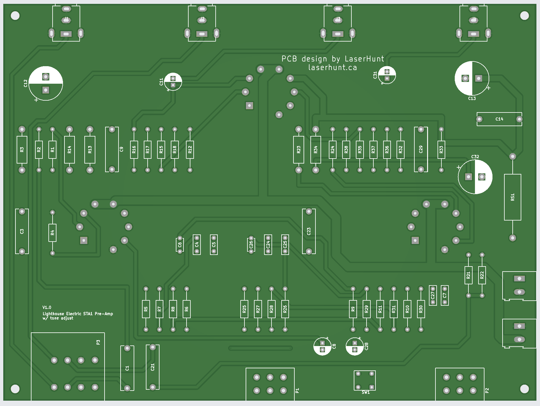

Here’s my re-incarceration of the Lighthouse Electric Sta 1 pre-amp, which has a ton control!
Two versions, mirrored and normal, so, one can decide on which side of the board to stick the tubes.
I also made two versions, one at a bigger size to fit perfectly BRZHIFI BZ2204 series Aluminium case com Aliexpress.

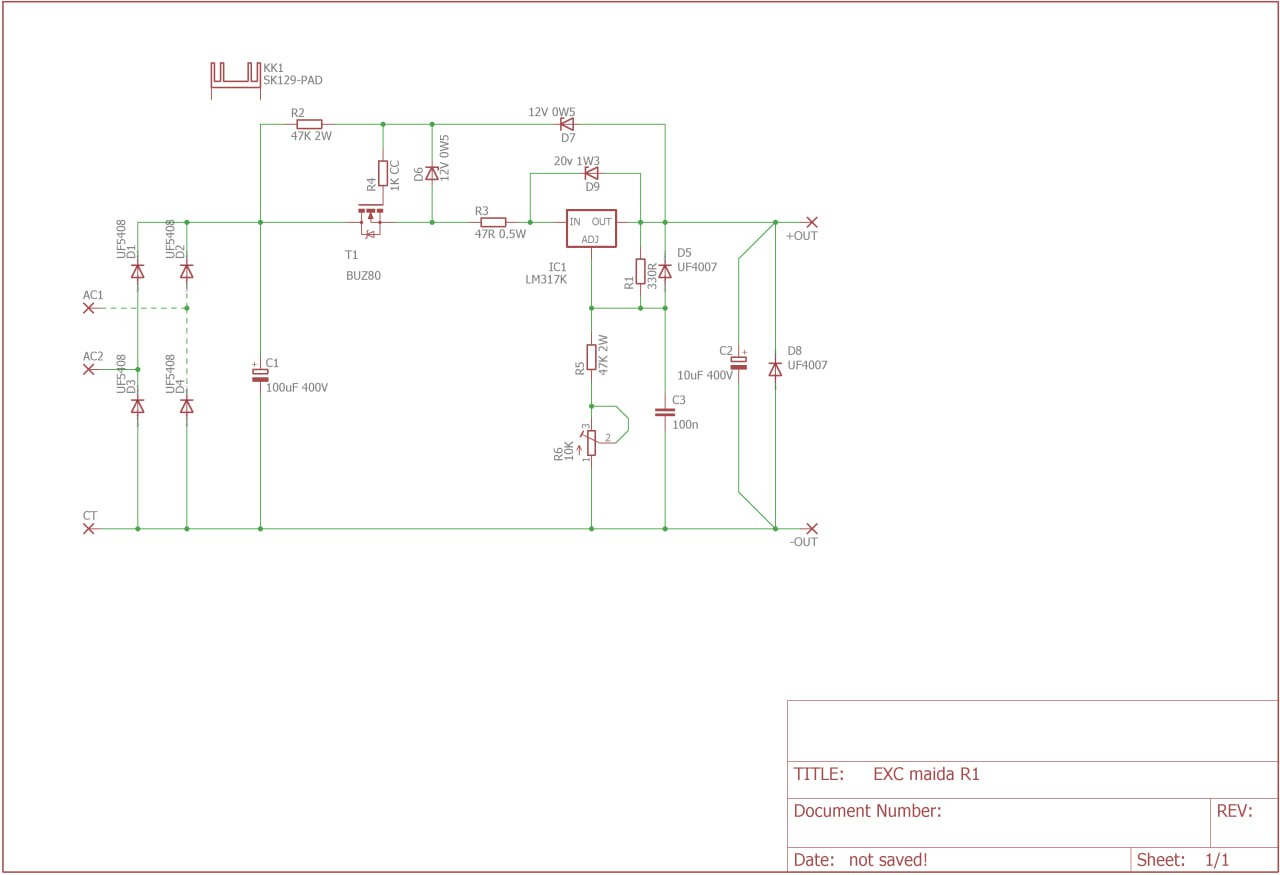

This is a board for an extremely compact maida style regulator. In short the EXCmaida R1

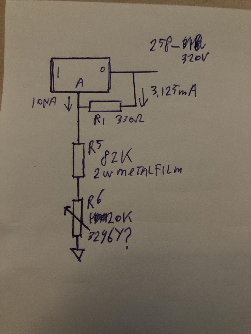

Hello, i like this design and ordered some boards. When i start to populate the boards, have some troubles. I read the post #130 and adjust pot R6 and R5. Set the R1 and then realize that R3 is also not mentioned in schematic. Is that resistor defining the curent, and what Iout can squeeze from board :) ?
Today also comes phase inverter boards for ECC82, they look very promising. This is very helpful thread for beginners like me :)
Hmm i got fake BUZ80 :) Fireworks happens. will replace with IRF740 or similar for test, also will try LM350 /that i have in stash/. I have one board with 2x PCL86 SE, and need to try to use this circuit to power it. The curent demand is maybe 100mA at 260v for stereo amp. Can i use this board to power the EL84 PP from this tread, ofc 2 boards - one for left and one for right chanell ?
I got 260-320V with standard components, trimmer is 20K in this example
If i change BUZ80 for IXYS IXTOP08N100P enhancement mode mosfet, could i change just R2, ( R3 ) , R4 ?
Would use regulator for voltages 285-300 Vdc at 40 mA to 60 mA.
Additionally when using transformer without CT do i connect secondaries just to AC1 & AC2 ?
