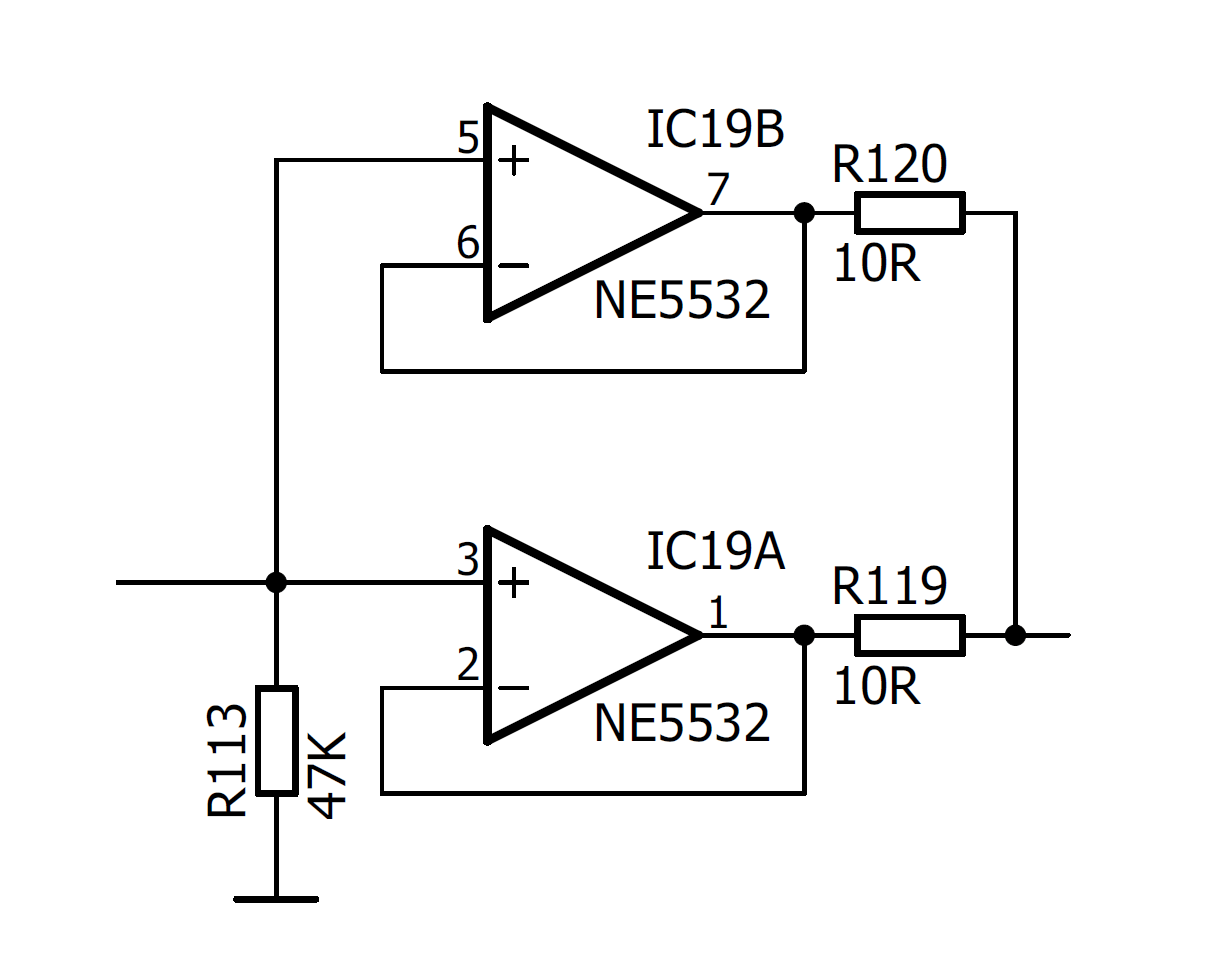

Valid opamp circuit?
Is this a valid op amp circuit?

Clearly it depends upon your goals.
If your goal is to drive a 4 ohm loudspeaker and supply it with 10 watts RMS, then that circuit will be inferior.
On the other hand if your goal is to build a unity gain amplifier with input impedance > 40K ohms, and whose input voltage swing is less than +/- (Vrail - 4) volts , and which processes input signal frequencies less than 44 kHz, and drive a load resistance greater than 600 ohms, then many audio people would say that circuit will achieve some amount of success.
No. The slightest difference between the offset voltages will lead to one op-amp going into current limiting and the other trying to control the output.
With ideal op-amps it would be what my former network theory professor would have called a forbidden network, as it would have an uncountable infinity of solutions.

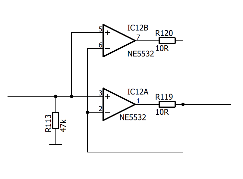

parallel opamps with shared feedback
with unity gang.
most would say no go.
Feedback is after the current sharing resistors.
In simulation this usually cures the DC offset /standing current
or voltage war etc etc and other stuff people make up
for parallel opamps.
Does well usually in sim, shared feedback after current sharing resistors actually fixes the so called issues. But that is sim.
real life cure is just use
a single opamp that can supply 100ma of current.
Since there is plenty of them. Many with heatsink pads
for reliable operation over life time
Absolutely not - you can never parallel inputs like that as the variation input offsets gets multiplied by the massive open-loop gain, saturating the two outputs at opposite rails.
Perhaps this is based on a comparator circuit though? NE5532 will not function as a comparator as the inputs are tied together with diodes to prevent degrading of its low-noise input transistors.

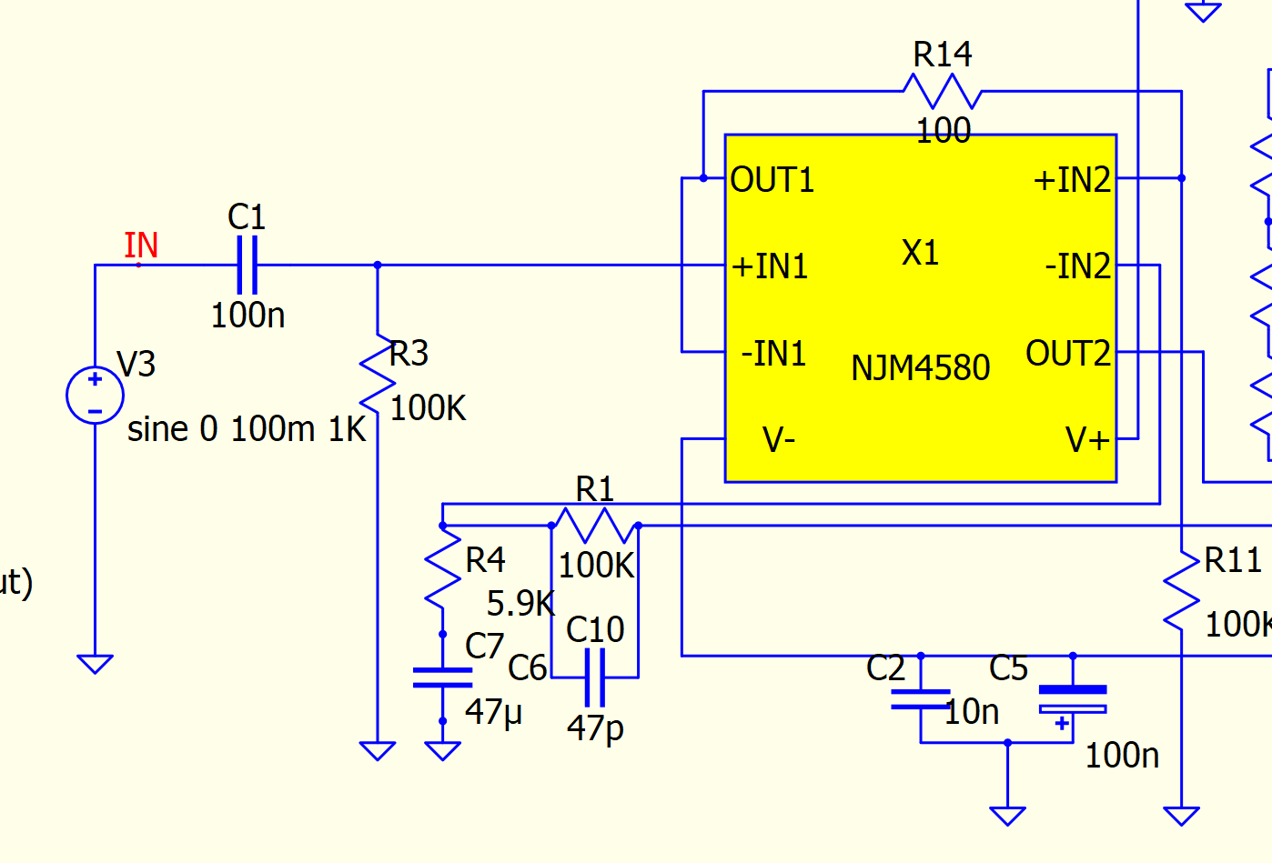

I've seen this used in headphone amps to increase op-amp gain. I have played with such circuits with Spice sim extensively and my conclusion is a better result, for me, is achieved with NJM4580 with its 50mA output. This let's me drive power transistors without drivers. I've attached a screenshot of my circuit - channel A buffered and channel B driving. NJM4580 can be found in dual channel single line profile - two SIPs can be inserted neatly in 16pin socket.
Agree, they might fight each other, and the 10-ohm resistors might not be a good enough referee.
