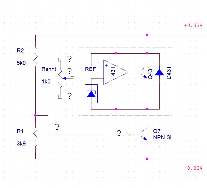

As a follow-up to a recent post: is it possible to apply a VBE multiplier with a Si transistor for a complementairy output stage with Ge transistors?
(See example).
R2 in the circuit must be of a very low value to avoid a melt down of the Ge's. But is it 'controllable' with a certain adjustable value of R1?
Wrapping up: what would be the lowest possible multiplied Si-Vbe?

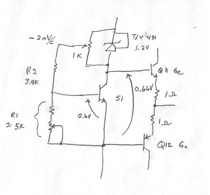

I think using a Ge transistor would be the simplest solution, but if you want a silicon circuit I suggest the following concept.
Add a TLV431 in series at the top, above the Q7 collector/Q11 base. Wire the shunt regulator for 1.24V and shunt it with a 1k pot.
Make R1 about 5k, adjustable. Make R2 = 3.9k and connect it to the 1k wiper rather than Q7. I think the circuit will give plenty of adjustment range.

I think you've lost me somewhere, but this will make things very complex.Add a TLV431 in series...

I contend that it's not that complex--- only two more components than in the original circuit.I think you've lost me somewhere, but this will make things very complex.
The tempco is ~ -(1+R2/R1)*2.2mV/C; The 1K pot position lowers the voltage across the Si transistor to trim the spreader voltage and its position has minor effect upon on tempo. (Wiper resistance varies from 0 to 250 ohm, small compared to R1+R2.)

Many thanks BSST!!!
Very helpfull and it hints in the direction to think about it.
The application I'm busy with has nothing to do with Ge output stages (that is an example), but with low value Vbe multipliers.
I think I have my answer.

Copied your drawing for easy viewing.
This solution does not look right.
