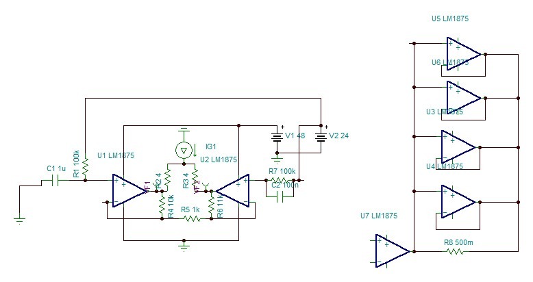

Very simple bridge, has seen already?
I am trying to make use of the Chinese TDA2050-LM1875 chips costing less than $2/10 pcs.

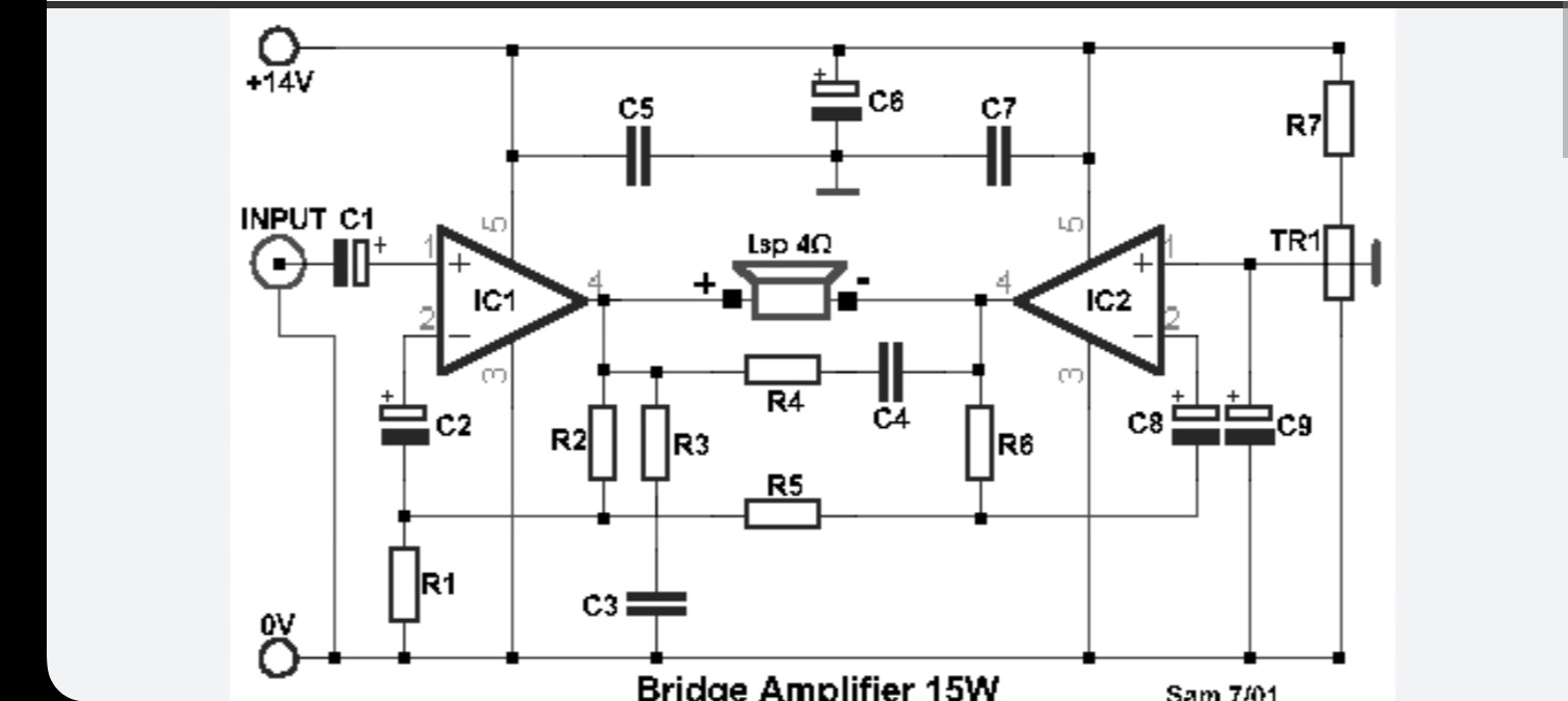

To make it good and cheap, I came upon this simple circuit. I do have remembrance having seen a Russian design with mutual resistor, I wonder if someone can remember it.
Watch out for common-mode instability! If the amplifiers are not unity-gain stable, you have to attenuate the common-mode feedback.
For example, you could split R5 in two pieces and put an RC network to ground from the centre point. You can choose R and C by looking at the common-mode loop gain.
This!
Also, the common-mode voltage -- 1/2 of the unbalanced input voltage -- is not removed, that is, the output is not symmetric.

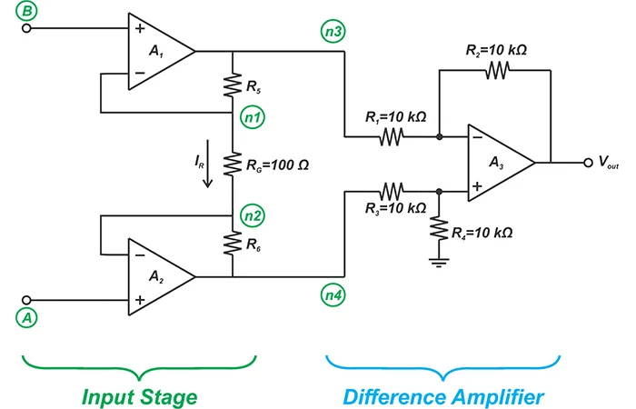

In the end it is just the first stage of a standard 3-OpAmp instrumentation amplifier, drawn obscurely.
In my circuit, as it doesn't have differential input, the inverter has a gain Rf/R and the non inverter has a gain (Rf+R)/R this why the inverter is 11k vs 10k.
On Google I found this but the site is closed. The Russian one used a known chip.

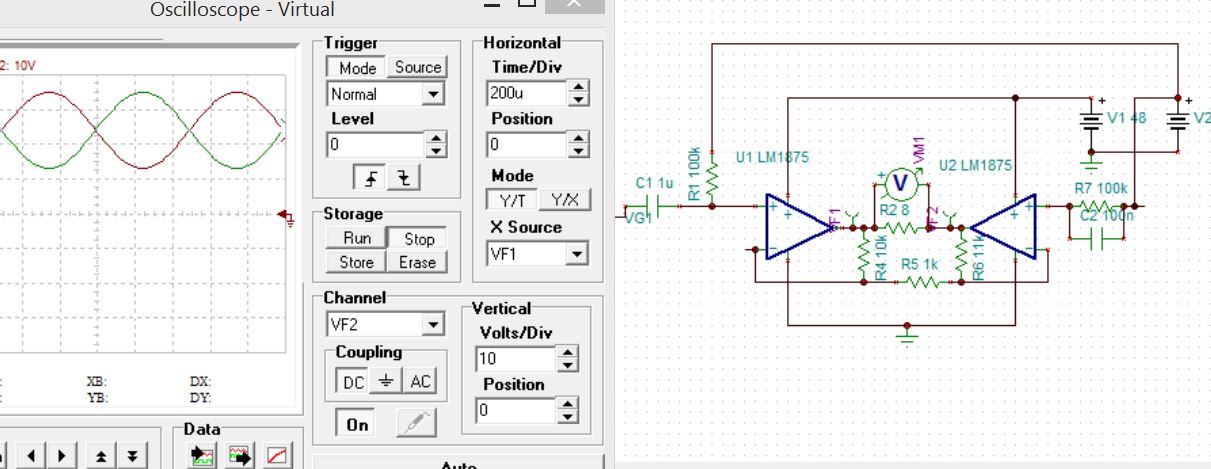

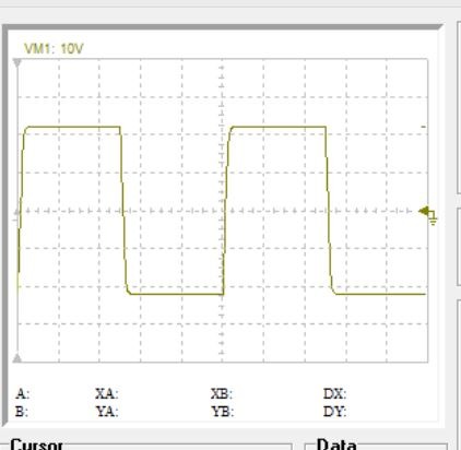

Added bellow 10khz square wave on the load.

Both amps are working with a gain of 11. But the Chinese chips are unity stable that I will use 4 parallel on each side driven by these two. I must check the maximum input voltage if it is less than the dropout of the driver.

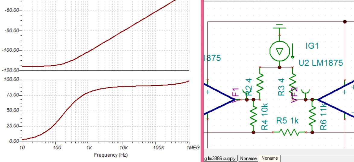

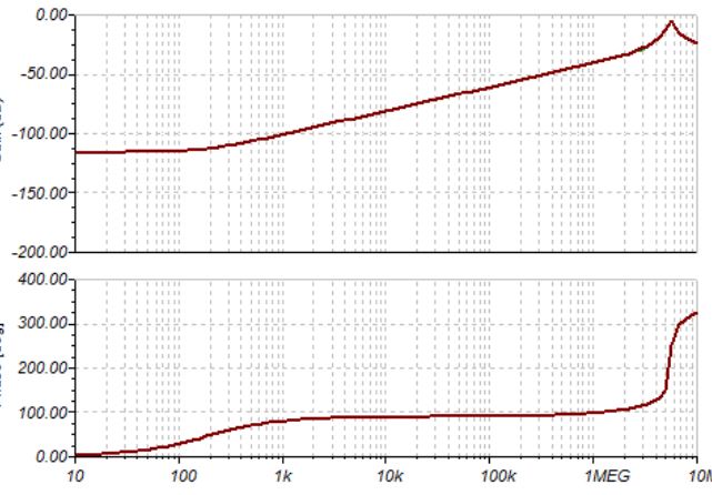

Suppose that due to some disturbance or other, the outputs of both amplifiers in post #1 increase by 1 uV. The voltages at both inverting inputs then also increase by 1 uV, rather than 1/11 uV. Hence, common-mode disturbances are fully fed back.

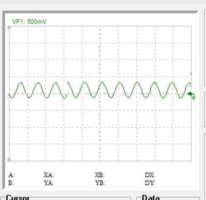

If both negative inputs increased, both opamps will get inverting command to counter the increase. Bellow is a current source on the center point of the outputs and the voltages of the outputs measured.
