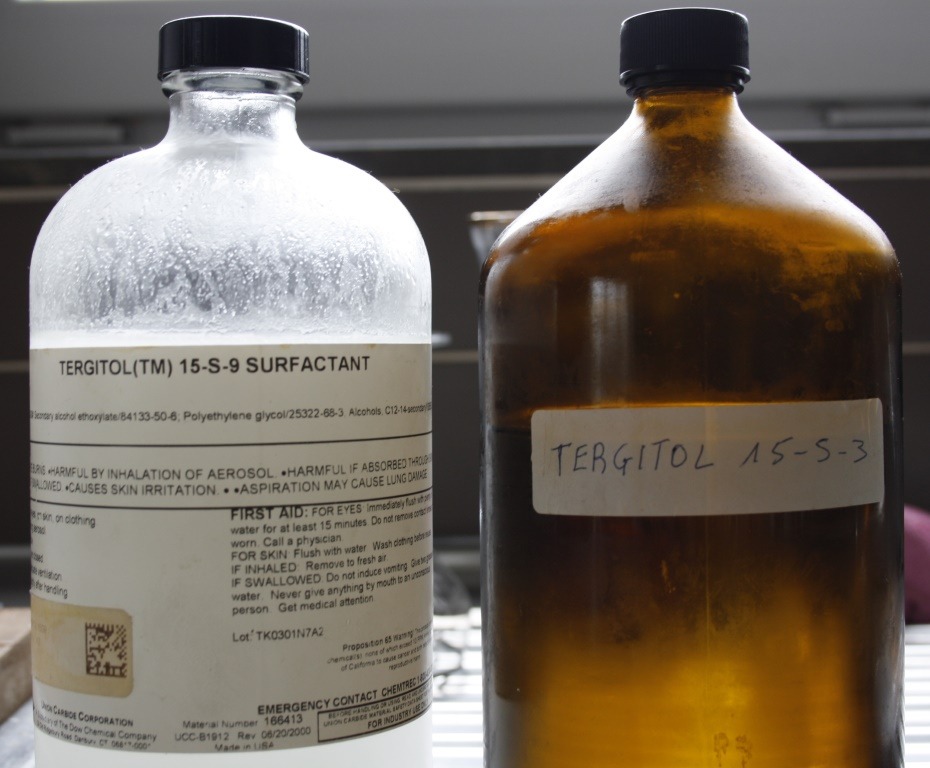

Which ? 15 S-X, 7, 9 , 4 ?
It was their old recipe: 15 S 9 & 15 S 3.
They switched to a single solution over the years, but I can't find it anymore on their site.
Remember, you only need a tiny bit of these surfactants. IIRC 20mL of each for 5L water.
In those days, I called DOW chemicals to ask how to acquire those surfactants.
The friendly lady said that they could only supply me with one liter of each as a sample.
Next day I received two bottles, enough to clean records for the rest of my life and longer...
