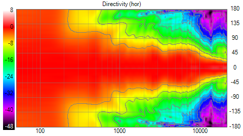

3- it would be nice to be able to 'step' the color range in the polar plot i.e 0to-2 is a color -2to-4 is a color etc.
Contour lines with graphics methods is doable. It's slow as tired snail because color of every pixel on chart area is read few times. dB step is constant. 5 dB looks okay.
