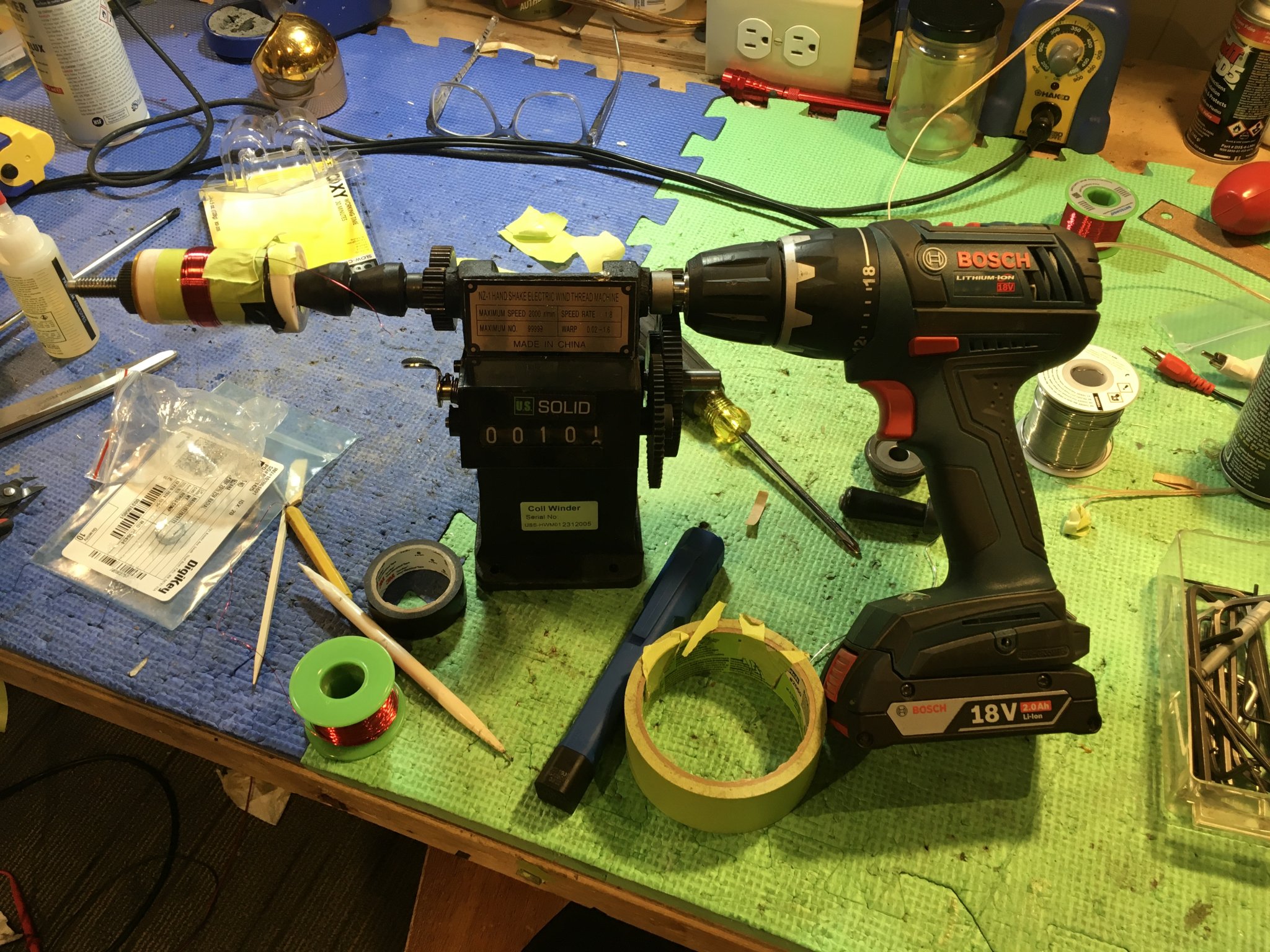

Got the winder I ordered off amazon today! Trying a couple test coils to get the feel for it. Not using proper former material yet.
For the first attempt, I used the hand crank. This was awkward and I didn't get the wire tight enough.
For the second attempt I stuck the power drill on. Better.
The hardest part is starting the next layer of the coil without just pushing the last wire in the previous layer out of the way. Do I need to let the epoxy of the first layer start to harden more? Or is it about getting the wire tight enough? Any tips and tricks for this?

Not needed or desirable to let epoxy harden, not even partially.
With practice you will find the slight angle needed for wire to lie just by the previous turn without pushing it away, same with wire tension.
There is an old guy from India who winds voice coils "in the air", no winder or drill involved, and he tensions wire by passing it around his naked (or sandal clad) foot thumb, go figure! 😱😱😱😱
We Humans can learn to do almost anything 😲
