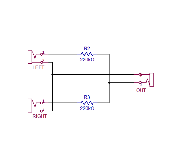

Here's how you can do it.
Combine the channels on the output of the CD player, follow this diagram:
I'm not completely sure about the resistor values but 220K seems close - experiment but don't go below 100K.
Attach this to the phono input on one channel ONLY, drive the speaker from that channel.
Done.
Good luck. ;)

You're welcome :)
The resistors are for dropping the output voltage and work as a low rent mixer to combine the channels of the CD player. If the phono input is near line level input, then use 10k resistors.
Leaving one channel idle is better than both channels not working ;) You could use it this way until you get another speaker (why only one?) and then use both channels and get rid of the "mixer".

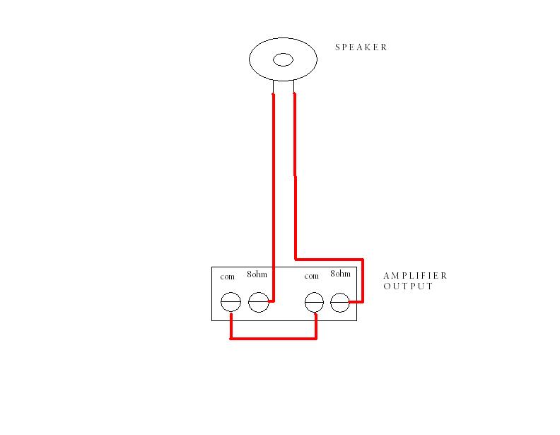

On the diagram on the attachment. . . Is this series or parallel? Also, If I reversed polarity on one of the channels would this work? If it would work how would I reverse the polarity? What would be accomplished by floating the ground on one of the OPTs (disconnecting the ground)?

Geekdude. . . The terminals of the positives on the terminals go to the OPTs.
Brainfart... I thought you meant two terminals on the speakers :eek:
