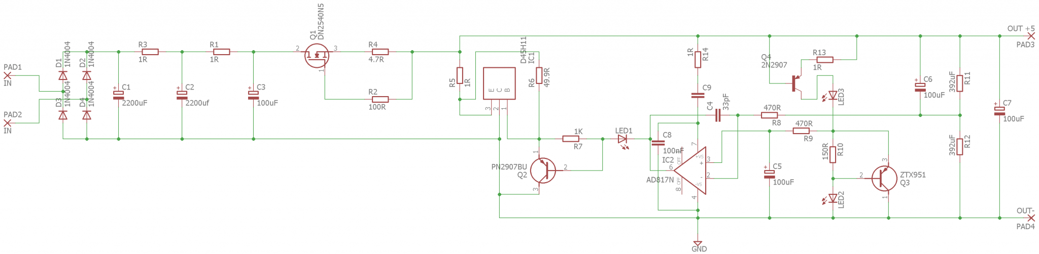

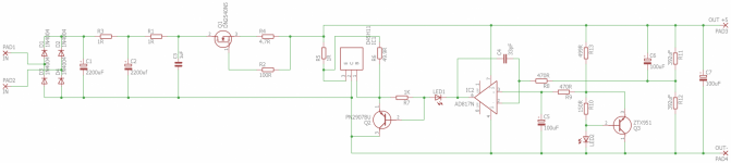

Hi everyone, I intend to design some pcb for Mr. Walt Jung's shunt, I took the original schematic and added the reference GLED431. My idea is to design a pcb schematic and then make it public for those who want to print it themselves or modify it since there are none. I share the schematic I created, I would like to know if there are improvements to be made and if you need to have specific precautions in the design phase of the pcb. The PCBs that will then be created will have the rectifier part on board, and perhaps even a transformer for each branch. But let's go in order before we establish the goodness of the scheme ...
For reference : https://refsnregs.waltjung.org/.

Perché non utilizzare un LM317MDTRKG per sostituire il DN2540 è davvero più economico e richiede solo 1 resistore per limitare la corrente; ed è buono fino a 40 volt in ingresso... il tuo AD817 ha una tensione di alimentazione max. ±18 V
Divertiti!
È anche un'idea. Ho rispettato i componenti originali scelti da Walt Jung. Lo terrò presente. Ora mi concentro su una prima bozza del PCB

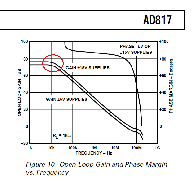

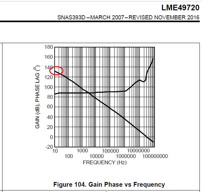

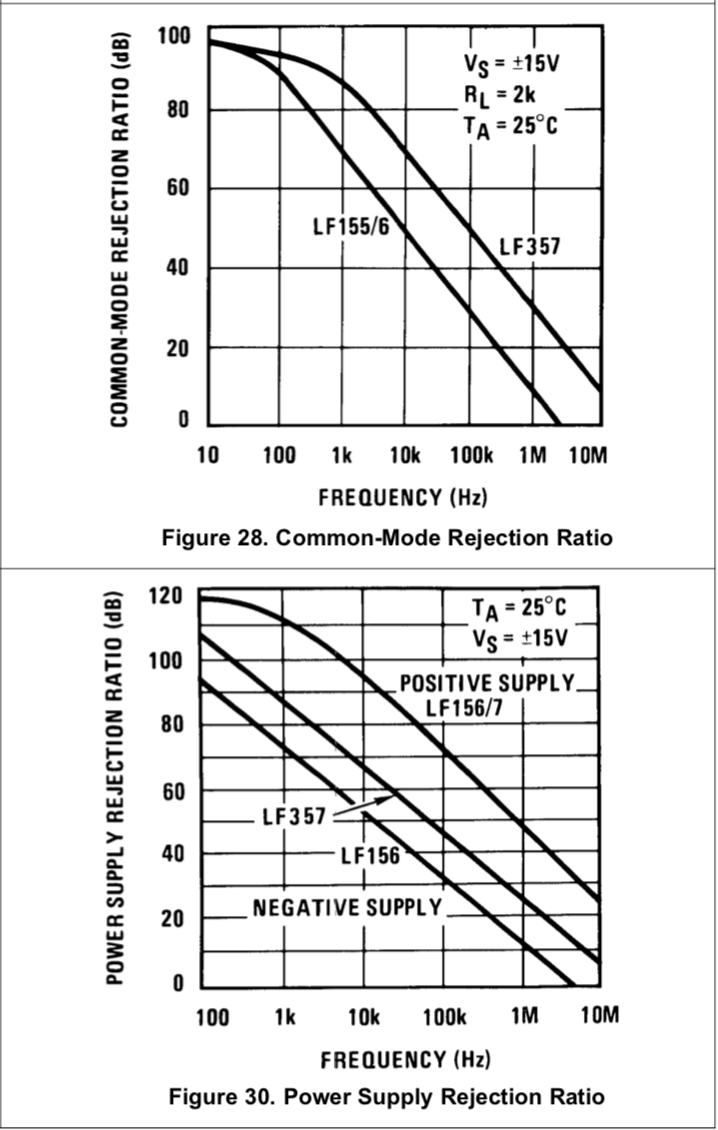

I offer the gentle suggestion that you consider using a different opamp, one whose dominant pole rolloff corner is well below (2 x mainsFrequency), i.e., below 100 Hz.

For +/-5V good op amp. is LT6202 , OPA1611 or jfet OPA1641 , low noise jfet op. amp is the best choice.

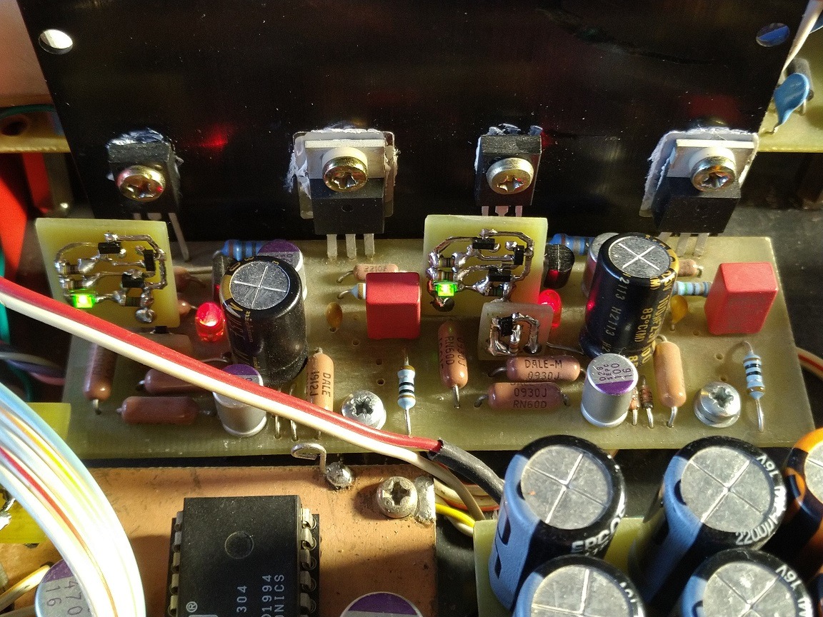

Tix88 ,new improvements from Walt Jung should be out soon, so you should wait a little longer to make a PCB that doesn't look like mine with four extra small PCB (two CCSs and two new version of GLED431)

I started with the improvements as you did with GLED431, later Walt advised me on new improvements . All the improvements we have made affect the performance of the regulator (shunt or serial) and are heard in the overall sound of the system. I use my regulators in my DAC for six PCM1702 and PMD100.
Gled cell work better with CCS and you can always add small pcbs with improvements like me or make new pcb.

For CCS I prefer CPH3910 but they don't have it at the moment in Mouser, I think it will arrive in a month. For GLED431 I used 2SK246 or 2SK117, but they are not suitable for the new version so I would rather go to SMD right away.

Here's a couple of suggestions if I may, not wishing to overcomplicate things but to gain measurable performance improvement. Not shown on the schematic is the necessary decoupling of the opamp supply pins. A 100nF X7R ceramic at pins 7 and 4 would be good. You might want to consider some RC decoupling of the positive supply pin 7 as well. A 1uF polyester (say Wima MKS series) fed through a 1 to 4.7 ohm resistor would drop only a few mV of supply but give even better decoupling. Replacing R13 with a CCS is a nice idea but with only 2.5 volts available and a 5 mA supply required for the GLed that won't work as you will get a low output voltage. An alternative is a simple single LED and transistor current source that would operate better at that voltage, set for at least 5mA. Suggest a 2N2907, a green LED and a 200 ohm resistor for this. Be careful to not specify low ESR capacitors for C6 and C7 to avoid potential oscillation, perhaps even consider pads for low value resistors in series with each of these to open up the options. Q1 is great and will be less noisy than an LM317 and although that may be insignificant why risk it. Q1 can be cascoded with a second DN2540 for even better performance. Walt Jung detailed this in one of the addendums to his Sources 101 series. Shunt regulators lend themselves quite nicely to upstream choke filtering (CLC). You're probably looking at approx 200mA with R4 at 4.7R so a Hammond 156R would work but you would need 10 more volts on C1 to start with, i.e. a higher voltage transformer. You also need to ensure enough Drain to source voltage across Q1 to ensure it is in the linear constant current region and giving a high output impedance for good line regulation. Looking at the data sheet that will mean at least 10 volts across it. You can get away with less but its performance will suffer. Q1 may be dissipating as much as 2W so will need a small heatsink to avoid getting toasty.
Finally to allow use of a greater range of opamps I would suggest a dual DIP and SOIC layout where the SOIC footprint and pads sit within the DIP one. With source impedances of 470R you will get the lowest noise with bipolar opamps such as my favourite with a 5 volt rail, the OPA1611.
Lots of options. Take your pick.

Hello . Thanks for all this good info, change the schematic with these changes and propose it again. What type of capacitor C3 is it advisable to put it?
For C3 a low ESR electrolytic would be fine. Boutique plastic caps won't make any noticeable difference here IMHO. What you change/add on the schematic very much depends on where you are pitching this. There is always the option of linking out some of the additions to start with, the CCS for example, and then installing those bits later on, otherwise you may either never get round to trying them or be forced to use added daughter boards (a la Grunf).

I will use the power supply to power the analog art of the DAC chip, the digital part of the DAC chip, and the power supply of the receiver. In total I need 2 power supplies for the analog part +5/0/-5, and 5 for the digital part +5. I would like to make a modular and at least definitive design, so as not to modify the PCBs much in the future.

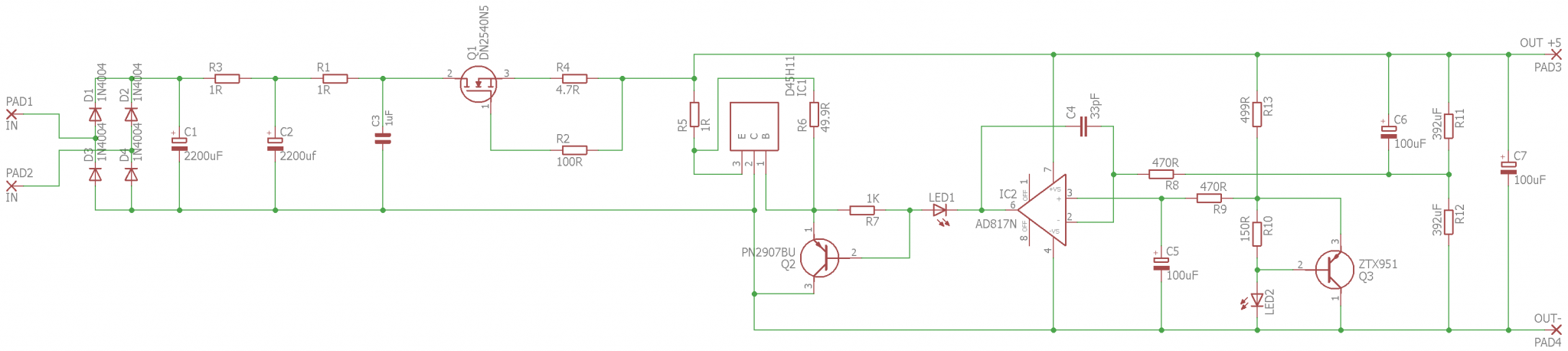

I made the changes you suggested to the scheme, what do you think?
