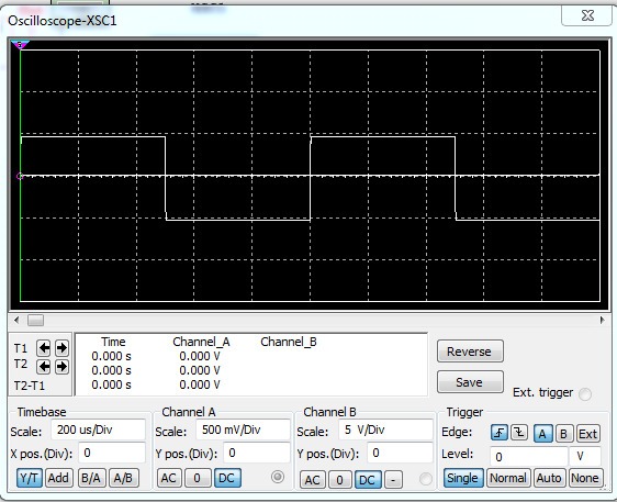

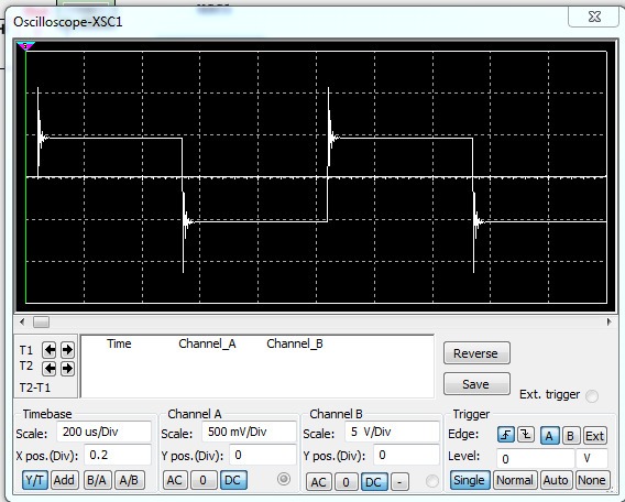

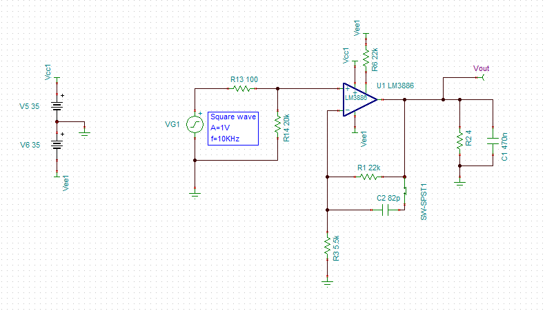

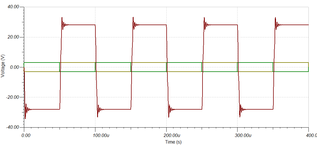

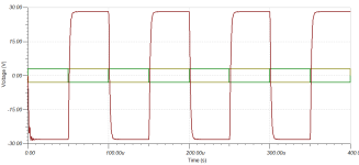

I did some simulations with LM3886.
Here is the circuit using Gain=5.
Then 2 oscilloscope images.
First is without compensation cap across the feedback resistor.
Second is with a capacitor 82pF across fb resistor.
At gain=5 this cap was necessary to make perfect squarewave.
Not more not less capacitance.

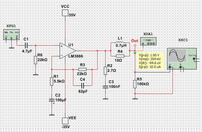

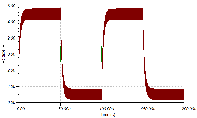

What simulator software are you using?
I tried 82pF cap but it oscillates.
My schematics is missing input decoupling cap, output Thiele, and Zobel networks.
I also loaded 0.47uF cap over the output 4R resistor.
Attached are schematics and square wave.

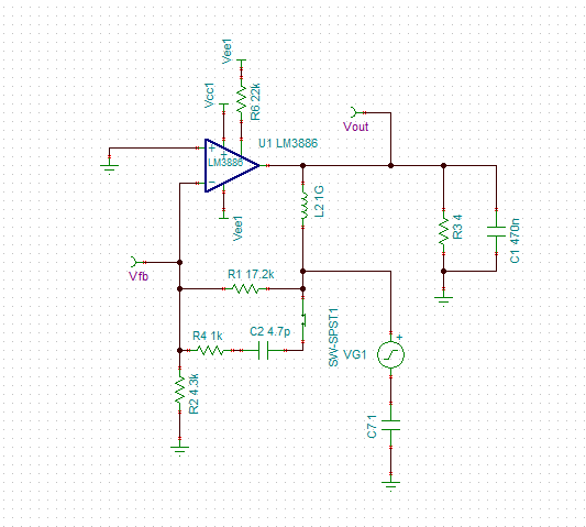

Joined 2011

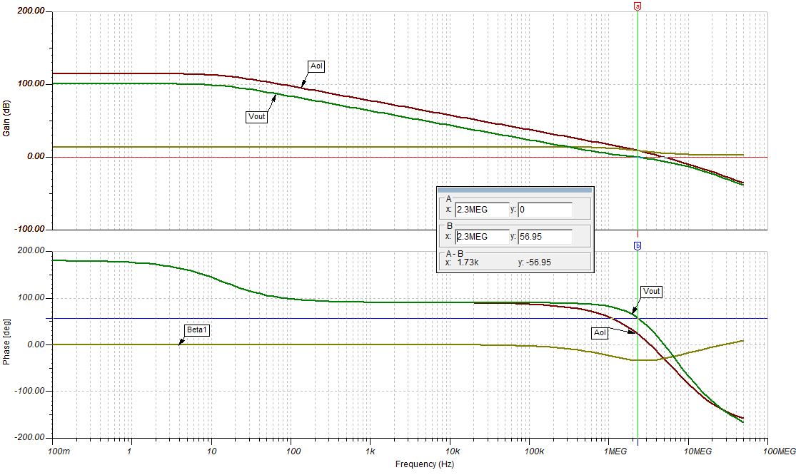

So the compensation is called feedback lead compensation.
It allows for the phase to lead ahead by certain margin.
Can see from the graph attached.
Aol curve is phase response without compensation.
Vout is the new phase response.
From reading on theory little bit, such compensation allows for lower bandwidth, and hence lower noise.

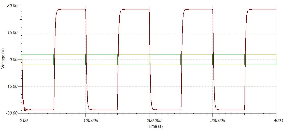

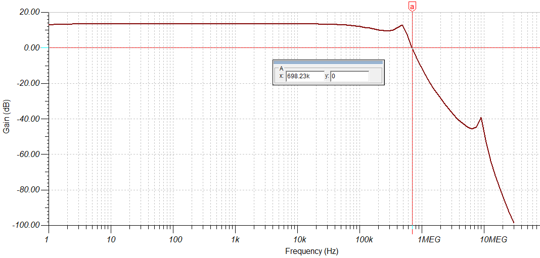

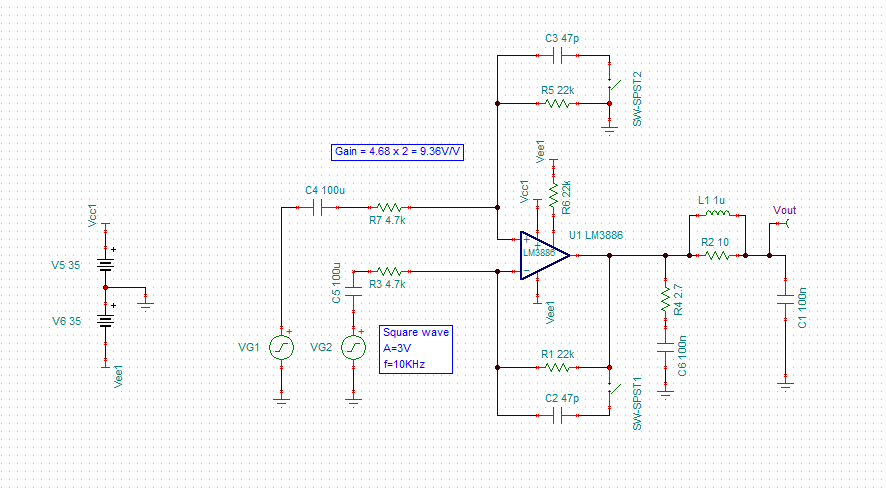

Joined 2011
I realized that I needed to use capacitor as a load and it should've been without resistor in parallel.
I also added decoupling capacitors to the inputs as well as output Thiele/Zobel networks.
Finally getting proper simulation.
Adding two 47pF caps seems to be lowering loop gain to stabilize the whole circuit. Adding two 33pF is on the edge of instability.
This is a difference amp topology to be used with balanced inputs.

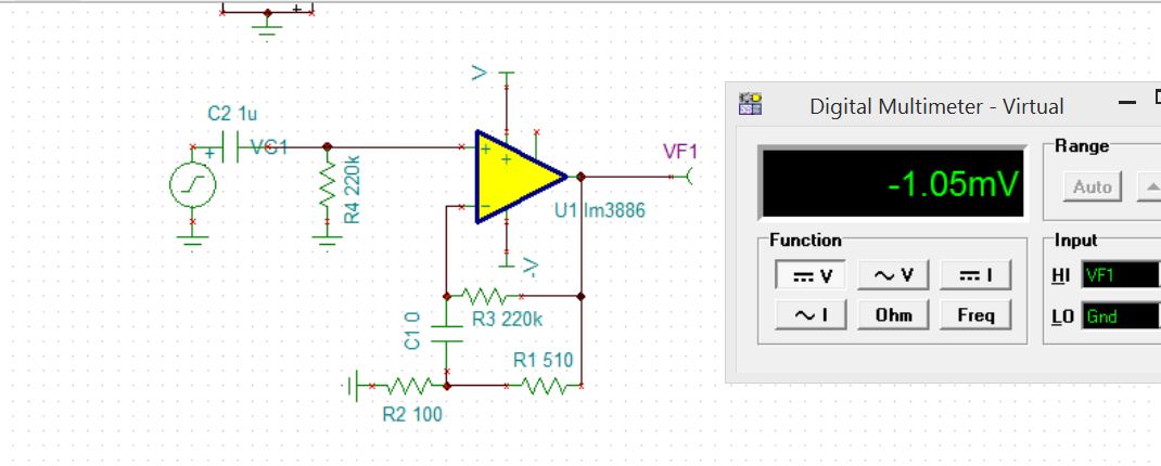

Joined 2011

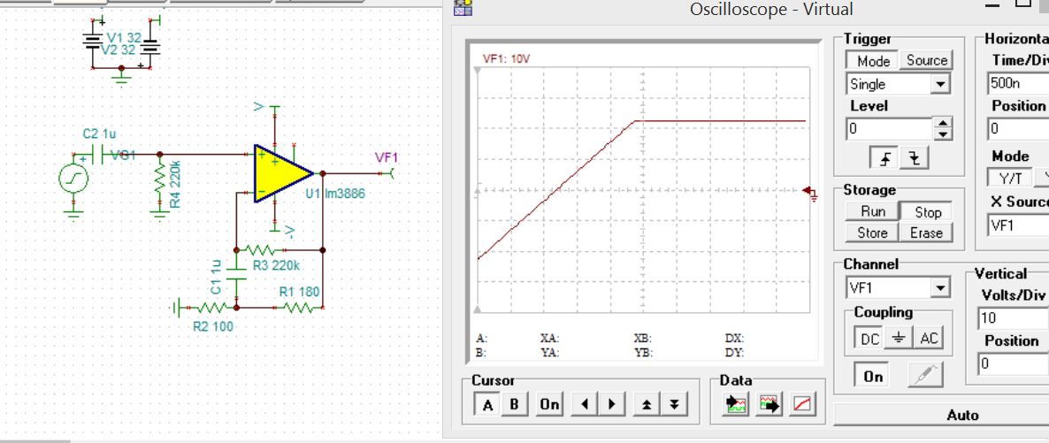

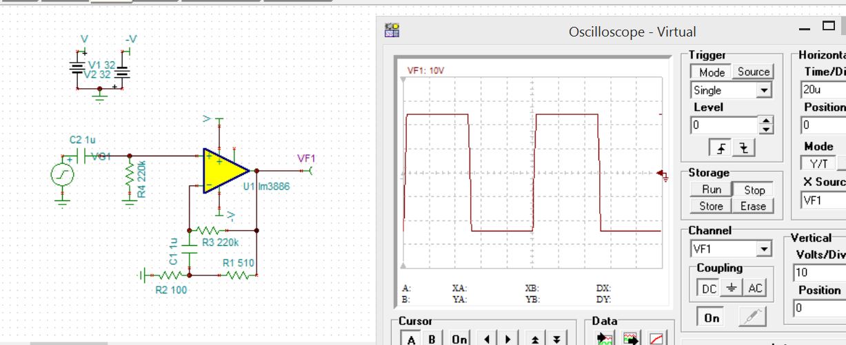

That is interesting way to do a feedback.
220,000/100 = 2,200x gain if capacitor is not accounted for.
That is 66dB of gain limiting over the whole frequency range.
Adding cap of 1uF in conjunction with 220k creates filter with fc=0.72Hz.
180R resistor is then "loosens/dampens" the filter.
Am I understanding correctly?
So is 1uF cap acting as lead compensation sort of?
And then adding another lead comp cap to 180R?
Neurochrome.com
Joined 2009
At DC the capacitor, C1, is an open circuit, so you have unity gain through R3.
Above some corner frequency (where C1 is a short circuit) the gain is 1+(R3 || R1)/R2. As R3 >> R1 this can be approximated as 1+R1/R2 or 2.8 V/V with the values shown.
That's definitely too low for the LM3886, which is why a compensation cap across R1 is needed to ensure good phase margin.
I've come across this type of feedback arrangement before in some older discrete designs (Hitachi? Toshiba? I forget). I suppose it's a relic from the times where electrolytic capacitors had pretty horrid audio performance. With the scheme shown in Post #33 relatively low feedback current flows in C1, so it will have only a tiny impact on the audio performance of the circuit.
With the more traditional approach with C1 in series with R2 (which requires a much larger C1) the full feedback current flows through the capacitor so its impact on the audio performance is much larger.
The main issue with the approach shown in Post #33 is that if C1 blows or dries out (thereby going open circuit) the LM3886 will not have any DC feedback path and will output the full rail voltage onto the speaker. That said, with C1 = 1 uF one could use a film cap or ceramic cap. It'll outlast any of us in that application.

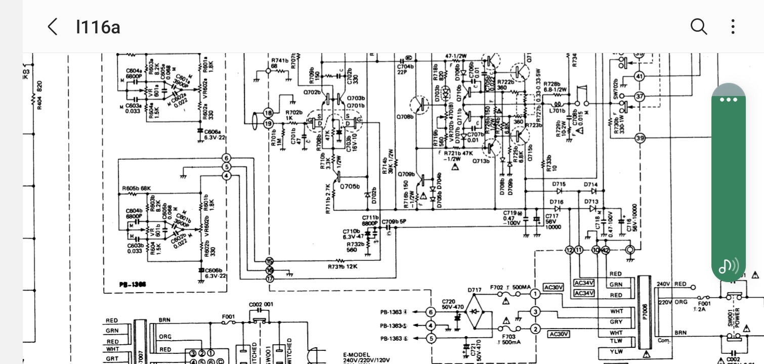

Do you remember on which model Luxman or at least, the decade that was used?
Google gives me Luxman l116 to be duo beta and here is the circuit. It has the tone control in the feedback.
