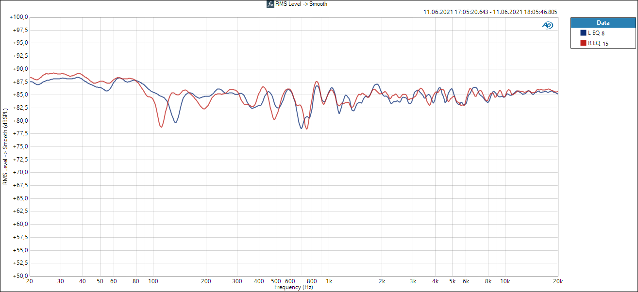

Here the FR of my main speakers in my listening room - no subwoofers but the LF drivers (4x20cm) sit on a good position to form a bass array. Sorry for the strange 2,5dB scale ... AP thinks that's a good idea ...
Closed volume - with the ability to EQ you can get EVERY FREQUENCY RESPONSE you want to have! You just need enough SD and Xmax to achieve it in the level you need.

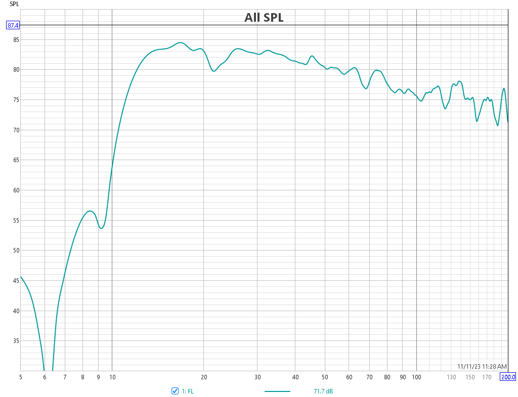

Me too. Here is one of my front main speakers measured from the seat. 1/48th smoothing. There's LOTS of PEQ to a room curve that sounds great. It uses a DIY 36dB/octave rumble filter cornering at 15Hz with a Q of 0.7071 to protect things from unwanted/wasted energy without taking anything at 20Hz or above. Sealed Morel 12" woofers and a Linkwitz Transform is in place. I play plenty of music that includes strong content to around 20Hz.

Yeah can't beat it. You don't even need those fancy FIR CPU-hungry options. Just REW to generate the filters and JRiver Media Centre to type them all in. They act exactly like "perfect" analogue filters with IIR. I run 4 subs all with their own EQ (a multi-channel DAC is used) and CPU usage while playing is only around 1% on a basic Windows mini PC. That measurement was made using REW swept through JRiver Media Center's WDM en route to the active crossover, so it picks up the EQ settings. It matches REW's prediction perfectly. For the rumble filter you could also just type it in, although I built a PCB with a circuit designed using FilterPro to do the same job and it has the same transfer function as JRiver at line level give or take 1 degree of phase lag due to capacitor tolerances.

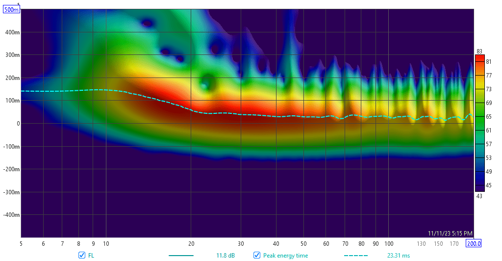

My room has no "treatments" that aren't normal furnishings and I showed you the bass performance achieved with simple EQ. That was to Toole's recommendations of targetting modes with cuts of the same magnitude and Q. Spectrogram is fine. No room treatment can achieve the kind of targeted "absorption" that careful EQ can achieve. Follow commercially-motivated people like that and you'll get nowhere fast with a room full of garbage that has no place in a domestic living space. Seriously.

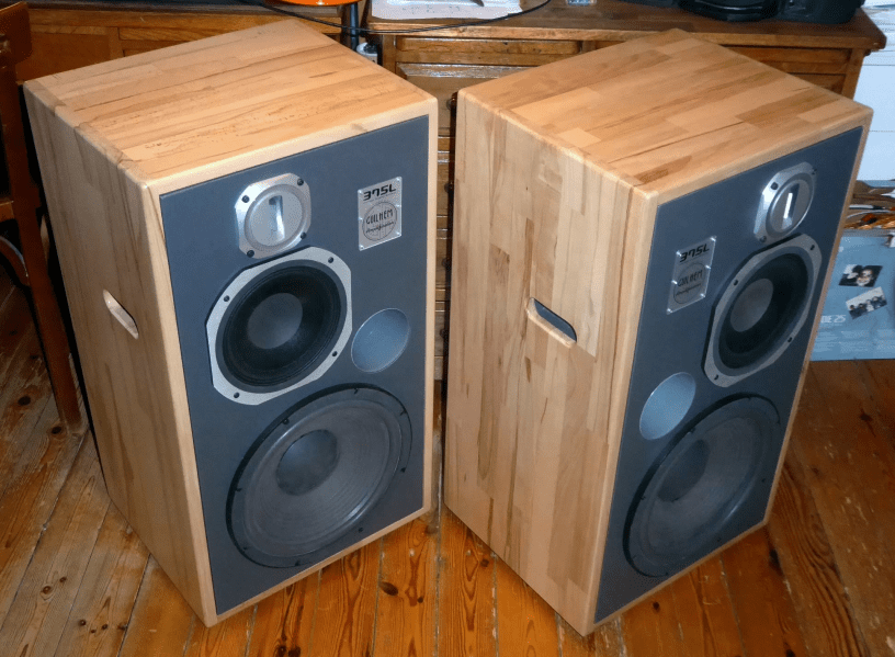

My largest (DIY) speakers are a 3-Way BR using BEYMA speakers 12B100R / 8M60N / CP21F :

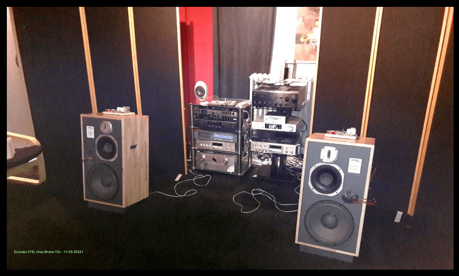

They offer a F3=36Hz, F6=29Hz, F10=25Hz, according to the calculator, which I find to be satisfactory in my little auditorium, and proved also convenient in larger rooms, as below, at a friend's home :
But it's me, OK ? ;)

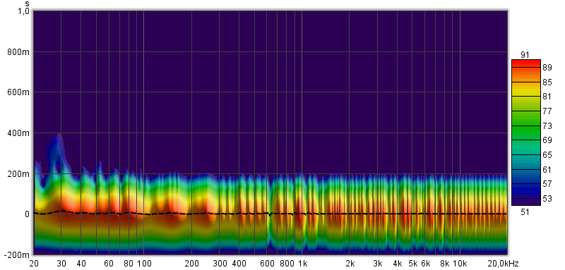

And a GOOD spectogram looks like that :cool:
If you measure the full audio bandwidth from your listening position you are doing it incorrectly. Use gated near-field measurements for higher frequencies and EQ those to address speaker resonances only. Read Toole or you will only continue down this path of irrelevant conflation to spread misinformation.
