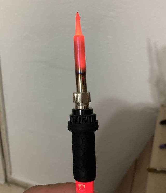

What temperature(s) do you run your soldering iron at?
350 Deg. F
Art

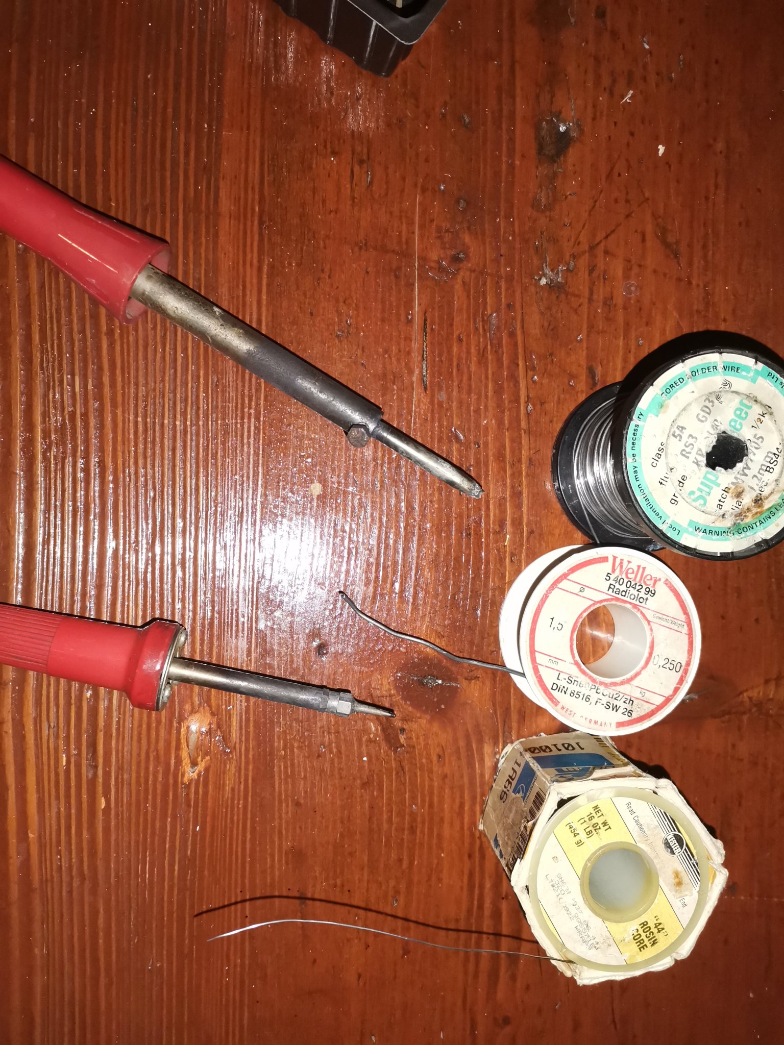

Ha ha funny you should mention that about increasing temps. I use temps anywhere between 320C and 380C-ish depending on the job, generally using 0.71mm 60/40 Pb/Sn. And I do what you say, rather than change tips, because I'm a bit slack I guess. :)
I'll change to a bigger tip for large copper planes if I have a few joints to solder, but if it's just for (say) large capacitor leads, I'll commonly just get out a fixed temp 25w or 60w iron I have which get to about 450C and have chunkier tips.
For the record, I have a really basic (but I think good) Micron brand analogue variable temp station made by Xytronic for a local store. It's around 20 years old and going strong. I mention this because I'm just going by the analogue dial temperature display, which I've never checked for accuracy.
