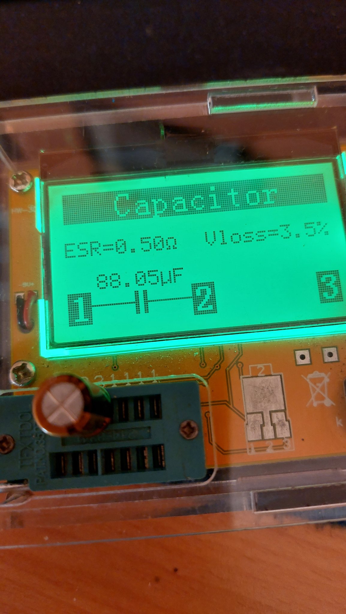

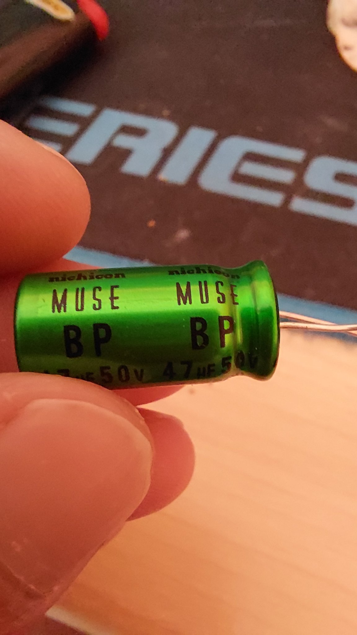

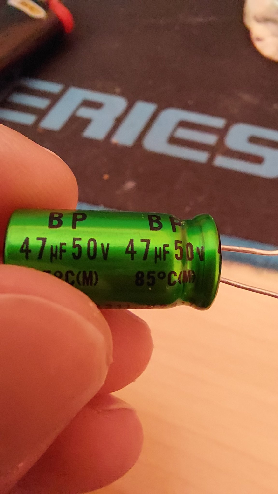

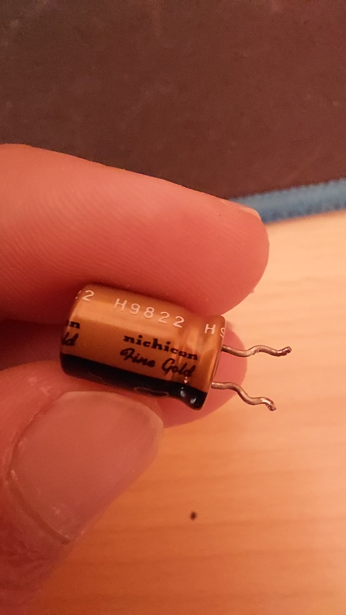

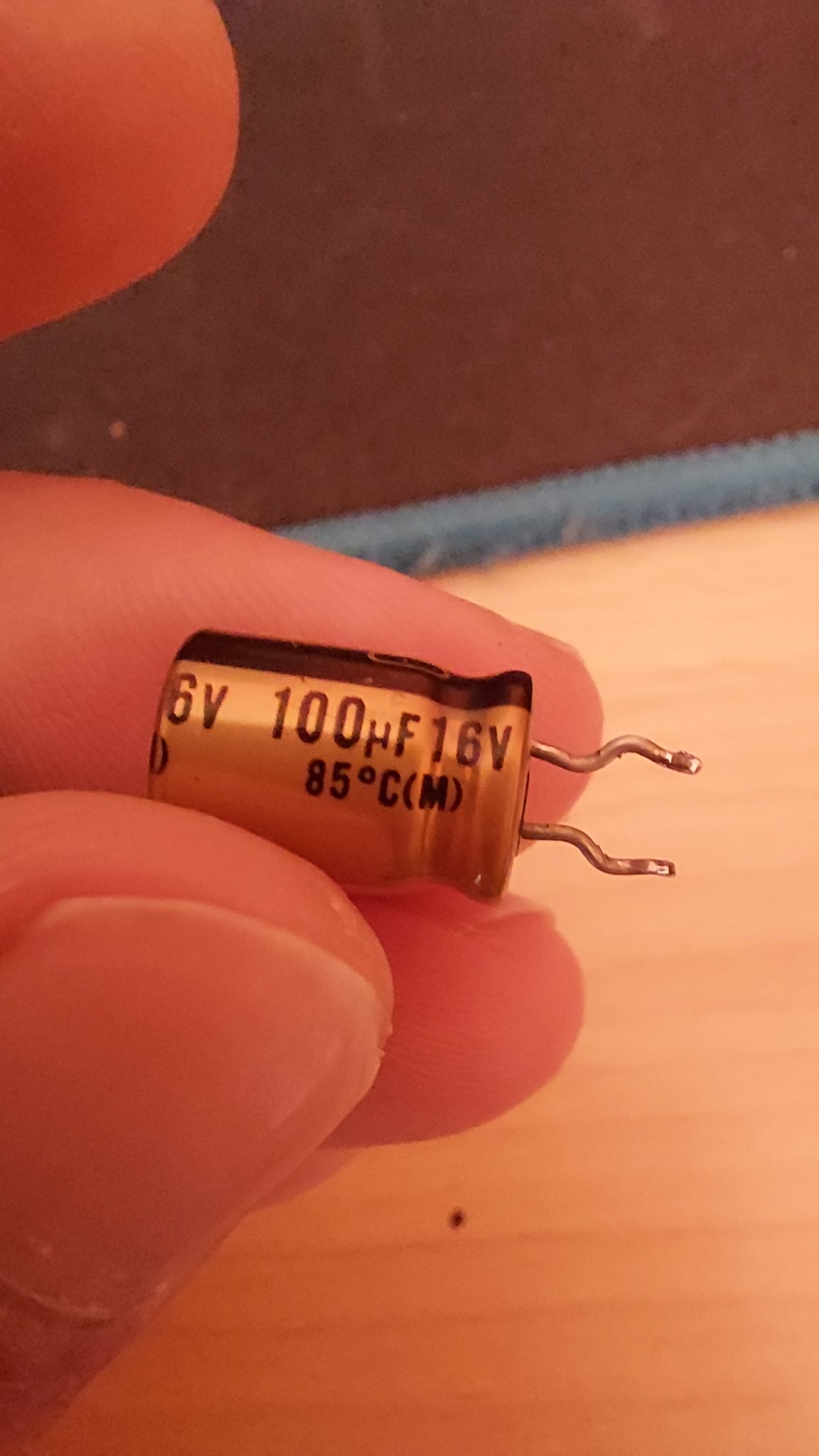

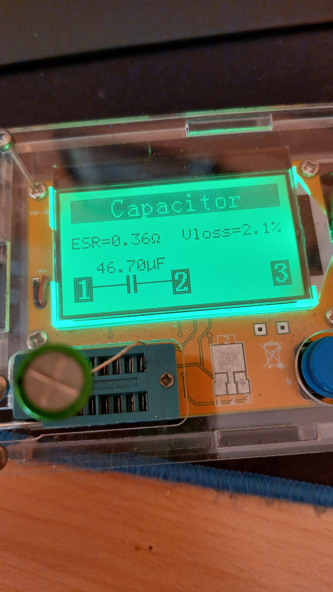

About old caps, I have tested these Nichicon fine gold. Compared to new Nichicon muse .
I might be deaf or just can't hear any big difference . The new muse might have " better" mids and the old fine gold better highs or it might be just in my mind.
H9822 is 1998?

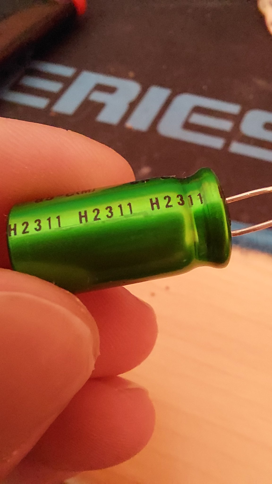

And H2311 2023 ?
0.36ohm new muse nichicon
0.5ohm old fine gold nichicon.
