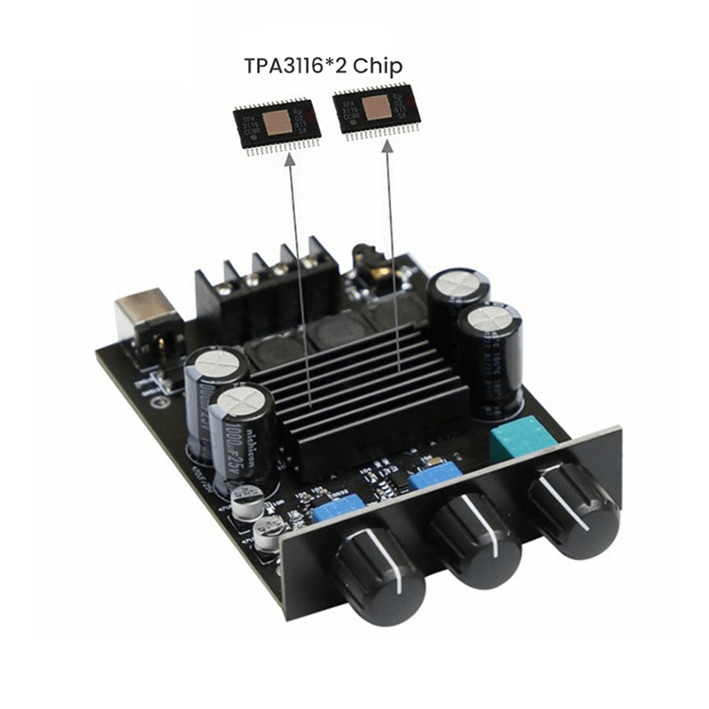

I believe the original Sanyo STK 4231 is discontinued and is not recommended for 4 ohm loads like your Kenwood/Awai speakers.
That leaves you with the Class D choice which is 4 ohm capable: 2 × 50 W into a 4 Ω BTL load at 21 V (TPA3116D2).

If you are asking if the TPA3116 has DSP built in, then the answer is no.
Digital Signal Processing (DSP) can allow you to adjust the EQ, i.e., amplify or lower the level of certain frequencies.
The amp shown in the image above includes volume, bass and treble controls, but not DSP.
