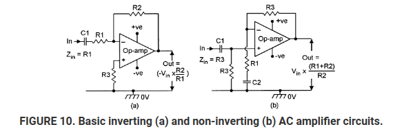

what is the purpose of C2 in the following example (b)

Any practical op-amp has a so-called offset voltage. That is, when you apply feedback around it, it regulates to some small DC voltage difference between its inputs. If the op-amp circuit has a large gain, the amplified offset may reduce headroom, or burn out your woofer if the path from the op-amp to the woofer is completely DC coupled. Reducing the DC gain to a small enough value prevents that.
At DC, the circuits are both followers, with the positive input connected to ground, so the output is 0VDC.
Except for any DC offset due to imperfections in the op amp.
The capacitors serve to block incoming DC voltage, and to avoid amplifying the inherent DC offset in the op amps.
Also they can reject incoming low frequency disturbances.

No. The diagram is mislabelled, and the gain shown is incorrect. If the top resistor is taken as R2, the gain (to simplify) is 1+R2/(Z(C2)+R3). At DC, Z(C2) is infinite, so the gain is 1.So gain is (0+ R2)/R2.
That way the input DC offset voltage does not get amplified by the stage gain.Reduces the gain at DC to unity.

There's also a typo in (b) where R2 in (a) becomes R3
Choose it such that Z(C2) = R3 at the desired turnover frequency.How is the value of C2 calculated?
Thanks for the replies. I like to put these results in a spreadsheet which I can resuse in future. Else I forget and have to reinvent. Here is an example of 3db cutoff.

I am wondering what this gain-capacitor thing is called so I can look for it on the web. And how is the cap value determined.Choose it such that Z(C2) = R3 at the desired turnover frequency. .... 5.31uF is correct for C2 if R3=10k and Ft=3Hz. What mystery?
