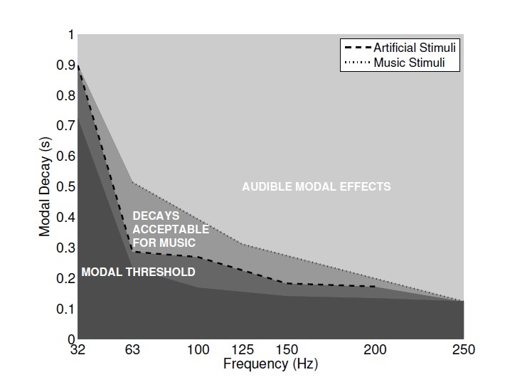

Looking at your projected absorption ranges for your 3rd panel, it seems they absorb mainly between 60 and 100 hz. Looking at the difference in that area on your graphs I think shows a lowering of 200 MS in that range, which when looking at the standard waterfall graphs would look more impressive I bet. Especially given how difficult those frequencies can be to control or absorb.Looks like this 3rd panel is not very effective. The initial measurement looks like most of the reduction is in the HF due to the foam panels. There is a some LF EDT reduction but not alot.

The LF decay time did change in the targeted range but not as much as I was expecting. As you say, it's a difficult part of the spectrum to damp because of the wavelength. Yes, it also shows in the waterfall as well, but I would still like better. I suspect that the one Helmholtz panel is not enough, so its working, but just not enough of it.

The "target" decay curve (attached below) was provided in : Fazenda, Bruno M., Stephenson, Matthew and Goldberg, Andrew (2015) Perceptual thresholds for the effects of room modes as a function of modal decay. The Journal of the Acoustical Society of America, 137 (3). pp. 1088-1098. ISSN 0001-4966
