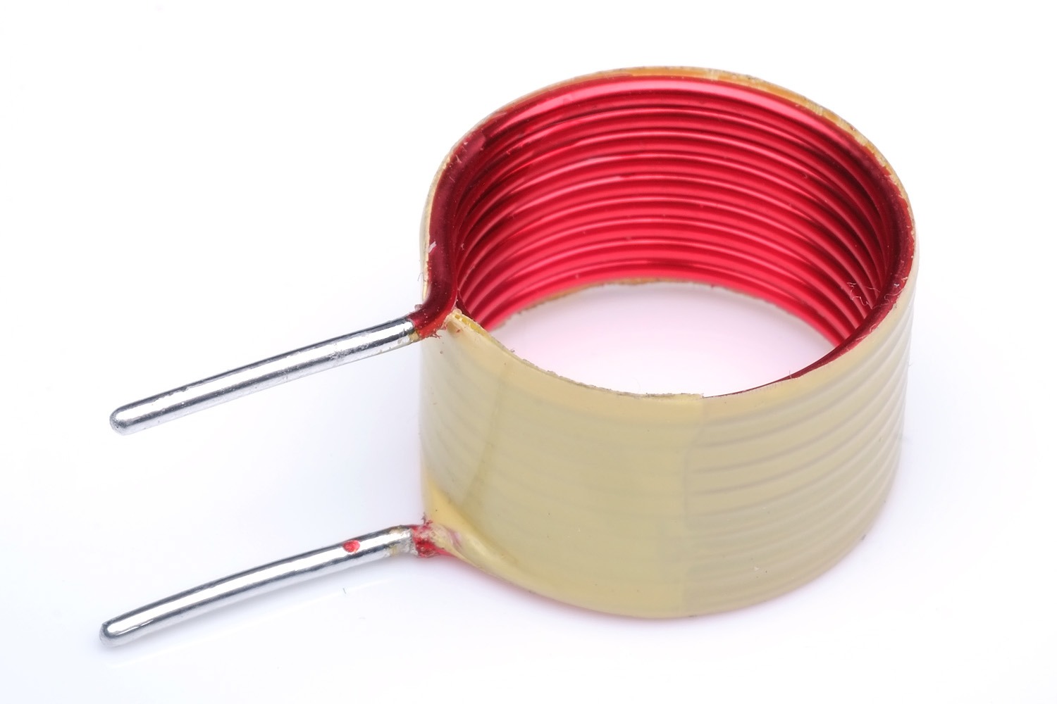

G'day Guys,
I am winding some inductors for the output thiel network on an amplifier:
5uH.
I've gone with 18awg wire. According to this calculator https://www.circuits.dk/calculator_single_layer_aircore.htm
I need 18 turns on a 25mm mandrel.
After winding the copper wire around my mandrel (a 25mm electrolytic capacitor) the wire wants to 'spring' back and loosen up.
Any suggestions on how to get the thing to hold its form nicely so that I can dip it into some epoxy?

- Wind tightly while maintaining tension in the wire, with the start end tied, or use a coil-winding machine (if available). The machine is capable of maintaining the correct pitch and tension.
Maintaining tension on the wire while winding is a good advice. Try to get some PVC pipe with a suitable diameter as a coil former. You can make a little notch at one end to aid in fixing the wire there, and it is very helpful if the coil former is much longer than the final coil will be. You can actually leave it inside the finished coil afterwards and just trim it to the correct length.
Personally, I have had good success with wrapping the coil into several layers of (tightly wound) capton tape and carefully removing the coil former afterwards. The tape stays on the coil.
There's a spring back factor at play here depending on the material and other mechanical factors which you have to accommodate for in order to reach your target diameter, simply put, in your case you have to wind your coil on a coil former with smaller diameter, try starting with someting like 20-22 mm.
Also, if you want the coils longitudinal direction to contract and hold together, you may also have to slightly twist around the coil former while winding, but usually holding the wire snug and almost letting it climbing on the previous turn at angle of something like 70-80 degrees instead of normally straight on 90 degrees perpendicular angle usually will make a fairly tight coil.
Put a thin (say 1cm wide) piece of grease proof paper on your former and tape it in place either side of where you will wind your coil. Then wind your coil. Once wound, secure the windings in place with a few drops of superglue along the winding over strip of grease proof paper. Let it dry and then just slide the coil off the former. You can then further secure your coil by filling the centre with silicone sealant.
I use a piece of dowel usually.
(Separately, 18 gauge seems a bit light and 5uH quite high!)
I seem to recall that there's magnet wire out there that has slightly sticky enamel. That's intended for keeping the coil together after winding. The inductors I use in my amps are custom made. The manufacturer gives them a layer of yellow transformer tape to prevent them from unwinding. I think they also use the wire with the stickier enamel.

Attach left end lead-out wire to coil winding rod with 3 wraps of masking tape. Tightly wind the correct number of turns. Keeping lots of tension on the wire, tape right end lead-out wire to coil winding rod. Cut away from wire spool.
The coil is now tight and non-springy. Tightly wrap it with two layers of Kapton tape. Since Kapton tape is not liquid like cyanoacrylate superglue, you don't need a barrier paper on the winding rod. Remove finished and tight coil, trim lead-out wires, and measure the final inductance on a DER-EE DE5000 digital LCR meter.
There are many good suggestions here.
I usually put some kapton tape sticky side out on a greased, slightly tapered mandrel to stop the wire from springing open.
Then once wound and cut to size, I put some superglue on the coil to hold then slide it off the mandrel.
A quick squeeze in a vice takes out any remaining springiness and it is ready for covering or epoxy dip.
