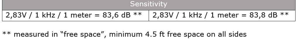

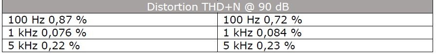

Distortion numbers from a complete rebuild ESL-63 set.
Measurement with REW RTA screen and MiniDSP UMIK-1
Indeed below 0,1% THD+N distortion @ 90 dB @ 1 meter.
This is left and right of both speakers from a set.
Can't really agree on annoying drive requirements.
According to some info on the web, you can/have to add 6 dB because of the fact that you are measuring a dipole and the microphone doesn't catch the audio impression that reaches your ears. No idea if this is fact or fiction.

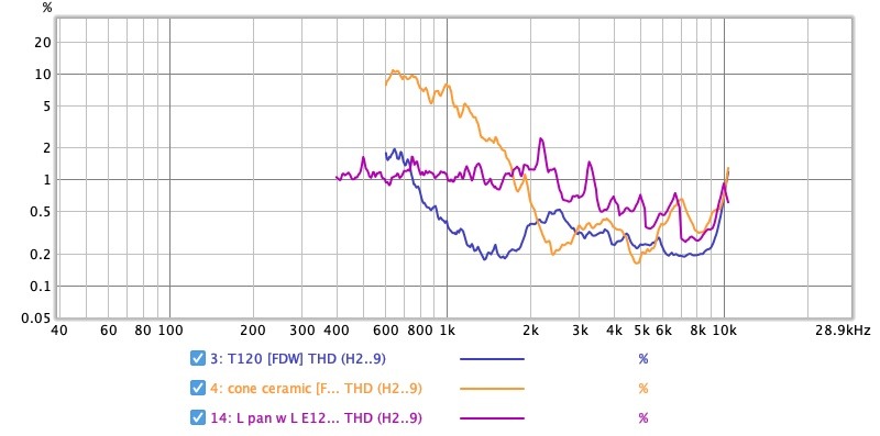

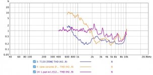

Attached is plot of my old and tired ESL panels from 1975 (red), a $3 ceramic tweeter 40 yrs old (orange), and a high-end Foster planar T110 maybe 20 yrs old (blue). Tested medium loud. Tweeters N/A below maybe 3kHz.
Not saying the testing was esp careful, but what is what is.

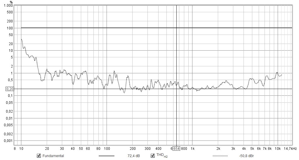

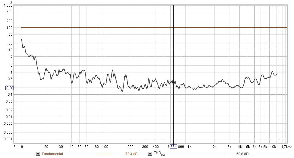

Here is a plot of the ESL-63
Fundamental and reference line at 0,2%
With a sweep measurement you have inter-modulation distortion.
This is 75 dB @ 1 meter in the living room.
You don't state volume and distance

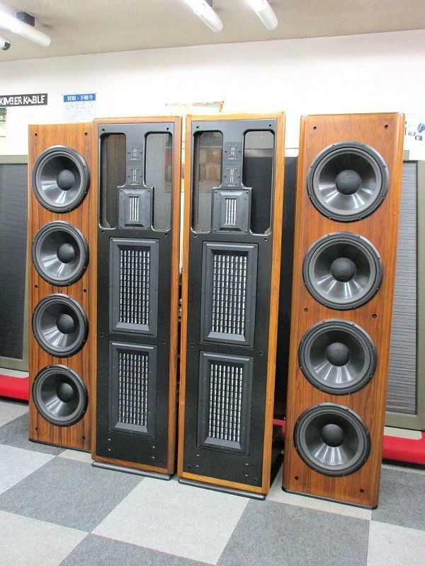

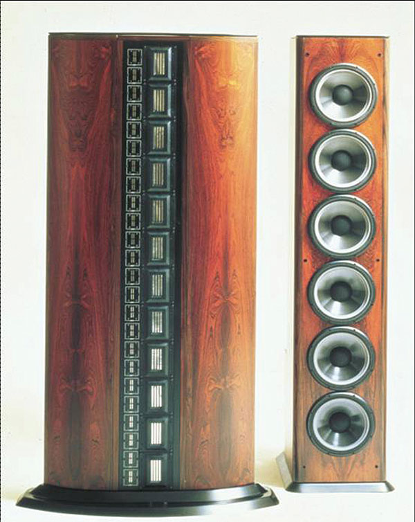

you can go as low as 100Hz, as some old IRS did
more common is 150Hz

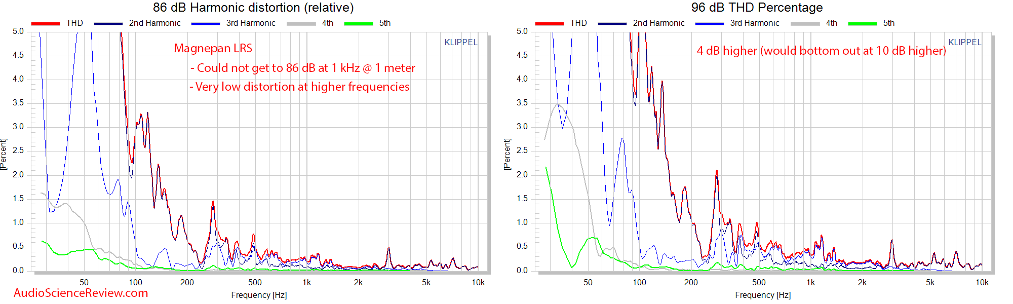

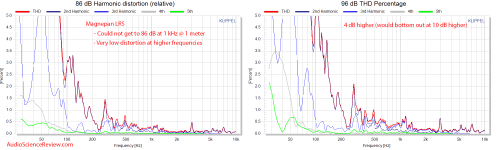

McGowan touches on this in a recent YouTube video discussing PS Audio's new flagship speaker replacing the IRS in their main corporate listening room. He suggested EMIMs generate double digit distortion at the operating lower end. Given their size, age and the performance achieved by Magnepan with the contemporary LRS this seems credible. Audio Science Review distortion results below.

The issue with planers and going low is tension and the resulting resonant freq. The "neo" drivers have a farly tight diaphragm that plays hell with trying to cross over below about 150hz.
I believe the old Infinity planers had very little to no tension. This is fine when using multiples.
