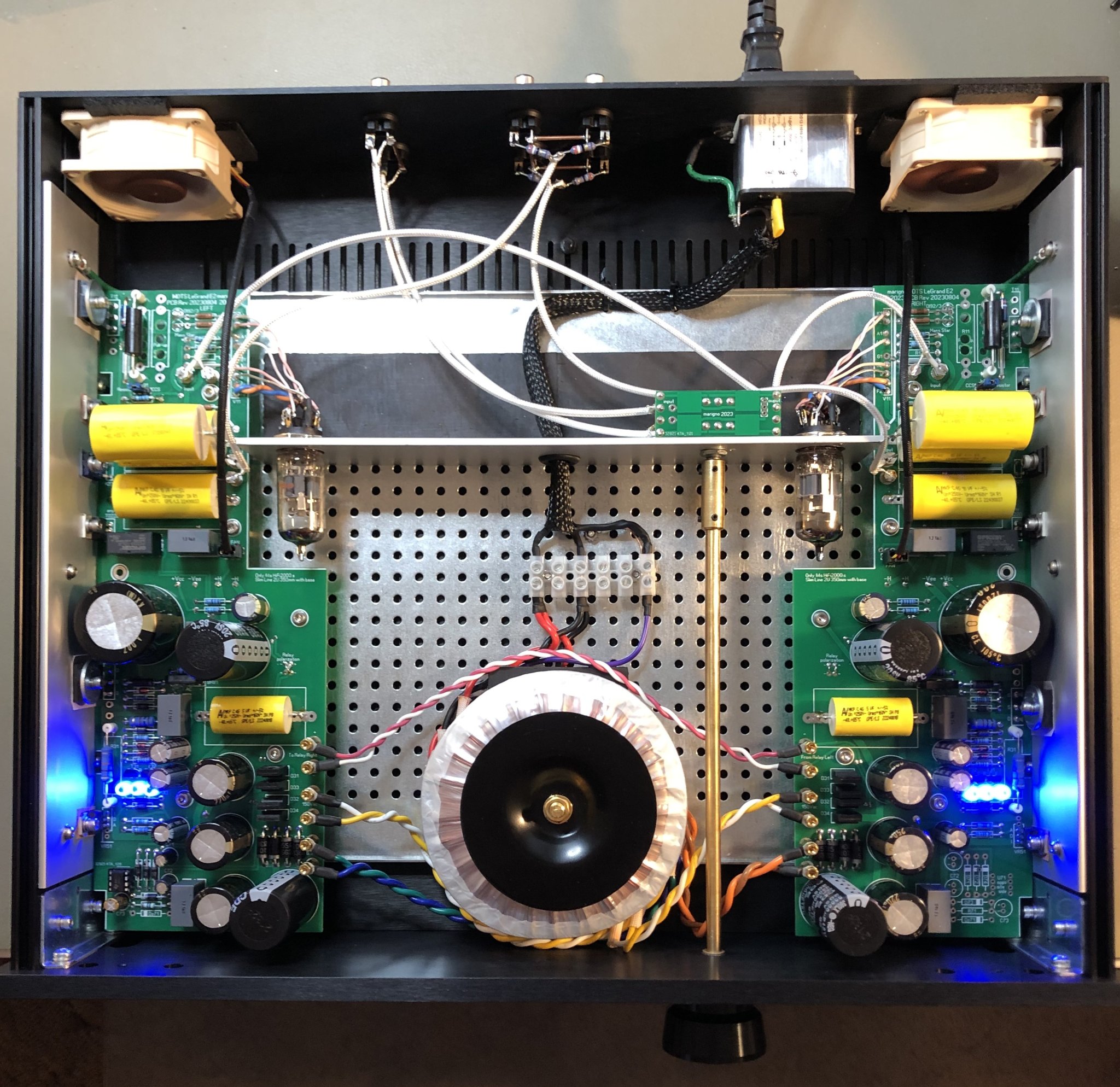

I finally managed to close the projects of my “WOTS LeGrand” and “WOTS Tre” line pre-amplifiers.
Two very well-functioning pre-amplifiers, necessary for the optimal definition of the sound, before sending it to the power amps. Or two useless and boring post-amplifiers, according to the opinion of some of the readers.
Both are dual-mono builds and have the same warm and precise sound, even if they use different technologies: the LeGrand is hybrid (tube/transistor), and the Tre is completely solid state.
The electronic part uses symmetrically designed double-sided PCBs, a single PCB design serves both left/right channels depending on which side is used.
Since they have no loop feedback, good-quality components must be used.

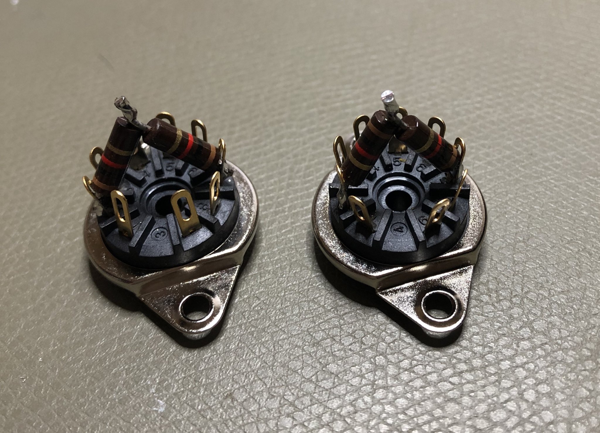

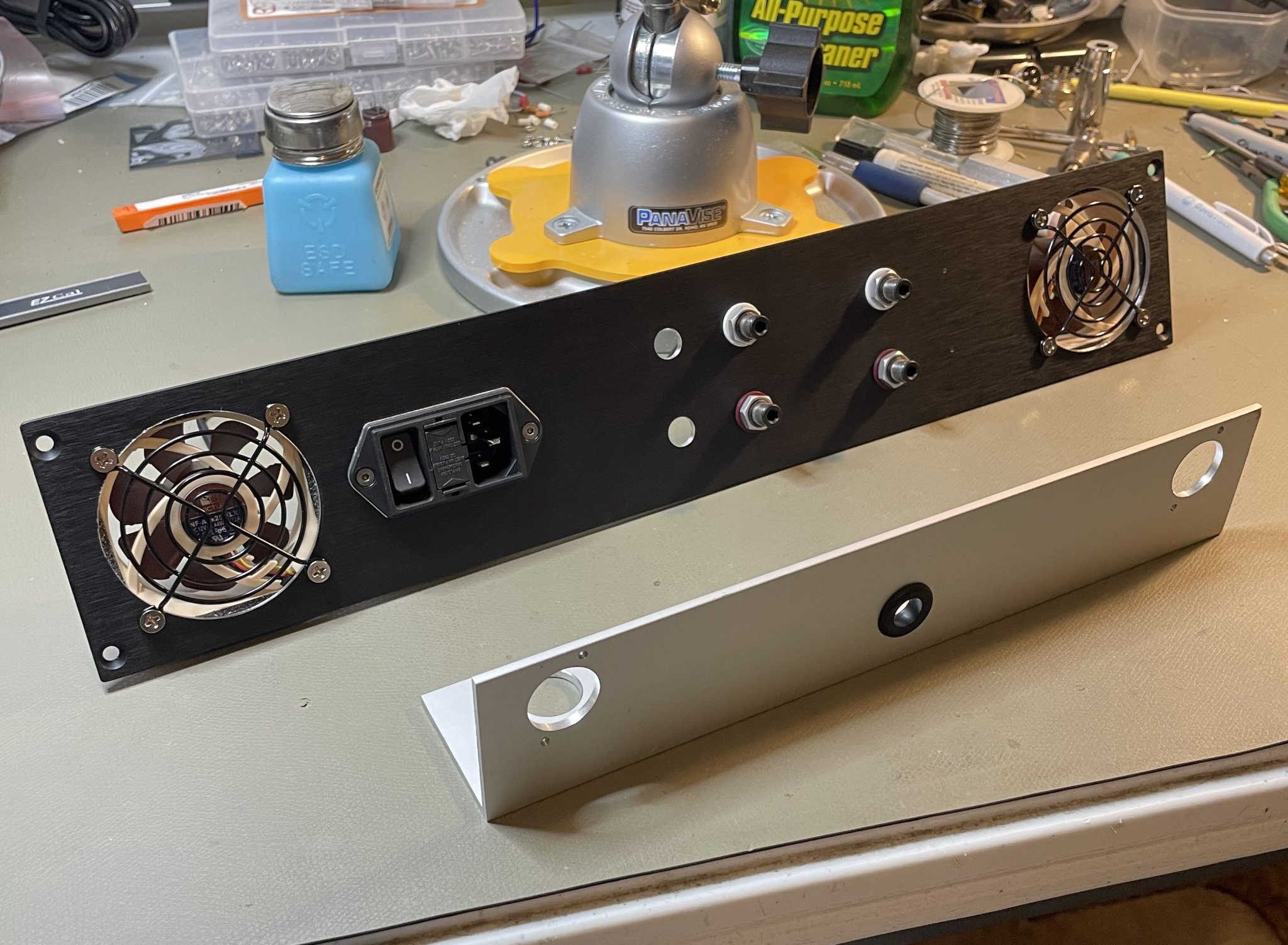

Yesterday I completed my build of the WOTS LeGrand E2. Finished quickly in a couple of evenings... ha, not quite.. I took things slow and enjoyed the process. This patience seems to have paid off, the preamp worked perfectly from first power-up. Fabrizio is a very friendly, knowledgeable, and passionate diy'er that has obviously put significant time and effort into the development of the LeGrand. It shows in the mature clever PCB design and support documentation that he provided when I inquired about the project. He was always on hand to answer my questions and offer advice along the way. That said, I probably wouldn't recommend this beast to a novice builder.
I'll refrain from making any subjective sound comments as that always seems to generate some angst. Suffice to say, the unwritten rule says the latest audio project you've completed is always the best one yet, and probably the best that's ever been (in the history of all mankind, of course).. LeGrand has lots of gain and a beefy output stage, so I plan to try something later with my monoblock amps to use that to my advantage. So here's a finished top down view and a few other detail shots from along the way. The attenuator I used is one of those cheap DACT knockoffs (50K D-shape shaft version, from HK) found on the big auction site.
