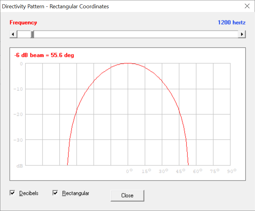

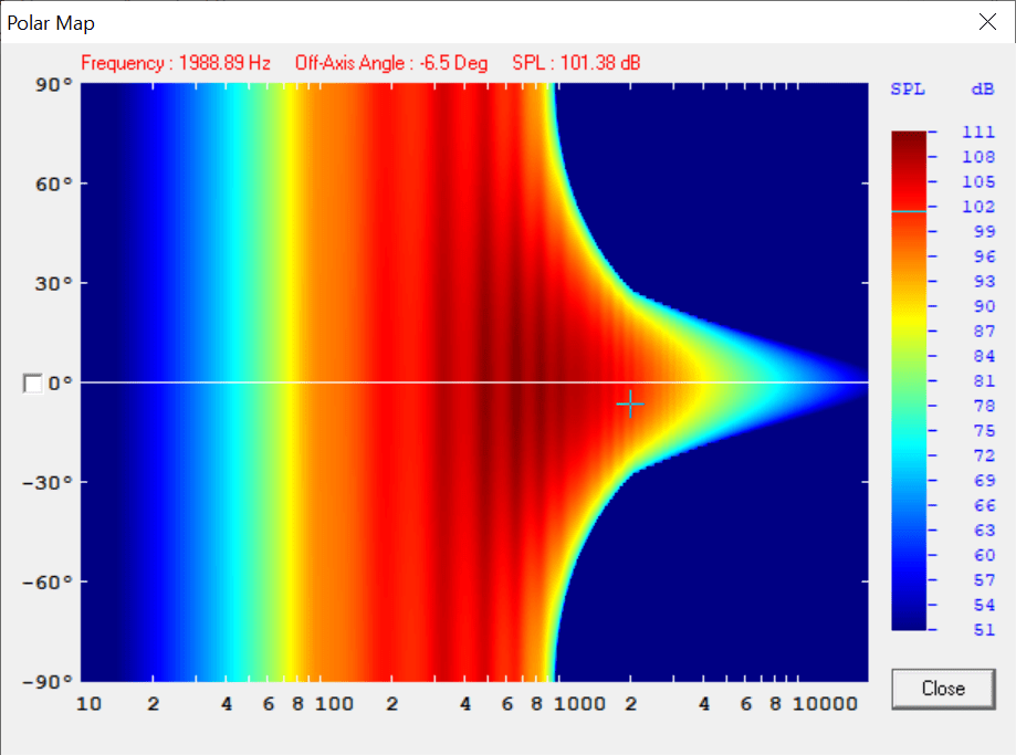

What would you estimate the directivity of one cabinet to be at ~1200Hz?
Hello Fredi, this questions is beyond my limited knowledge. Once this cab has a big flare at output I think the dispersion would be different horizontally compared to vertical position of the box.
For outdoor use I would use them in horizontal position while indoor it may doesn't matter much if you pointing them to where you are sitting.
To cross at 1200Hz it may depending from what driver you are assembling, For sure 1000Hz is doable for average drivers in the market with low Qts.

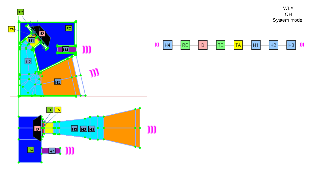

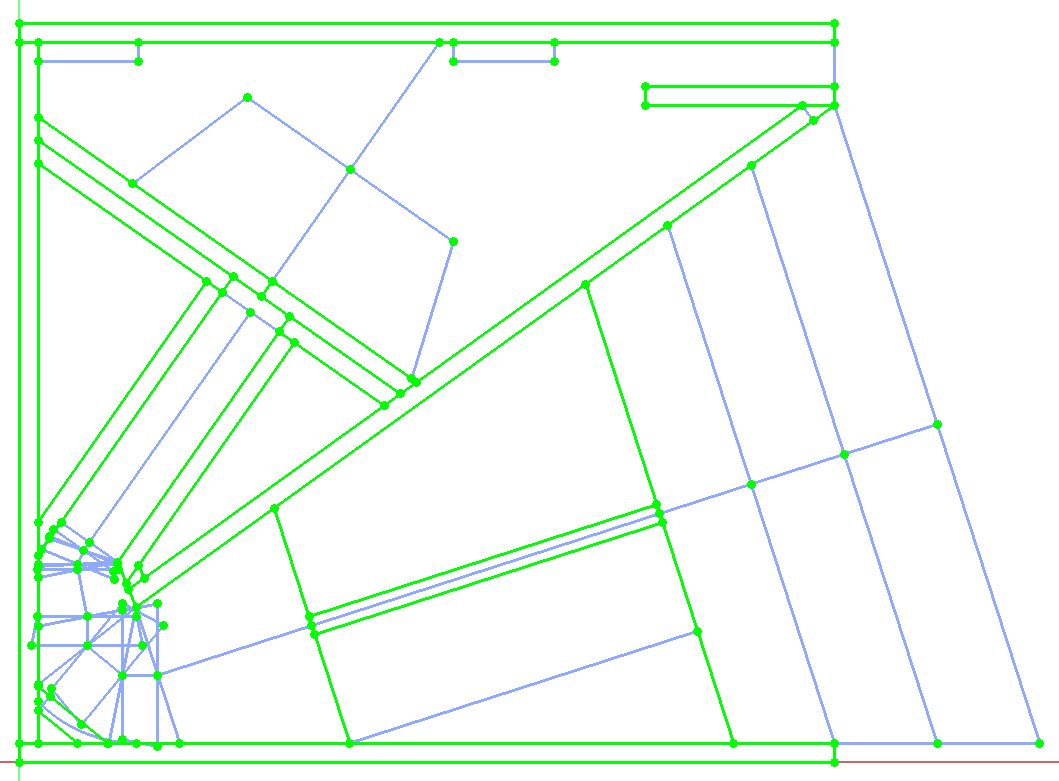

I tried to read the WLX style hornresp input stuff but don't see well- What corrections does "this" need?
To simulate the WLX box I used CH model from Hornresp. Check attached image.
WLX
Using Nd model with 18" driver, your model seems fine.

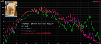

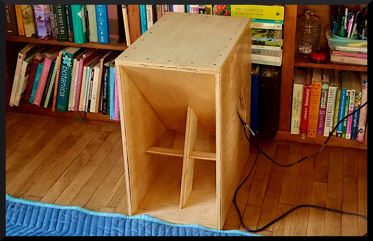

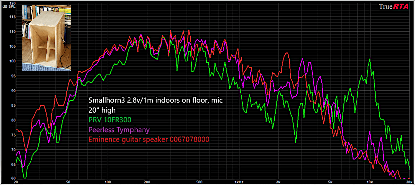

Lookie -- PRV's 10FR300 ~10KHz peak comes out unscathed from LORDSANSUI's "Smallhorn3".
Aesthetically speaking, {IMO smallhorn3's proportions and mouth/angle are things of great beauty. If vented a slot port may look better than round ducts.
(I've definitely got one of the best builder - testing friends in the world)
The vented version consider it placed on top of the mouth as you can see below. It would improve driver cooling a lot.

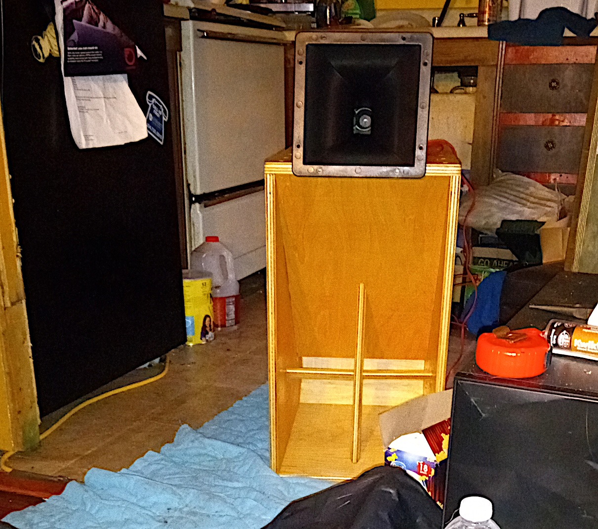

IMO my 0.83 scaled Klipsch Belle is a good performer and only a bit larger than smallhorn3. (Smallhorn3 built of 18mm is ~3.7 cubic foot external bulk. 0.83 scaled Belle made of 15mm plywood is around 4.1 cubic foot - but would be closer yet if the 1.125" tall base were omitted and back chamber cover made flush)
