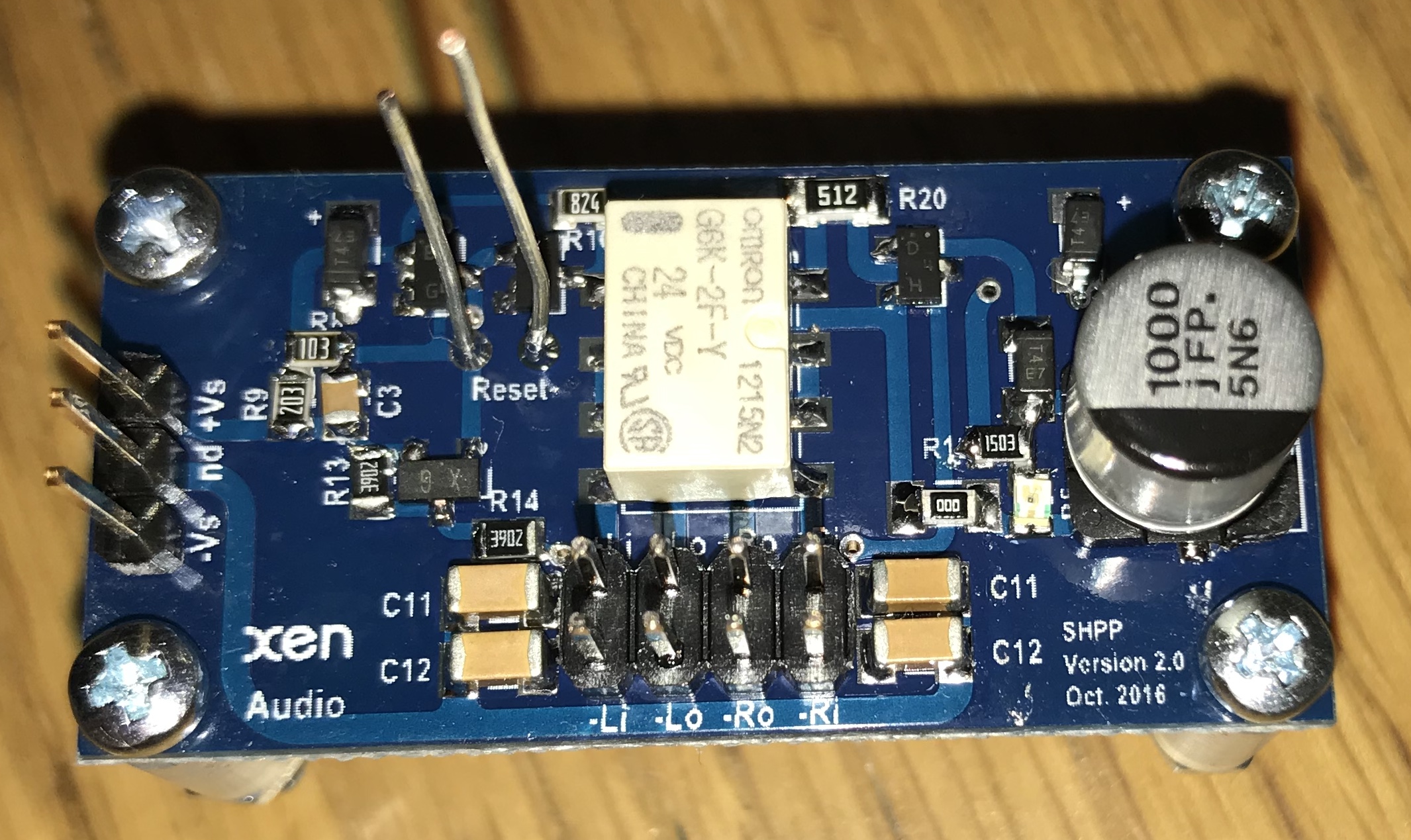

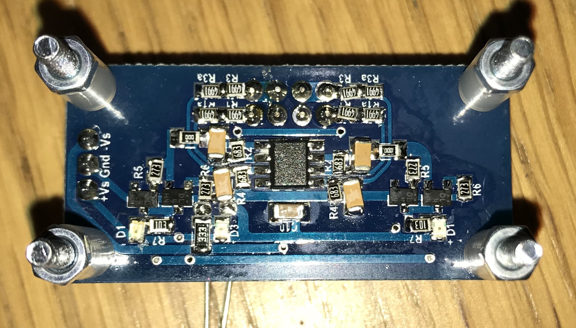

I got my SHPP board to a phase where I could test it and to my surprise it seems to be working alright. This was the most difficult soldering job I have encountered so far and my handcraft aint pretty. I have propably made a mistake with the LEDs, since the only one I can see lit is the right channel red one, when I feed DC to that channel with battery as described in the documents. When I feed DC to left channel the relay clicks, so I suppose it’s functioning as it should although the red LED won’t lit up. The green and yellow LEDs won’t lit no matter what I do. I guess that the LEDs are only for indication and don’t affect the protection functionality? I really hope I don’t have de-solder all the LEDs.
My other question is do I connect only Li and Ri (in SHPP board) from the headphone amp and Lo and Ro from SHPP to headphone out? Ground only to SHPP board’s power ground? Just to be sure...

Firstly none of the LEDs should light up even under DC offset.
So your circuit should be working as intended.
If you read the documents again, the SHPP can be used for any headamp output, including single ended and balanced ones.
So you need to connect all 4 connections (Li+, Li-, Ri+, Ri-) to you headamp outputs.
In addition you need to connect the SHPP PSU Gnd to the Gnd of one of the headamps.
If you use the headamp supply also for the SHPP, this is done automatically.
I personally use separate power supplies (78Lxx/79Lxx) for the SHPP.
You should also connect all 4 connections (Lo+, Lo-, Ro+, Ro-) from SHPP to the headphone.
I always use 4-pin connectors for headphones, as I want the Gnd current to return to their respective amplifier through separate wires to minimise cross talk.
I use either 5-pin Mini XLR (Pin 5 left unused) or 3.5mm TRRS.
Soldering will improve a lot after 2 or 3 boards.
The trick is to start from the middle and work outwards for good access.
And very sharp soldering iron tips.
Patrick

"Firstly none of the LEDs should light up even under DC offset."
So what is the purpose of the LEDs? The red one on my right channel does lit up and relay turns off when I feed dc to Ri+/Ri-, and dims out within few seconds after I remove the dc. Also shorting the reset pins turns D1 off. On the left channel the D1 does not lit while doing similiar tests but the relay works as it should. Is this still proper functioning?
Under normal circumstances, the voltage across D1 should not be much more than Vbe of Q3, i.e. 0.6V.
They are there to prevent excessive voltages in case of a fault.
In my own examples, the red leds only light up when there is a huge DC transient.
If you slowly turn up the DC, as normally the case, they should not light up.
Re-read the pdf and try to understand how the circuit functions.
I would check that first, then check soldering of R5,6,7, D1,2, and Q1,2.
What is your supply voltage and what value of R5,6,7 are you using ?
And what DC offset did you use to test (100mV or so ?)
Patrick
The board is set up to be used with +-24V supply. R5/R6 = 27k and R7 = 10k according to the BOM I got from the group buy. I need to check on the DC offset, maybe I had too high a value and that’s why the led lit up.
Yes, I need to take more time trying to understand this circuit and check the solder joints. I'm just being overly cautious since I'm not confident about my smd soldering on this board. Thanks a lot for helping.
The values are correct.
