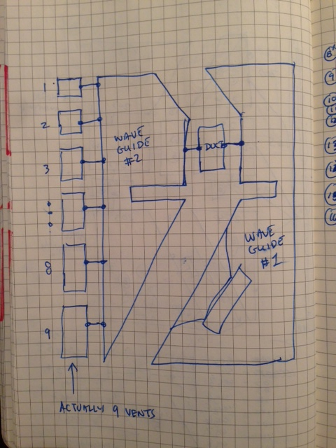

My Akabak model of a Karlsonator has a detailed K aperture profile that is accounted for. The XKi model is simplified and similar to a band pass sim you have. I can modify the K15 Akabak code to be an XKi and that would have the correct effect but I find it minor so don’t do it. It affects the midrange mostly.

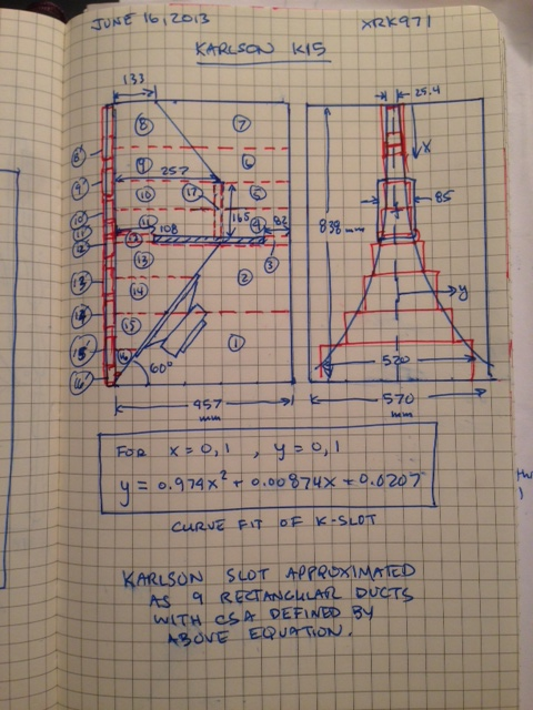

I have the outline of how I simulated the K15 in Akabak here:
https://www.diyaudio.com/community/threads/karlson.213594/post-3528706
I approximated the aperture as a series of different width waveguides radiators following aperture function. The passages internally are waveguides.
k15-akabak-1-png.354698

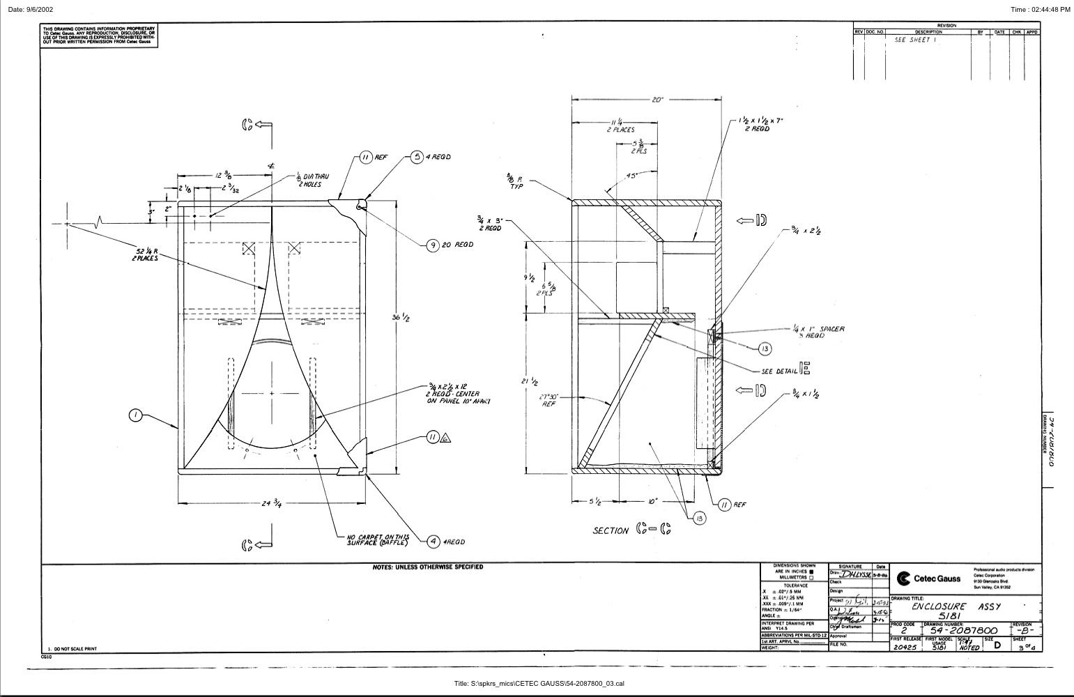

if You have a time maybe to check with akabak script for 18in driver.
There was a Gaus K-18 cabinet 5181 dimensions in the JPG,
with
Cetec / Gauss 18"
Model #4882SX
8 ohm.
Patent no. 225,069.
Doped suspension surround.
Field-serviceable voice coils.
Develeoped by Bart Bingham and Ed May
Vas = 430 liters
Qts = 0.2416
Qes = 0.27
Qms = 2.3
Fs = 33 Hz
xmax = 1 mm
Re = 6.7 ohms nominal
L = 1 mH
BL = 23.49 Tm
Z = 8 ohms dynamic, nominal
Mms = 107.24 grams
SD = 0.119 m^2
Weight = 11.24 kg each (25 lbs)
Approximate minumum power for nominal EQ accuracy = 20 watts rms.
Max Power [W]; Maximum input power = 400 watts rms, 800 watts program, 1600 watts peak.

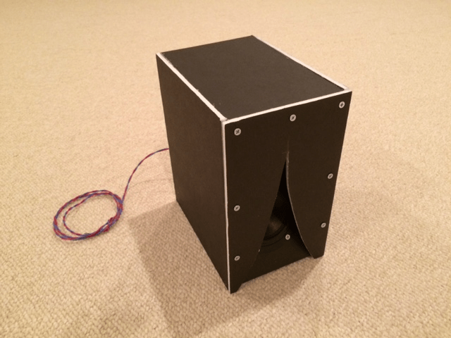

Hello, I would like to make a pair of XKi for the RS100-4. I read the thread but I have some doubts about the construction process.
You included some drawings on the K-aperture, but it is not clear to me how should I make it.
How wide should be the top aperture and the bottom be? I see you made an almost "exponential" cut to the aperture and some other people use a different, more "circular" shape. Does it make any difference or I can even use a linear shape if I want to?
Can I mount the speaker flush or it has to be mounted on top of the baffle? Usually this is made to reduce diffraction, but I have no idea if it matters when the speaker is tecnically inside the box.
How thick should the wood be? I'm worried that if I make the aperture too thick I will mess up the high frequency response. I have 1cm (3/8") MDF and 2cm (3/4") plywood but I can also buy 16mm (5/8").
Can I use polyfill for the big chamber and felt for the small chamber or do I have to use a specific type of deadener for it?
Excuse me for all these questions but I've never had any experience with such a weird design. Thank you!

I would not worry too much about the exact shape of the curve. I free handed it with about 3/8in slot at the top and the line is tangent there and expands in a fixed radius arc towards the corners. Try to swing the arc to intersect the driver surround.
Use melamine foam pads for damping. If using wood, you need damping in the front chamber as well as rear chamber.

Front use 1/4in to 3/16in. 1/2in is overkill. Line the inside of aperture with paper faced foam core.

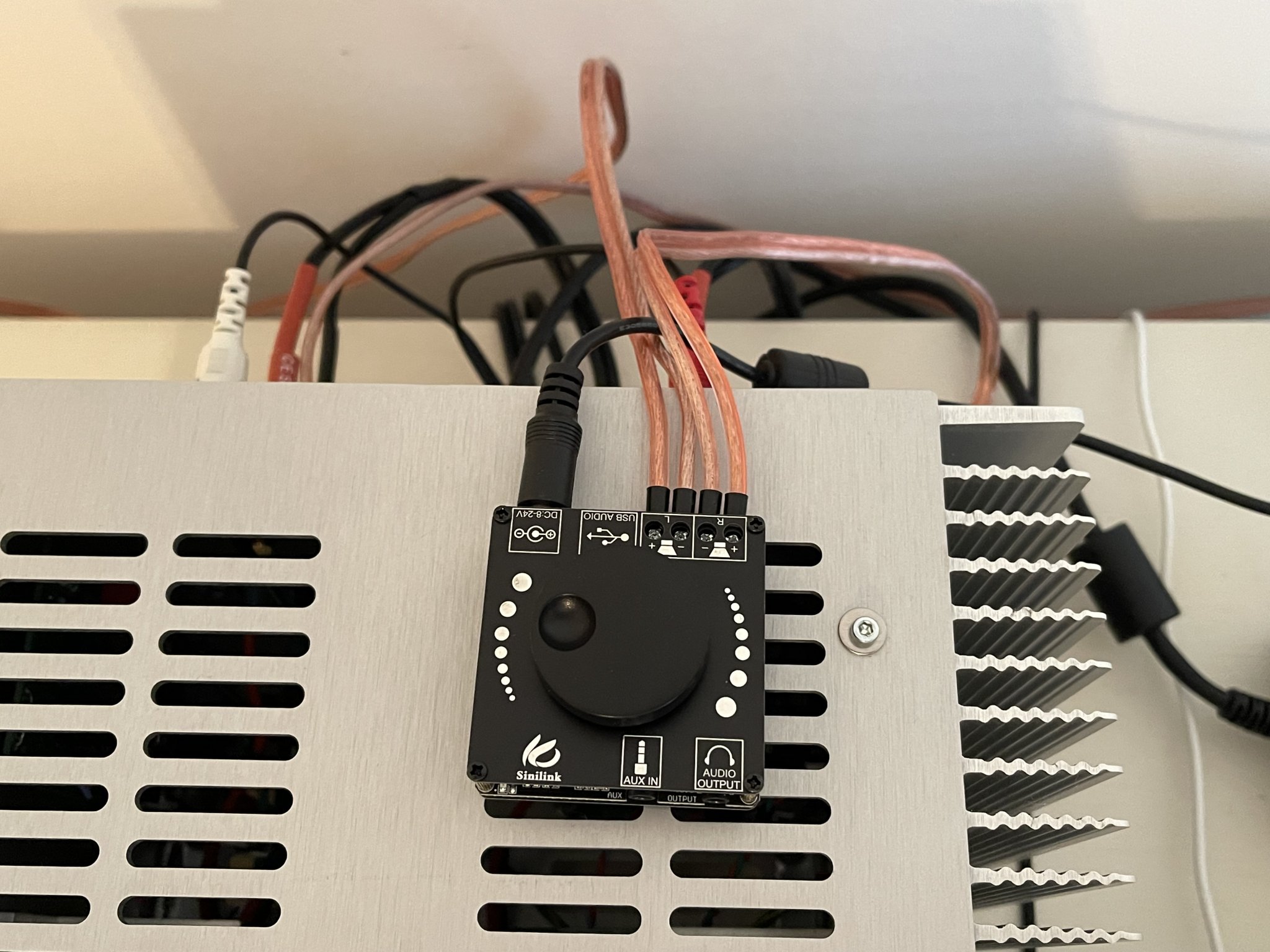

Recently I picked up an all purpose amp board that has multiple inputs and bluetooth. Specifically it is an XINYI XY-C50L which uses a Chinese clone of a TPA-3116 chip. Sometimes I need to hear music from someone's phone. I connected my pair of Xkiclops, which had been in storage for a while, and they were a nice match for this $7 amp. The speakers are on the floor near a corner, behind a chair. But they do the job. Anyway, for convenience I've been using it downstairs and feeding it songs from an upstairs desktop which has ALL my music; for when I'm too lazy to fire up the BIG system. Yesterday my desktop couldn't locate the bluetooth device (amp) so I played music from my phone. It was a much lower signal and I had to crank the amp to max to get a satisfying sound. then today the desktop re-recognized the amp while I was upstairs. So I hit play and there was this ENORMOUS sound filling the house. I let it go for 10 or 15 minutes before heading downstairs to check on my gear and OMG it was louder than I've listened to anything in years. And it was clean and had authority. The bass was killer (5" Vifa woofers). Needless to say I turned it down a bit, but what a surprise. The XKi is really something to scratch ur head about and marvel.
