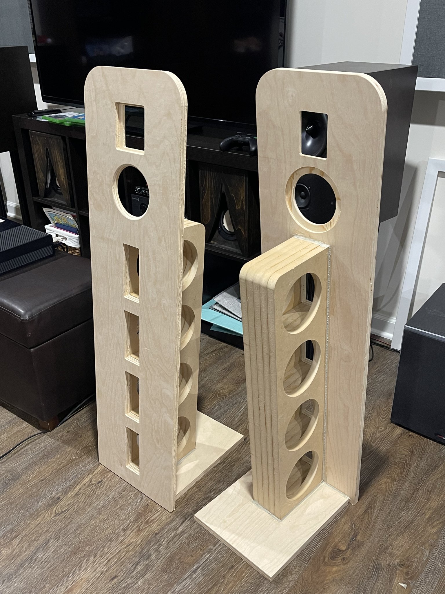

Hi Folks,
I have good news. We can do the XSD flatpacks for $600 a pair. This is with 3/4in birch faced Tru-Ply and 3/4in MDF on the woofer array box as shown above. The flatpack will be packed in foam, cardboard corner protectors, and a large box with straps so will arrive in great shape.

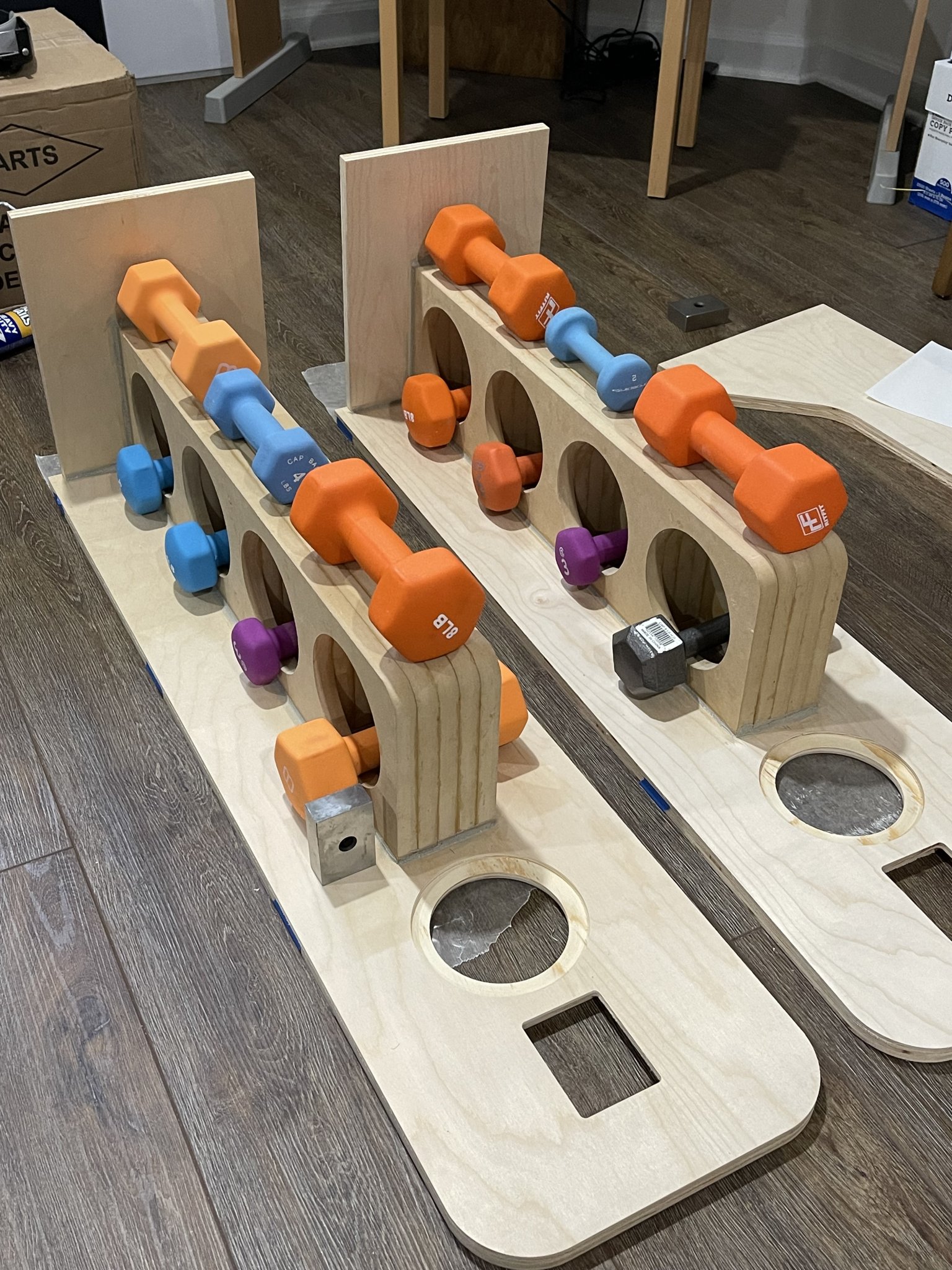

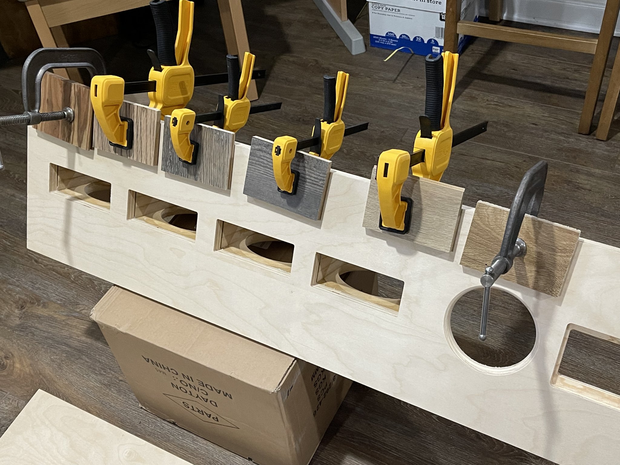

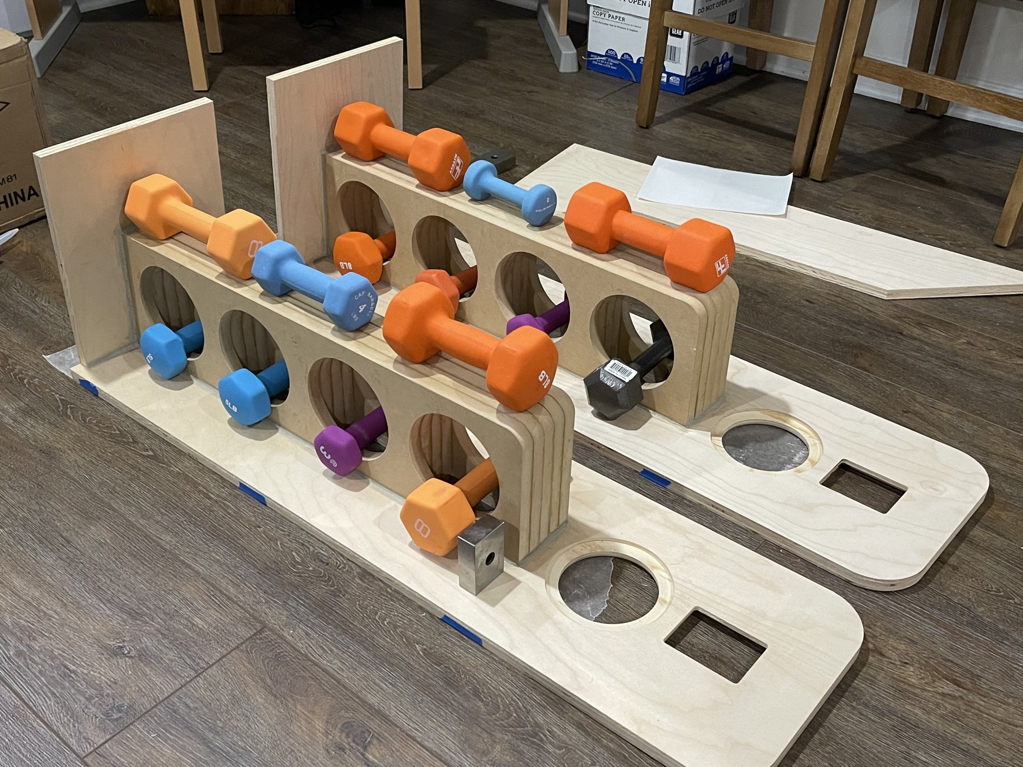

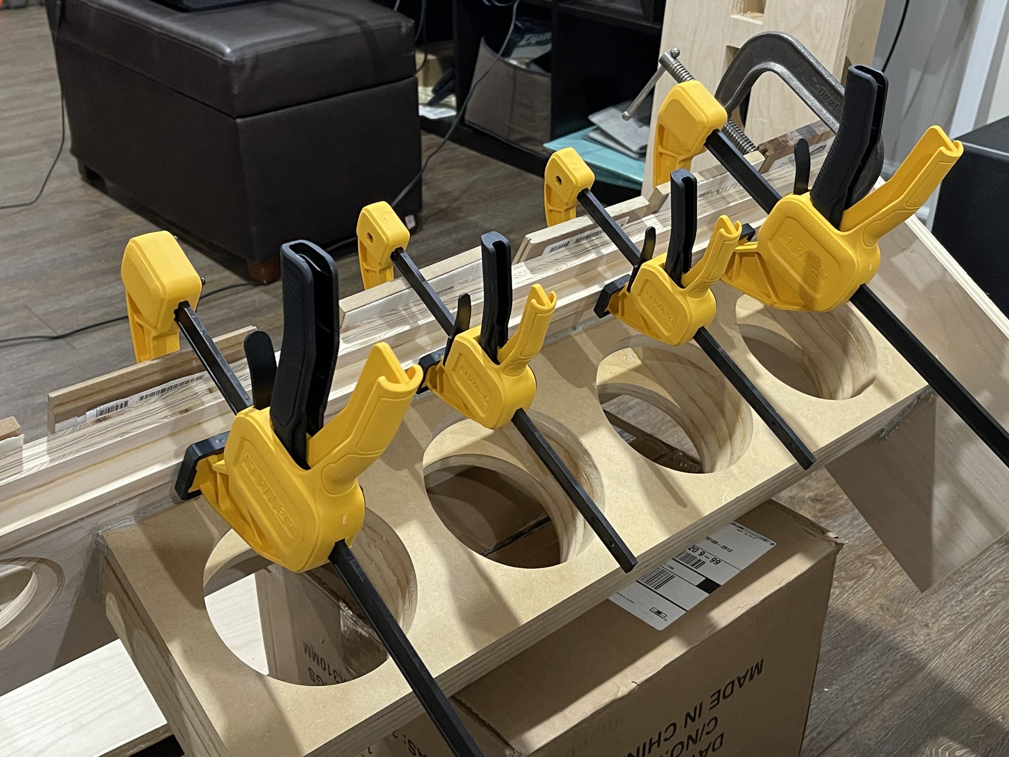

Gluing the baffle and base now.
Is there anymore interest in a GB for this flatpack? Birch faced poplar plywood. Cosmetically perfect birch veneer. $600 a set precision CNC cut and nicely packed for secure shipment.

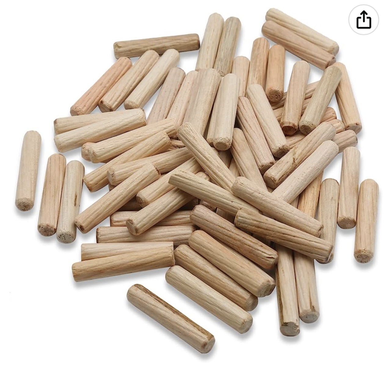

I was thinking the same thing originally. But then thought that the longer pieces might be tricky to push through if a tight interference fit for better alignment. The short ones are fluted and meant to tapped in with a hammer. They might actually provide a stiffer and straighter alignment than a long one with clearance.
I am no wood worker so happy to take suggestions from experienced woodworkers who have done something similar.
Reactions: 1 user
music soothes the savage beast
Joined 2004
I have made the request for the CAD model to include holes for standard M6 x 30mm long fluted wooden dowel pins.
3 for the woofer box stack (thru hole for all 5 sheets)
6 for the baffle to woofer box (blind)
4 for the base to woofer box (blind)
These are the typical dowels we can use:
https://a.co/d/j8xXpAg
