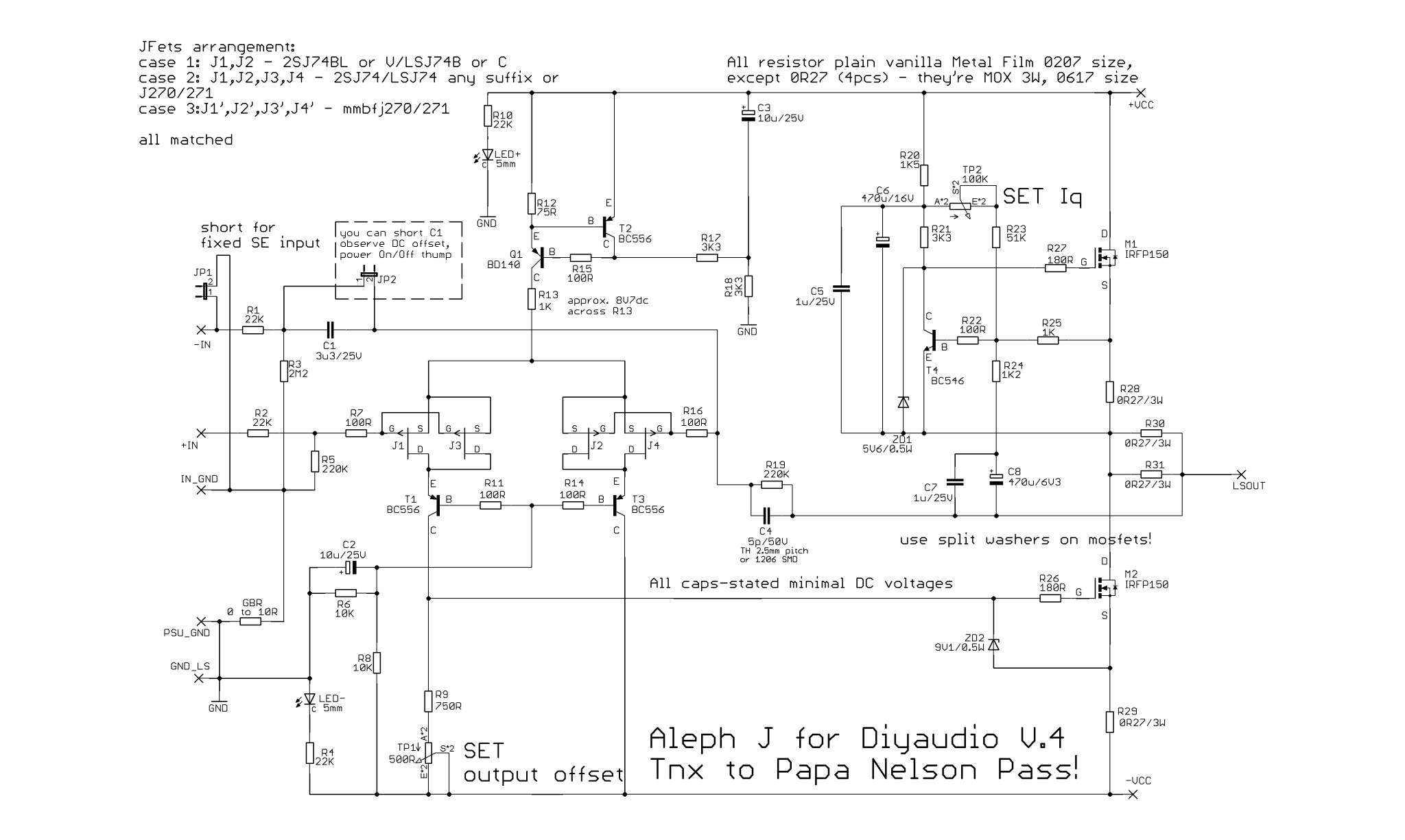

I described the differences here including some of the design topology:making me think!!! How about pointing me toward a schematic of the version prior to this?
So a little word on some of the technical differences between the two designs. It's very easy to see that ZM has tightened up his version particularly in a more compact layout, use of cascode regulation for the input JFETs and finally some current sources. The output stage uses the Aleph CCS but with IRF 150's which provide intrinsic matching! As such it is a much more turnkey method of building an Aleph J. There is no need for matching the output devices whatsoever.

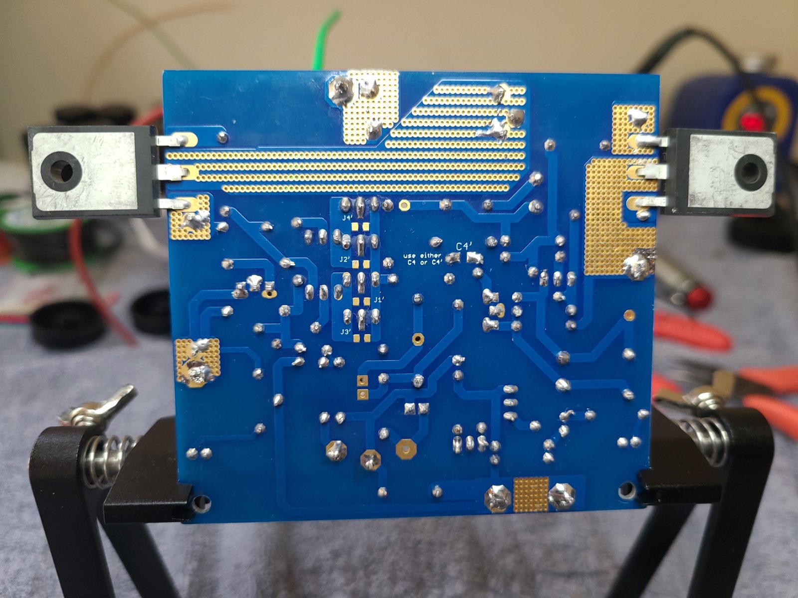

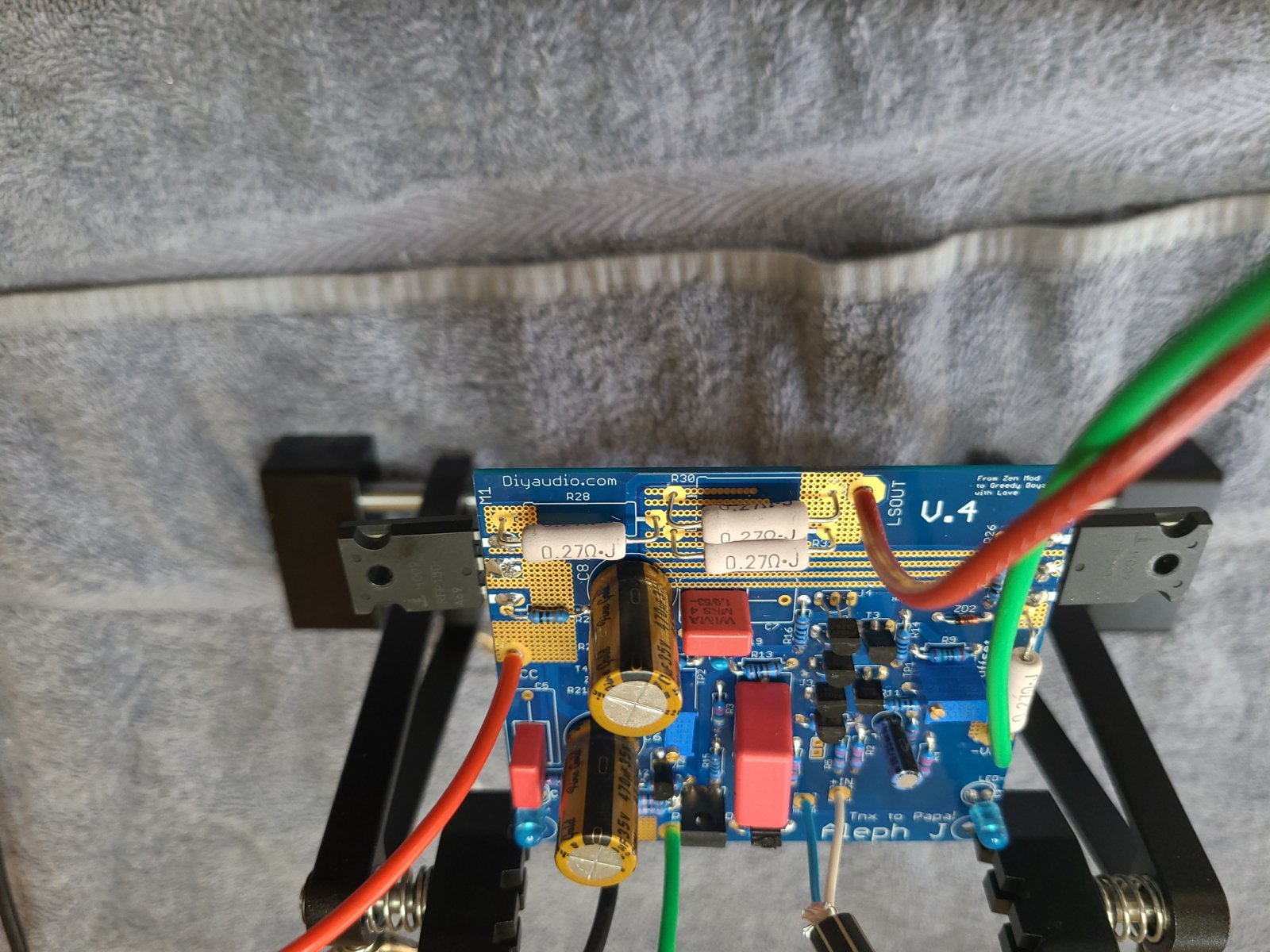

Nice job!Second board ready to install.
View attachment 1299228 View attachment 1299228 View attachment 1299229
Where you get the pcb?
Are gerbers posted somewhere here?

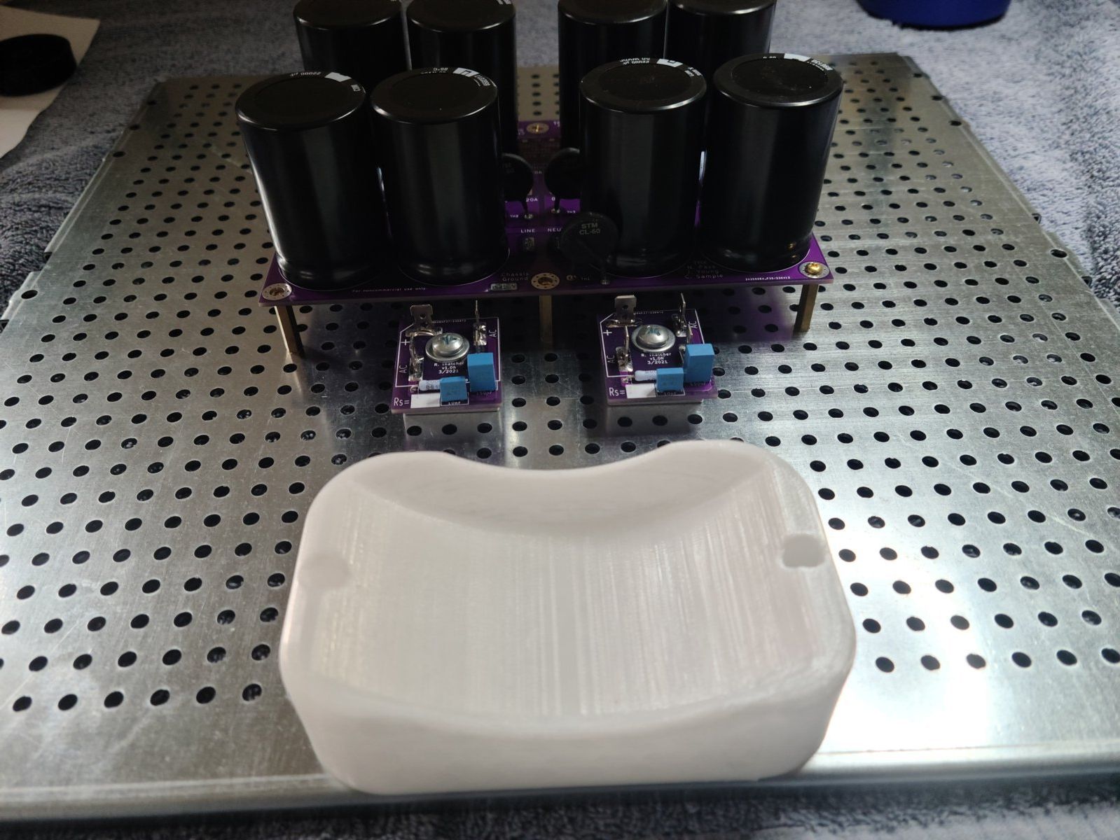

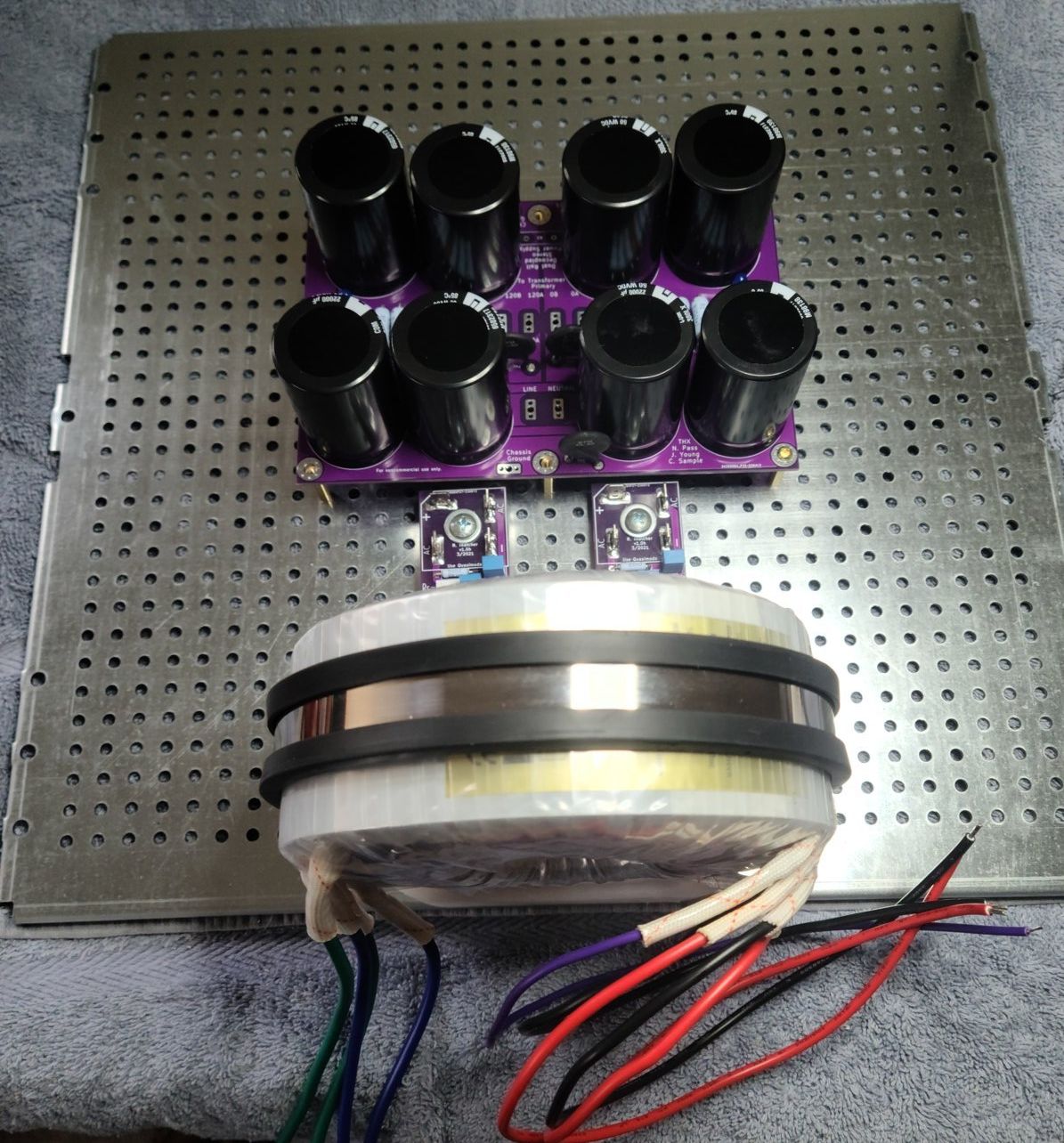

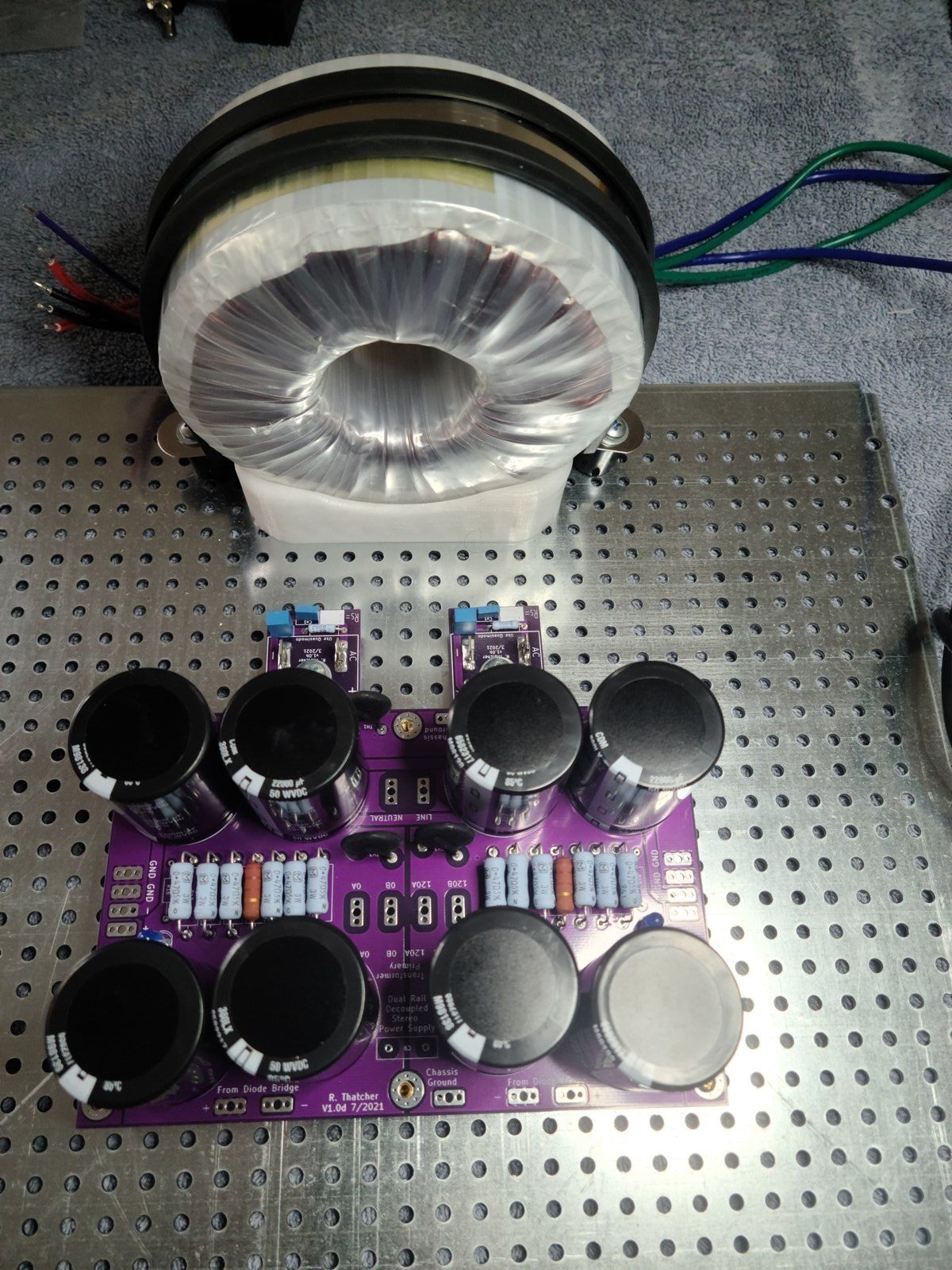

Oh lookie here. Another one of @birdbox trafo car seats in the wild!!!Coming together slower than expected, but nicely.
View attachment 1296190 View attachment 1296192 View attachment 1296194
I wonder where to get those!
