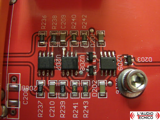

Please note that the board utilized four OPA2605 opamps and two pairs of transistord: 2sc2383, 2SD669, 2SC649 and 2SA1013. It appears that it is a bit more than paralleling and bridging. Let's see what it is

Please note at the newly uploaded photos in the OP that the board utilizes four OPA2604 opamps and two pairs of transistors: 2sc2383, 2SD669, 2SC649 and 2SA1013. It appears that it is a bit more than paralleling and bridging. Let's see what it is when I get bare boards without components soldered.

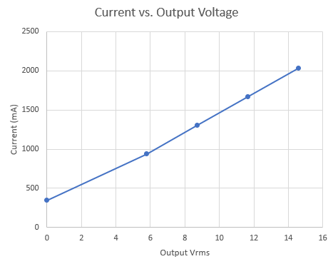

At zero input current is 345mA. Onset of clipping is at 30 Vrms. This is a bit premature because power supply sags several volts and I use 24-0-24V transformer.Can you please measure the supply current without load at quiescent and at full excursion?
It is to see how the offsets and gains are equated.
Here are the measurement results, numeric values are shown in the table below.:
Input | Output | I |
Vp-p | Vrms | mA |
0 | 0 | 345 |
200 | 5,78 | 940 |
300 | 8,7 | 1305 |
400 | 11,64 | 1669 |
500 | 14,58 | 2034 |
Of course, it is with 7.3 Ohm 200W dummy load.Is this without load?
Just one important detail more: In this particular case I have used a capacitance multiplier power supply with output of just slightly above +/-30 V and it sags at higher power demands.
I have now replaced capacitance multiplier with a linear power supply providing +/'34.5 volts. I have estimated that it will produce about 160-170 Watts into 7.3 Ohms. It is concievable that the amplifier can produce 200W into 4 Ohms. But why bother to run amplifier on its very limits. Perhaps it will be wise to run it at moderate values to have design margin when loud music demands more power and run it comfortably cool.
EDIT: and, by the way, the meassured quiescent current matches values from the technical data sheet 6X(50 ... 85 mV).
